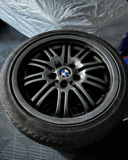

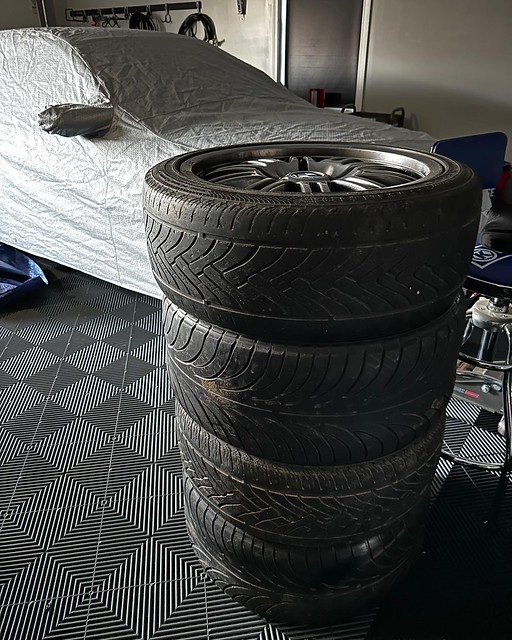

    Scored a super cheap set of Style 67's from just over the border in NH. Plan is to have them refinished at some point and keep them as a spare/backup set for the M3. I don't have any plans to swap out the OEM Comp wheels that are currently on it. In my eyes, the Comp wheels are the perfect wheels for the E46 M3.

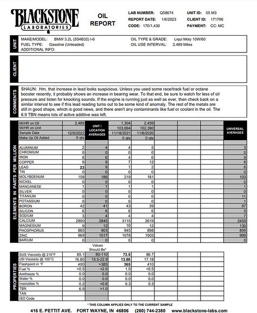

    Recently got the results back from my latest Blackstone Laboratories Oil Analysis. I didn't use any race fuel/octane booster, so obviously the Lead bit is somewhat concerning, but I didn't notice any issues with the oil pressure or any knocking. Will definitely be keeping a close eye on things once she's out of hibernation in the Spring. That said, I suppose bearings have crept up the To Do list somewhat. Anyone have a ballpark price on what new bearings would run me (parts & labor)? Will probably take it to either Wile Motorsport in Walpole or Woodward Motorsports in Mendon for this work when the time comes.

      I'm suspicious of that copper you've been seeing 3 tests in a row, and oddly it was highest in 2020, though not a lot higher than the averages. Looks like you're over 104k+, not like you only have 50k. Lead is the first sacrifical layer, so no surprise if that creeps up, then you'd see it start to go back down and copper rise up * if wear is even, but that's an assumption. Seeing iron, you've gone too far. So I'm not sure why you've seen elevated (for the mileage) copper BEFORE lead - perhaps one single shell or pair wore badly and its lead is gone and has been adding copper to your oil for a while? - Just a guess.
      Something to remember about the PPM is mileage. PPM will be higher on the more typical OCI of 7500. You have less than 3k.
      What oil are you running? If Castrol, there should be titanium. If liquimoly, there'd be no Molybdenum. Kind of strange. Maybe you're using the BMW (shell) oil or motul? Edit, says LM, but you must be adding moly as an additive.
      Hopefully RB job is cheaper where you are, but even in Socal, it's not that much higher than $1000 (labor) since ACL beraings are pretty cheap, but you'll need new bolts and other parts.
      Edit: Reading these reports is like reading tea leave lol. Ultimately, it's a gut decision to do the job or not. Yes, you're over 100k, but you don't drive the car much, so failure may be years away at your current rate.
      If you showed pics of the shells, I'd bet they're actually in good shape for 100k, but that's my opinion formed from looking at pics of shells, including my own, and oil reports, over the last 10 years.

        RB job will run you slight north of $1.8k at one of the shops you've mentioned (Got mine done in 2022) - Which included all the necessary gaskets, WPC OE bearings and oil (OE rod bolts were supplied by me).
          I wouldnt bother with wpc oe (which I have too). Just oe or acl, maybe be - theyre popular for s65.

            Appreciate you chiming in, as always! And as you stated, I am and have been using the LM MoS2 additive at each oil change. And my goal is to drive the car more and more each year, as this past year is the most miles I've put on the car in one season since purchasing. The fact that I can get my boys into boosters in the rear seats makes it much easier to consider this car for everyday errands and what not.
            I suppose we'll see how the next oil analysis looks and go from there. If new bearings are in the cards, so be it. I don't plan on moving on from this vehicle any time soon, so I'll spend whatever is needed to keep her running smoothly and happily!
              That's not awful. Appreciate you chiming in!

                  Then just plan on doing it around the next time you need an oil change anyway imo, in about a year? Gives you time to book apt and discuss shells/bolts etc with shop.
                    Good call. Will probably end up doing just that.
