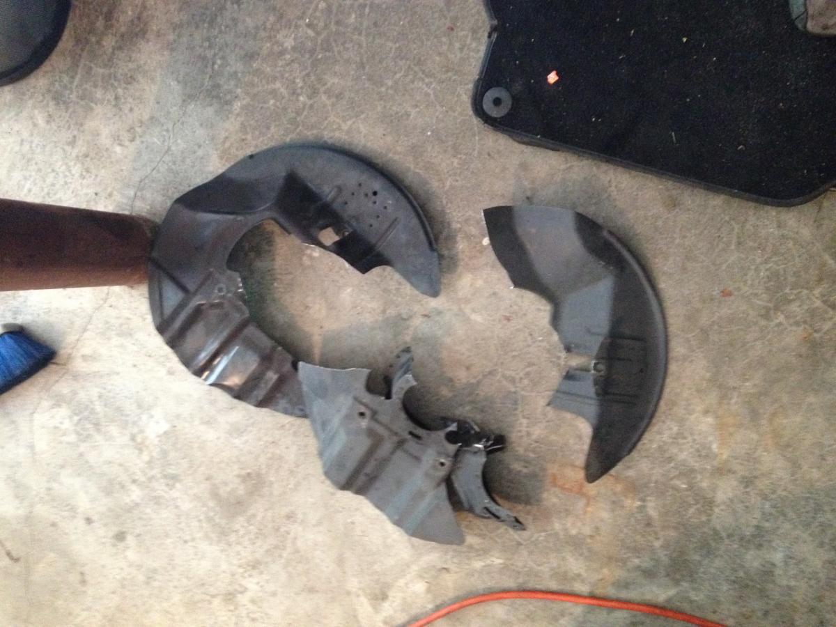

    I didn't have the cash to complete a BBK - so I upgraded to the BMW euro floating rotors and CSL front disks. With a pad update to Performance Friction - 008's for the track and Z-rated pads for the street, I've been happy with the performance.
    I removed the front and rear backing plates while I was at it and had intended to add brake cooling ducts, but I haven't found that it was an issue yet for my skill level on the track.
Name:	Brake splash guard removal.jpg
    I remember there were a lot of cutting tools involved and a lot of swearing - in retrospect, I would recommend not doing this unless you need the clearance or are running force fed cooling to the rotors. I haven't had any issues with this setup on the street in cold or wet weather.

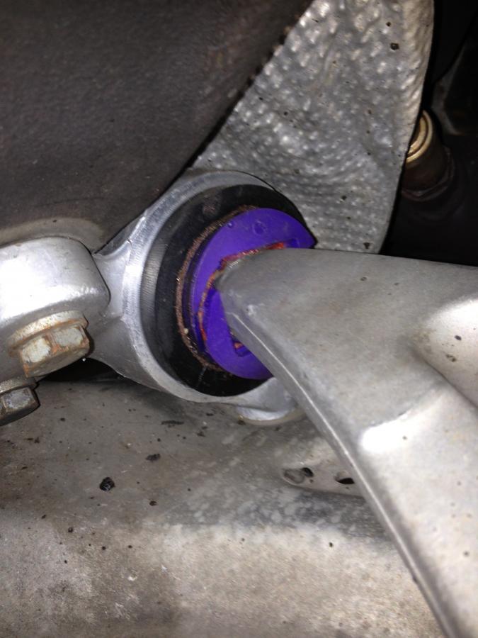

      With about 45K miles on the clock, next upgrade was to move to Powerflex FCAB bushings and a set on TMS swaybars.
      I purchased the baseline powerflex bushings and unfortunately after a few track days the passenger side (header side) bushing support housing gave up the ghost and cracked.

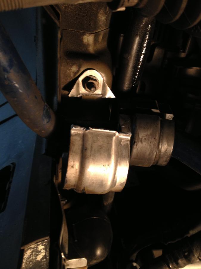

      I also found that one of my front swaybar mount brackets cracked - always a good idea to investigate those unusual noises...
Name:	Broken swaybar mount.jpg
      The folks at Bimmerworld were great and helped address the premature failure and get me into the upgraded powerflex race level FCAB bushings and I haven't had any issues with them since. I was tempted to go to the TMS FCAB with spherical bearing with grease fitting - but last time I pulled and re-lubed the new ones (no pic), they have been fine.

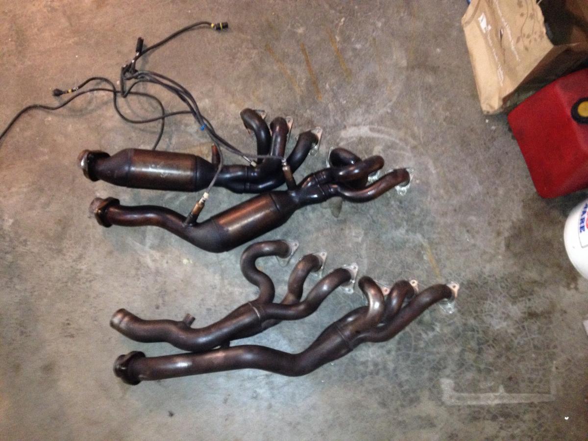

            I pulled the US headers out and installed a set of the Euro headers. Went with Evolve tune and I modified the Euro headers to weld in another set of O2 bungs so I could install the rear sensors.
            First peak at the bundle of snakes.
            Click image for larger version  Name:	Euro headers installed.jpg Views:	0 Size:	55.1 KB ID:	164097
            Here's a picture of the porkers next to the Euro headers ready to go back in.
            Click image for larger version  Name:	Euro vs US.jpg Views:	0 Size:	139.7 KB ID:	164098

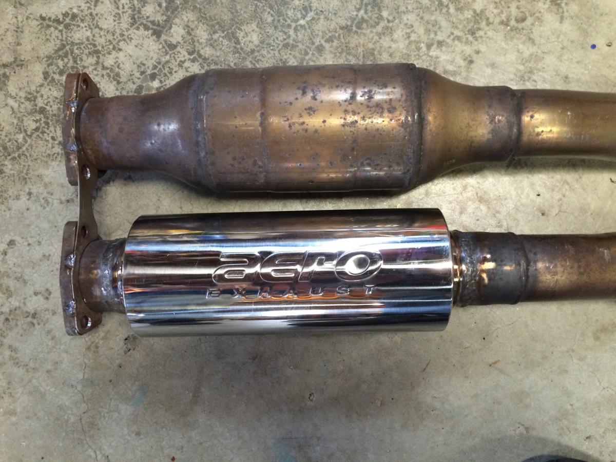

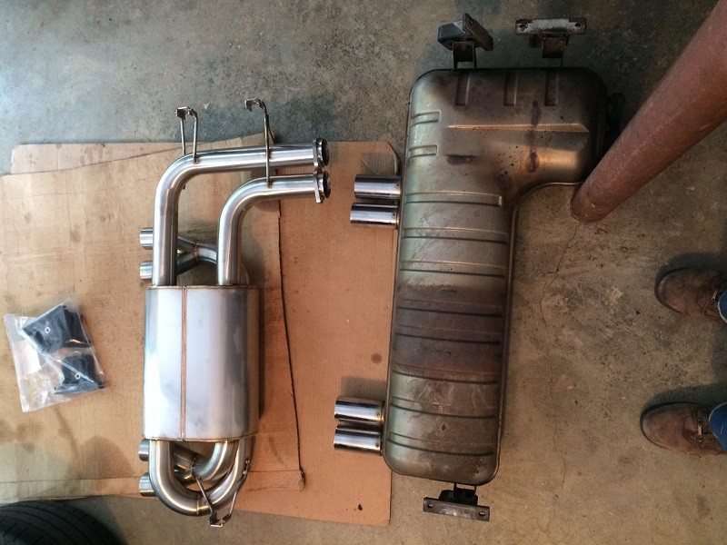

            I stayed with the US section 1 and the car had a ton of rasp, great power - but wow, when combined with the shorter 4.10 gears the car really howls on the highway when you get on it...

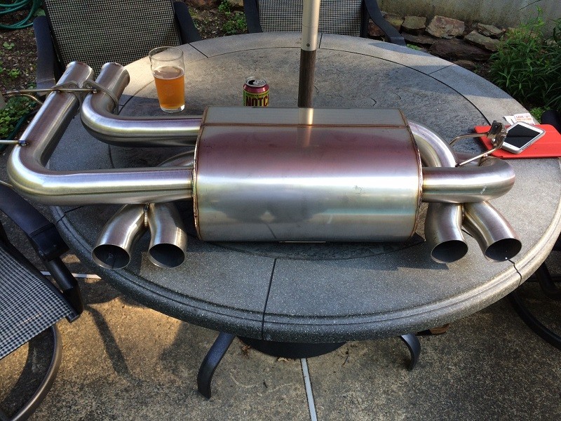

            So for my birthday/fathers day last year I removed the stock muffler (what a beast!) and installed a Status Gruppe Scorza muffler. Sounds glorious and I lost 25# or so on the car!!
            Click image for larger version  Name:	Muffler comparison.jpg Views:	0 Size:	140.7 KB ID:	164099 Click image for larger version  Name:	Muffler.jpg Views:	0 Size:	192.7 KB ID:	164100
            Sound is unreal on the track - love it, but after daily driving it for a year - I'm planning to weld in a set of AR20 resonators and a pair of Magnaflow 200 cell metallic race cats to see if I can tame the rasp and quiet things down a bit.
            One of my buddies welding in the new resonator
Name:	Welding rasp pipe.jpg
            Click image for larger version  Name:	image_34167.jpg Views:	3 Size:	149.9 KB ID:	164101
            Changed my plan - welding in one AR20 resonator in parallel with factory resonator. Longer team will look to go to Supersprint setup, so trying to minimize expenses on this setup.
            The AR20 was a HUGE improvement to the rasp - car no longer sounded like a 2 liter 4 cylinder with a giant muffler....

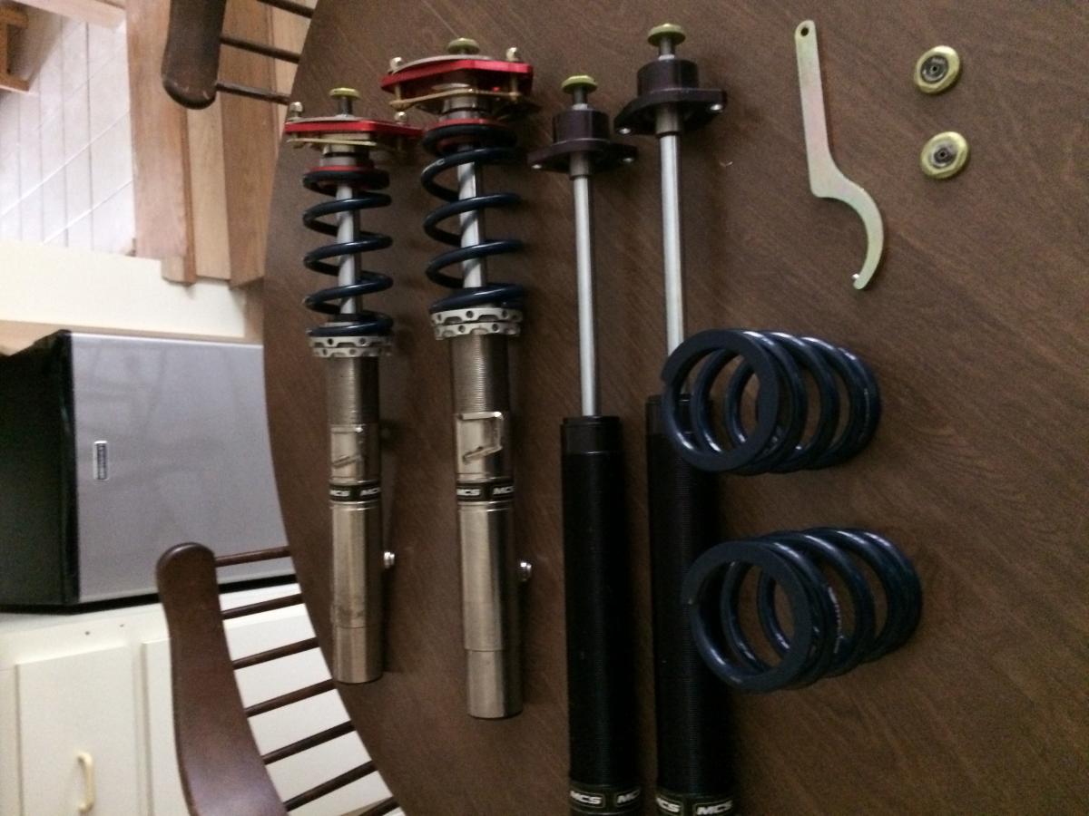

              So my Christmas Present to myself - a set of MCS 2WNR coil overs courtesy of Mr. Wolfe. :-) Can't wait to install!!
              Click image for larger version  Name:	MCS.jpg Views:	0 Size:	110.6 KB ID:	164102
              I plan to get the car up on jack stands this winter and pull rear subframe, inspect the chassis and condition of the TMS strengthening plates. Also install TMS Aluminum rear subframe bushings and while I have the exhaust on the ground - weld in the AR20's and a set of race cats to tone down the rasp and the stink. I'll post some pics as I work through that project.
              Also plan to pull fuel injectors and get those rebuilt - I haven't checked in a while, but previously when I looked I couldn't find any DIY's, so that might also be a project for me to document as well.
              Parts I've accumulated over last couple of months:
              - MCS 2WNR Coilovers w/Vorschlag GTS springs, camber plates & monoball RSMs

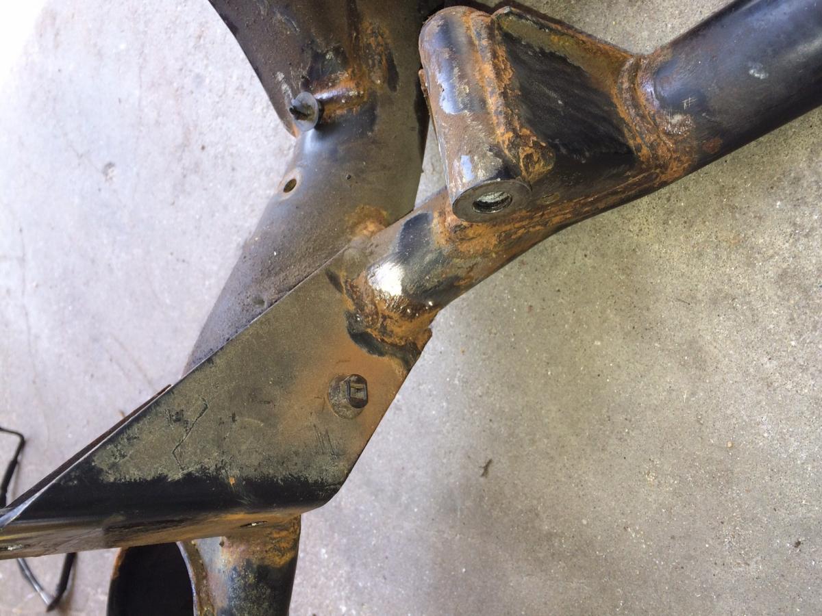

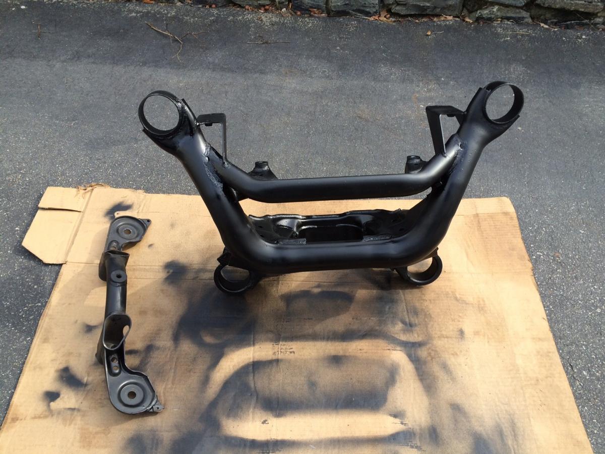

              Here's the grungy rear subframe
              Click image for larger version  Name:	Rusty subframe.jpg Views:	0 Size:	154.4 KB ID:	164103
              Cleaned up and painted with rust encapsulator paint
              Click image for larger version  Name:	Painted subframe.jpg Views:	0 Size:	160.9 KB ID:	164104

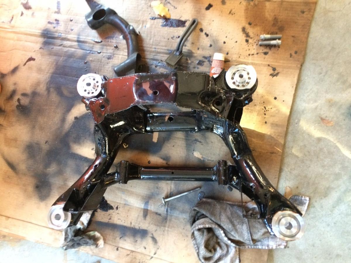

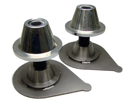

              Decided to go with aluminum rear subframe mounts in attempt to minimize risk to mounting points on the unibody. Getting the old bushing out was a huge PITA - I have a hydraulic press, but nothing to press against to get them out! So, went ballistic and drilled a ton of holes in the old ones and got the BFH out and was able to pound them out. With the help of some friends, we were able to hold the subframe in space, another guy hold the bushing and the 3rd guy actuate the press... Finished product.
Name:	Subframe TMS Al Mounts.jpg

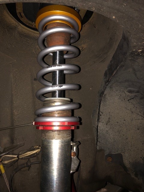

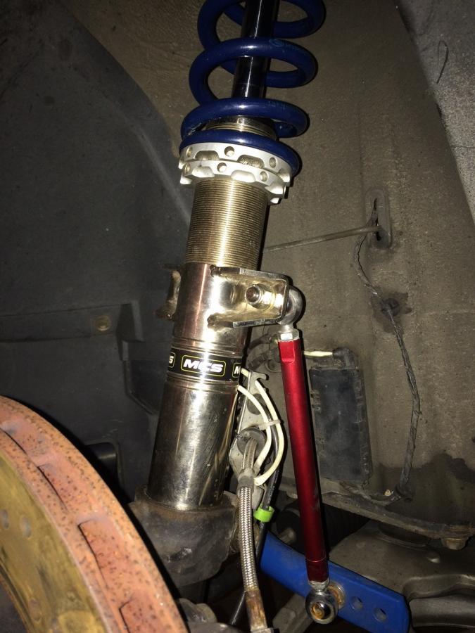

                Well - the MCS shocks and struts were just too track oriented for me and I decided to remove them.
Name:	MCS fronts installed.jpg
                The comfort and damping were fantastic, I was running 550/650# F/R springs if I recall and the ride was great - no complaints there. But, they were very noisy... I sent them back to MCS for rebuild and upgrade to latest valving, but not a lot of improvement... Could hear a lot of "clicking" of the valves opening and closing in the shocks, so off they went. I have heard that the 2 way non-remote are the noisiest and the 1 way are supposed to be quiet - but I installed a set of TCK DA coil overs instead.
Name:	300# flat ride.jpg
                I ran the konis for several years with 450# front and 550# rears, but always felt the rear of the car was harsh on the street. I worked near Boston, so the roads were in terrible shape... So after reading about flat ride on the Forum, I changed the fronts to 300# springs and couldn't be happier - great ride and the harshness in the back is gone - even though I didn't change the rear springs!

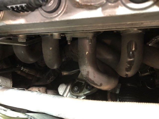

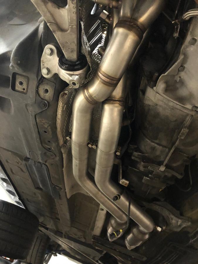

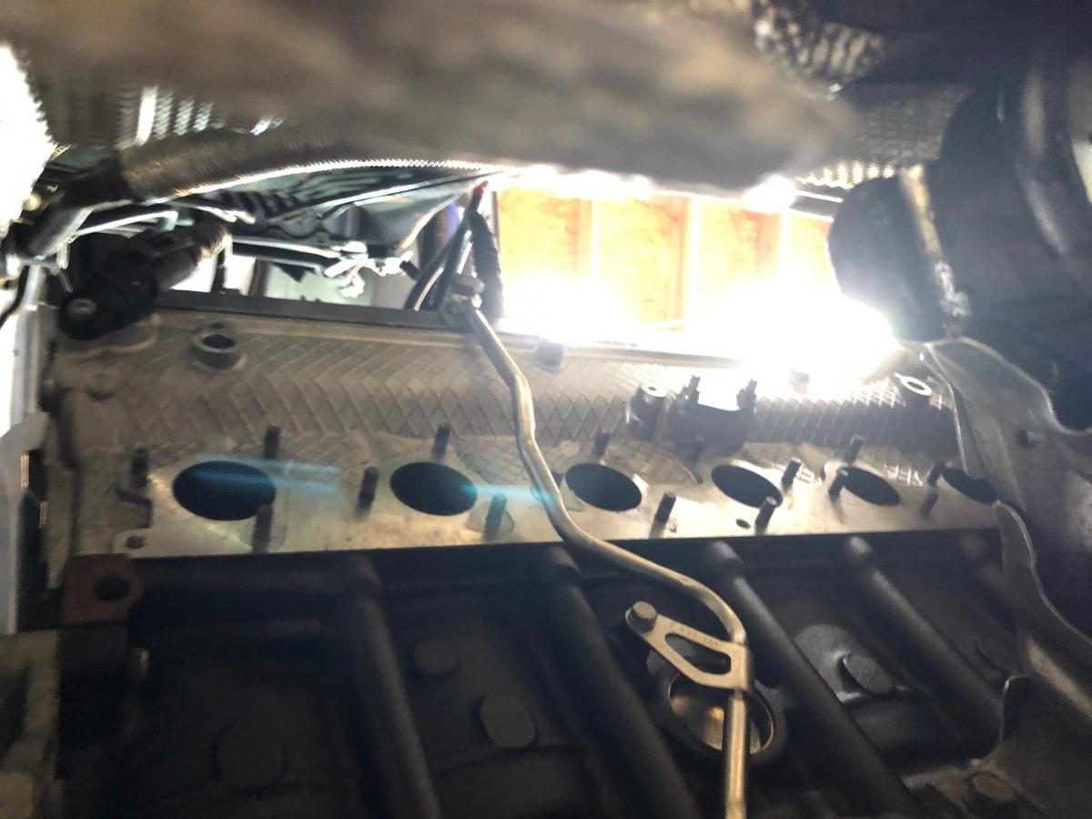

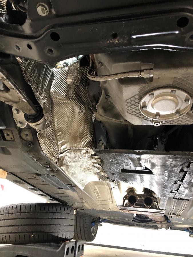

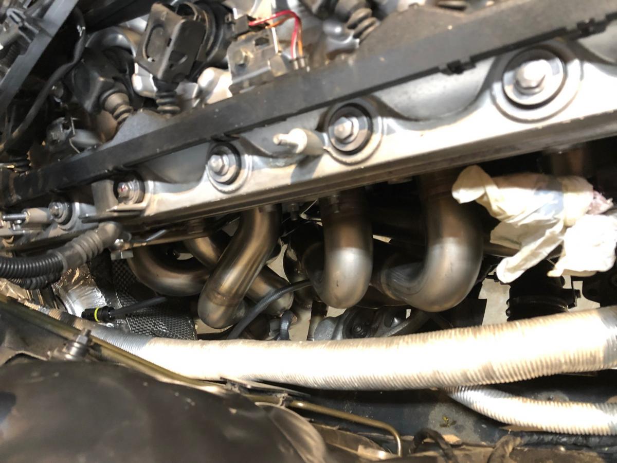

                  The stink of running catless was getting to me and I moved to a new state and needed to get through inspections - so I decided to bite the bullet and install a set of 63.5mm Supersprint headers and their high flow cats.
                  Here's a shot underneath with the Euro headers out - everything looks good and seems to be plenty of room...

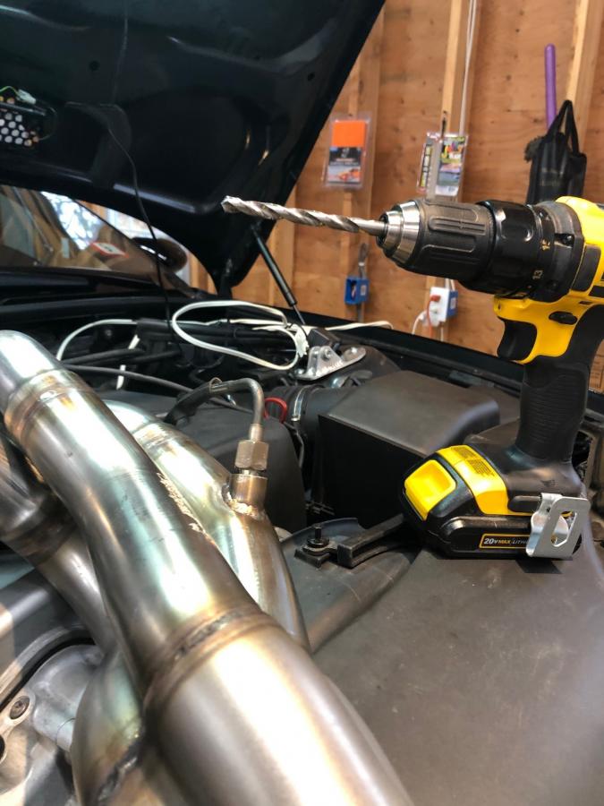

                  I managed to get the headers in and then realized I do have to install the longer studs... I had bought them but the old ones looked great - so hoping to skip a step, but just not enough exposed threads, so I double nutted the studs and backed out the old ones and installed the new ones. Fortunately, everything came out and went in OK. I used a home brew penetrating oil - 50/50 mix of ATF and Acetone. I bought a gun micro oiler with a hollow tube tip and it works wonders.
                  A "plus" during this exercise was I trial fitted my O2 sensors and EGT probe to see what I was up against with the cats in Section 1. I found that SS had forgot to drill out the bung for the EGT sensor - so I had time to rework that before the "final" install.
Name:	SS EGT rework.jpg
                  Here's the new studs in
                  Click image for larger version  Name:	Exhaust studs.jpg Views:	39 Size:	91.6 KB ID:	164113

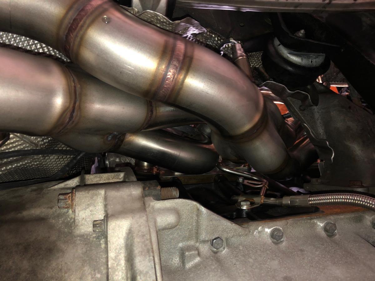

                  Next - reinstall the headers! I could get them in place myself, but the primaries are so large a diameter, wrench access is awful and I had to enlist a helper with small hands to get some of the nuts on the studs, my hands were just too big. Tightening them was a huge PITA - had to get very creative with wrenches and on 2 of the nuts I had to suspend a wrench from above with a magnet and then tighten the nut one 6th of a turn and then re-index the wrench and repeat... 45 minutes to get one nut on - excruciating! But...
                  Click image for larger version  Name:	Installed SS.jpg Views:	41 Size:	120.0 KB ID:	164114
                  A tight fit at the transition!
                  Click image for larger version  Name:	SS tight fit.jpg Views:	41 Size:	120.5 KB ID:	164116
                  And the view from below - I ended up partially disassembling the EGT harness to the DEC and then ran the lines going to the rear O2 sensors down along the fuel lines and put the harness connectors near the fuel filter underneath the metal protective shield. I just couldn't make it work from the right side of the car no matter what I tried...
                  Click image for larger version  Name:	image_34272.jpg Views:	3 Size:	75.0 KB ID:	164499
                  '01 M3, JB/IR, SS, TCK DA, Apex, TMS CSL, HTE, 4:10 gears - original owner

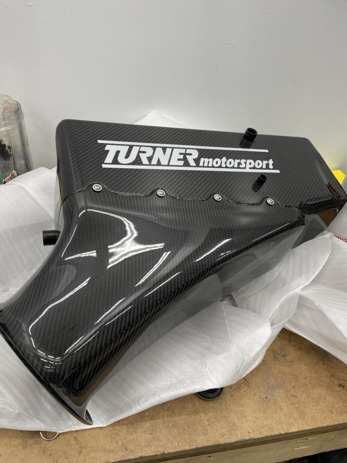

                        Getting ready to install TMS CSL intake, full Vanos rebuild/lockdown & set valve clearances.
                        Here’s the expensive piece - packaging was fantastic - can’t wait for install.

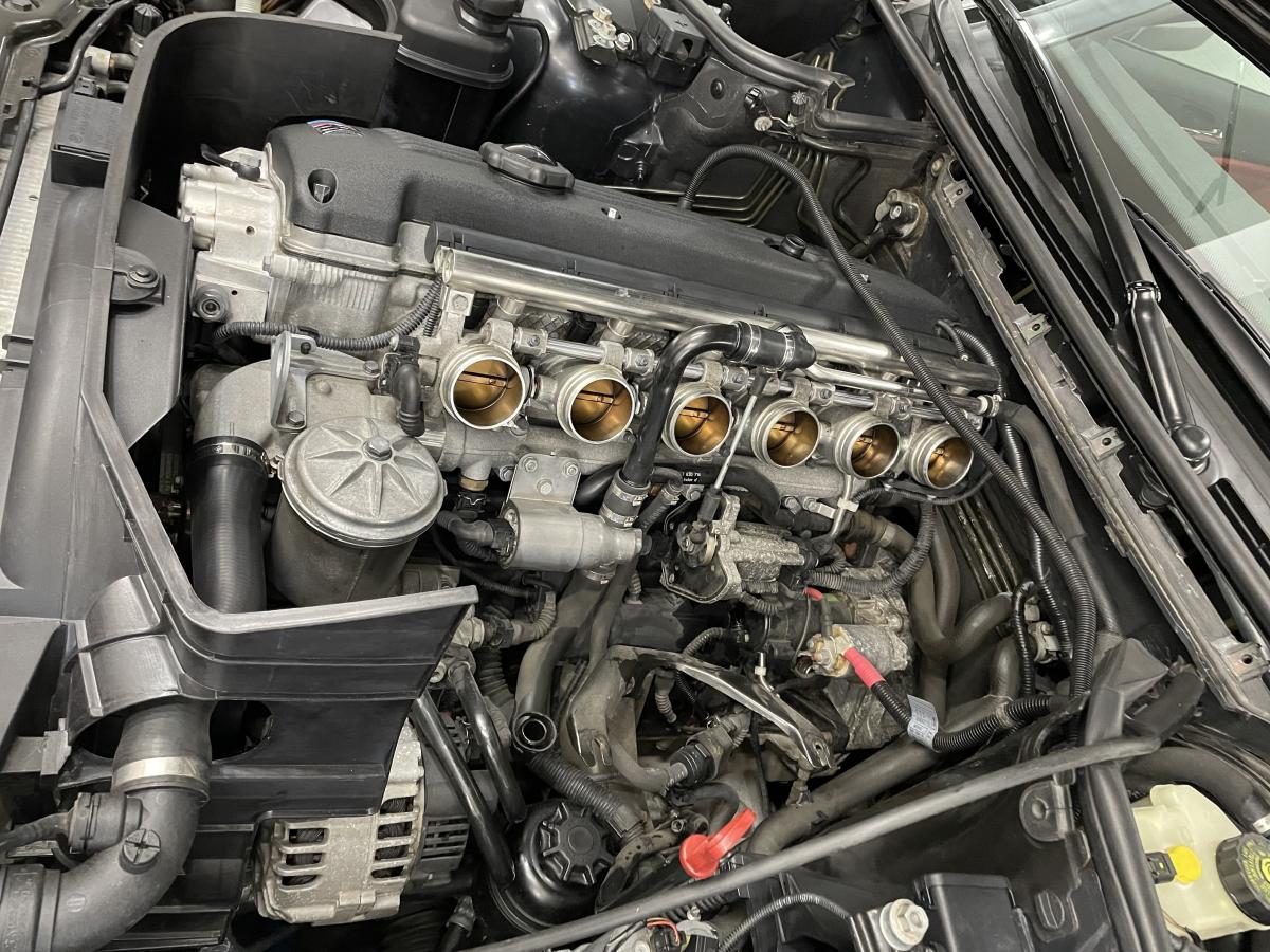

                            Got the old airbox out - the oil drain back line was the only real challenge and once I had the box off the ITB’s, I was able to pop it off with big flathead screwdriver. Everything looks great underneath.

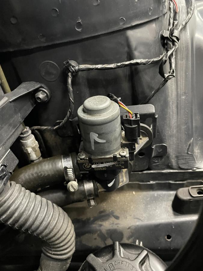

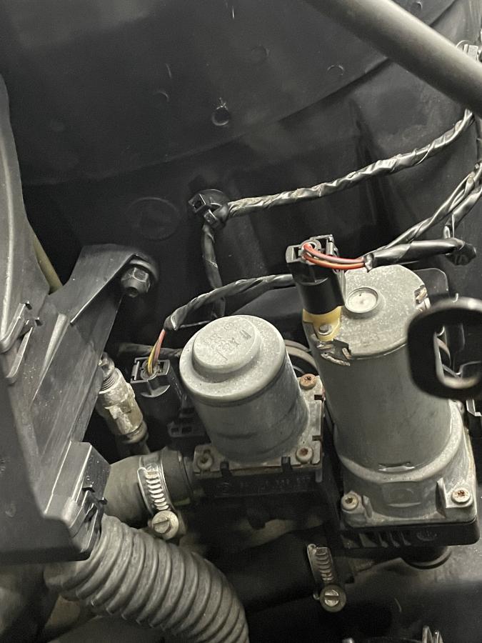

                              I took the opportunity to install a different aux water pump that I’ve seen others use to free up real estate in the area.
                              Here's the original two pump setup
                              And here's the single pump setup which eliminates the taller pump
