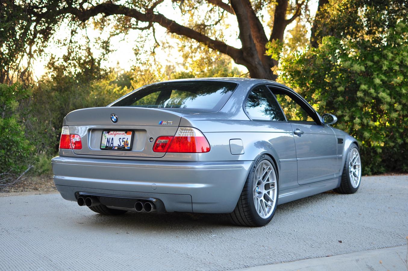

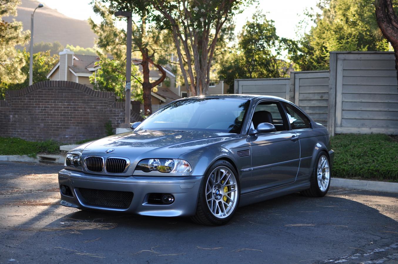

    Current look:
    Click image for larger version  Name:	apexshoot239.jpg Views:	907 Size:	208.6 KB ID:	189576
    Click image for larger version  Name:	lowsunlang28.jpg Views:	358 Size:	235.2 KB ID:	189577
