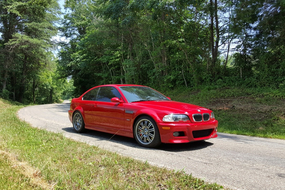

    I purchased this car in 2014 from a knowledgeable enthusiast in the Chicago suburbs. I talked on the phone with him about the car for hours and he provided tons of detailed pictures and information on the car., which eased my qualms of traveling so far to purchase a used car. The car had driven less than 30k miles, and was optioned similar to how I would have ordered it from the factory:
    Imola Red
    Black Nappa leather
    Power heated seats
    Moonroof
    Harman-Kardon Sound System
    Xenon headlights
    18" wheels
    SMG
    11/2002 production (MK60)
    I wasn't necessarily looking for a SMG car, but also wasn't against it. Mostly I was just looking for a super clean, low mileage M3. I'd sworn off buying a modified car, but this one had some quality bolt-ons:
    TC Kline DA coilovers with 550F/600R springs
    TC Kline adjustable rear control arms
    Brembo 355mm front brakes
    Dinan 27mm front sway bar
    Dinan front and rear strut tower braces
    Dinan muffler
    Dinan tune
    retrofitted OEM navigation
    coded with things like M-Track mode, reverse mirror memory, headlights

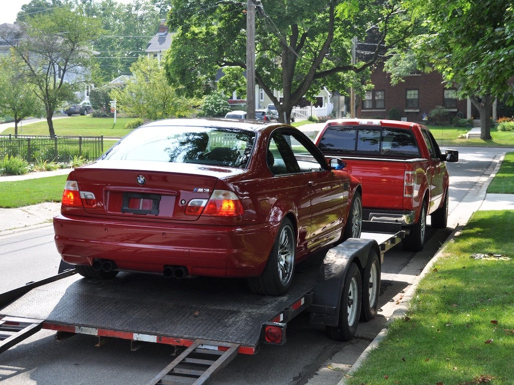

    I was actually in Fort Worth, Texas when I found the car. I happened to have an empty car trailer with me, so I made the short detour to Chicago to purchase the car on my way back to Florida.

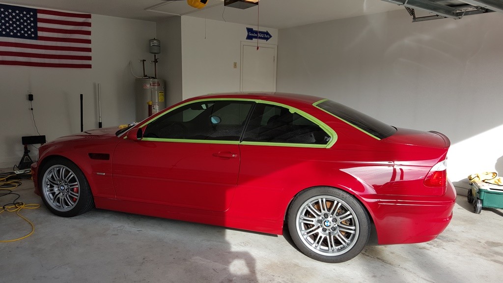

    I drove the car about two August days before making an appointment to have the windows tinted with ceramic film.

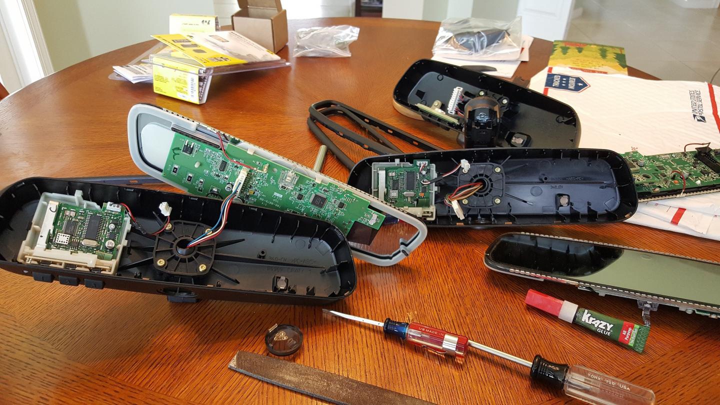

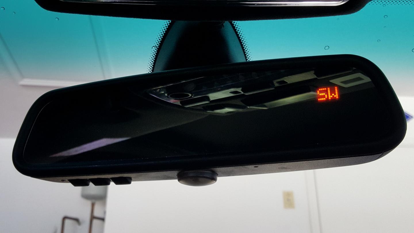

      The PPI noted that the rearview mirror was leaking, so I wanted to address that before any damage was done to the console. Additionally, the factory Homelink module appeared to be on the fritz as I was having issues programming it to my garage door opener. I read that mirrors from some newer BMWs are interchangeable with mine and also have a digital compass and Homelink built in. I found a mirror from a 2011 328i with autodim, compass, Homelink and the smaller gray "clown nose" for $50. While I like the looks of the stock oval mirror, this mirror is more functional and cheaper than having my old mirror repaired, while also getting me a functional Homelink module. Installation was simple plug-and-play.
      A couple years later, I replaced my garage door opener with a newer Chamberlain belt-drive DC unit (yellow antenna wire), and the older Homelink was no longer compatible. I couldn't find a mirror with compatible Homelink and all of the same functionality of my current mirror, so I purchased a mirror from a 2011 535i and swapped the Homelink module into my mirror. Strange that 2011 5 Series got the the newer Homelink, but 2011 3 Series got the older one.

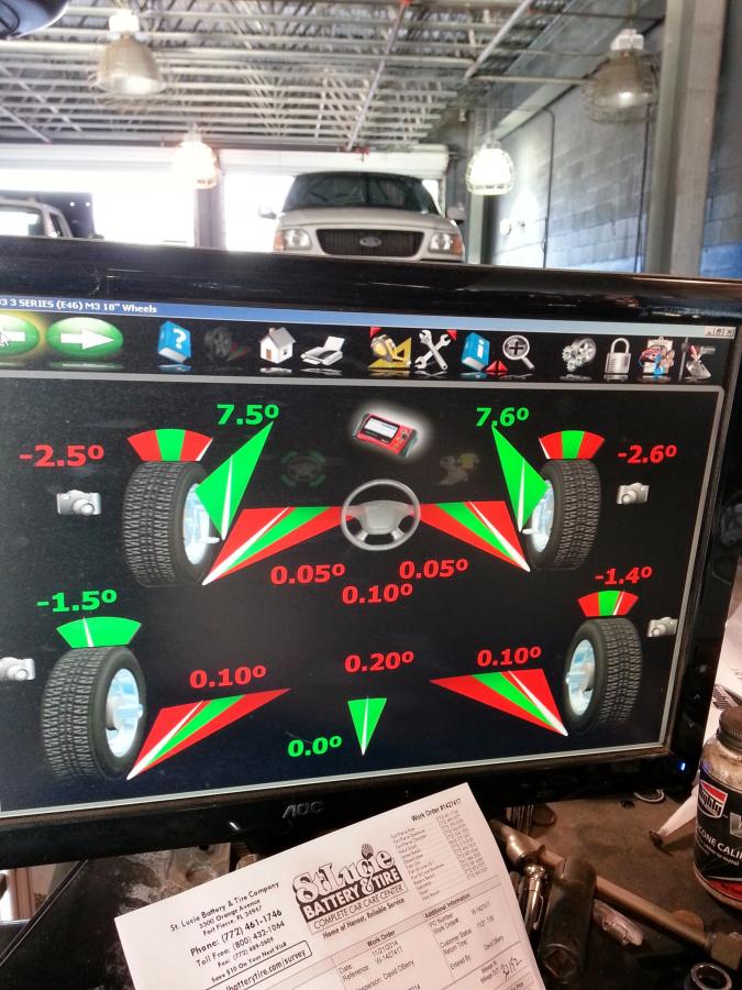

          Lowered the car a little and got it aligned, then put on a set of new Michelin PSS. The ride height was set to 14"F and 13.25"R.

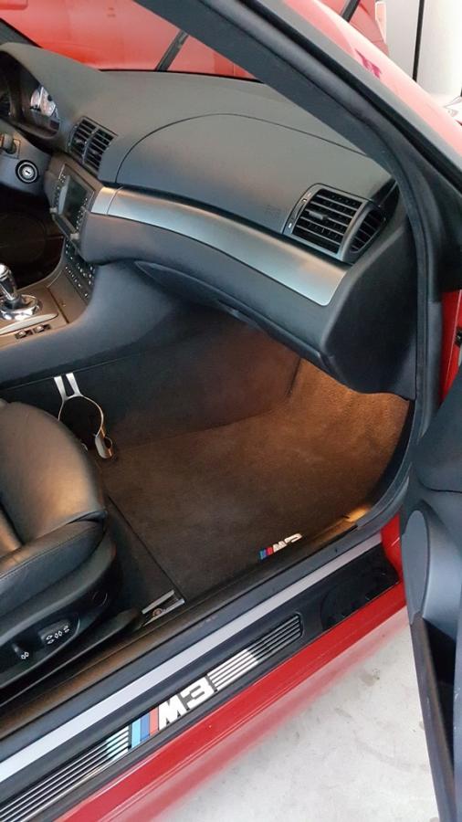

          New floormats

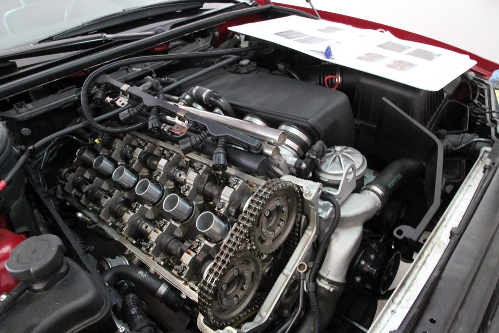

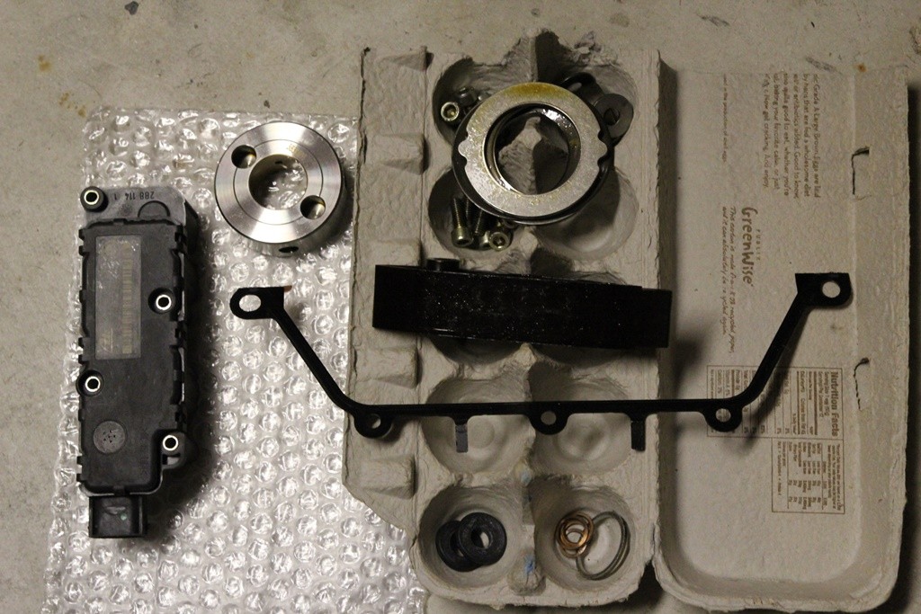

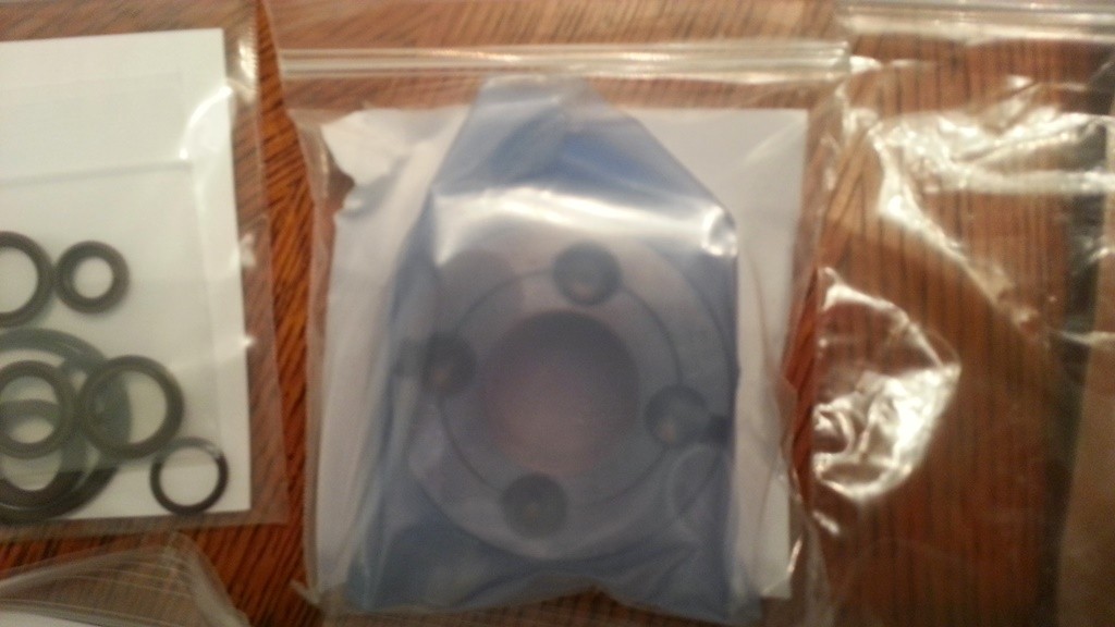

          Started experiencing VANOS solenoid failures, so I gave the car the full Beisan treatment
          Click image for larger version  Name:	20150330_204605.jpg Views:	0 Size:	96.2 KB ID:	179519
          Click image for larger version  Name:	394.jpg Views:	0 Size:	199.8 KB ID:	179521
          Click image for larger version  Name:	016.jpg Views:	0 Size:	199.1 KB ID:	179520

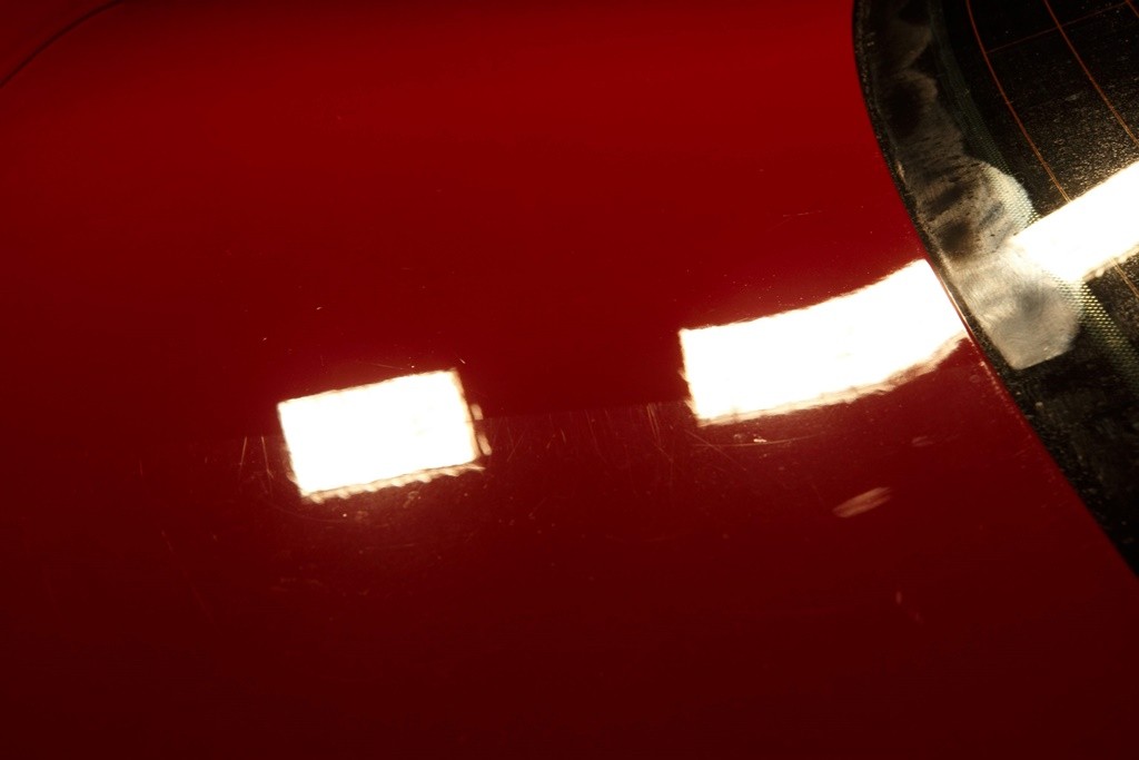

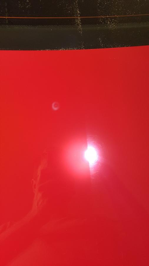

            Performed a paint correction

            I got a little carried away with the Dr. Colorchip, but in the end, I was super impressed with how it came out.

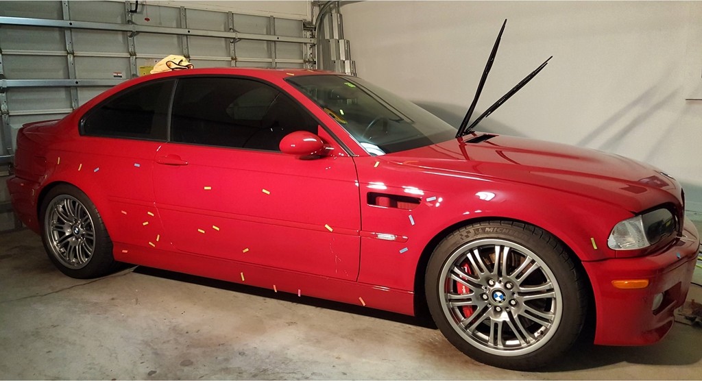

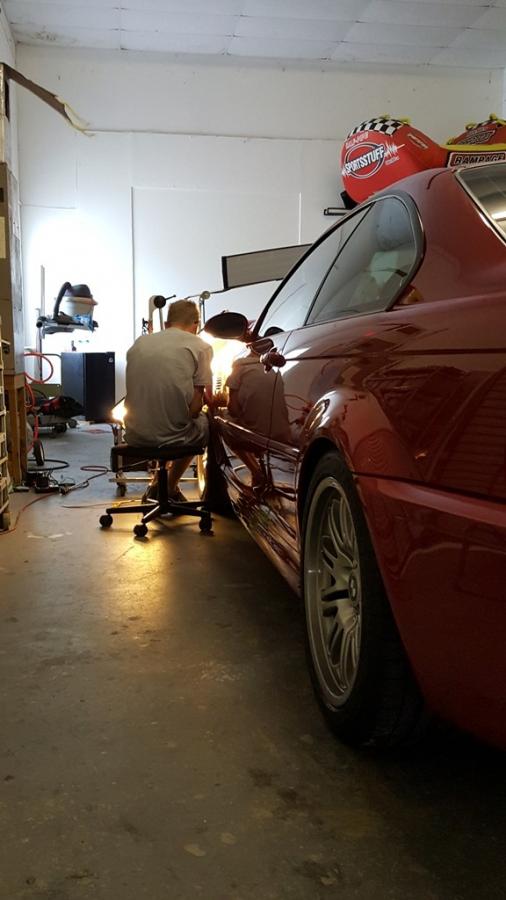

            Had some minor dents removed by the local paintless dent repair guy

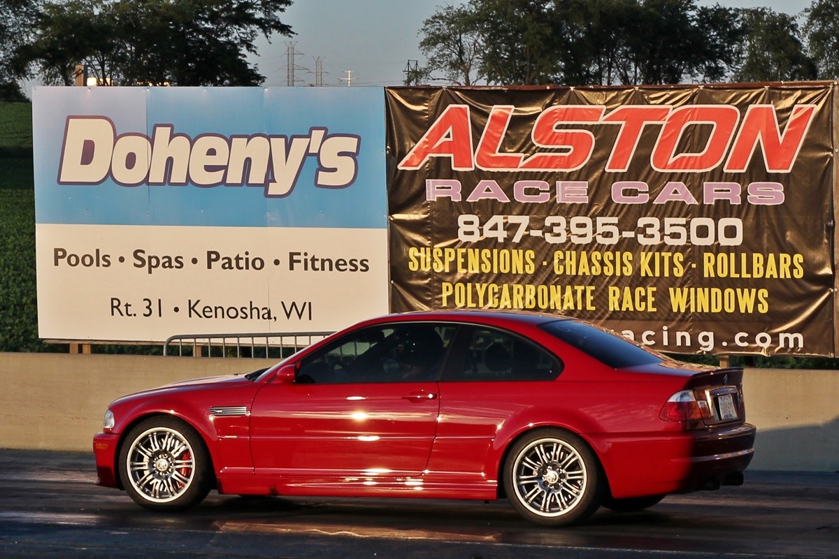

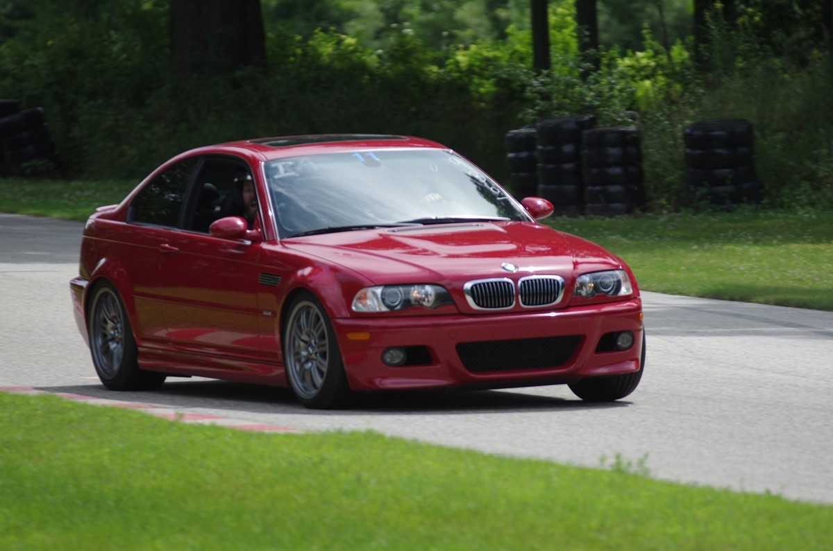

              Did a track day at Blackhawk Farms and made a few passes at Great Lakes Dragway. My best time was 13.7 @103mph.
                Looks great - which products and pads did you use?
                  Been a while, but I think I used orange and then white? pads with Meguiars 105 and 205. I have a Flex 3401. I probably coated it with Collinite 845.
