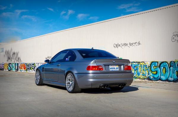

    2006 BMW E46 M3 Competition Pkg.
    Exhaust:
    - Supersprint Oversized 2.5" Stepped Headers
    - Supersprint Oversized 2.5" Catted Section 1
    - Genuine BMW Resonated H-Pipe Section 2
    - Supersprint Sport Muffler (Gen 2) Section 3
    Suspension:
    - KW V3 Coilovers
    - Ground Control Camber Plates
    - Rogue Engineering
    Rear Shock Mounts
    - OE Front Control Arm Bushings
    - SDW Monoball Rear Trailing Arm Bushings
    - CMP Solid Subframe Bushings
    - CMP Solid Diff Bushings
    Transmission:
    - 6 Speed Manual

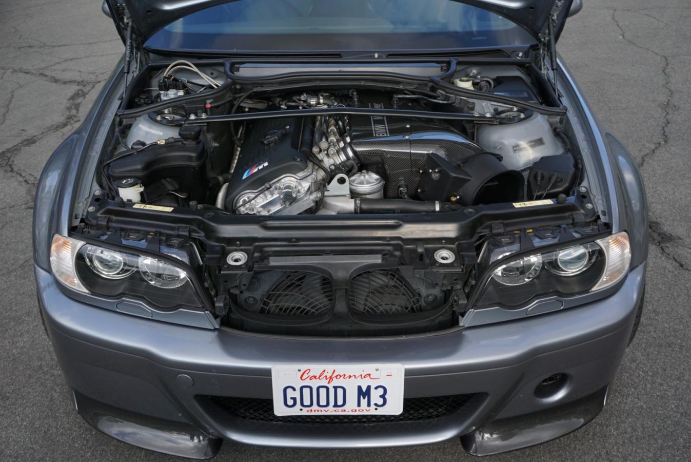

    Engine:
    - NA 3.2L Inline 6 S54B32
    - Karbonius CSL Airbox
    - Genuine BMW CSL Ducting
    - Genuine BMW CSL Air Filter
    - Genuine BMW CSL Intake Flap
    - Alpha-N tune by Paul-Claude
    Exterior:

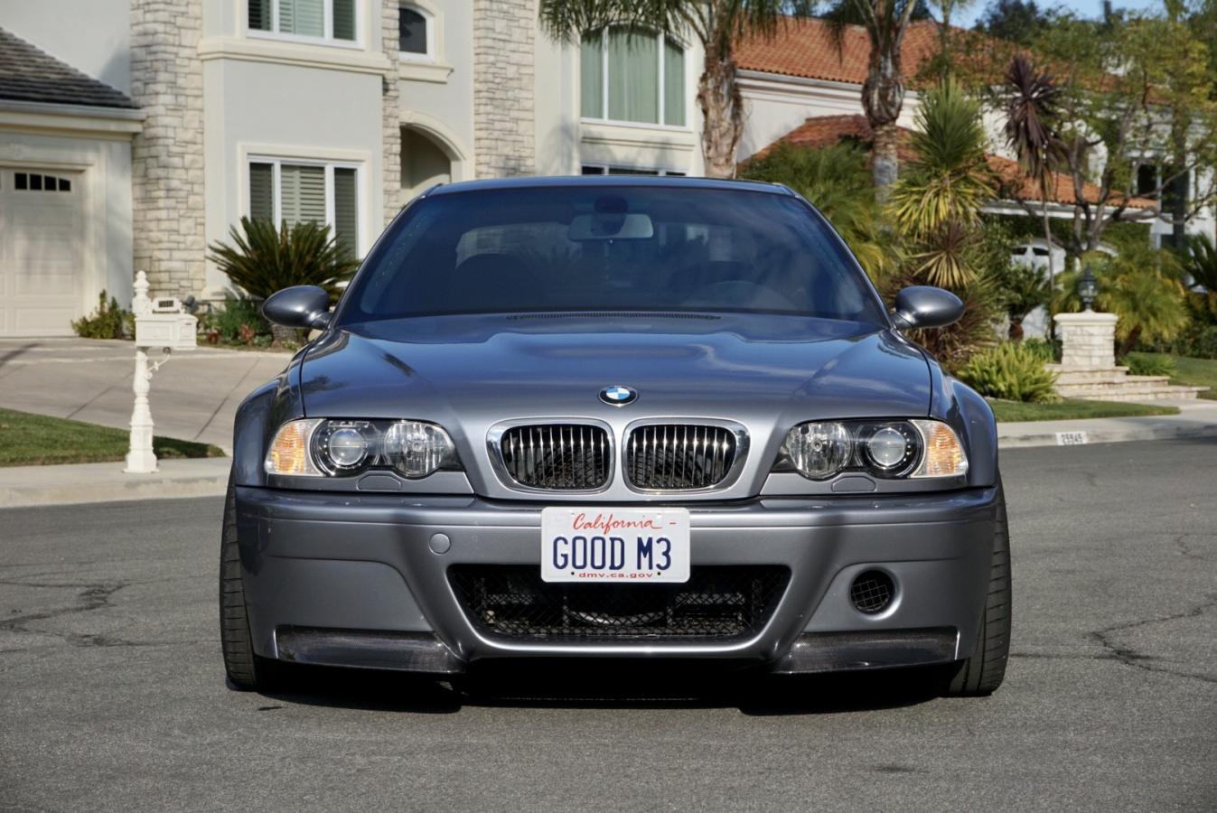

    - Mile End Composites CSL Diffuser
    - Vorsteiner CSL Front Bumper
    - Genuine BMW CSL Wheels

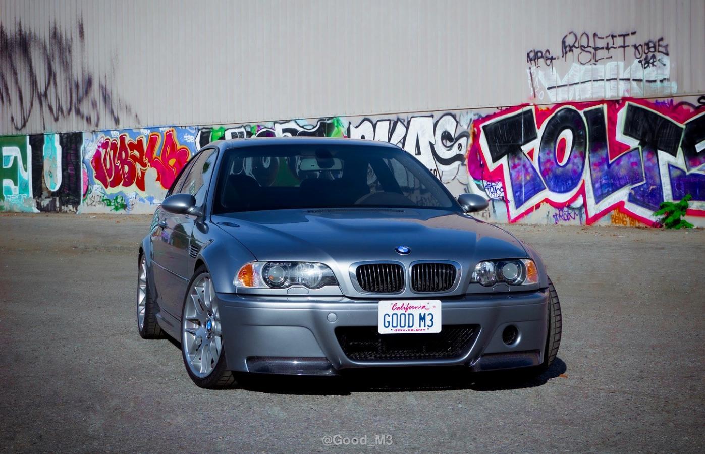

    Since my build thread on m3forum.net was lost along with many other members journals, I will post pictures in chronological order from the start. The first modification began with the exhaust!
    Supersprint V1 2.5" Stepped Headers, Supersprint V1 2.5" Catted Section 1, Stock Section 2 and my Supersprint Sport Muffler from my previous E46 M3.

      Within the week I had purchased a Karbonius CSL Airbox (the carbon fiber trumpet version) along with a Genuine BMW snorkle.
