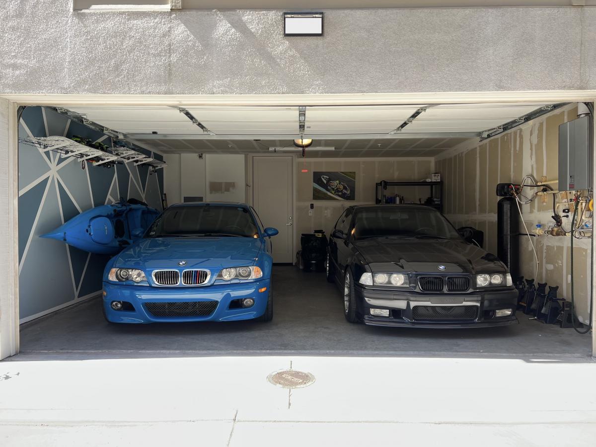

    Taking delivery:
    Click image for larger version  Name:	IMG_3942.jpg Views:	5 Size:	129.7 KB ID:	244035
    Click image for larger version  Name:	IMG_3940.jpg Views:	0 Size:	194.8 KB ID:	244038
    Click image for larger version  Name:	IMG_3951.jpg Views:	3 Size:	143.1 KB ID:	244033​

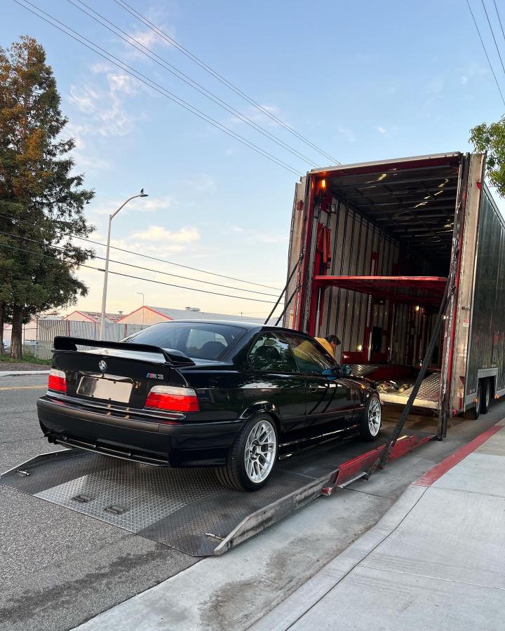

      I don't have the time or space for two fun cars, so the e36 had to go. I purchased this in rough shape around 2011, and slowly made a clean example out of it. It went back to the original/first owner making for a great story.
      Click image for larger version  Name:	13999BE4-8E2D-41F7-903A-955ED9F2737D.jpg Views:	0 Size:	121.7 KB ID:	244045
      Click image for larger version  Name:	F1C67CC7-57B0-4F79-BCCF-86A570B4DBD6.jpg Views:	0 Size:	120.7 KB ID:	244046​​

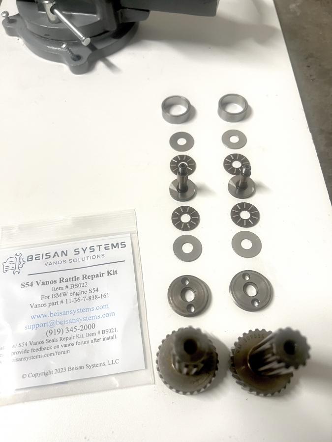

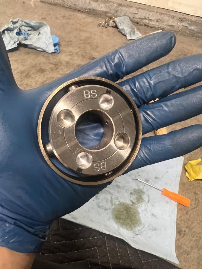

        On to the vanos...

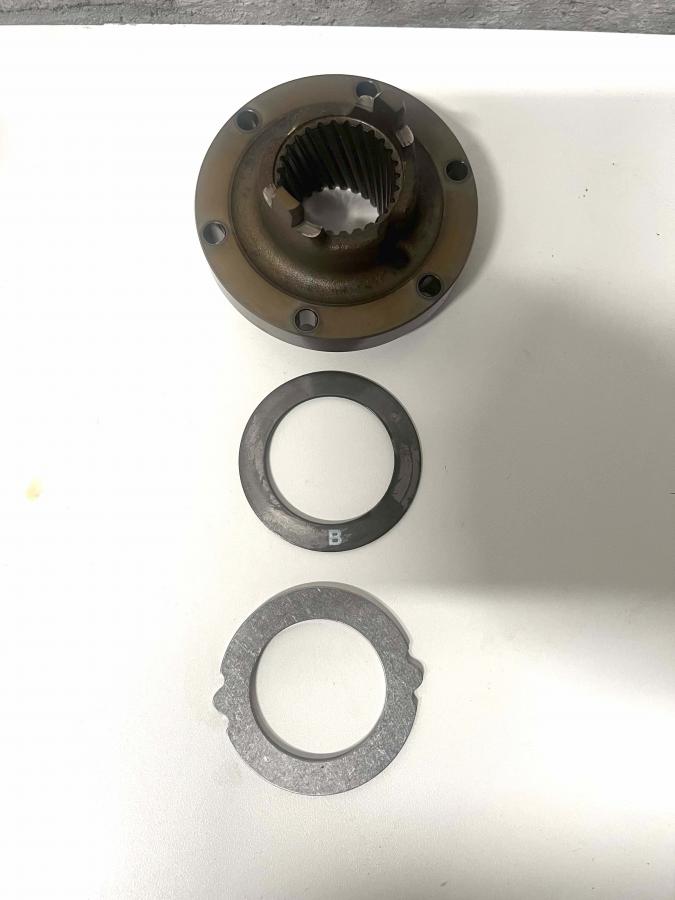

        Breakdown of parts replaced:
        -Beisan oil pump disc (my hub tabs were all good)
        -Besians coil pack
        -Beisans rattle kit
        -Beisan seals
        -OE s62 diaphrams springs
        -OE cam bolts with loctice
        -OE timing chain guide
        New bolts threadlocked. Don't worry I had towels below during the process =)
        Click image for larger version  Name:	IMG_4734.jpg Views:	0 Size:	110.9 KB ID:	244051
        Click image for larger version  Name:	IMG_4719.jpg Views:	0 Size:	86.9 KB ID:	244054​
        Click image for larger version  Name:	IMG_4808.jpg Views:	0 Size:	42.0 KB ID:	244052
        Click image for larger version  Name:	IMG_4803.jpg Views:	0 Size:	51.6 KB ID:	244053​

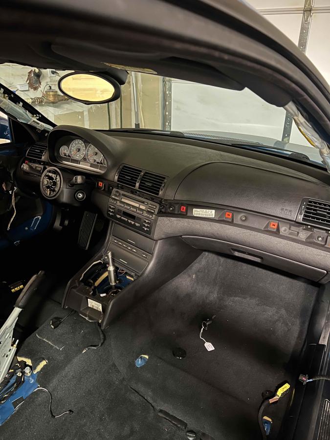

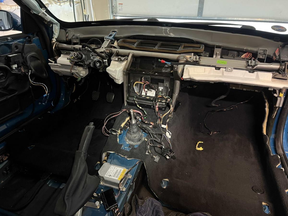

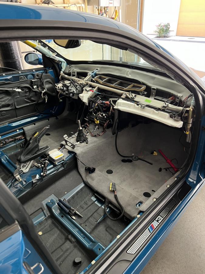

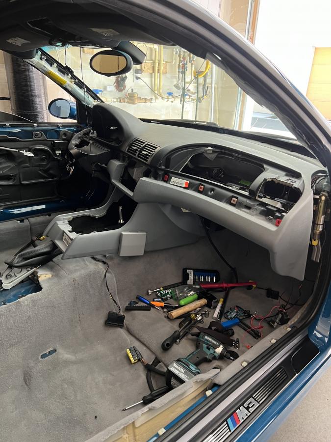

            The next build stage started with getting rid of the grey interior. After lots of searching, I was extremely lucky to come across a set of seats and door panels in speed cloth local to me. Sourcing the rest of the bits was a pain but all is in hand now.
            More on that later, but first some dismantling fun.
            Click image for larger version  Name:	IMG_4902.jpg Views:	0 Size:	150.7 KB ID:	247086​
            Getting the dash out was relatively hassle-free to my surprise.
            Click image for larger version  Name:	IMG_4959.jpg Views:	0 Size:	104.6 KB ID:	247087

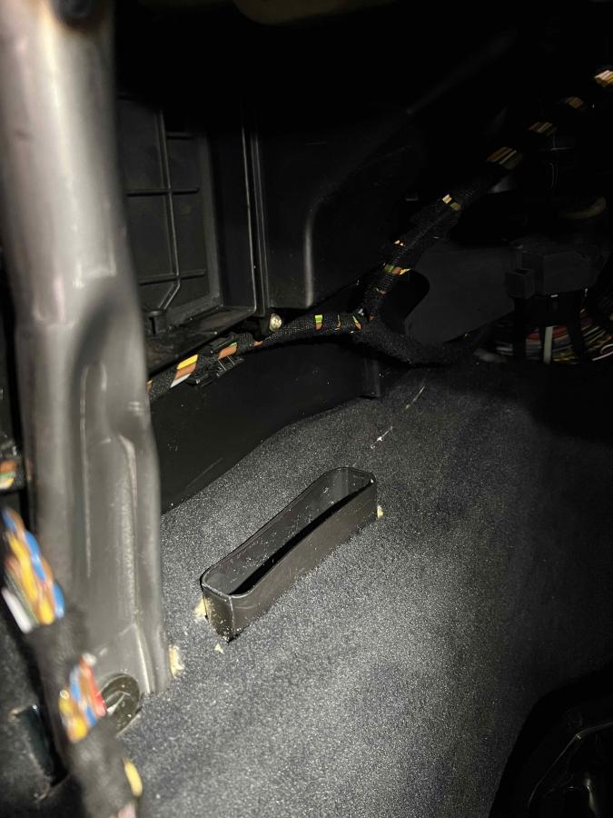

            The hardest part was to get the front carpet out of the heater hvac piping. This basically requires a little cutting unless you want to get crazy. ​
            Click image for larger version  Name:	IMG_4960.jpg Views:	0 Size:	117.8 KB ID:	247088
            Fully stripped. To my satisfaction, the removal unveiled all mint flooring.
            Click image for larger version  Name:	IMG_5028.jpg Views:	0 Size:	109.4 KB ID:	247090​

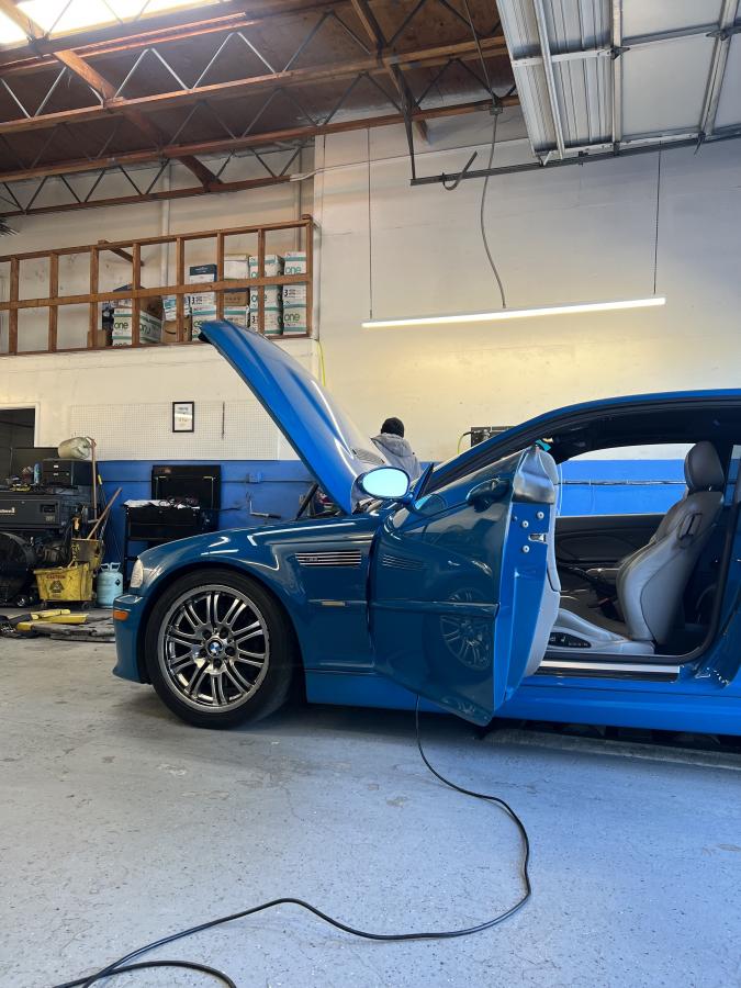

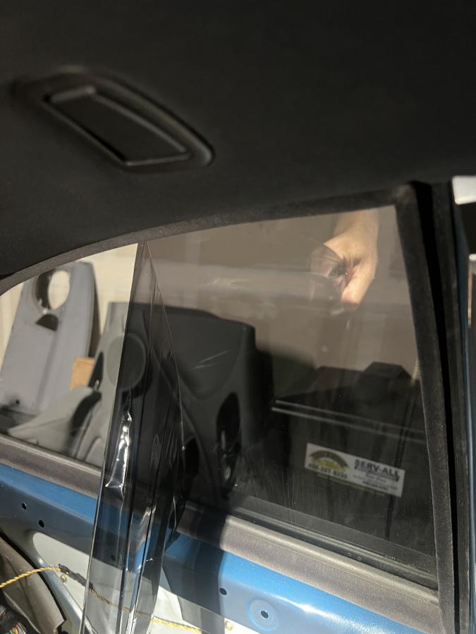

            Last step was to strip the existing tint which was much to dark for my liking. I'll get some lighter tint done so the interior will have some UV protection.

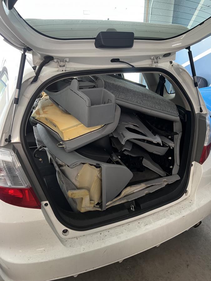

            Off to storage...not sure if the bits are worth anything but if anyone needs anything you know where to find me.
            Click image for larger version  Name:	IMG_5287.jpg Views:	0 Size:	83.9 KB ID:	247091​

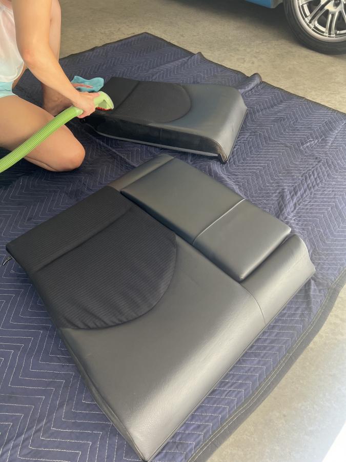

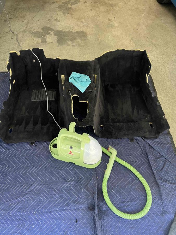

              On to starting the installation of the black interior. First step was to give everything a deep cleaning.
              Protip: get you a girlfriend with a steam cleaner.

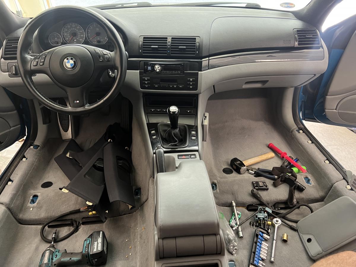

              Next I worked through the dashboard, glovebox, radio, storage trays, and other trim pieces. All the little things take time, especially when you want to replace worn or outdated parts with new or upgraded.
              I'll give a sneak peak of the current state of progress as it actually sits today, and go into details as I pick back up this stage.
              Click image for larger version  Name:	IMG_5339.jpg Views:	0 Size:	91.6 KB ID:	247102
              I decided to halt the progress on the interior makeover as I came to a realization. The next big job will be around the rear suspension overhaul. This involves
              Vince gussets and Puretech x-brace. It made no sense to install everything when I had a messy job involving the cabin/under the rear seats to do shortly after.
              So on to the Quickjacks we go and I started removing stuff...to be continued in the next post

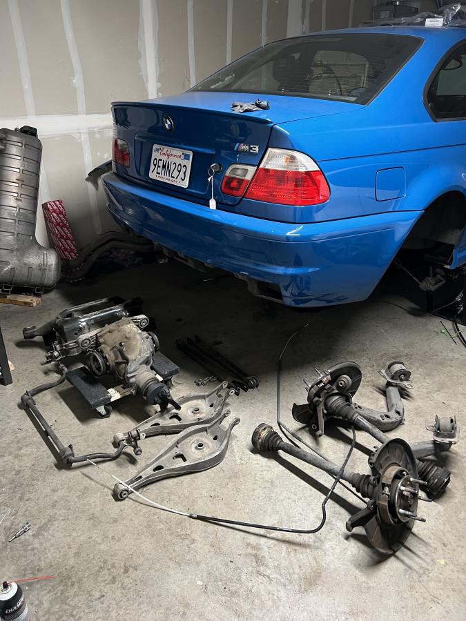

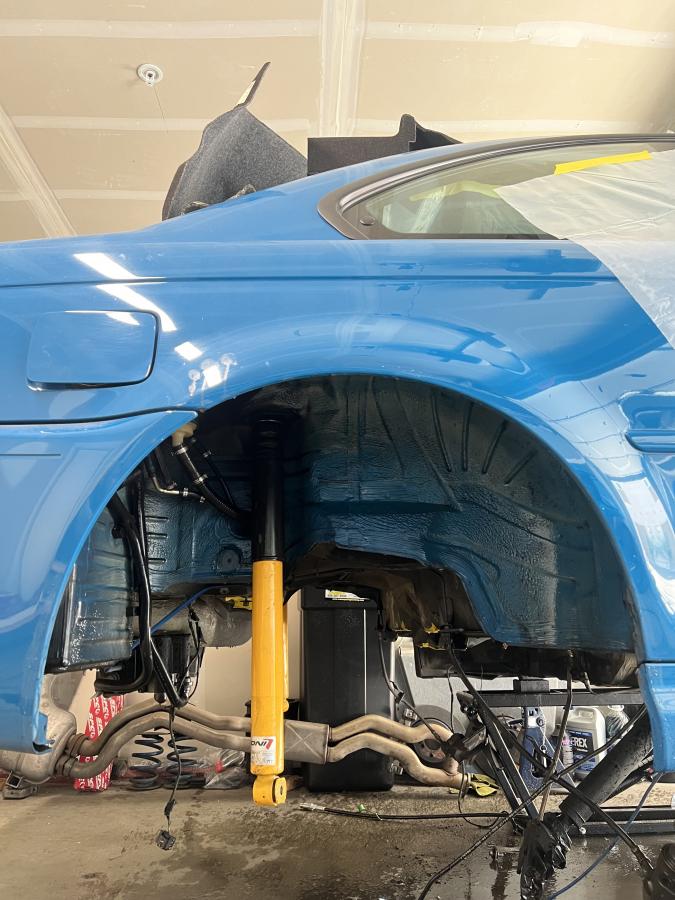

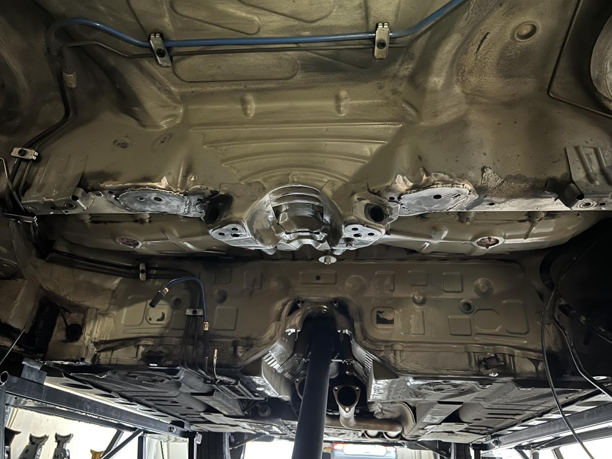

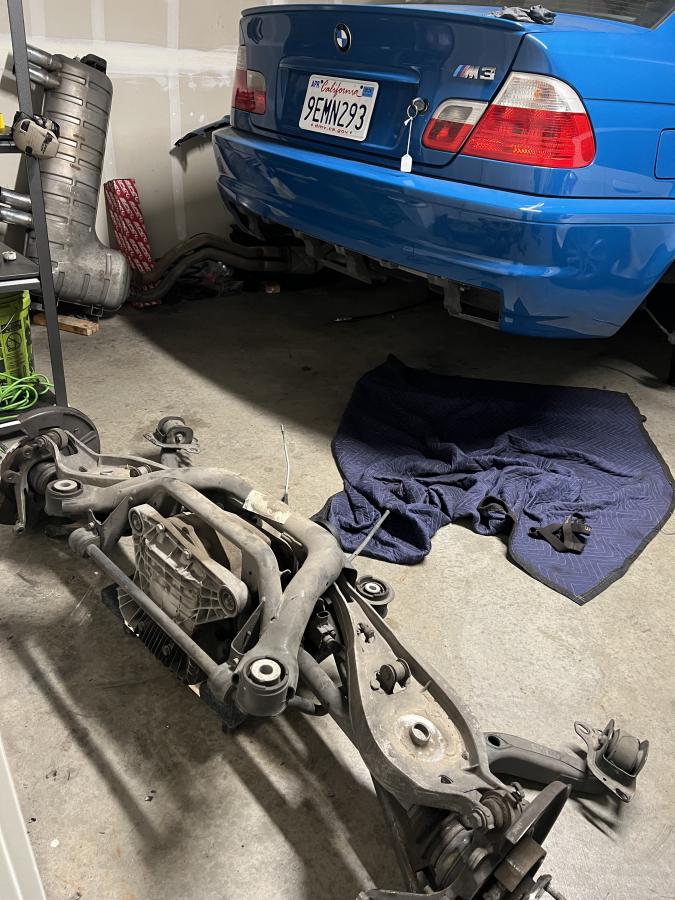

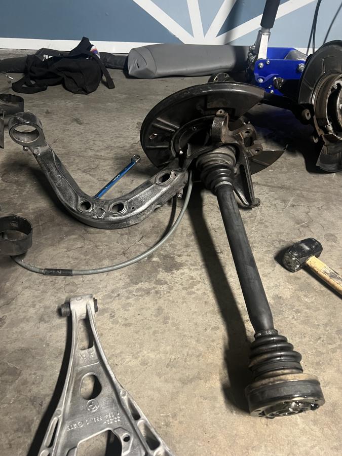

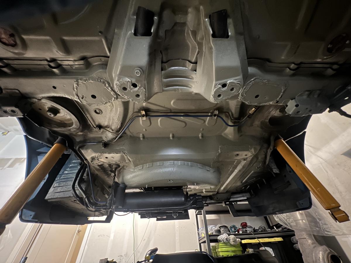

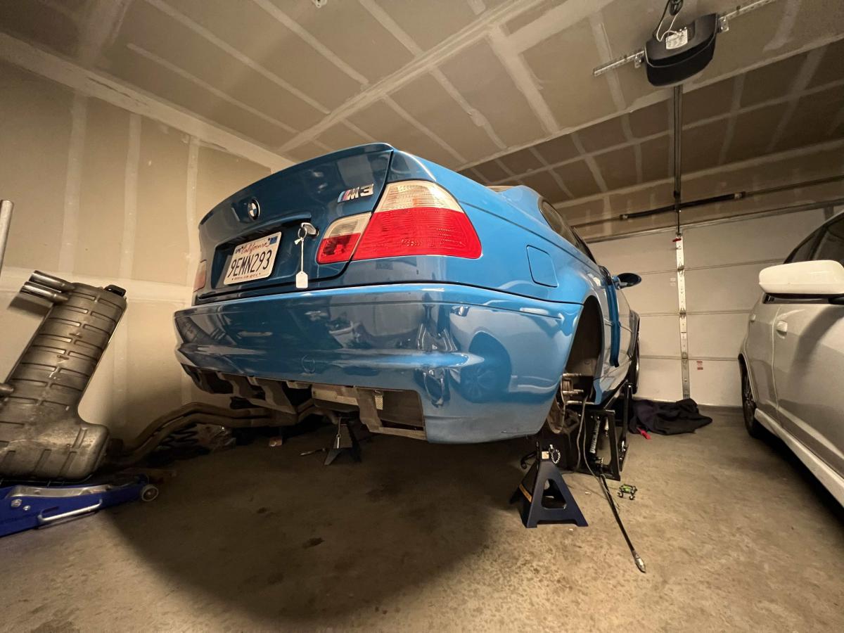

                    Moving on, I started dropping stuff...
                    Click image for larger version  Name:	IMG_5410.jpg Views:	0 Size:	112.4 KB ID:	250072​
                    Pretty easy process honestly, just forgot to completely pull out the e-brake lines so I bent those into needing replacement.
                    As with the rest of the car, super good bones, just soo much dirt accumulated over the years.​
                    Click image for larger version  Name:	IMG_5425.jpg Views:	0 Size:	106.6 KB ID:	250071

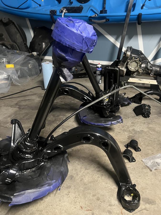

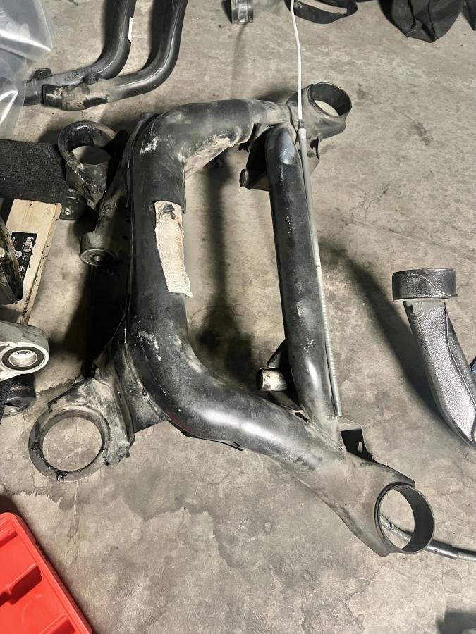

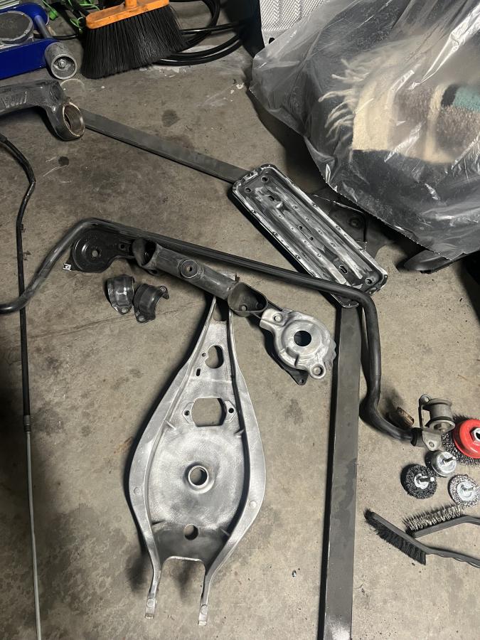

                    Original plans were to clean all the parts, replace all bushings, and send it all back up there, but after seeing this post from BMWahba on his undercarriage resto I couldn't unsee it. So I got to work...
                    First I started removing all bushings and prepping parts for paint...lots of work and not fun.
                    The subframe bushings came out easy with some heat and a wack.
                    Click image for larger version  Name:	IMG_5652.jpg Views:	0 Size:	114.3 KB ID:	250074
                    It was nice having proper tools around.
                    Click image for larger version  Name:	IMG_5579.jpg Views:	0 Size:	65.3 KB ID:	250075
                    I sanded things to a reasonable degree, was unnecessary to get bare metal.
                    Click image for larger version  Name:	IMG_5654.jpg Views:	0 Size:	116.9 KB ID:	250073
                    Click image for larger version  Name:	IMG_5651.jpg Views:	0 Size:	104.6 KB ID:	250076

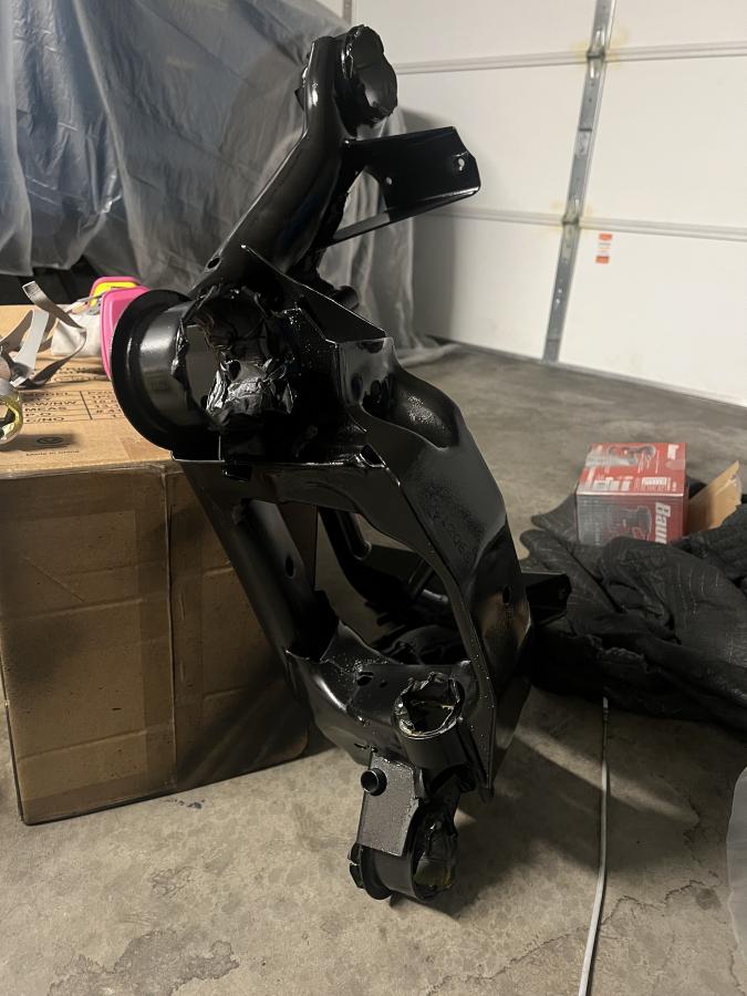

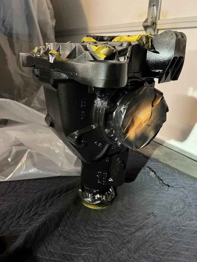

                    And on to some paint work. I went with Spraymax 2k primer for durability and protection, then VHT Roll-bar and chassis rattle can for top coating.
                    I kept it simple by keeping parts intact where possible.
                    Don't worry, new diff cover going in here.
                    Click image for larger version  Name:	IMG_5722.jpg Views:	0 Size:	86.0 KB ID:	250077​

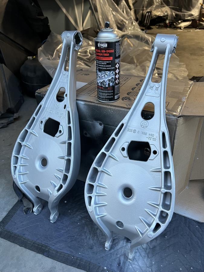

                    I looked high and low for a quality spray can that would mimic aluminum. Found literally a paint that is marketed as aluminum with actual the actual metal in it, interesting. Came out great.
                    Click image for larger version  Name:	IMG_5721.jpg Views:	0 Size:	102.6 KB ID:	250079​

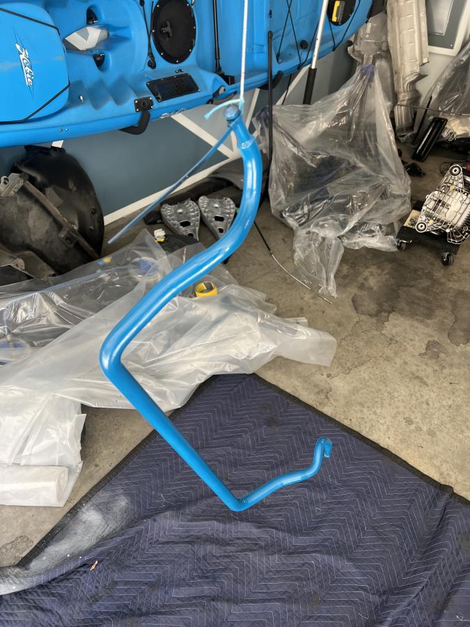

                    To give myself even more work, I decided to have fun with the swaybar color. Clearcoat was later added to this.
                    Click image for larger version  Name:	IMG_5691.jpg Views:	0 Size:	108.2 KB ID:	250081​

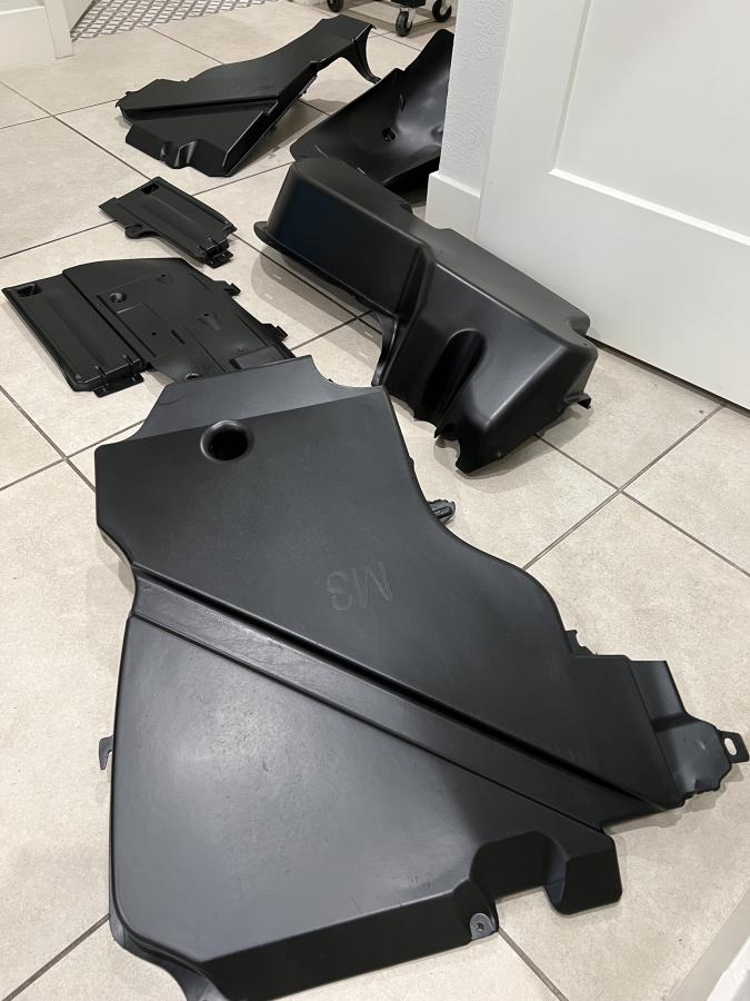

                    Oh and last but not least, can't forget about all the trim pieces. I was running out of room at this point and parts starting spilling into the house.
                    These received SEM Trim paint over some adhesion promoter(probably unnecessary)
                    Click image for larger version  Name:	IMG_5753.jpg Views:	0 Size:	72.3 KB ID:	250082​

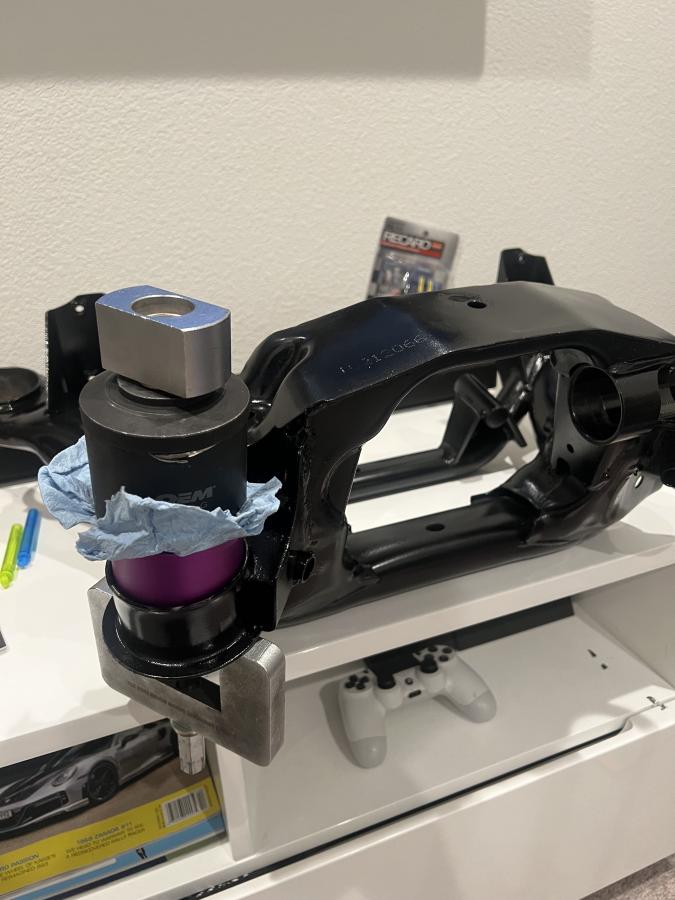

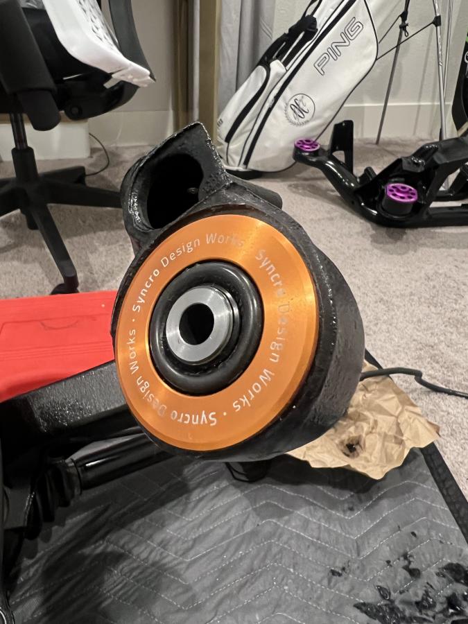

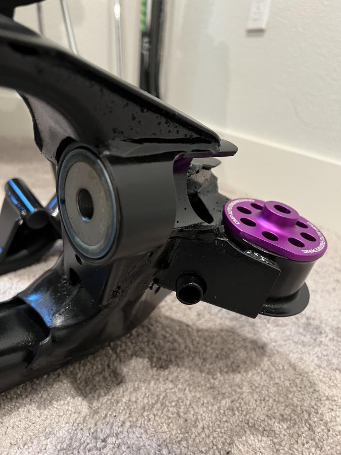

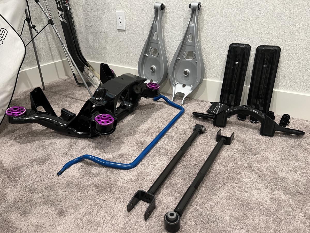

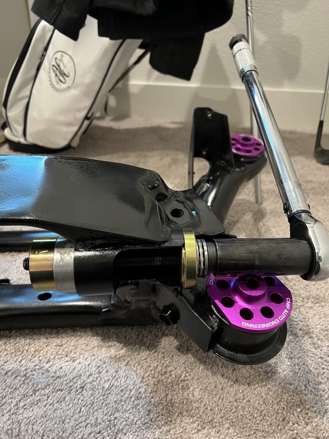

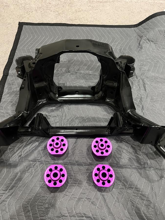

                      I left the parts to dry for a week or so. Then moved on to getting fresh bushings in. This took a collection of kits to get this done, but this bushing kit helped alot. I also had an RTAB specific tool, and autozone balljoint press kit rentals to fill in any gaps.
                      I opted for CMP solid bushings for the subframe. Mainly because they look cool of course.
                      Click image for larger version  Name:	IMG_5788.jpg Views:	0 Size:	131.7 KB ID:	250090
                      Getting these in were a breeze. I used a circolight alternative to aid pressing.
                      Click image for larger version  Name:	IMG_5791.jpg Views:	0 Size:	68.0 KB ID:	250091
                      And the front diff bushing. The kit really helps here.
                      Click image for larger version  Name:	IMG_5804.jpg Views:	0 Size:	102.3 KB ID:	250093
                      Press it till it hits your backing plate, translation from TIS rough guidance.
                      Click image for larger version  Name:	IMG_5808.jpg Views:	0 Size:	71.5 KB ID:	250094​
                      Looks good.
                      Click image for larger version  Name:	IMG_5794.jpg Views:	0 Size:	135.9 KB ID:	250092

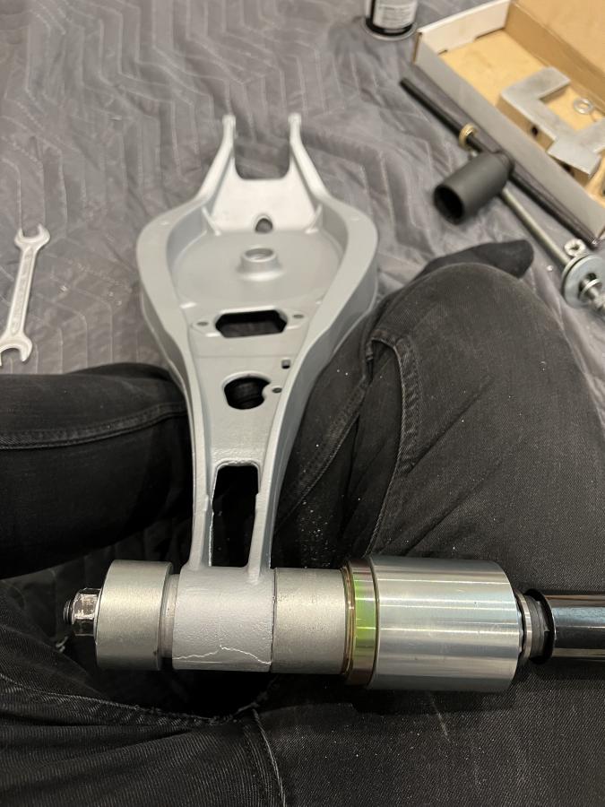

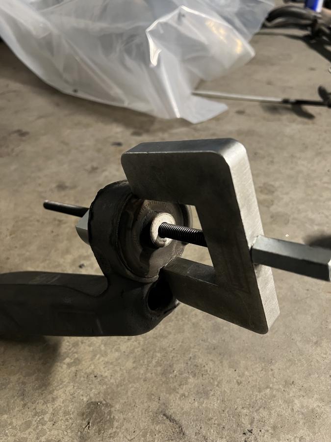

                      On to the trailing arms...
                      The kit really helps here so you remove and press these bushings with the brake shield in place.
                      Click image for larger version  Name:	IMG_5844.jpg Views:	0 Size:	88.9 KB ID:	250095​

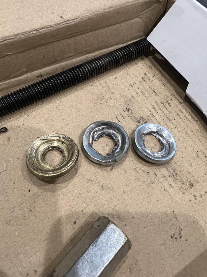

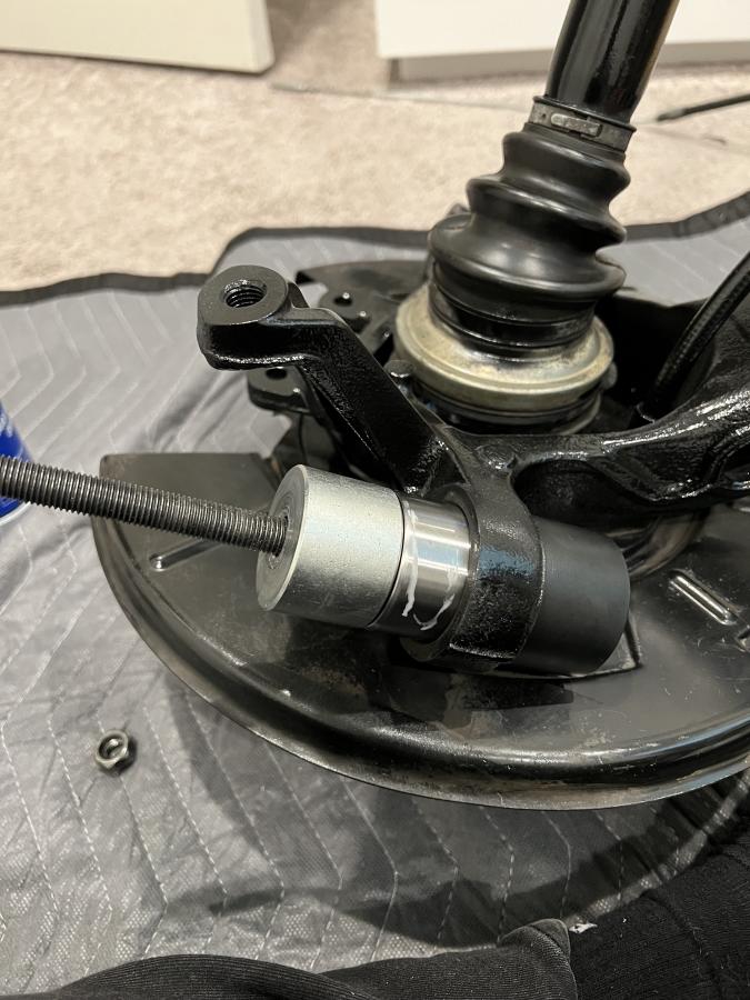

                      Unlike all the other bushings, the RTAB's were crazy tight going in, even out of the freezer with P-80 lube added. Impact wrench or real hydraulic press needed here.
                      Click image for larger version  Name:	IMG_5856.jpg Views:	0 Size:	78.6 KB ID:	250096
                      Click image for larger version  Name:	IMG_5872.jpg Views:	0 Size:	108.8 KB ID:	250098​
                      Click image for larger version  Name:	IMG_5871.jpg Views:	0 Size:	93.3 KB ID:	250097​
                      On to the upper arms, these bushings go in by hand tool very easily. Keep in mind the kit alone won't service these coming out. To get them out initially I had to take my bushing to the hardware store and get an appropriate socket that fit.
                      Click image for larger version  Name:	IMG_5839.jpg Views:	0 Size:	81.5 KB ID:	250099​

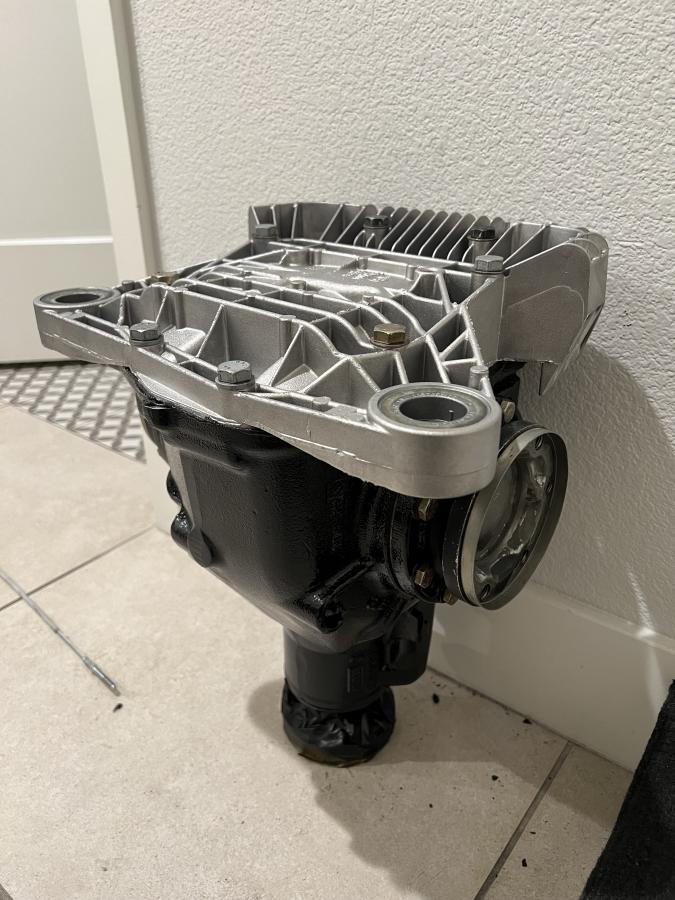

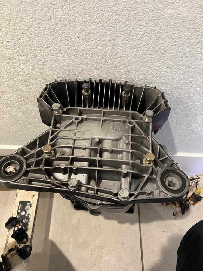

                      Lastly the diff
                      Bushings are only sold with the cover, and this thing was filthy anyways so out with it...
                      ​Click image for larger version  Name:	IMG_5929.jpg Views:	0 Size:	129.1 KB ID:	250100

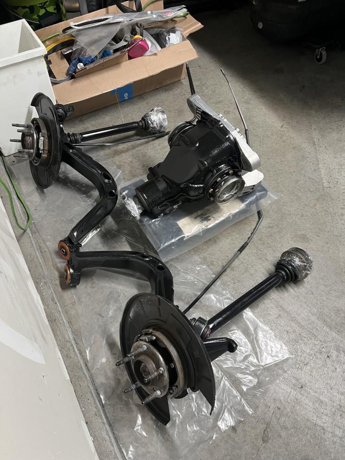

                      nice seeing it all together
                      Click image for larger version  Name:	IMG_5932.jpg Views:	0 Size:	93.1 KB ID:	250101​
                      When your parts are so clean they can go on the carpet.
                      Click image for larger version  Name:	IMG_6099.jpg Views:	0 Size:	266.8 KB ID:	250102​
                      don't mind the overspray and dirty brake shields n hubs, these will be addressed when i redo the brakes.
                      Click image for larger version  Name:	IMG_6103.jpg Views:	0 Size:	105.7 KB ID:	250103​

                        Still lots to do before everything can go in.
                        I started with probably the worst job, attempting to clean the undercarriage. I tried a whole bunch of products with a pressure washer, and I could only get so far but it helped.
                        Especially with these wheel wells....had no idea LSB was under here! Wish I had a before shot.
                        Click image for larger version  Name:	IMG_5570.jpg Views:	0 Size:	95.7 KB ID:	250140

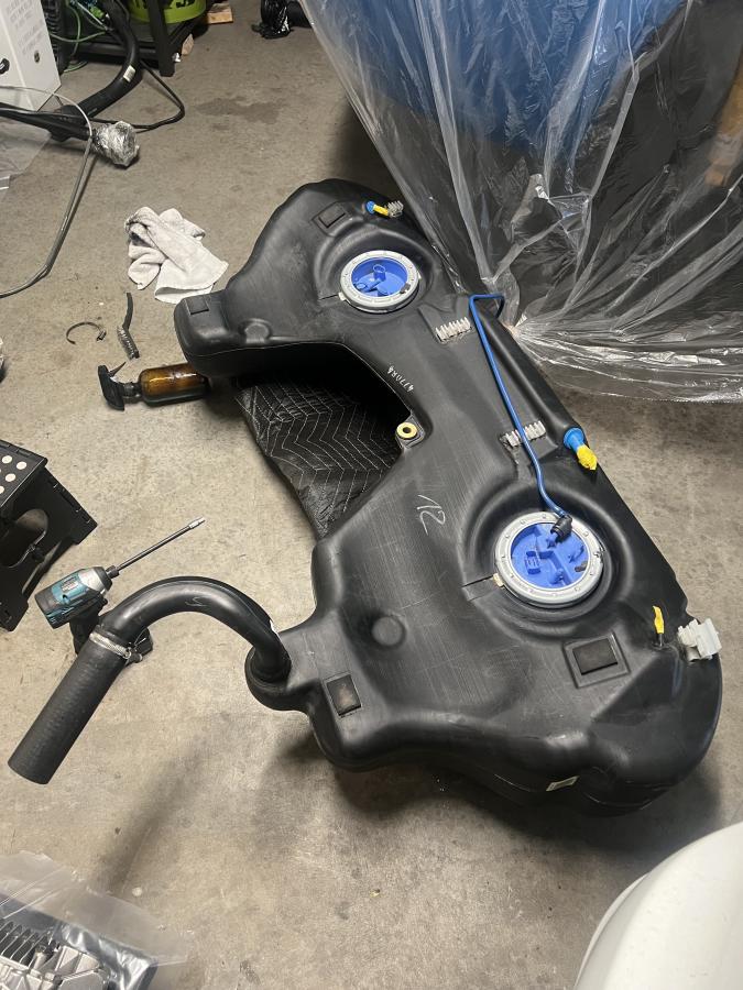

                        This fuel tank was also filthy. Got to clean it up along with a new filler neck hose from @mpower22
                        Click image for larger version  Name:	IMG_6183.jpg Views:	0 Size:	106.8 KB ID:	250144​
                        On to the RACP inspection.
                        My car came with existing subframe plates, but I kinda wish I could've done this all myself. Upon initial inspection, the plates were not sealed and painted well so there was some surface rust forming around the plates and under the seam sealer.
                        I threw a wire wheel on and went to work. The spot welds were clean and intact everywhere. I can't believe how well babied this car must have been.
                        Click image for larger version  Name:	IMG_5571.jpg Views:	0 Size:	152.5 KB ID:	250138​
                        I'll cut to the chase here and show the finished product to reseal the plates.
                        The products I used:
                        -first spraymax 2k primer(most important) to seal everything
                        -then 3m urethane seam sealer on top to avoid any moisture being trapped on the bare metal
                        -top coated with SEM EZ coat
                        -coated with Transtar chip guard
                        It's a lot of products, but IMO the 2k primer is the most important. Spraymax makes it easy with a 2 part in a rattle can and no nasty Isocyanates.
                        ​Click image for larger version  Name:	IMG_6190.jpg Views:	0 Size:	125.0 KB ID:	250139​
                        "While I was in there" and everything apart, I worked on some other things around the drivetrain.
                        The picture speaks for itself.
                        Click image for larger version  Name:	IMG_5742.jpg Views:	0 Size:	99.9 KB ID:	250141

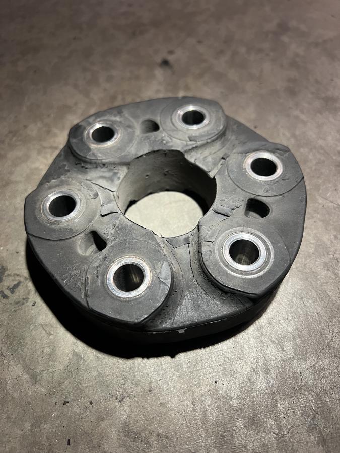

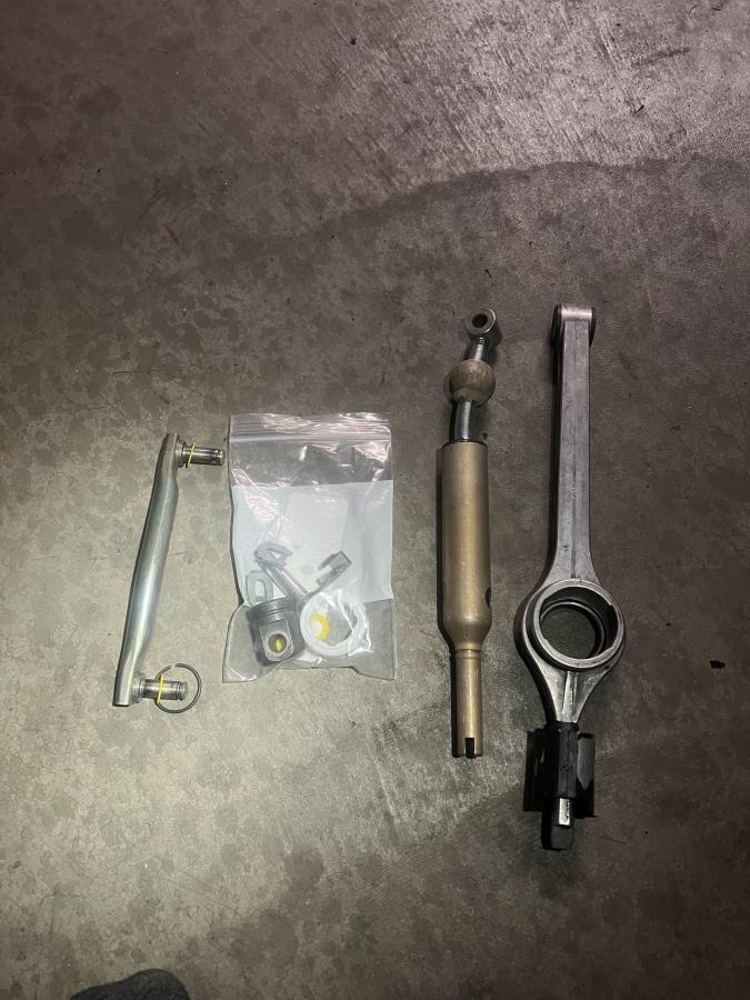

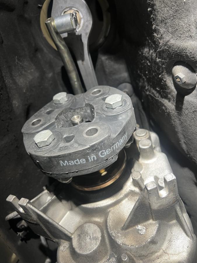

                        The car also came with a UUC short shifter which I found unbearable. I'm new to the getrag as I came from an e36 m3(as shown earlier) with new detents and other bits and it shifted like butter.
                        In effort to find smoother shifting I decided to get all new oe bushings and go back to stock.
                        Click image for larger version  Name:	IMG_5734.jpg Views:	0 Size:	92.3 KB ID:	250143​
                        In with the new shifter and guibo. Note: do not install the guibo this sequence before the driveshaft. I had to reinstall it on the driveshaft later on.
                        Click image for larger version  Name:	IMG_5739.jpg Views:	0 Size:	95.7 KB ID:	250142​​

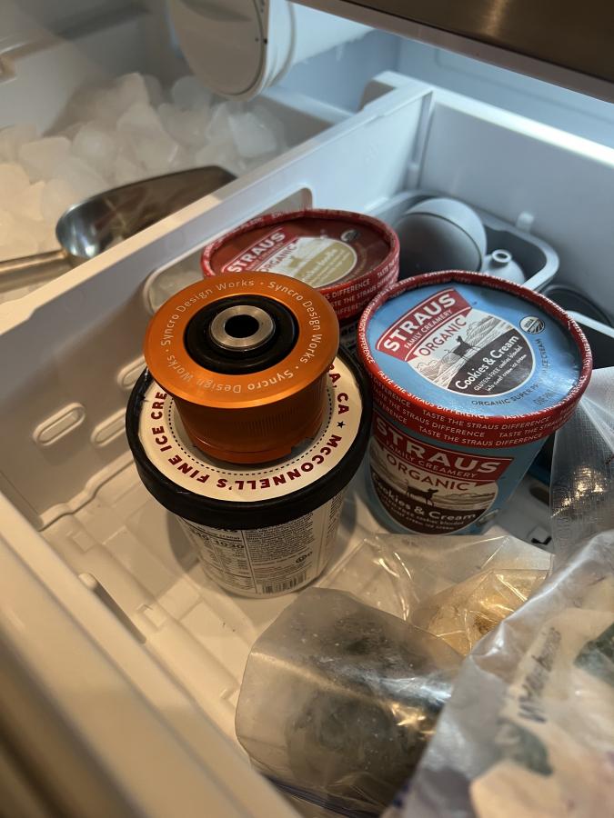

                            Looking good. What has your GF said to all these parts in the house? Lol
                              I regret not taking the extra time to clean and paint all the parts during my refresh. Makes it look brand new.
