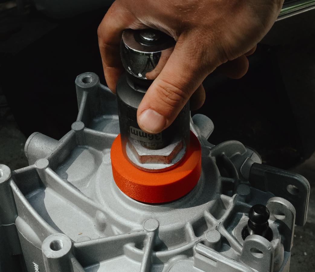

    I made this output shaft seal installer and put it up for download in case anyone else finds it useful:
