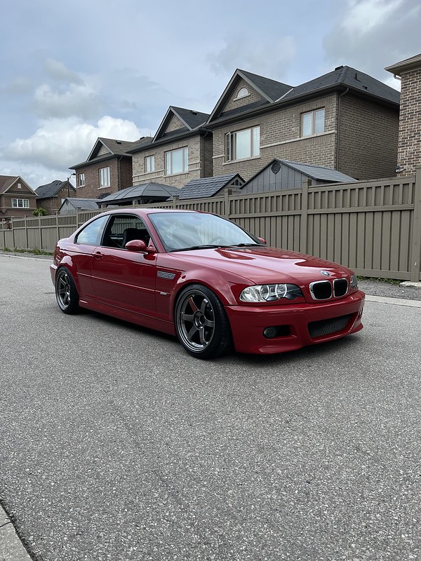

                              As promised, here are my new wheels! TE37SL Formula Silver 18x9.5 et 22 and 18x10.5 et 20 255/35 275/35 PS4S. I did pick up these used but they are in perfect condition except for the valve stems and stickers. Replaced them with genuine parts and ceramic coated the wheels! I love the new look, the car definitely needed it. I wasn't a fan of the black BBS wheels that came with the car.
