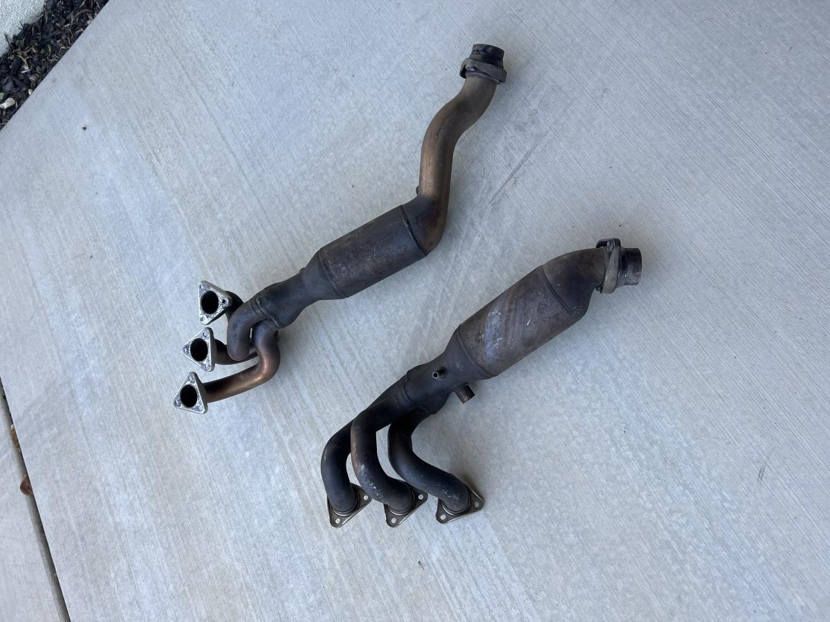

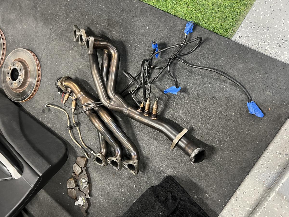

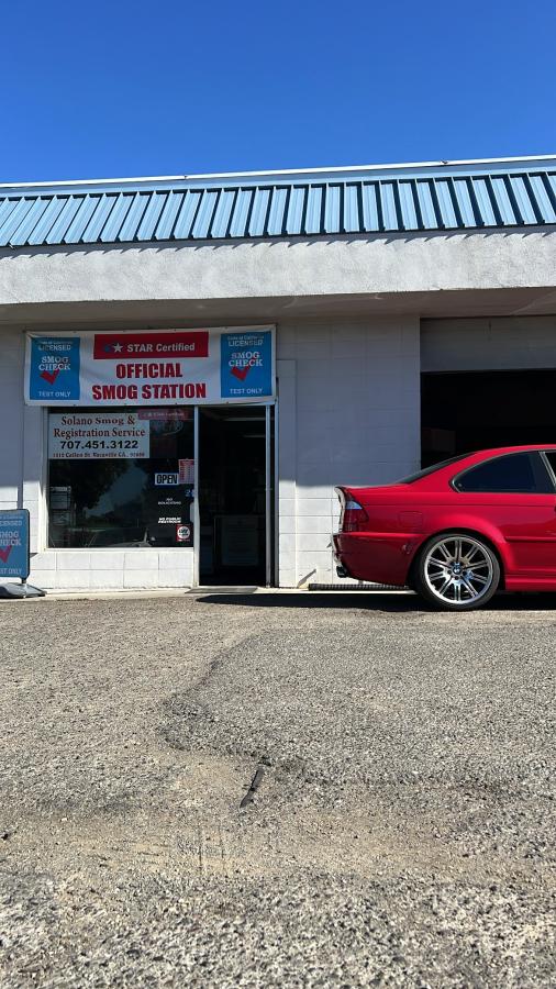

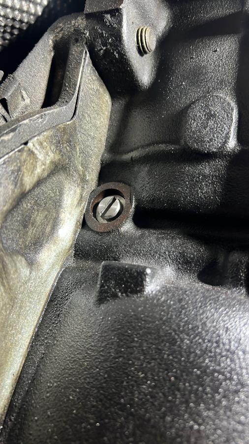

    After purchasing the E46, the first order of business was getting the car registered to CA's DMV. This it needed a passing smog certificate. I purchased the car from the owner agreeing to take the smog risk with the catless headers. I used ECUWorx to hard code the catalysts to always be in a Ready state and did a drive cycle to get the other monitors ready. Took the car to two different smog shops and failed the visual inspection both times! I did not want to deal with the catless header smog saga every two years so I found a deal for OEM headers from FB marketplace and installed those. I've never been more happy to pass smog lol.
    While I was in there I also did the following:
    • Cleaned up the engine
    • Oil change with Liqui Moly BMW 10W60
    • Added Liqui Moly MoS2 ant friction engine treatment

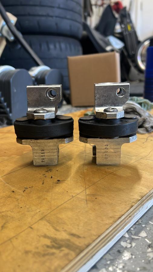

    • Replaced the steering coupling assembly to fix the loose steering wheel handling

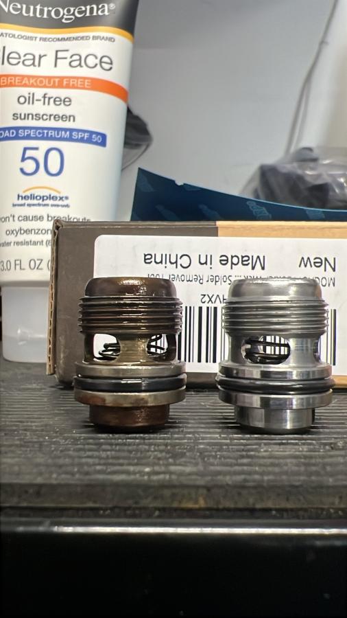

    • Replaced the constant pressure valve since it is a known leak location on the S54
    As of today my exhaust components are stock headers, section 1 with two 200 cell high flow cats, stock section 2, aftermarket section 3 muffler. That leaves me with 4 catalysts haha. I'm undecided if I should either go stock section 1, two resonator section 1, or straight pipe section 1.

      How many miles are on it? Did replacing the steering coupling assembly do anything?
        140k miles. Yes replacing the steering coupling did make a difference. My buddy who has a well sorted M3 noticed that the car didn't respond to small steering inputs on a test drive and suggested replacing this part. Now the car responds to these tiny inputs.
          How hard is the steering coupler to replace?
            It's easy to replace. I already had my reinforcement plate off so it probably took 10-15 minutes to swap out.
              Nice, I would do a dual resonated section 1 and maybe pick up a resonated section 2 while you’re at it. Those two things help improve the rasp without eliminating it, IMO it keeps the character of the exhaust and just makes it nicer. But you’ll notice that there are a billion possible exhaust setups and no one agrees on what sounds best.
              '01 M3, Imola/black
                Thanks for the input. I'll probably go back to a stock section 1 for now to see how it sounds with my aftermarket section 3 then go from there.

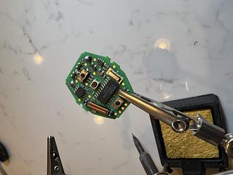

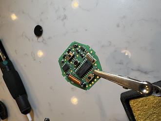

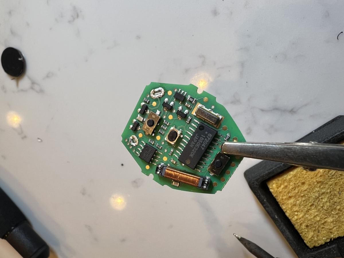

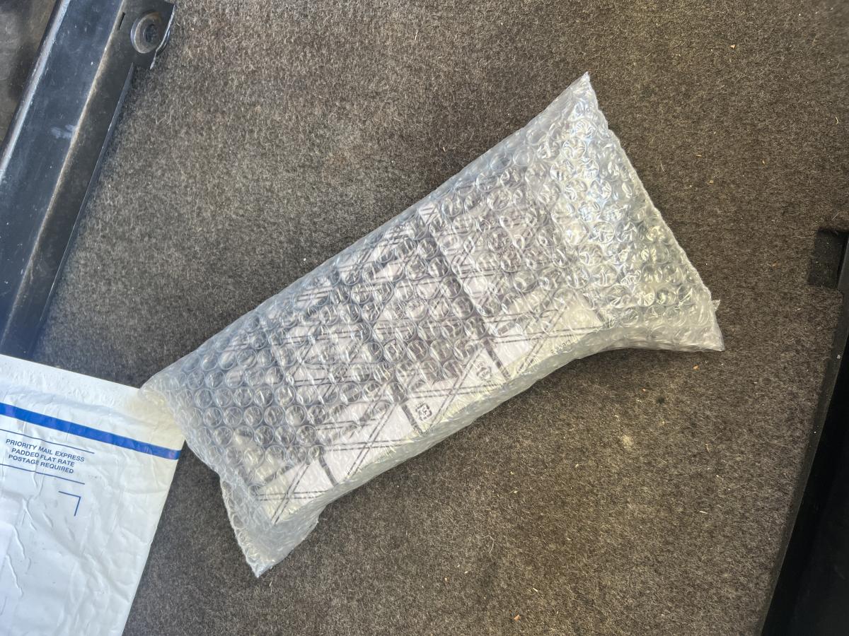

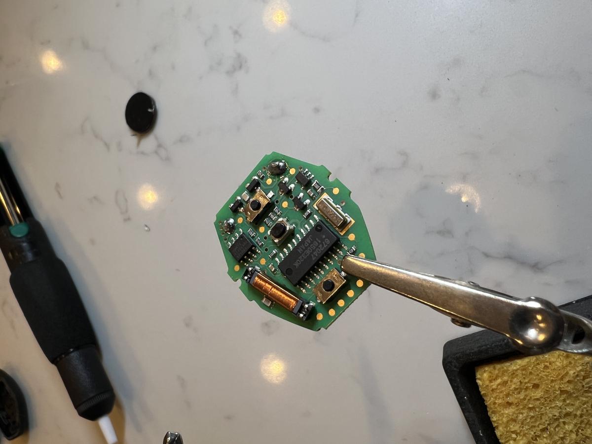

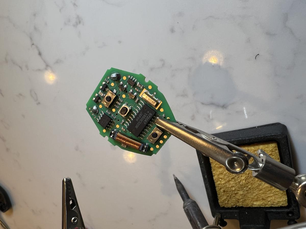

                      • Replaced key fob battery

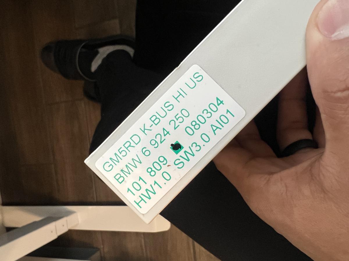

                      • Refurbished my GM5 module
                      • Installed Bluetooth module

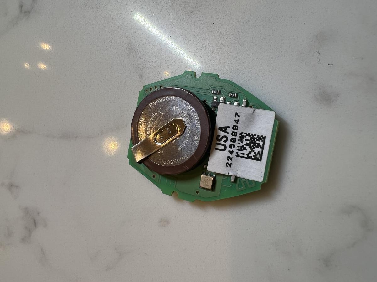

                      The key fob battery was really easy to replace. I got to whip out my circa 2010 RadioShack soldering iron
                      Click image for larger versionName:	IMG_2147.jpgViews:	0Size:	88.9 KBID:	306036Click image for larger version  Name:	IMG_2148.jpg Views:	0 Size:	89.5 KB ID:	306037Click image for larger version  Name:	IMG_2149.jpg Views:	0 Size:	84.0 KB ID:	306038Click image for larger version  Name:	IMG_2150.jpg Views:	0 Size:	102.2 KB ID:	306041​​​​

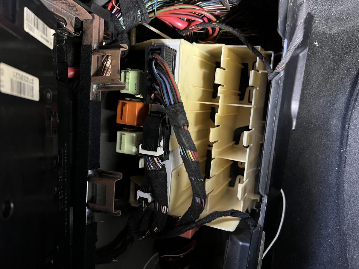

                      As for the GM5 I was having very inconsistent central locking with the car. Reading through forums it looked liked my GM5 needed some refurbishing. I found Scott's website (http://www.bmwgm5.com) and reached out to him via email. He confirmed my symptoms and I pulled the module for repair. Service was quick and easy.
                      Click image for larger version  Name:	IMG_2084.jpg Views:	0 Size:	92.9 KB ID:	306039Click image for larger version  Name:	IMG_2189.jpg Views:	0 Size:	244.0 KB ID:	306045Click image for larger version  Name:	IMG_2190.jpg Views:	0 Size:	143.8 KB ID:	306044​​​

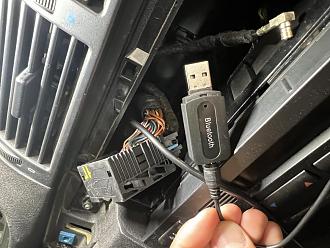

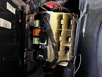

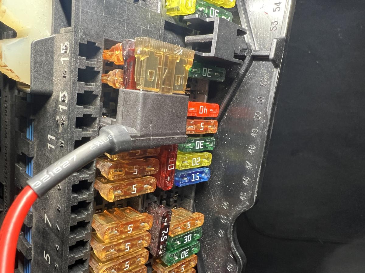

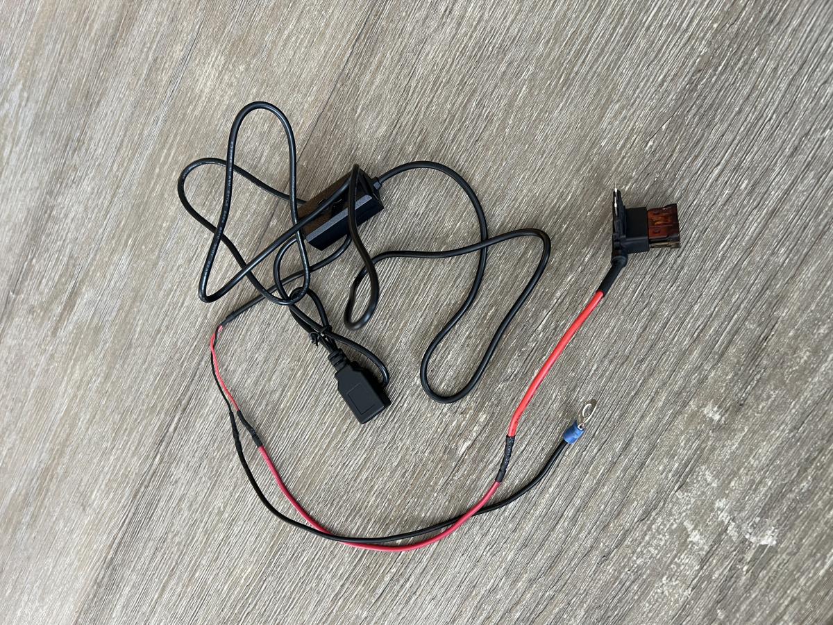

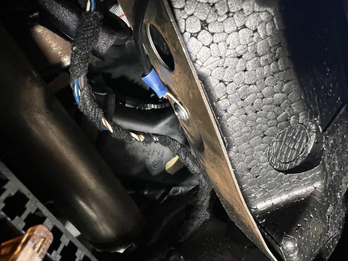

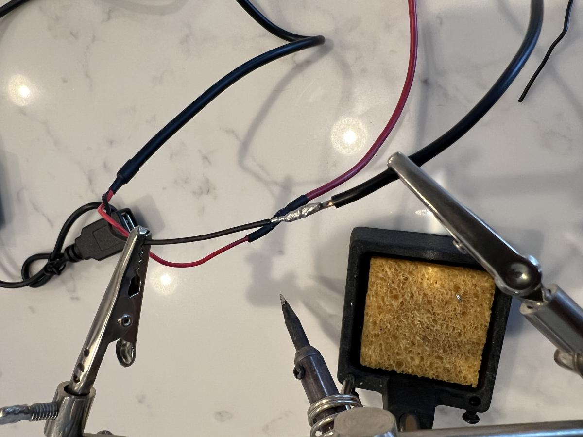

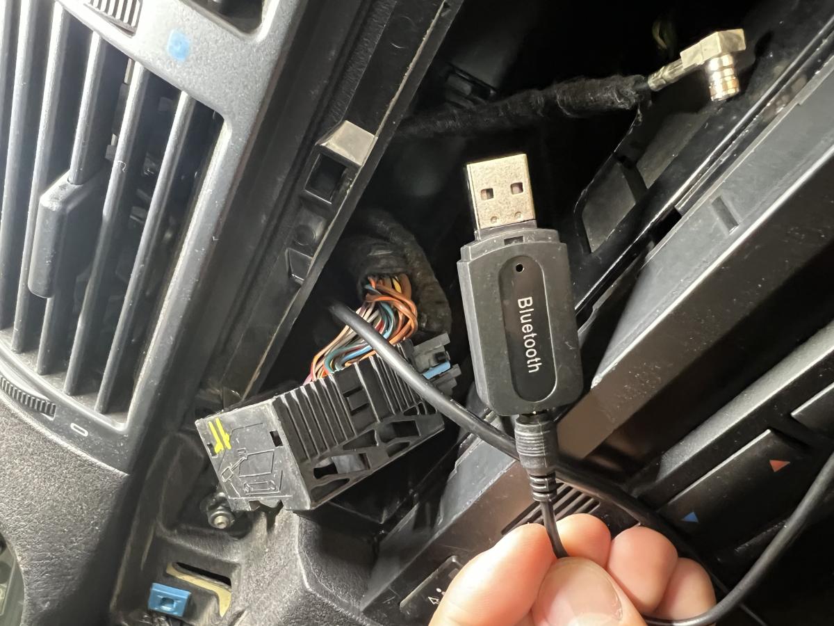

                      The car also came with an aux cord. My iPhone has a very loose lightning bolt port so this didn't work too well. I found a cheap Bluetooth alternative from AGA tools and installed it. The switch source I used was fuse #12. There is a ground screw that can be used behind the dash which is in front of the fuse box when it's in its housed state.
                      Click image for larger version  Name:	IMG_2191.jpg Views:	0 Size:	105.5 KB ID:	306040 Click image for larger version  Name:	IMG_2192.jpg Views:	0 Size:	328.6 KB ID:	306046 Click image for larger version  Name:	IMG_2193.jpg Views:	0 Size:	174.8 KB ID:	306042 Click image for larger version  Name:	IMG_2194.jpg Views:	0 Size:	174.6 KB ID:	306043 Click image for larger version
