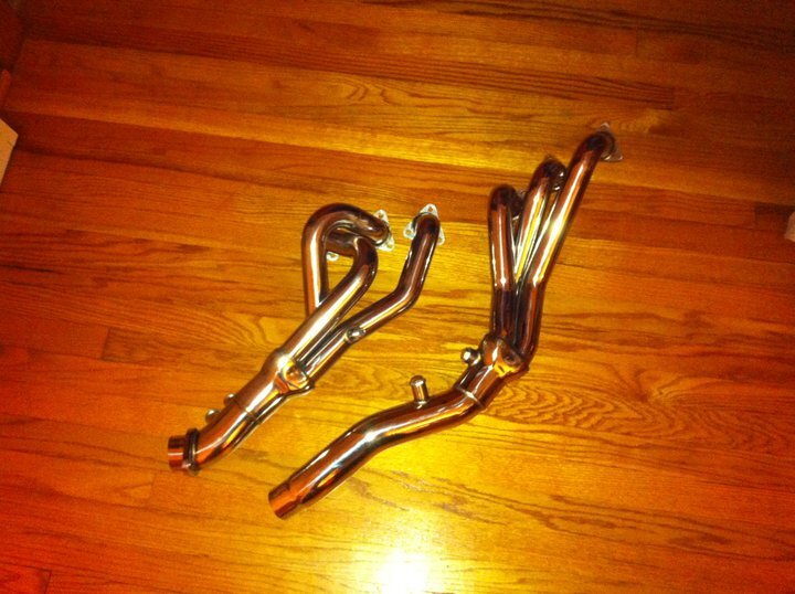

    After I graduating from CU in 2010, I moved to Omaha to attend the Nebraska Medical Center. I added some ebay headers and replaced the shark tune with an epic motorsports tune from Bimmerworld. I also added koni yellow sports, and eibach prokit springs. The fitment on the headers was terrible and required a bit of persuasion to work.
    Click image for larger version  Name:	headers.jpg Views:	0 Size:	81.3 KB ID:	3804

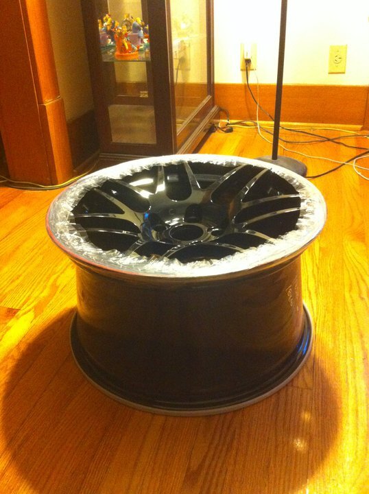

    The orginal wheels were peeling like crazy at this point so I bought some Forgestar F14 wheels. The wait time was advertised as 6-8 weeks but it was 8 months before they were delivered.
    Click image for larger version  Name:	forgestar F14.jpg Views:	0 Size:	77.7 KB ID:	3805

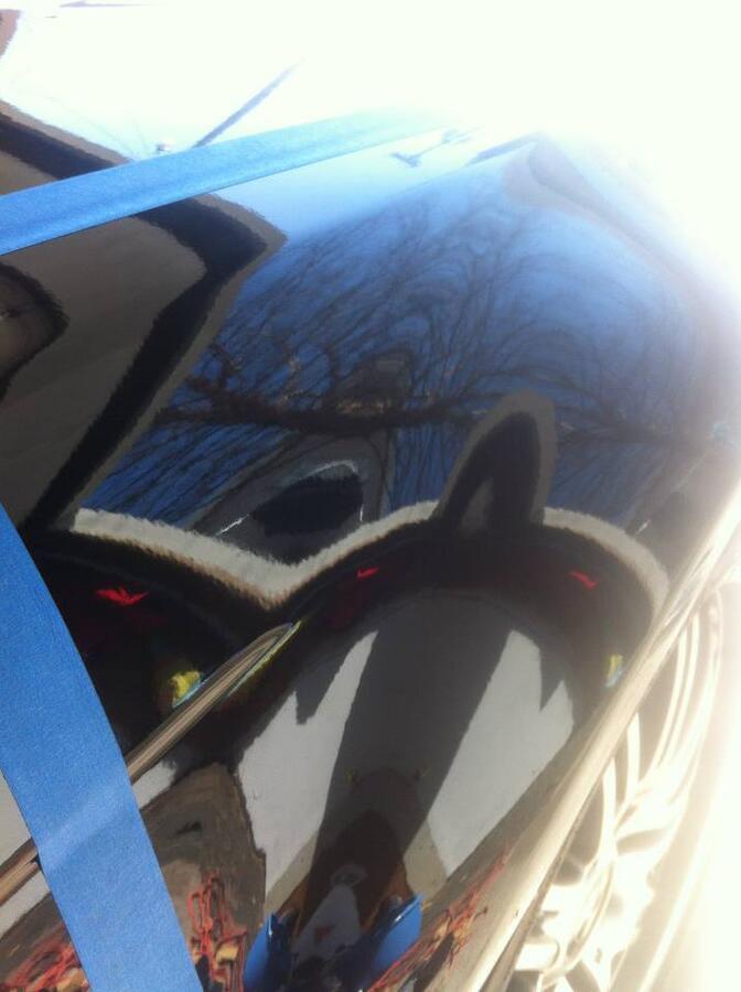

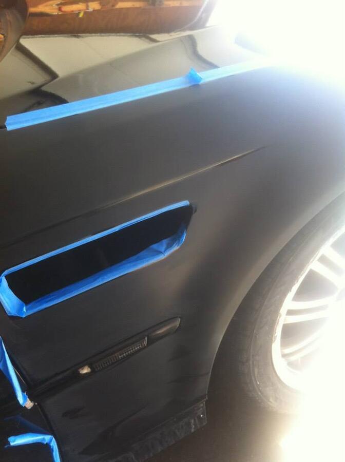

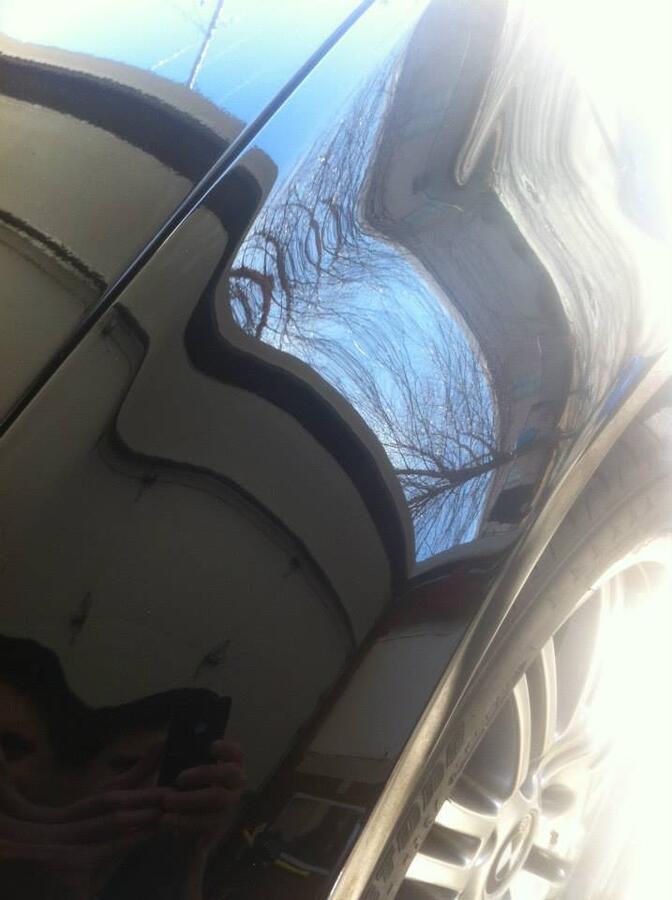

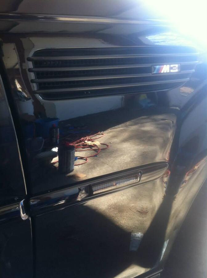

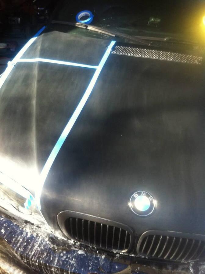

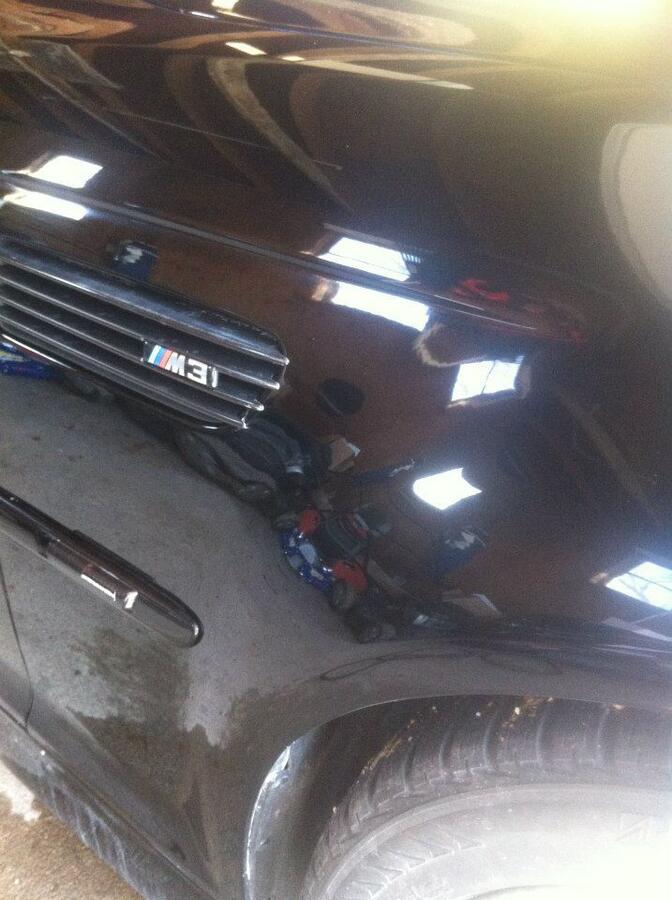

    Paint correction after exams was a great way to deal with stress.
    Click image for larger version  Name:	painc.jpg Views:	0 Size:	49.9 KB ID:	3808
    Click image for larger version  Name:	paint correction.jpg Views:	0 Size:	58.1 KB ID:	3806
    Click image for larger version  Name:	paint fender.jpg Views:	0 Size:	37.9 KB ID:	3807
    Click image for larger version  Name:	finished 2.jpg Views:	0 Size:	50.4 KB ID:	3809
    Click image for larger version  Name:	finished fender.jpg Views:	0 Size:	50.4 KB ID:	3811

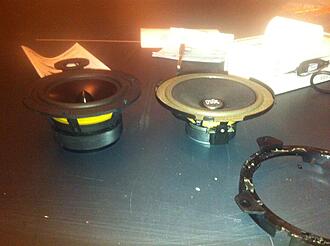

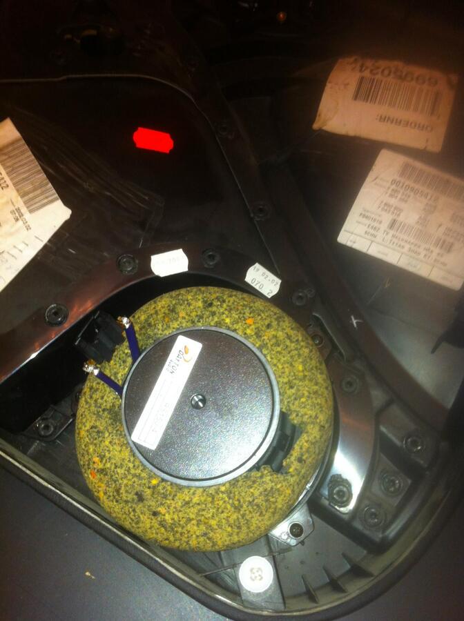

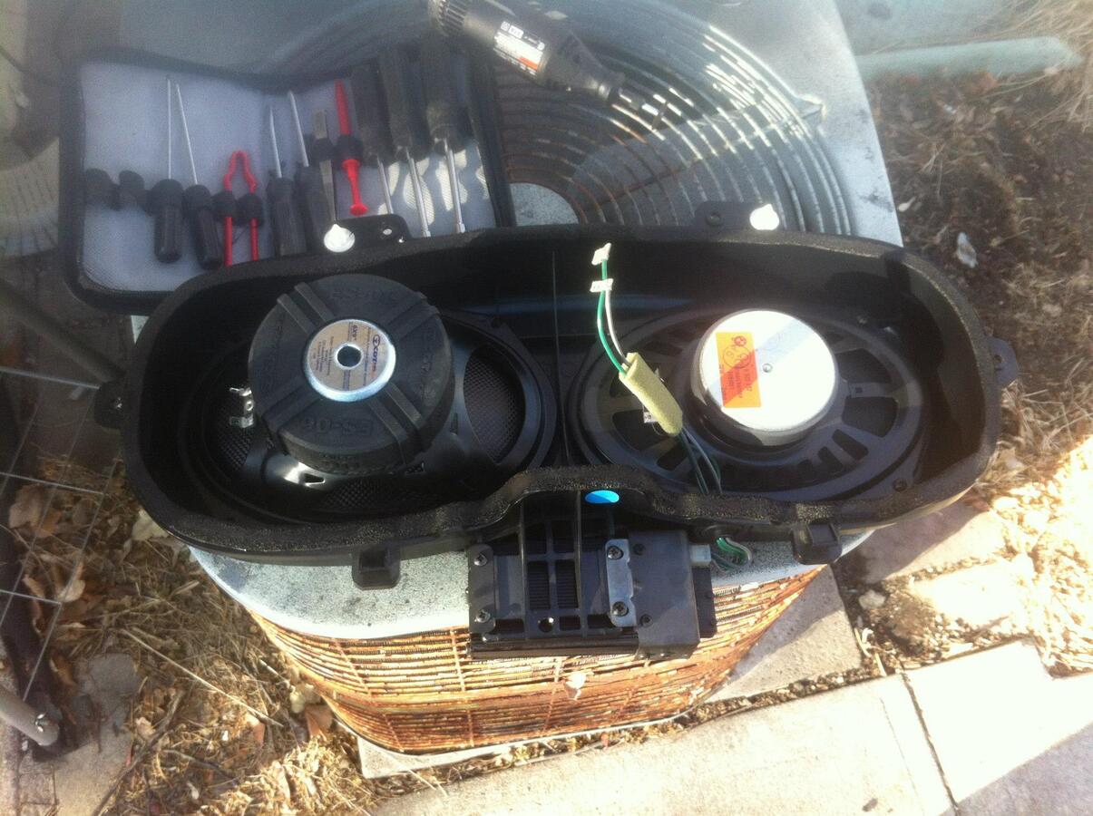

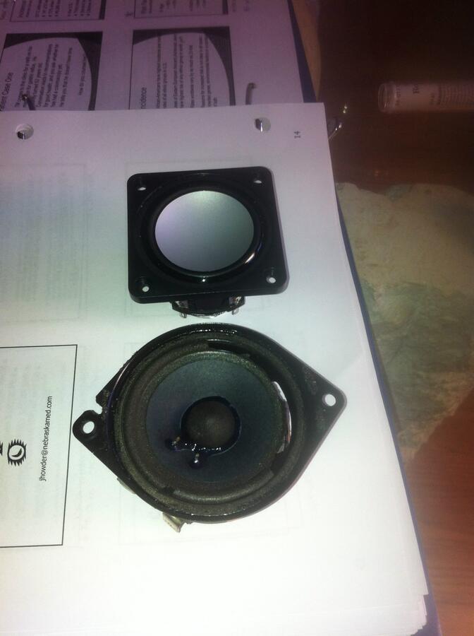

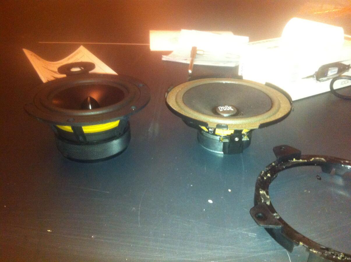

    The speakers were also very tired at this point so I took the opportunity to replace them and the Amp. The CDT diamond 6x9 subs were a very nice upgrade coupled with the alpine amp driving them.
    Click image for larger version  Name:	speakers1.jpg Views:	0 Size:	103.9 KB ID:	3822 Click image for larger version  Name:	speakers2.jpg Views:	0 Size:	150.7 KB ID:	3823
    Click image for larger version  Name:	speakers3.jpg Views:	0 Size:	43.7 KB ID:	3824 Click image for larger version  Name:	speakers4.jpg Views:	0 Size:	68.2 KB ID:	3825

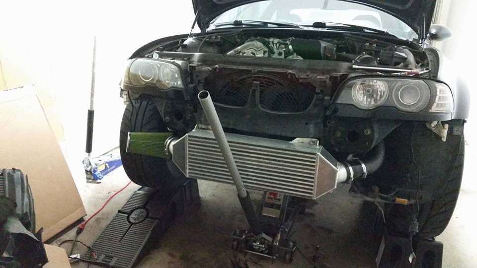

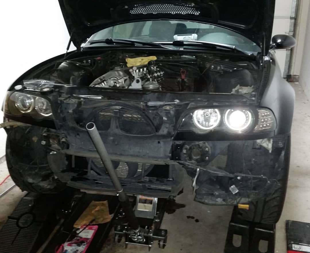

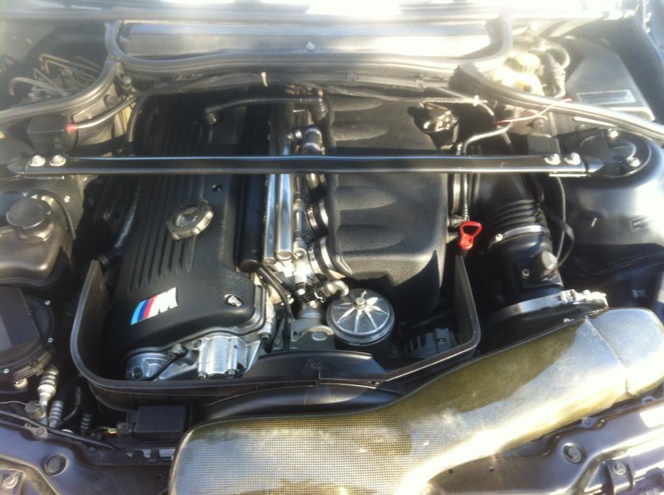

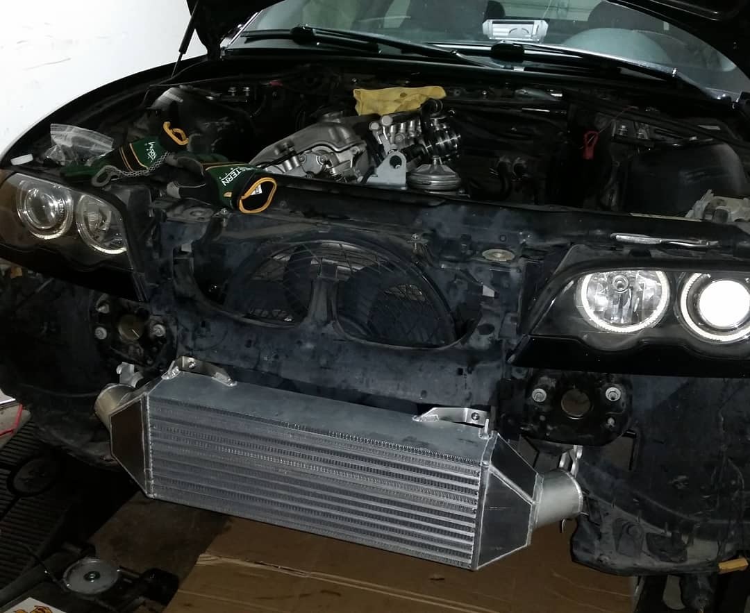

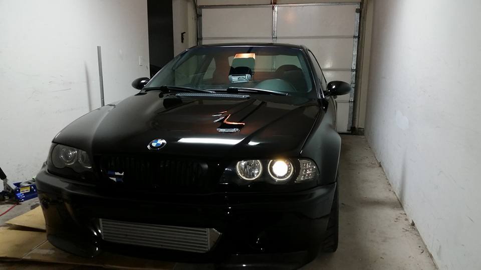

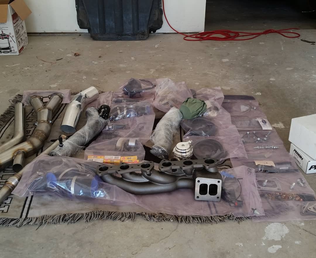

    When I bought the car, I had the dream of eventually going to a supercharger or turbo. After I graduated for hopefully the final time, I picked up a stage 1 MaxPSI kit as a present to myself. Thankfully they were still shipping kits at that time and I installed it in my tiny garage attached to my villa.
    Click image for larger version  Name:	IMG_20191224_213048_056.jpg Views:	0 Size:	123.2 KB ID:	3826
    Click image for larger version  Name:	IMG_20191224_213048_057.jpg Views:	0 Size:	105.3 KB ID:	3827
    Click image for larger version  Name:	IMG_20191224_213048_055.jpg Views:	0 Size:	119.2 KB ID:	3828 Click image for larger version  Name:	IMG_20191224_213048_058.jpg Views:	0 Size:	203.5 KB ID:	3829
    Click image for larger version  Name:	IMG_20191224_213048_065.jpg Views:	0 Size:	78.8 KB ID:	3830
    Click image for larger version  Name:	turbo.jpg Views:	0 Size:	59.3 KB ID:	3833 Click image for larger version  Name:	almost done.jpg Views:	0 Size:	64.9 KB ID:	3834

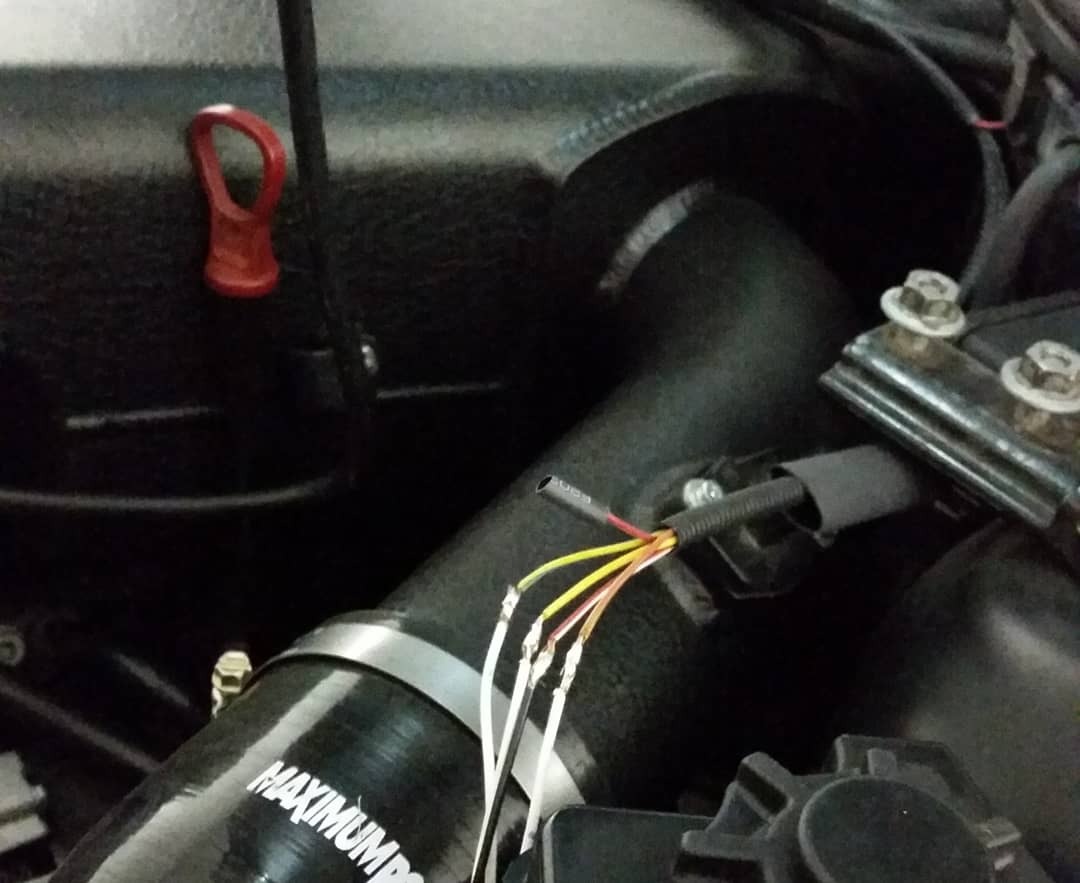

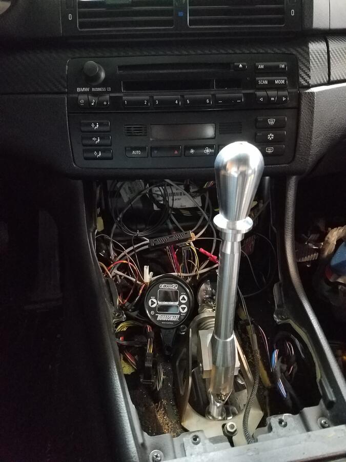

    Click image for larger version  Name:	wiring.jpg Views:	0 Size:	79.0 KB ID:	3835

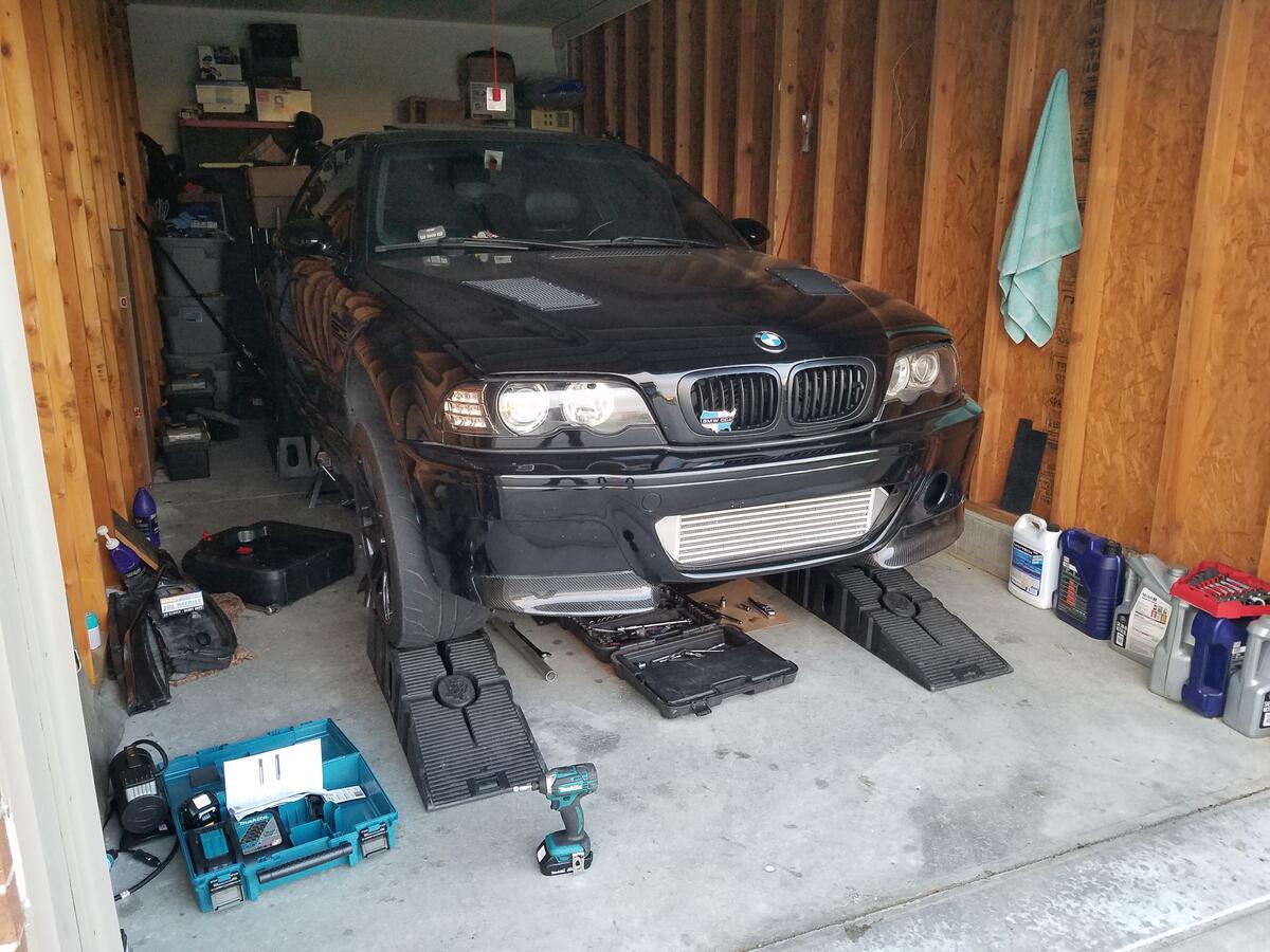

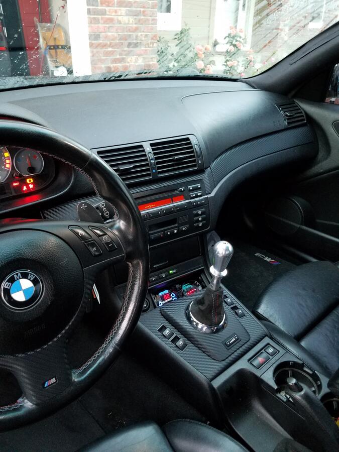

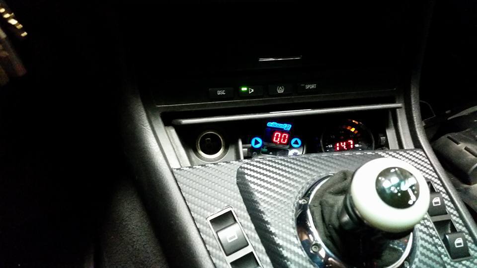

    Stealth Install of the gauges
    Click image for larger version  Name:	gauges.jpg Views:	0 Size:	48.9 KB ID:	3864
    Click image for larger version  Name:	garagem3.jpg Views:	0 Size:	39.2 KB ID:	3836

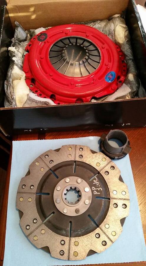

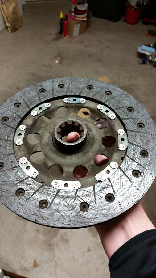

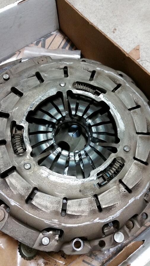

    A couple months after install, the clutch unexpectedly started slipping...After pulling it out, the pressure plate fingers were damaged, the pivot pin was broke resulting in the fork rubbing on the plate and the disc looked a little worn.
    Click image for larger version  Name:	20160320_191013.jpg Views:	0 Size:	89.1 KB ID:	3831
    Click image for larger version  Name:	20160320_191153.jpg Views:	0 Size:	74.1 KB ID:	3832
    The stock clutch was replaced with a Southbend ferramic kit
    Click image for larger version  Name:	SB.jpg Views:	0 Size:	77.6 KB ID:	3837
    Click image for larger version  Name:	20180506_150035.jpg Views:	0 Size:	76.4 KB ID:	3838

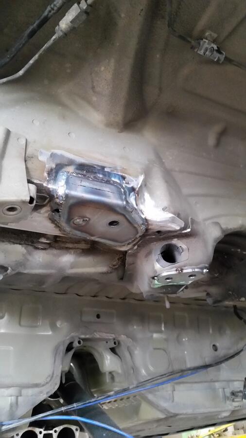

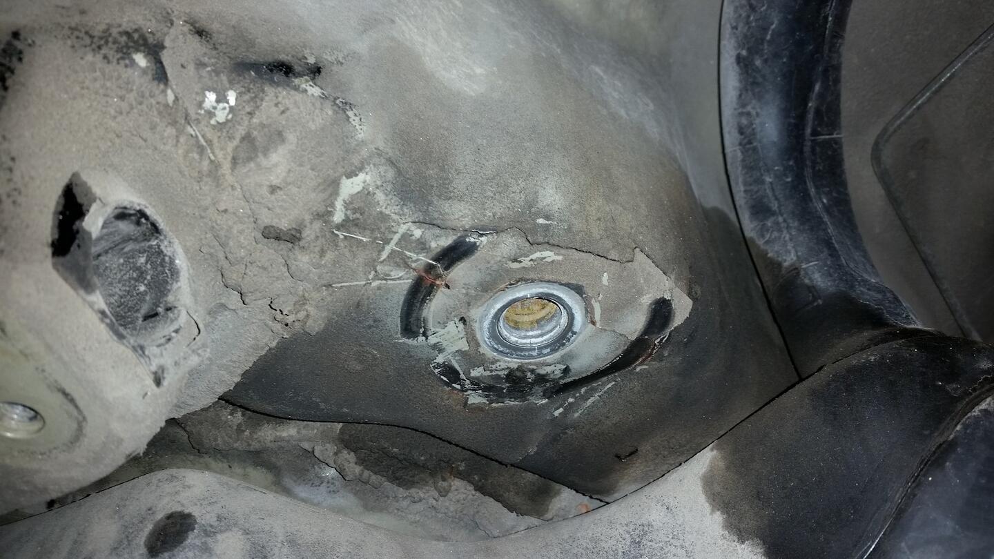

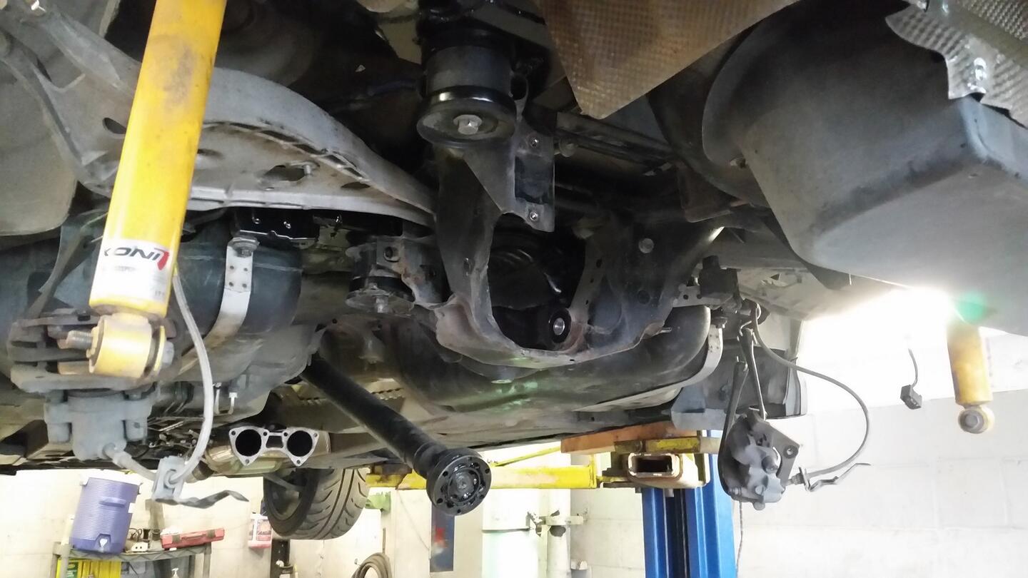

      After about a year of street and track use, the rear end started making unwanted noises. The damage was pretty severe. The spring perches were broken and sunlight could be seen through the floor of the trunk. One of the studs holding the subframe was easily moved by hand. This was outside of my skill set but thankfully the nearby shop I frequented for conversation helped me out. It seemed like a good time to upgrade the subframe bushings to AKG as well.
      Click image for larger version  Name:	20160304_174459.jpg Views:	0 Size:	157.8 KB ID:	3854
      Click image for larger version  Name:	20160311_090247.jpg Views:	0 Size:	92.1 KB ID:	3855
      Click image for larger version  Name:	20160315_093836.jpg Views:	0 Size:	50.1 KB ID:	3857
      Click image for larger version  Name:	20160315_093357.jpg Views:	0 Size:	51.6 KB ID:	3856
      Click image for larger version  Name:	20160315_094102.jpg Views:	0 Size:	48.7 KB ID:	3858
      Click image for larger version  Name:	20160315_094120.jpg Views:	0 Size:	164.4 KB ID:	3859
      Click image for larger version  Name:	20160316_094007.jpg Views:	0 Size:	121.6 KB ID:	3860
      Click image for larger version  Name:	20160323_084709.jpg Views:	0 Size:	120.2 KB ID:	3861

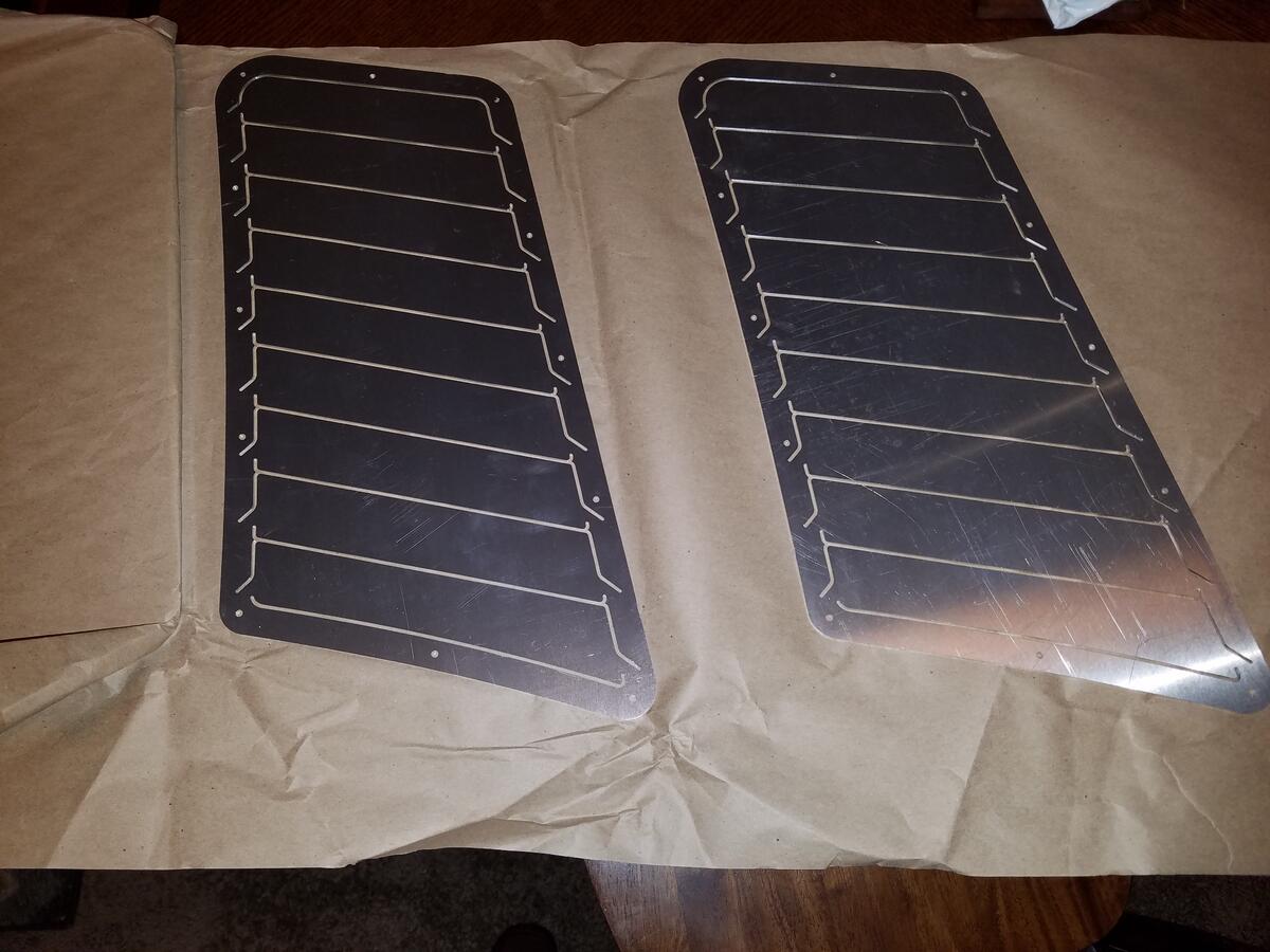

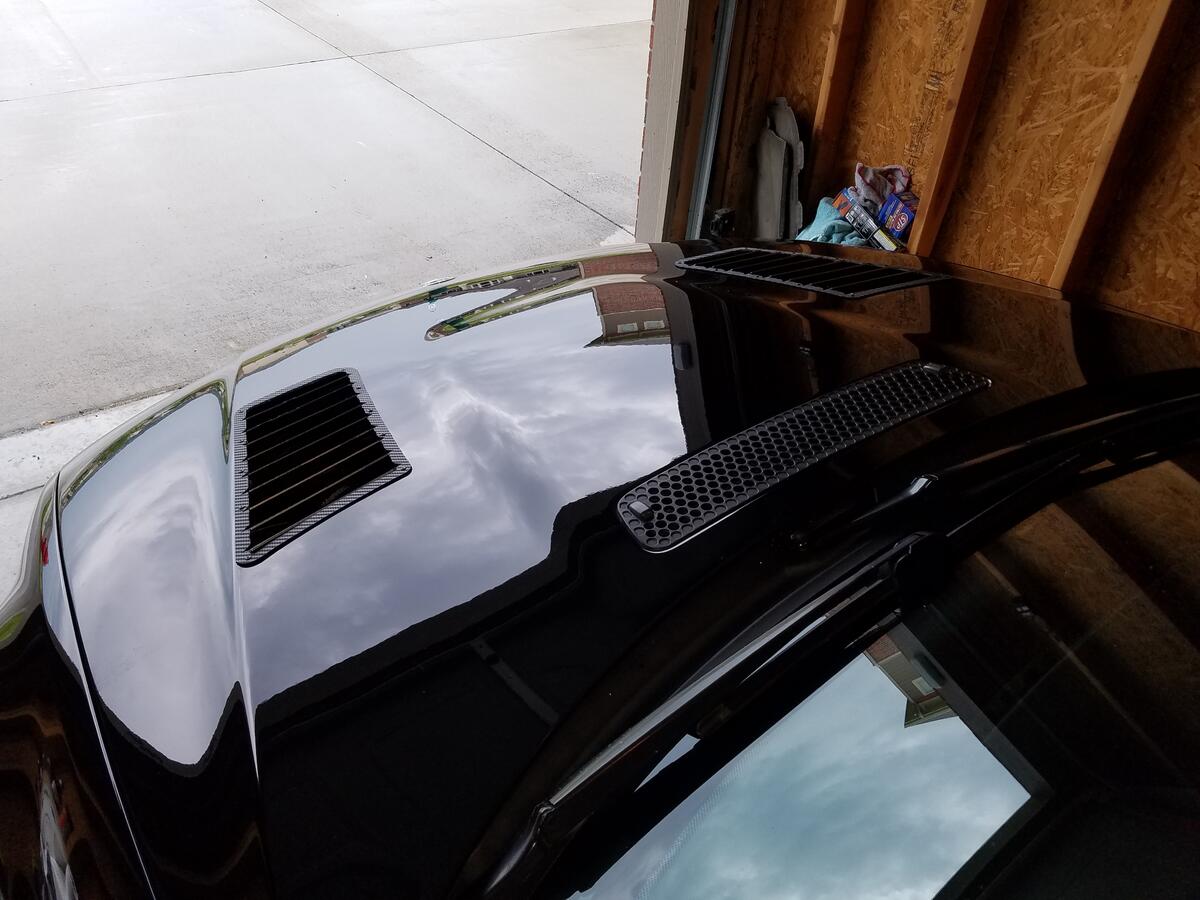

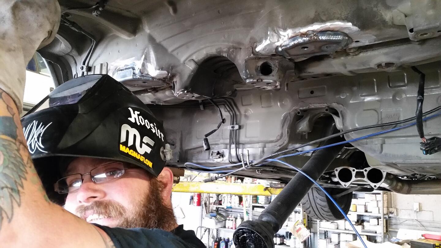

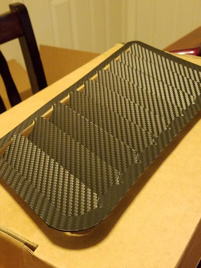

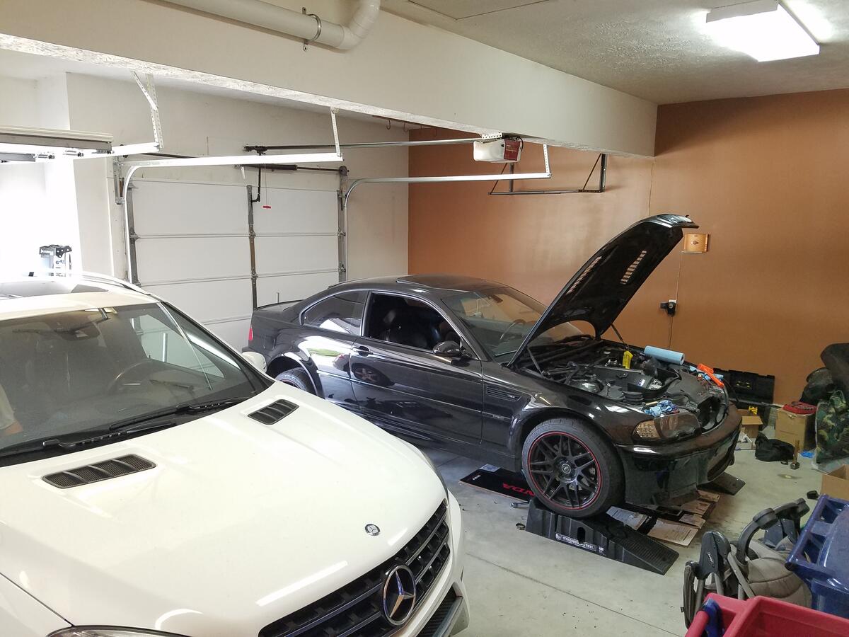

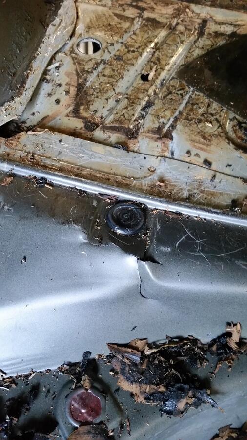

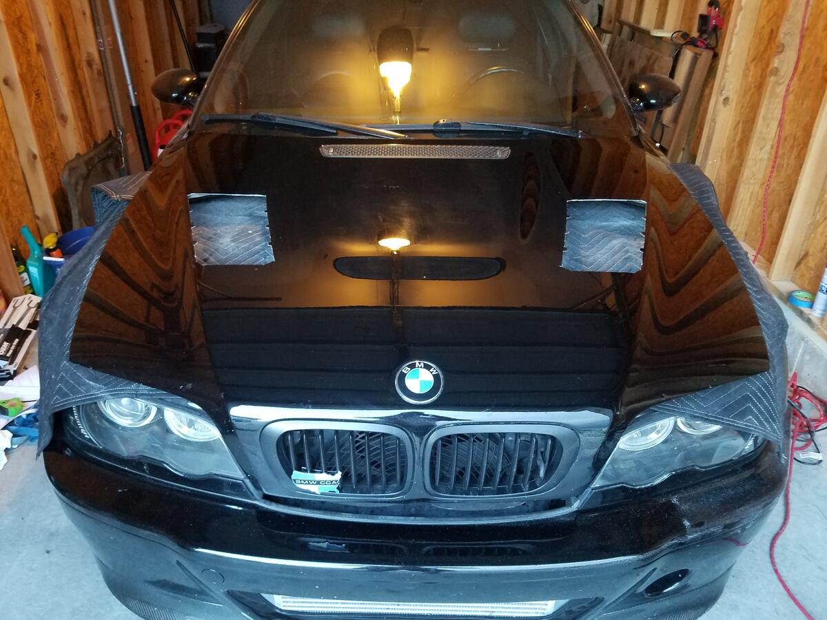

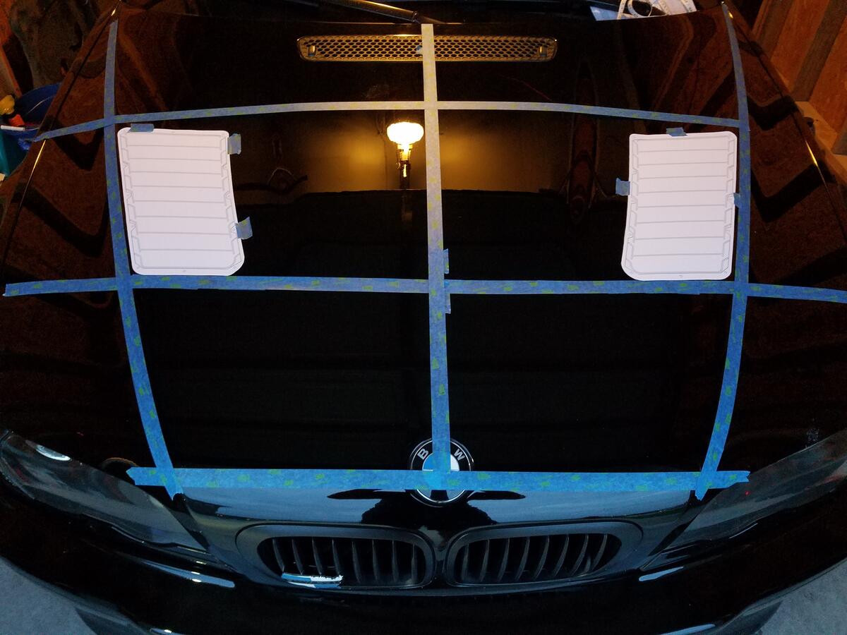

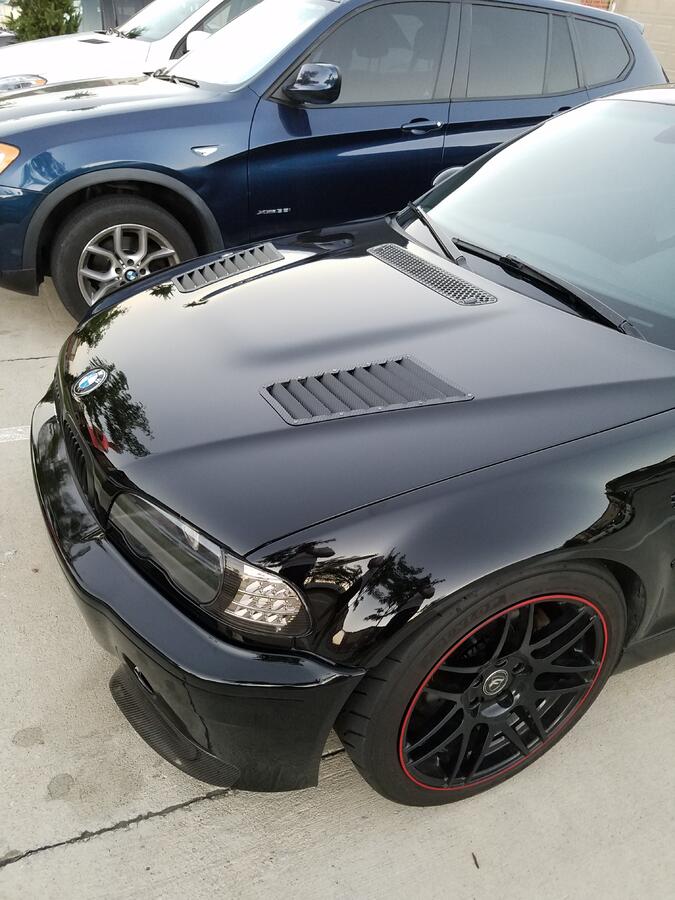

        Temps under the hood started getting pretty warm so it was time to vent the hood. Cutting the hood was one of the more nerve wracking things I've done to the car. I do miss the look of the original hood but the vents do a great job of lowering the termperature.
ID:	3872 Click image for larger version
ID:	3873 Click image for larger version
ID:	3874 Click image for larger version
ID:	3875 Click image for larger version
ID:	3876 Click image for larger version

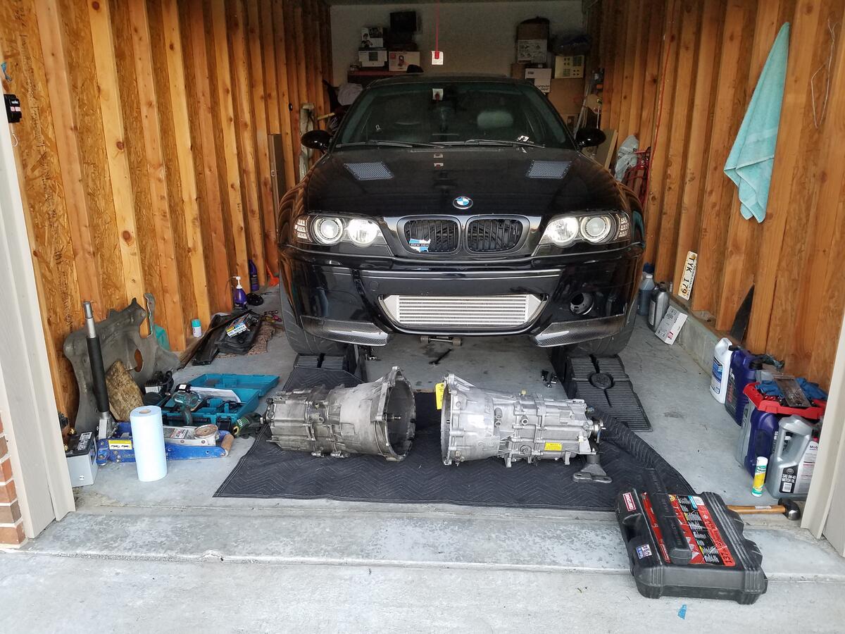

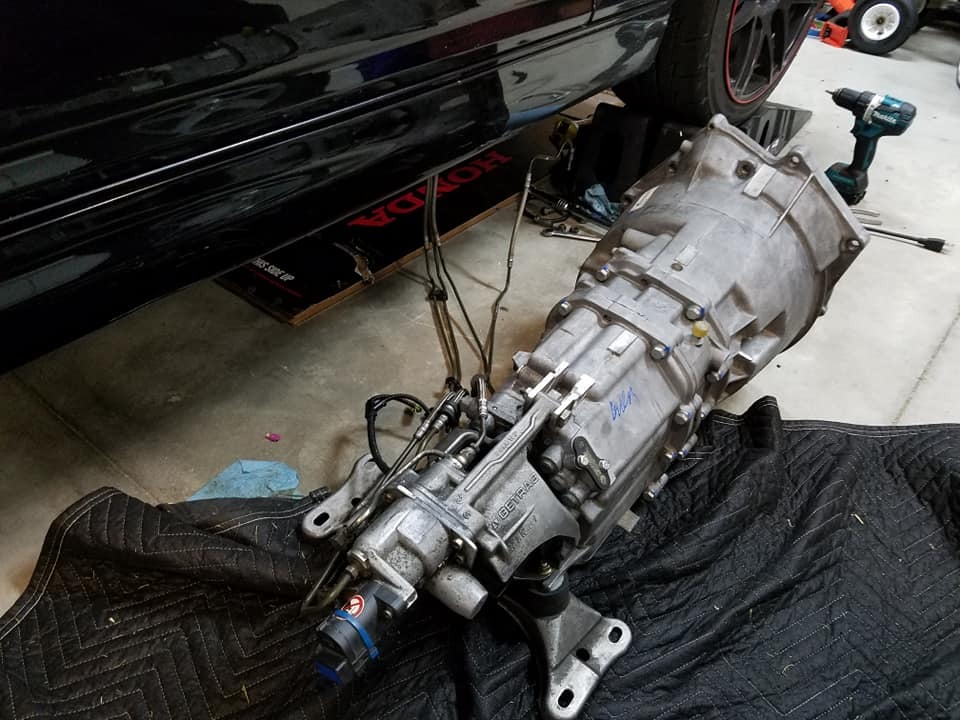

          The SMG transmission started having problems with shifting and destroyed a synchro.
          Click image for larger version  Name:	20171010_182914.jpg Views:	0 Size:	162.6 KB ID:	3880 Click image for larger version  Name:	20171012_182809.jpg Views:	0 Size:	184.3 KB ID:	3881
          After the lower mileage transmission was put in it was time for more road racing.
          Click image for larger version  Name:	20171104_142506.jpg Views:	0 Size:	180.9 KB ID:	3882

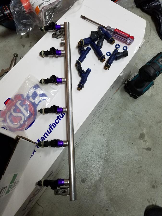

          After a couple years of running race gas, it was time to upgrade. I talked to MIke at MaxPsi and bought the E85 flex fuel kit coming off of the shop car.
          Click image for larger version  Name:	20180609_200121.jpg Views:	0 Size:	91.1 KB ID:	3883
          Click image for larger version  Name:	20180528_171743.jpg Views:	0 Size:	96.4 KB ID:	3884 Click image for larger version  Name:	20180527_191041.jpg Views:	0 Size:	198.0 KB ID:	3885

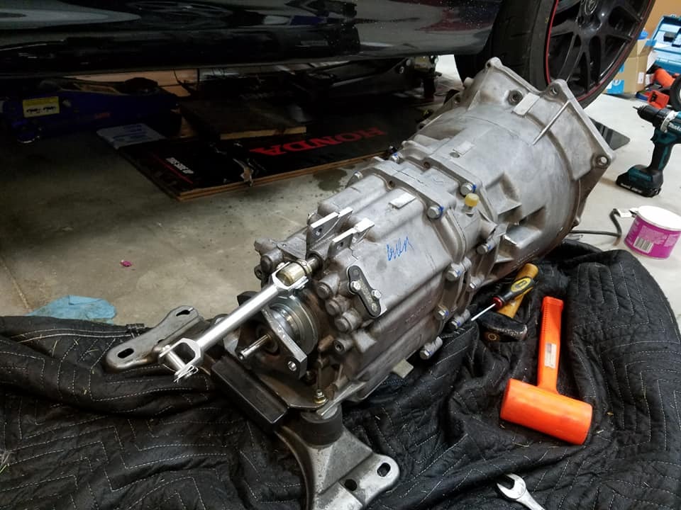

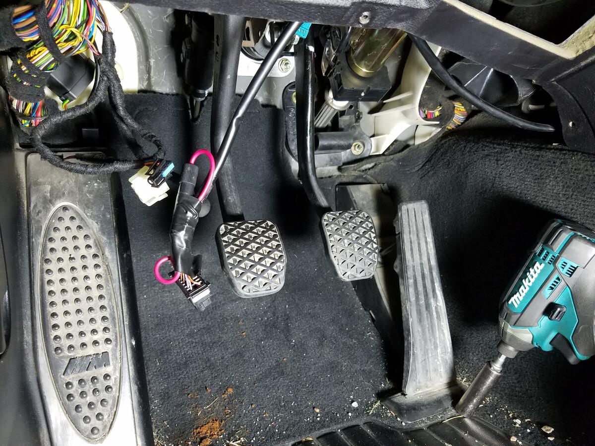

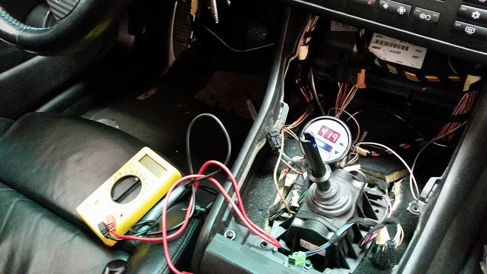

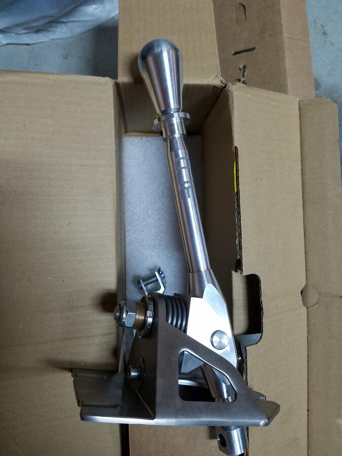

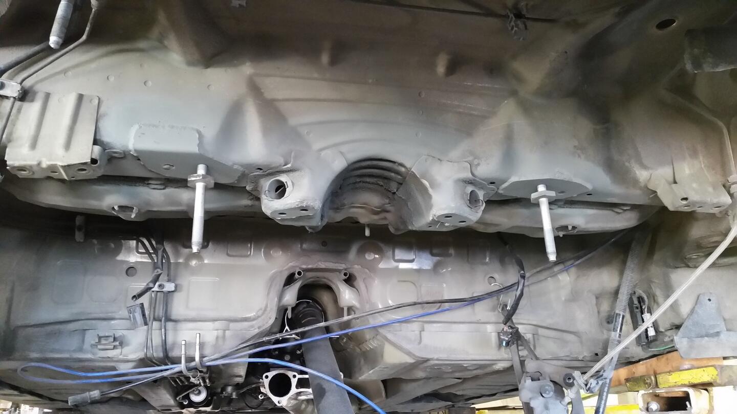

            With the increase in power came more problems from the SMG. I quickly removed it and converted to a 6 MT before it ruined another synchro. Originally I wanted to use a RTD self centering shifter to avoid changing the bell housing. However after spending time reading, I decided to have have it machined.The bell housing from the old transmission was removed and sent to Technica motorsports in California to be prepped for the conversion. They did a great job and quickly turned it around.
            Click image for larger version  Name:	20180609_155315.jpg Views:	0 Size:	81.0 KB ID:	3896
            Click image for larger version  Name:	20180609_172941.jpg Views:	0 Size:	216.9 KB ID:	3892 Click image for larger version  Name:	20180610_111836.jpg Views:	0 Size:	124.9 KB ID:	3893
            Click image for larger version  Name:	20180615_161226.jpg Views:	0 Size:	63.4 KB ID:	3894
            Click image for larger version  Name:	20180615_175143.jpg Views:	0 Size:	78.2 KB ID:	3895
            Click image for larger version  Name:	image_1380.jpg Views:	3 Size:	94.0 KB ID:	3897

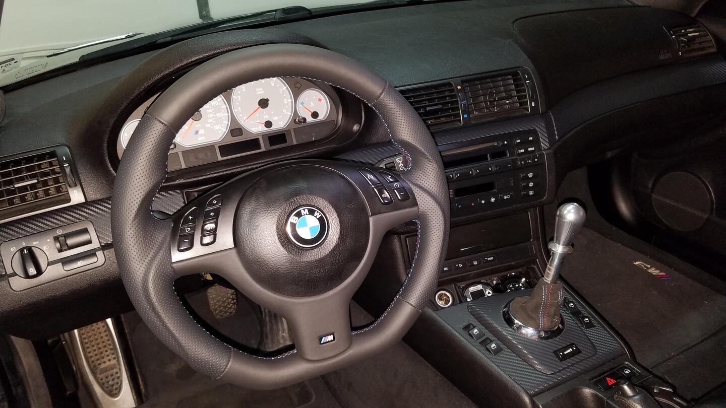

            The steering wheel was looking a little worn after almost 190k miles
            Click image for larger version  Name:	20190820_130859.jpg Views:	0 Size:	166.3 KB ID:	3899

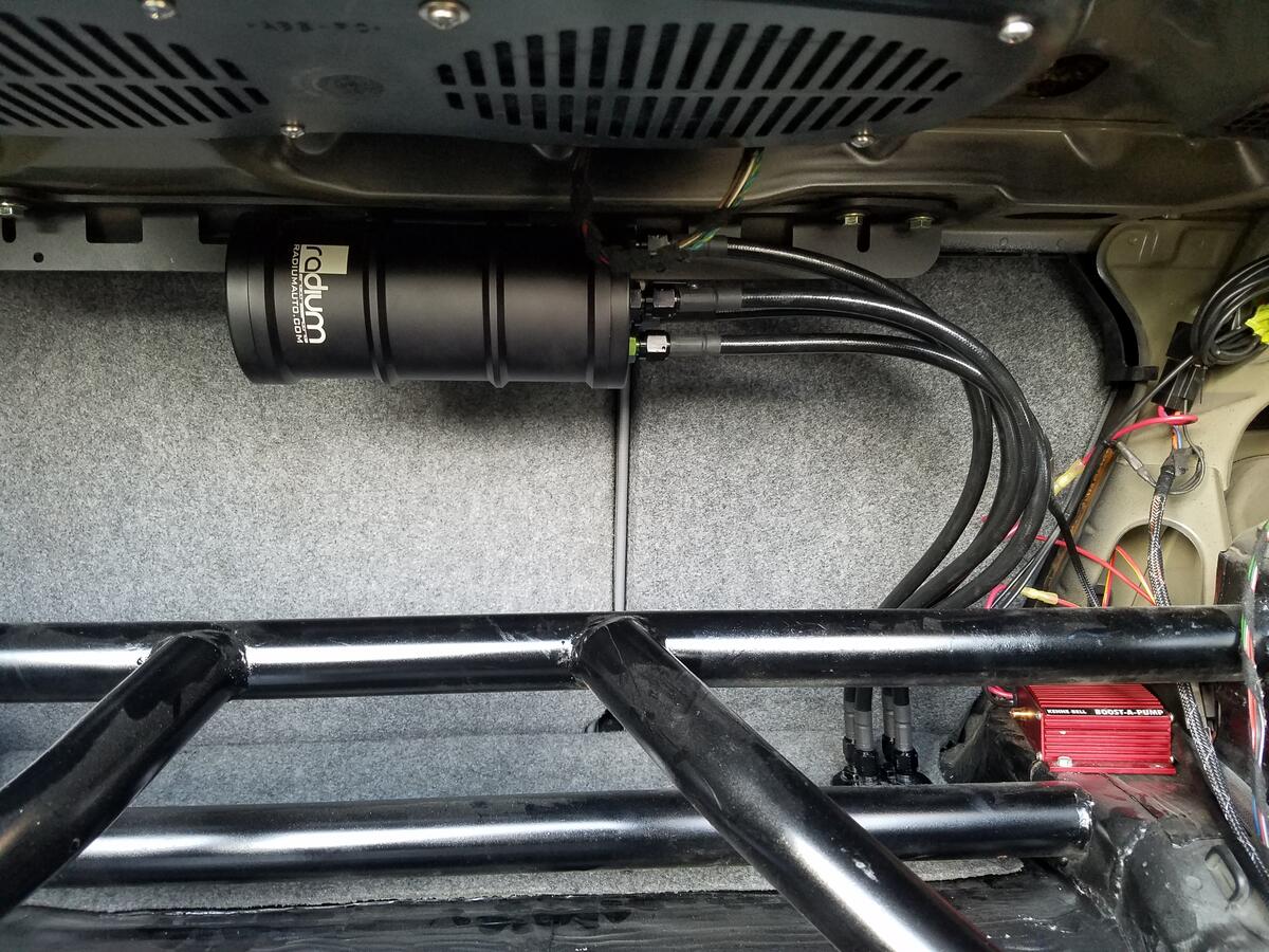

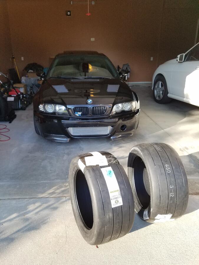

              I started visiting the nearby track more for Test and Tune. Running on e85 and 19+ psi, the car was in need of some new shoes. I added some 17" silver apex arc 8's and Mickey Thompson ET street R's (275/40r17)
              Click image for larger version  Name:	20180808_184236.jpg Views:	0 Size:	79.0 KB ID:	3912
              Click image for larger version  Name:	apex arc8.jpg Views:	0 Size:	74.5 KB ID:	3913

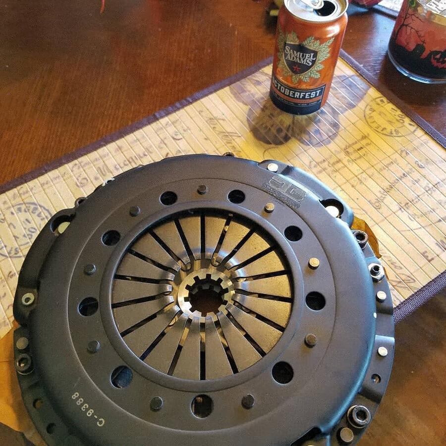

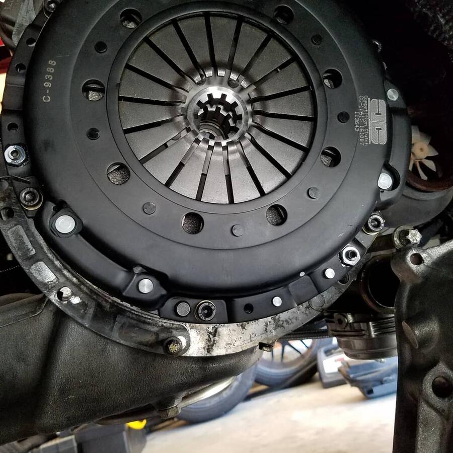

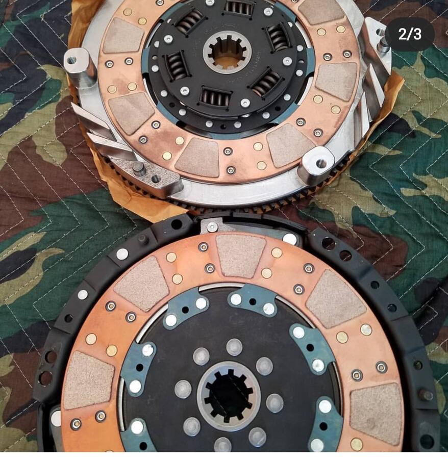

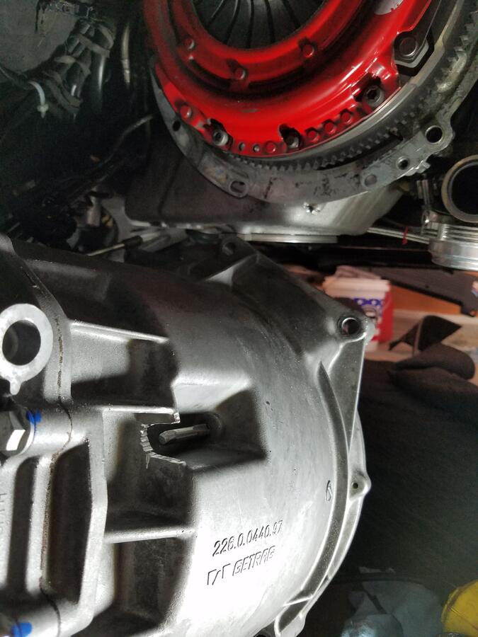

              I very quickly realized these are not a good choice for drag racing with a ferramic clutch. On my second pass the clutch was fused to the pressure plate. I made haste for the exit and drove it home without being able to release the clutch. And....out came the transmission again.
              I called competition clutch and they had discontinued their twin disc ceramic clutch. However they still had some in obsolete inventory and gave it to me for a screaming deal. The twin disc is night and day compared to the Southbend unit it replaced. The pedal pressure is much lighter and the streetability of the clutch is amazing. It's held up to a lot of drag strip launches on drag radials without a problem.
              Click image for larger version  Name:	IMG_20191218_072452_342.jpg Views:	0 Size:	147.0 KB ID:	3914
              Click image for larger version  Name:	20200329_154342.jpg Views:	0 Size:	129.7 KB ID:	3915
              Click image for larger version  Name:	IMG_20191218_072452_348.jpg Views:	0 Size:	119.4 KB ID:	3916

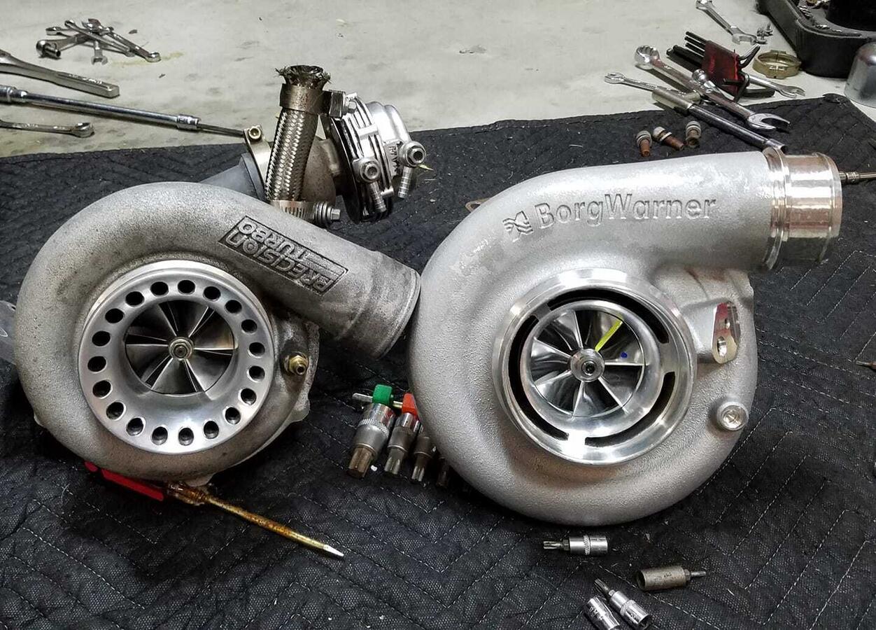

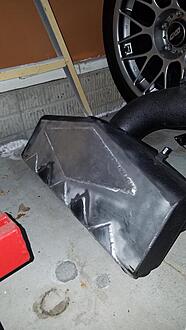

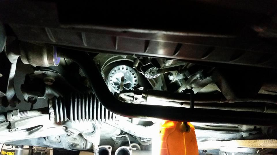

                The intake pipe for the turbo had the misfortune of rubbing on the sway bar and sending aluminum shards into the turbo. Last year I noticed the car would occasionally smoke and it gradually got worse though never being terrible. Again I contacted Mike and he recommended a Borg Warner S300sxe. By moving the torque hit higher in the rpm range, it should offer a little protection to my poor original rods that had been taking a beating.

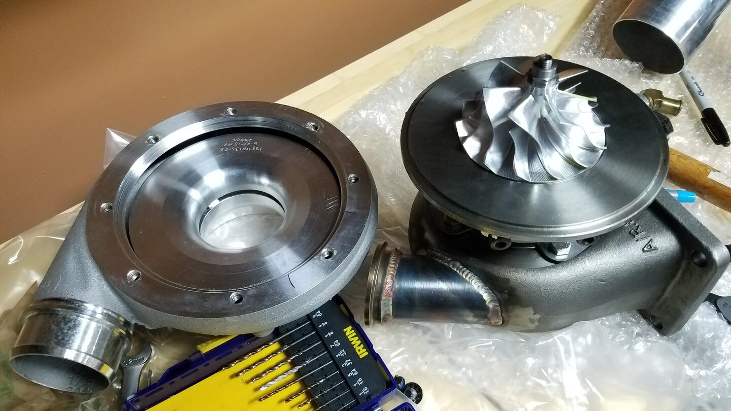

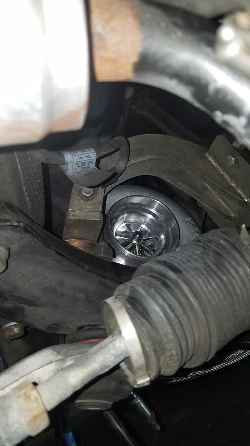

                The front side of the turbo arrived quickly but the exhaust side needed to be modified to work with my setup. Once it arrived, it needed to be installed and clocked. The port for pressure also needed to be drilled.

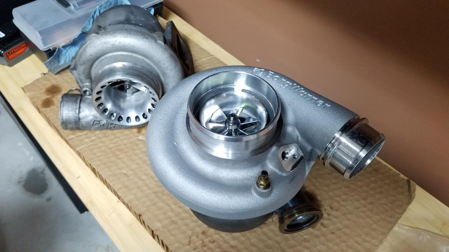

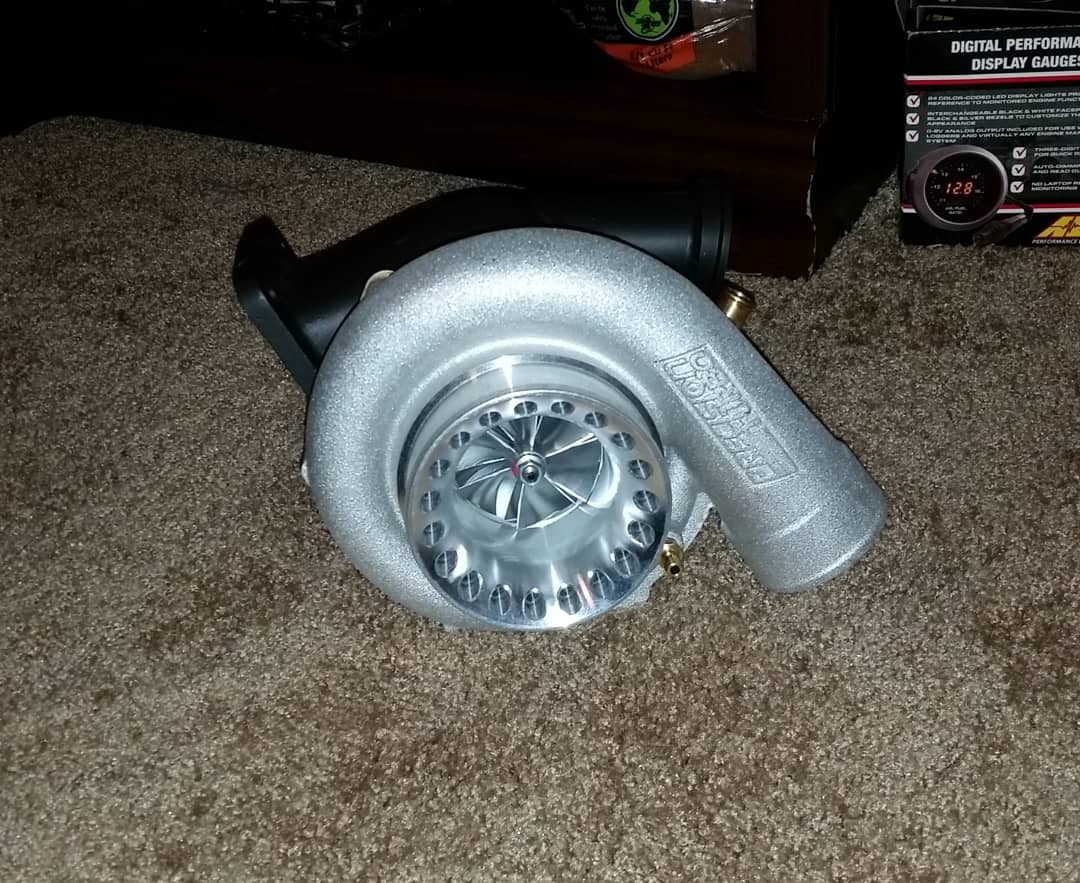

                  The BW compared to the Precision 6266 is super laggy. When roll racing at the track if I'm not brake boosting it feels like the car is broken. It is however a lot of fun to drive and I started pushing the pressure higher. I've run as high as 25 psi but had difficulty with the welds on the intake manifold cracking and needing to be reinforced.

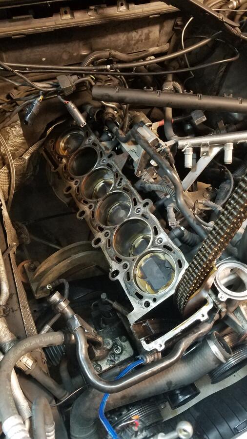

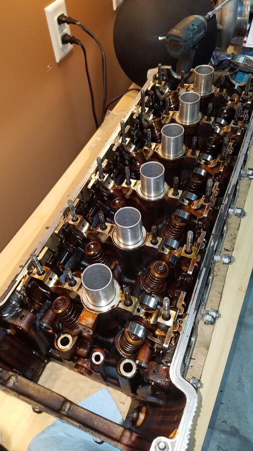

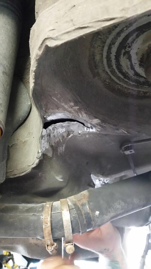

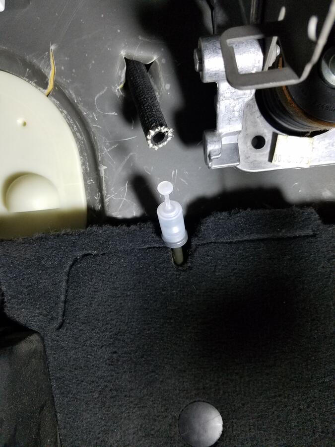

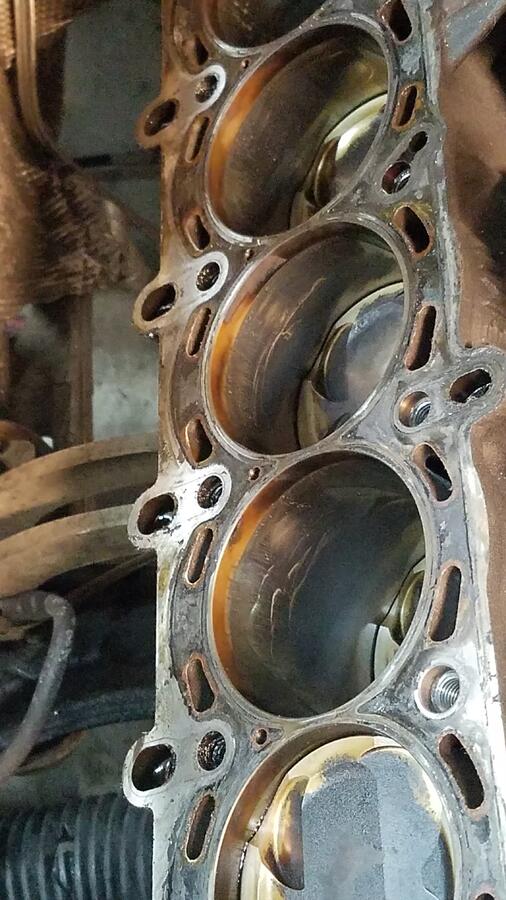

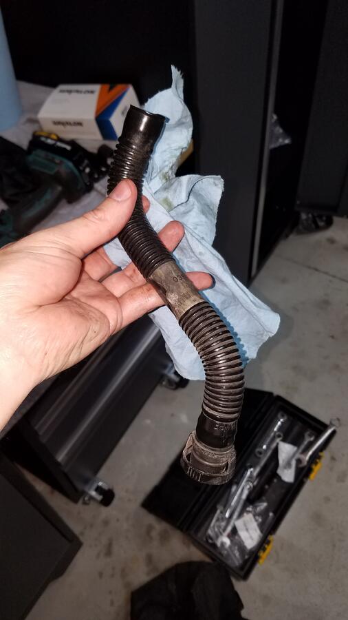

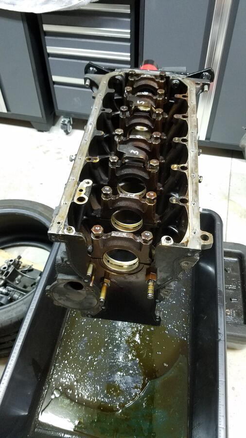

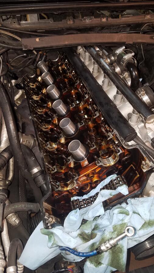

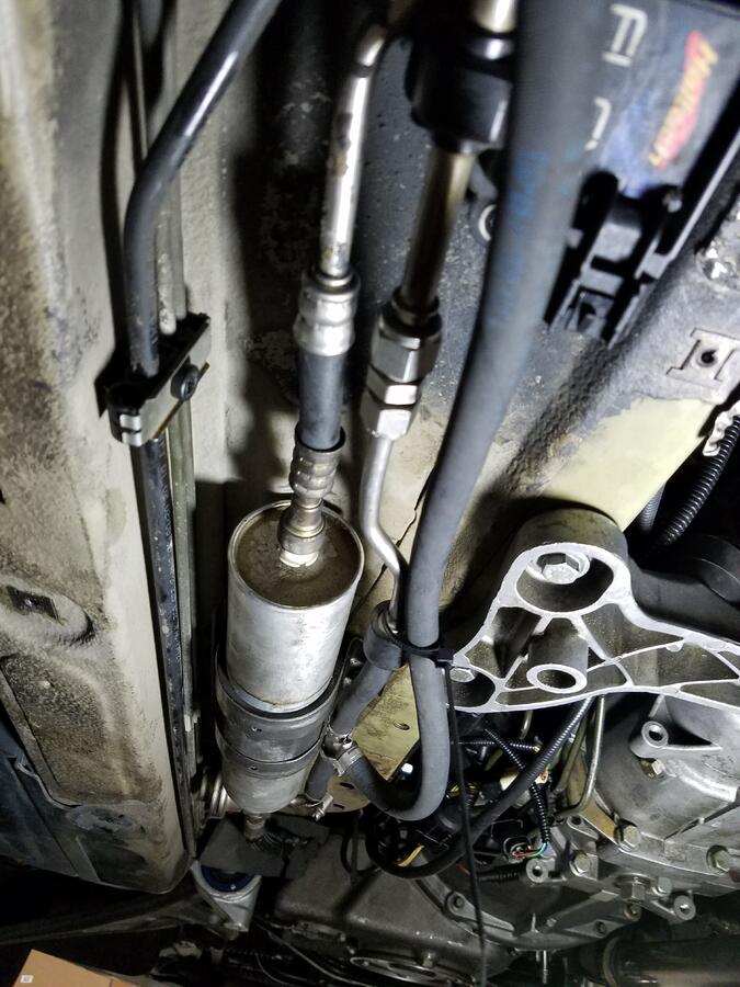

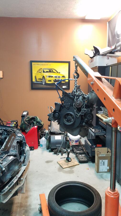

                    After a cruise in December, the car developed a vacuum leak. I was in the process of hunting it down when I decided to pull the engine and build it.
                    Click image for larger version  Name:	20200126_195445.jpg Views:	0 Size:	141.9 KB ID:	3966
                    Possibly the source of the vacuum leak
                    Click image for larger version  Name:	20200224_223135.jpg Views:	0 Size:	46.9 KB ID:	3967
                    Click image for larger version  Name:	20200226_225041.jpg Views:	0 Size:	96.9 KB ID:	3968
                    Click image for larger version  Name:	20200308_170155.jpg Views:	0 Size:	94.7 KB ID:	3969
                    Click image for larger version  Name:	20200314_161549.jpg Views:	0 Size:	70.2 KB ID:	3970
                    Click image for larger version  Name:	20200308_170207.jpg Views:	0 Size:	88.5 KB ID:	3971
                    Click image for larger version  Name:	20200309_210704.jpg Views:	0 Size:	91.7 KB ID:	3972

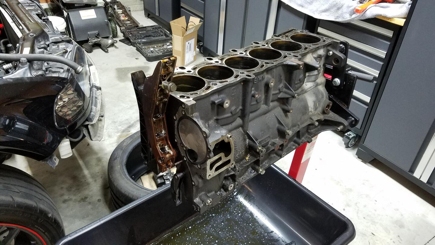

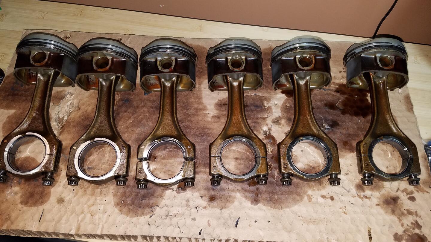

                    The rods all look shockingly good for having pushed out over 800 whp on their last run.
                    Click image for larger version  Name:	20200322_160417.jpg Views:	0 Size:	212.0 KB ID:	3973
                    Click image for larger version  Name:	20200322_185933.jpg Views:	0 Size:	188.8 KB ID:	3974 Click image for larger version  Name:	20200322_191549.jpg Views:	0 Size:	77.8 KB ID:	3975

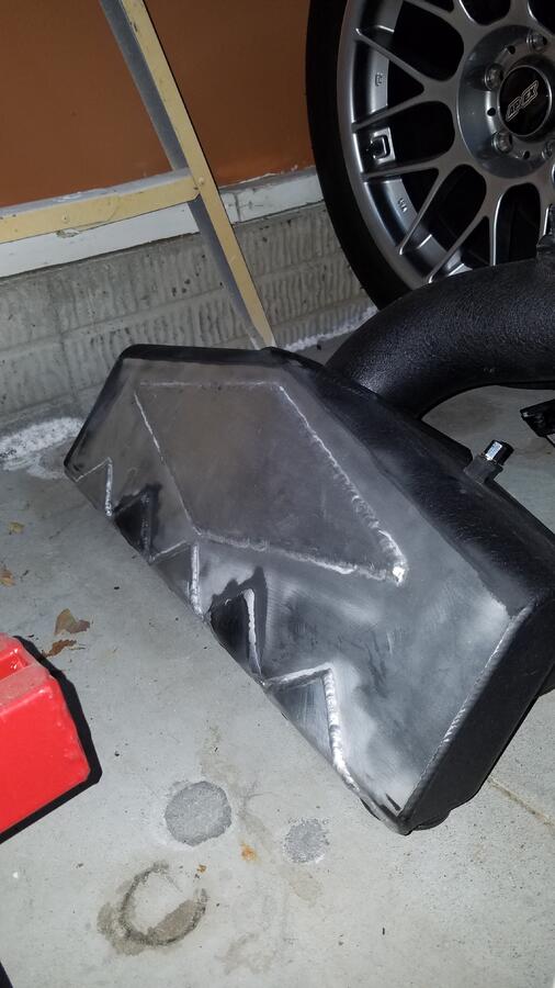

                      Digging the build. I love the car. Good insight on the BW vs precision.
                        What intake manifold are you going to run now as the max psi one is cracked??
                          To piggy back off of the previous post, NFA in Southern Cali makes s54 intake manifolds. They’re on cars with over 1,000whp. Check them out on Instagram @nofuckinaround
                            A friend had his father in law reweld it and reinforce it with a plate across the top and across the throttle body side. Max psi said they started welding 3 dowels from top to bottom along the throttle body side. The cracking is caused by the pressure flexing the top plate causing it to bow out. Click image for larger version
