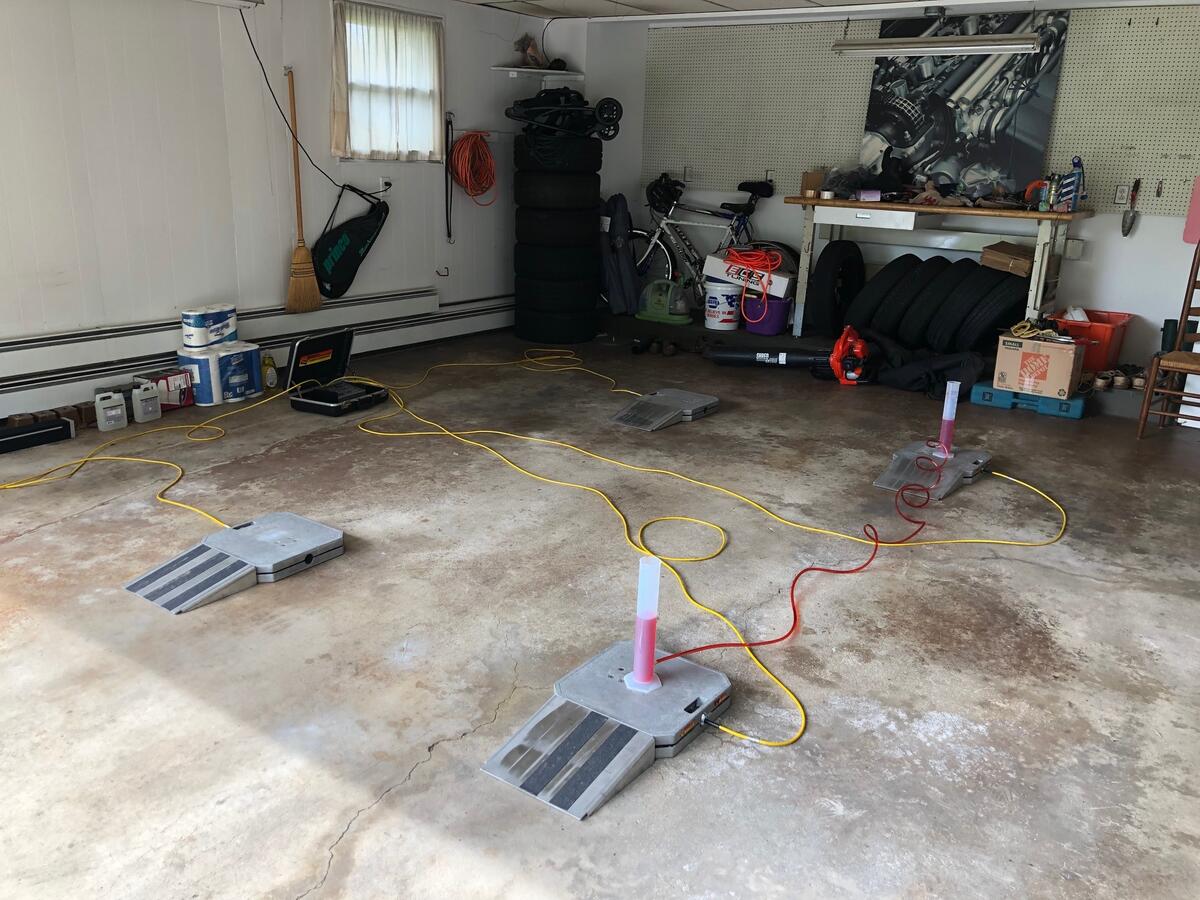

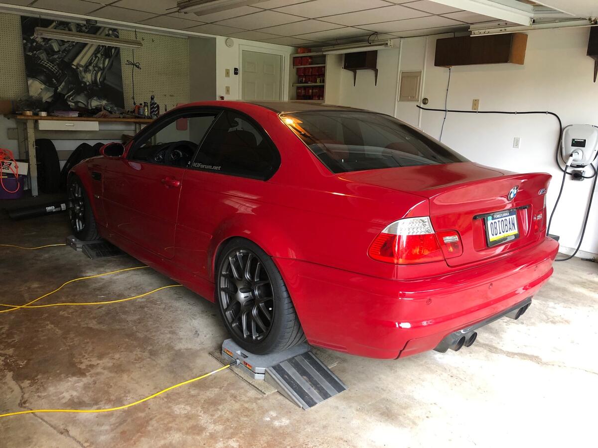

                          Made some changes to the suspension, which included eye balling the ride height (with a tape measure). Spent 2 hours setting up and leveling my scales, only to sit down in the car and find the cross weight was already at 49.9%. Le sigh.
                          Interestingly, though, I did notice that the cross weight stays identical to the .1% when I'm in the car or not-- which I believe means my COG is exactly centered between the front and rear axles in my natural driving position. Kind of cool.
