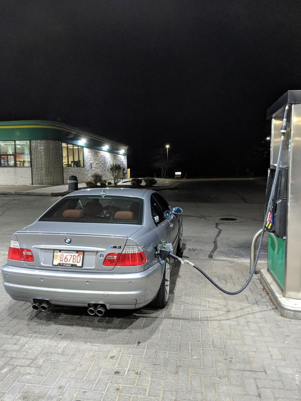

        ​Oh, I forgot to mention that when I bought the car, it came with both an aFe intake, and a Magnaflow exhaust. Unfortunately it had seen better days, and the tips sat way, way too low for my liking. I ended up replacing the exhaust, and installing some catless Megan Racing headers, and section 1, and well as Megan's section 2 which turned out to be a massive bottleneck for the car. In fact, for months I replaced tons of consumables on the car including spark plugs, coil packs, TPS sensors, fuel filters, and more trying to figure out where the hesitation was coming from. As it turned out, the straight-through design of Megan's section 2 was the source of my issues, and thus, I sourced a factory section 2 which resolved my issues. After the catless headers were installed, I also removed the post cat-O2s since they no longer served a purpose, and deleted the EGT sensor, which required a tune. I went with BuildJournal's OTS tune, but I'm not all that happy with it at this point in time. Below is a photo of the car on the trip home from when I bought it with the Magnaflow tips in their rather saggy position:

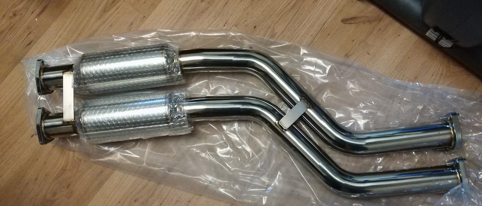

        Here's the Megan section 1, which is actually a really nice piece with 2 large resonators to cut back on some of that infamous S54 rasp:

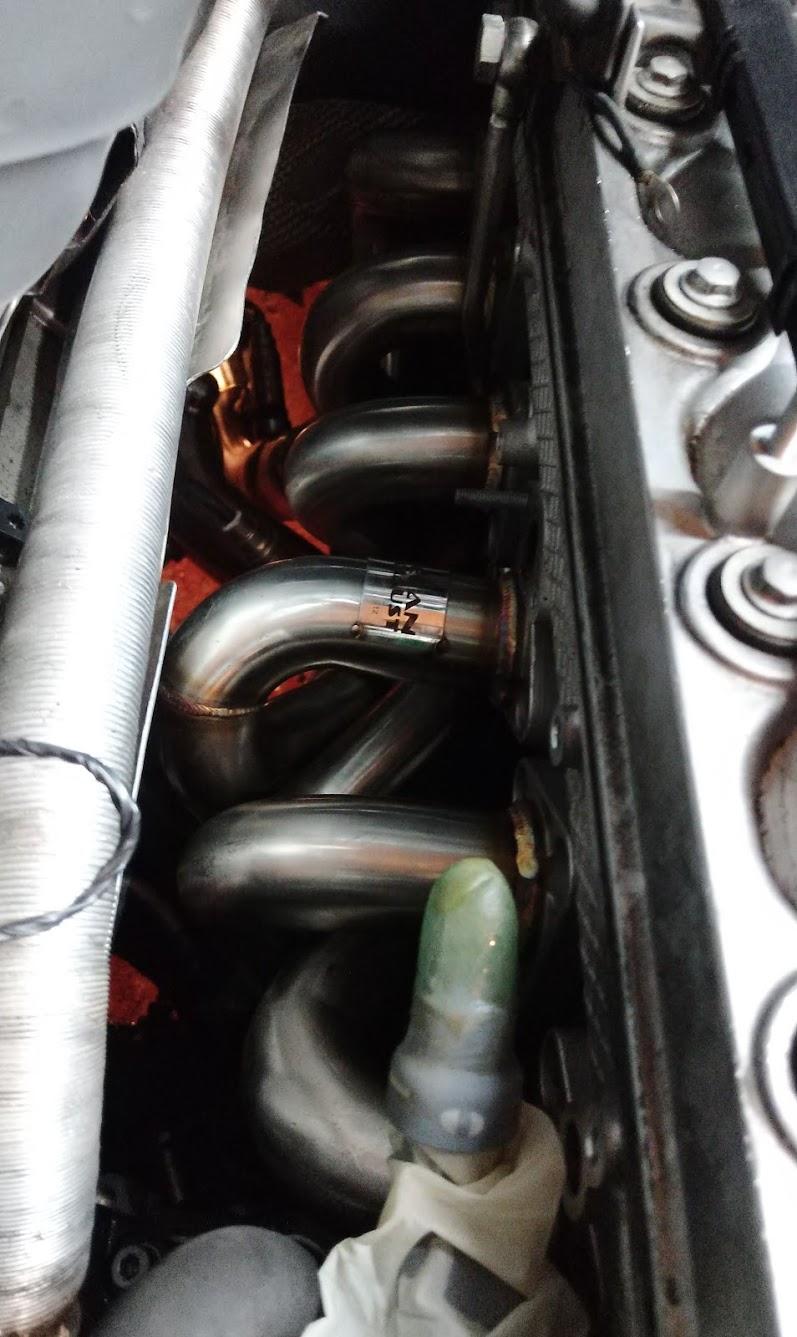

        And here's some photos of the Megan Headers:
        And some photo's of the install:

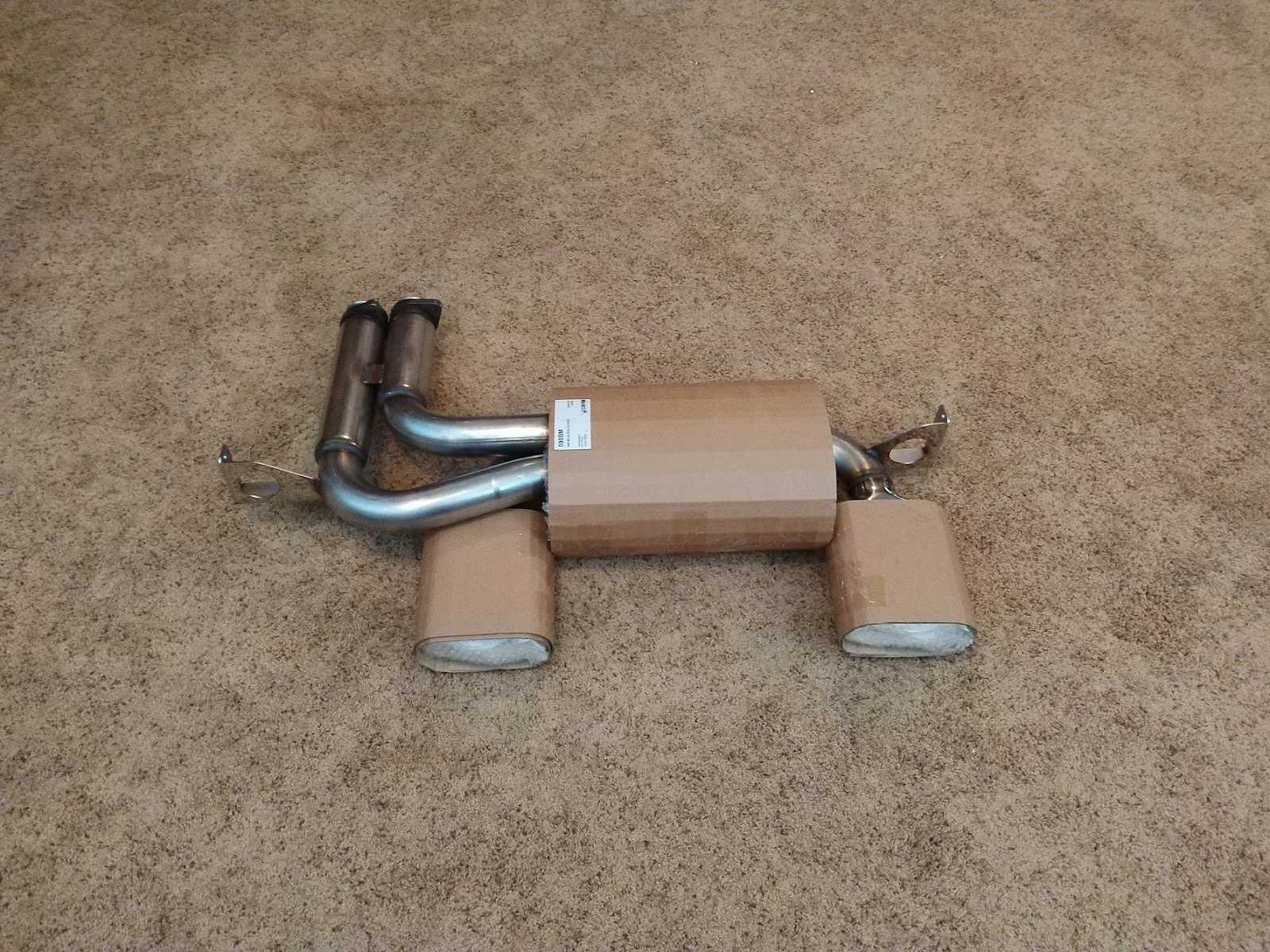

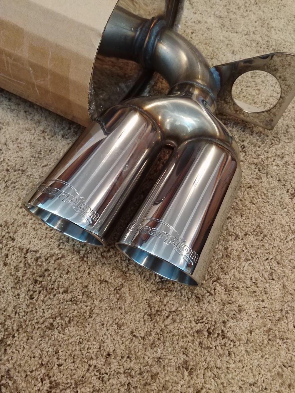

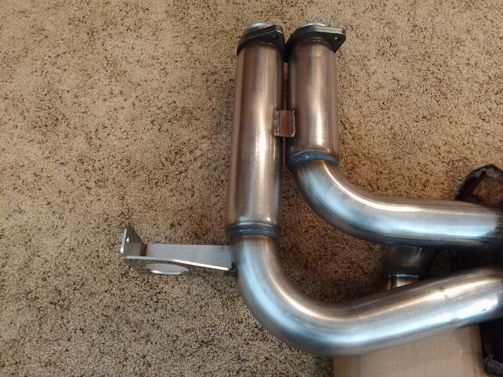

        Since the Magnaflow uses proprietary fittings, and is an entire catback I also had to replace the section 3. Again, I'm not sure how long I'll be keeping this, but I bought a Scorpion section 3, which I bought from a UK seller since they're somewhat challenging to get in the States:
        Here's the car with the new exhaust installed and the tips positioned how they should be!

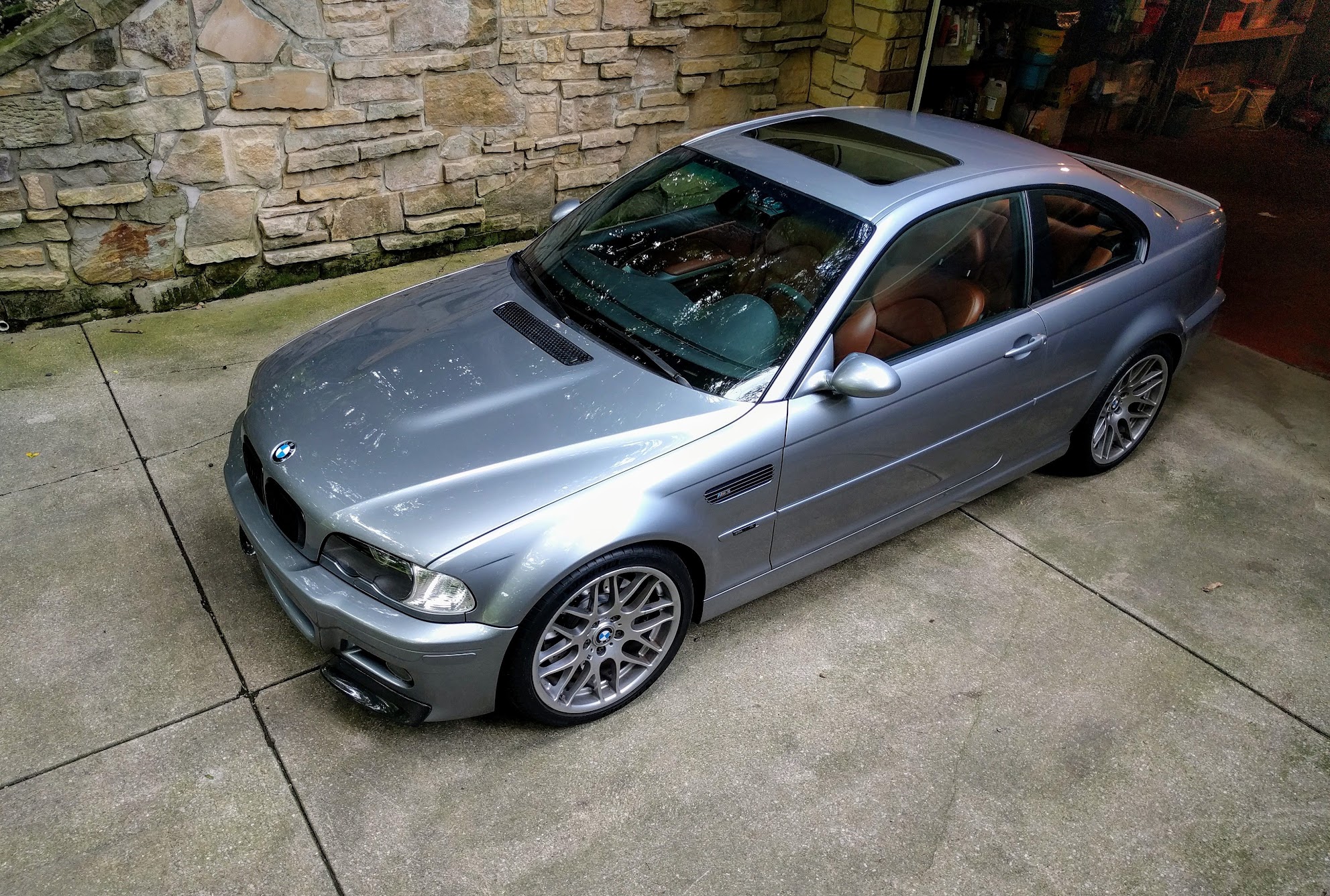

            The most recent modification I did was a set of Bilstein PSS10 coilovers, some Turner Motorsports adjustable endlinks, new front control arm bushings (FCABs), and an H&R 30mm sway bar. I also sold the aFe intake on the car per the recommendation of countless M3F members, who suggested that it was more likely causing me to lose power than gain it. Being it wasn't something I installed, I didn't have the stock part. Thus, I was able to source a stock intake from another member with a BMC filter. To reiterate, I didn't remove the aforementioned flippers until very recently, so I apologize if they offend anyone.
            Post coilover install:
            I also ended up putting some spacers on to make the ZCP wheels sit a little bit closer to flush:
            Ah, no more flippers at last:
