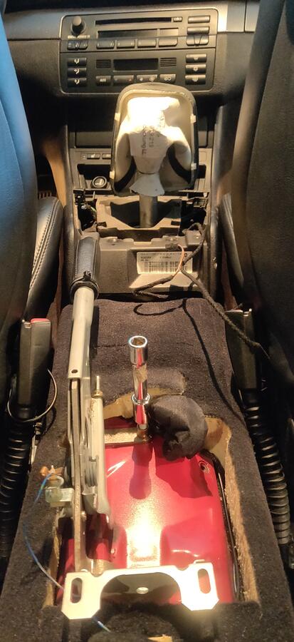

    Got rid of the gross shift knob for a much nicer shift boot and shift knob

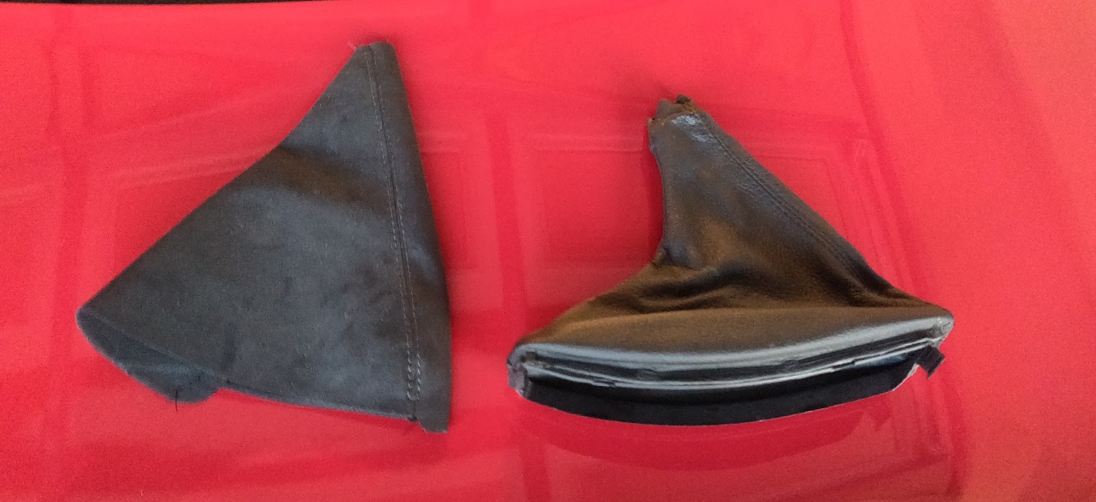

    Also got an alcantara ebrake boot

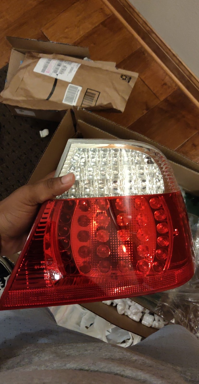

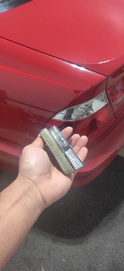

    Did a little cleaning and tossed on the LED tailights. I’m not a fan of this look. I’ll be reverting back to stock tails

        Nice car! Love the OEM CSL trunk. What LED tail lights did you go with?
          I went with the depos. They don't throw a code but the plastic piece inside the trunk doesn't fit. It's the trim where the bulb for the trunk lights up when the trunk is open. I'll be selling the depos soon. Other than that they're great.

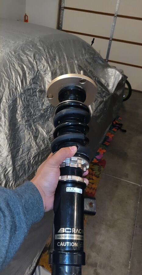

                    I bought bc coilovers for the car. I figured since this is a street car, it should be fine.

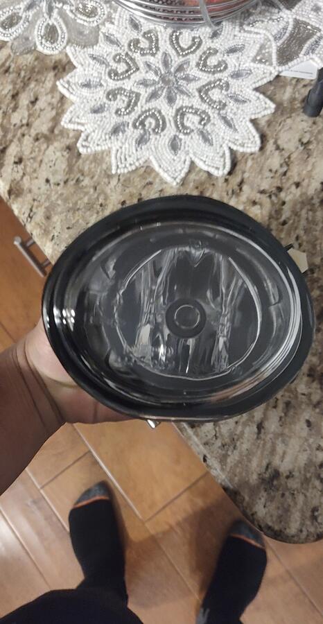

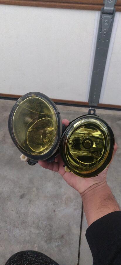

                    My foglights were showing a lot of wear and one was also cracked. I bought depo clear fogs and painted them yellow.

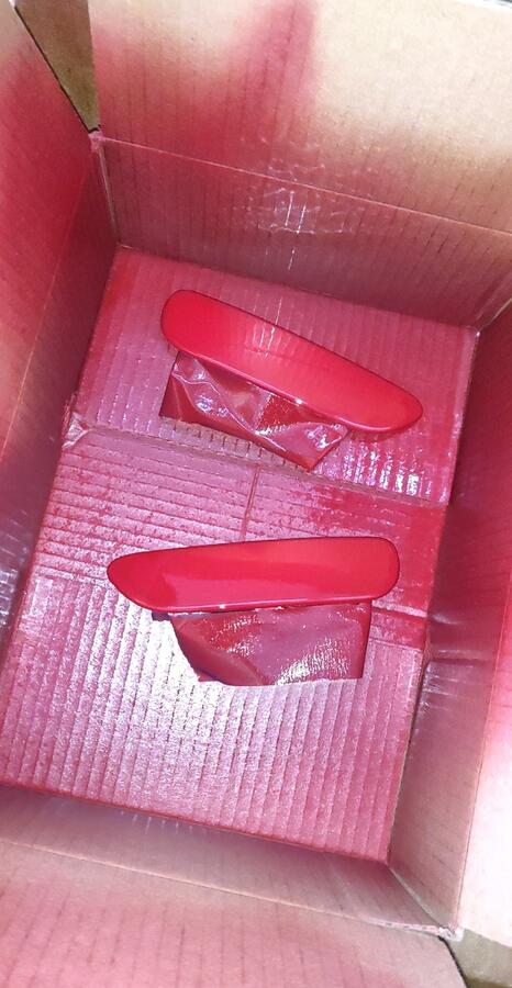

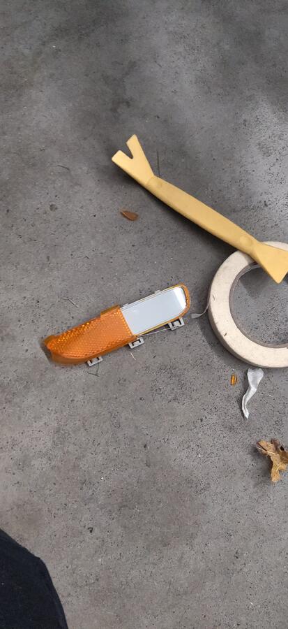

                    I absolutely hate the amber reflective corners. Not only are they a PITA to get out and install. They look awful. I bought clear ones and then painted them in imola red. I managed to break one of the new set after painting it while installing it.

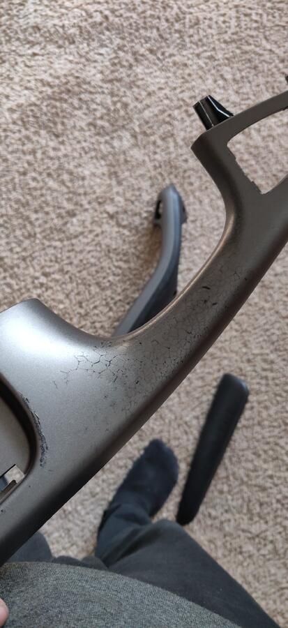

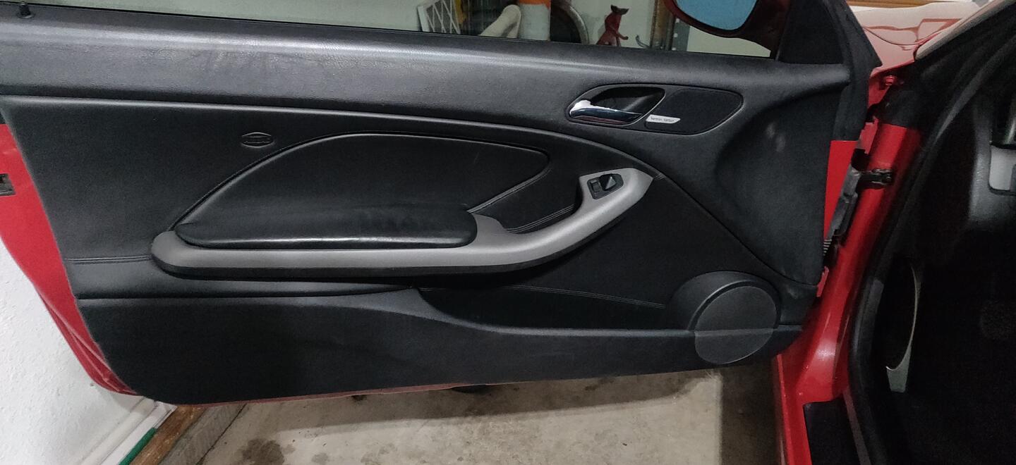

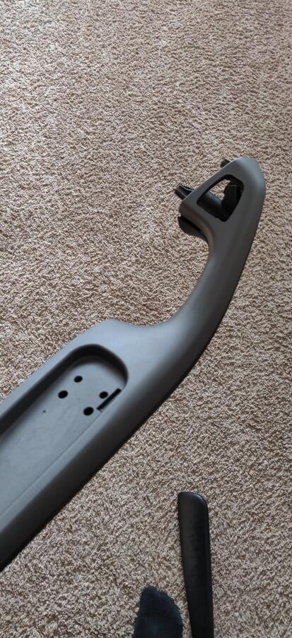

                    My interior trim pieces were showing a lot of wear. The previous owner wrapped the brushed aluminum trim and swapped the door panel arm rests too. They didn't look like they belonged to a 100k mile car so they had to go. While removing the door panel I discovered a lot of mismatched/broken interior trim clips. I wonder where my rattle was coming from.

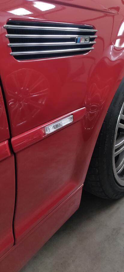

                    Also got new sidemarkers
