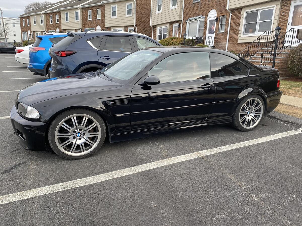

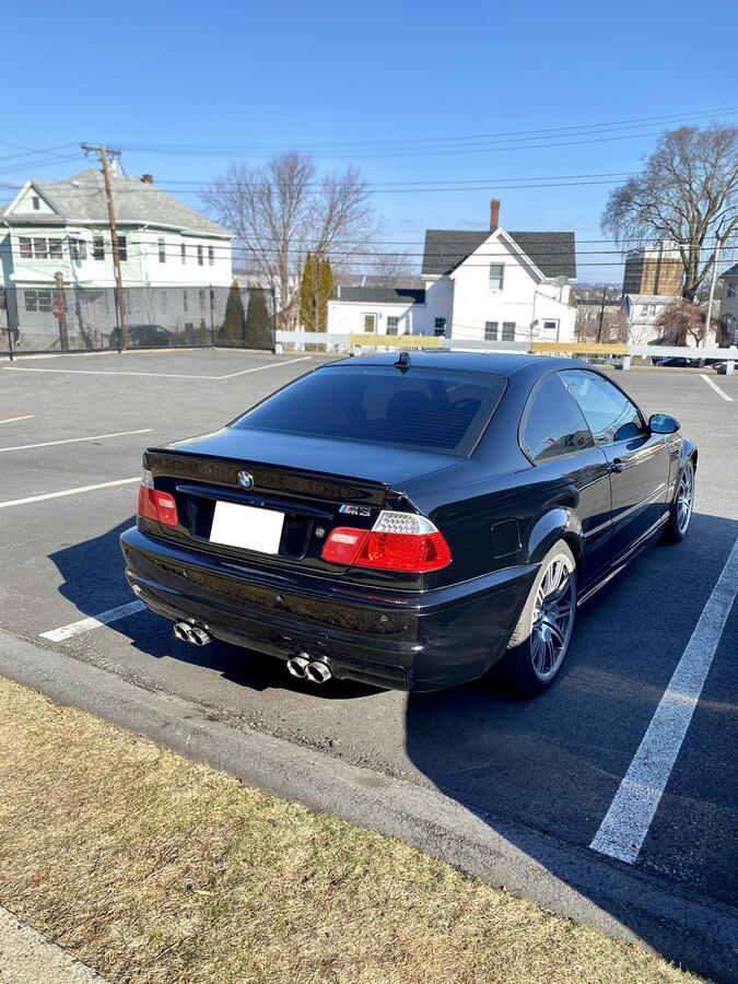

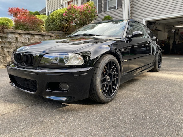

    Heres some general pictures:

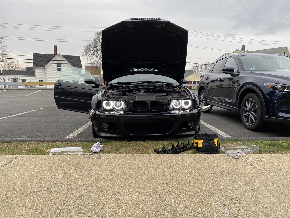

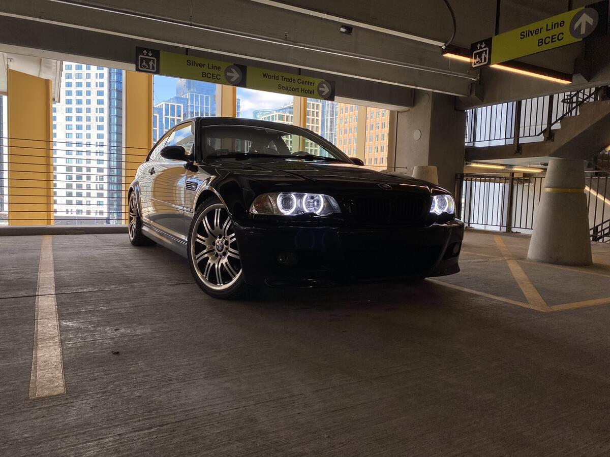

    I love the look of Angel Eye headlamps. I did some forum searching and decided to go with the Angel Eye Guy (https://angel-eye-guy.myshopify.com/...gel-eyes-white). A handful of options with good response time. I also like there were DIY guides on the website. I ordered up the standard LED, opaque, non switchback style. I received after a few days of shipping. Using the instructions on the website I was able to install these within two hours time. I love the look the give the car. Overall I am satisfied withe product.

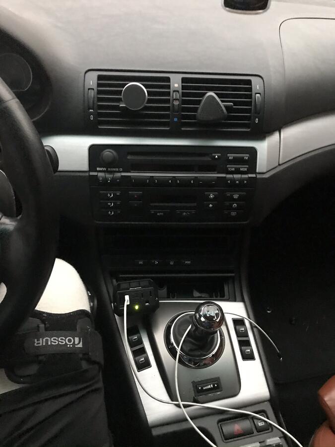

      Before.. just the standard business head unit.

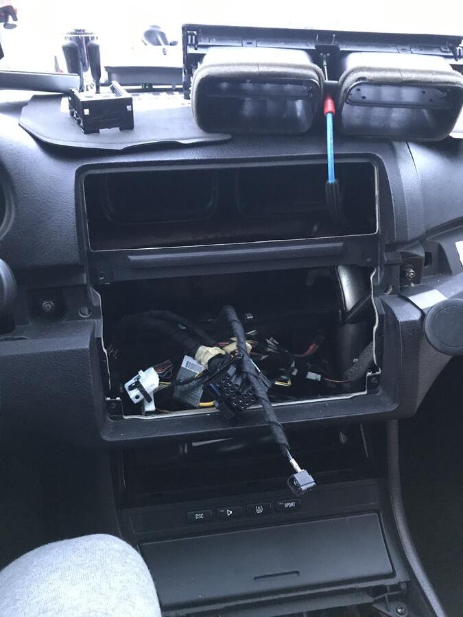

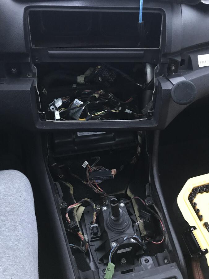

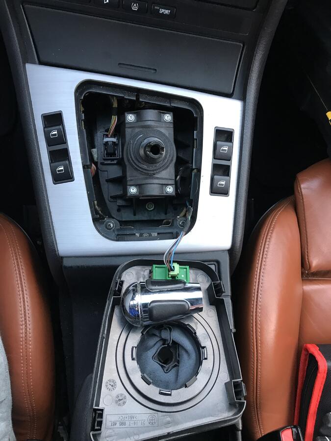

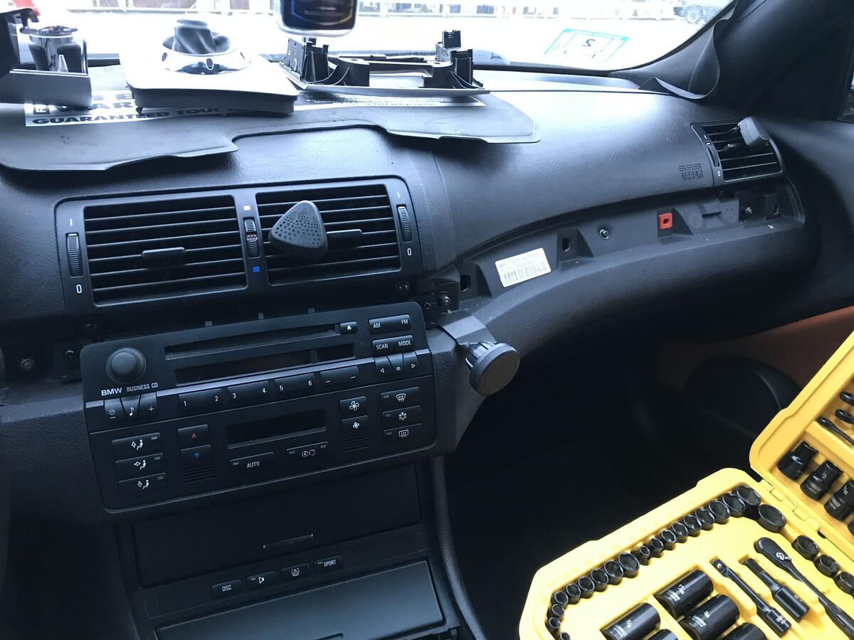

      I first took everything apart to get ready for the new components. This was pretty simple and included removing the dash trim, the old head unit, center console trims, and the old cig lighter/sunglasses case frame. Additionally I went ahead and took apart the trunk lid to prep for the camera install. The most useful videos for this work are below.Click image for larger version

      Once everything was apart I prepped for the install. I unboxed everything and got it all sorted before diving in. It was particularly cold out on the day I did it so there was not time to waste outside.
      I went first to the Dynavin HVAC relocation kit. This went in fairly easy and I opted to button the center console trim back up before testing. No issues there.

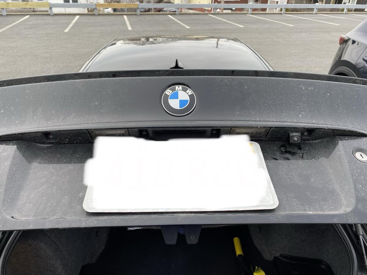

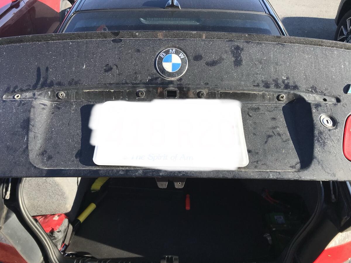

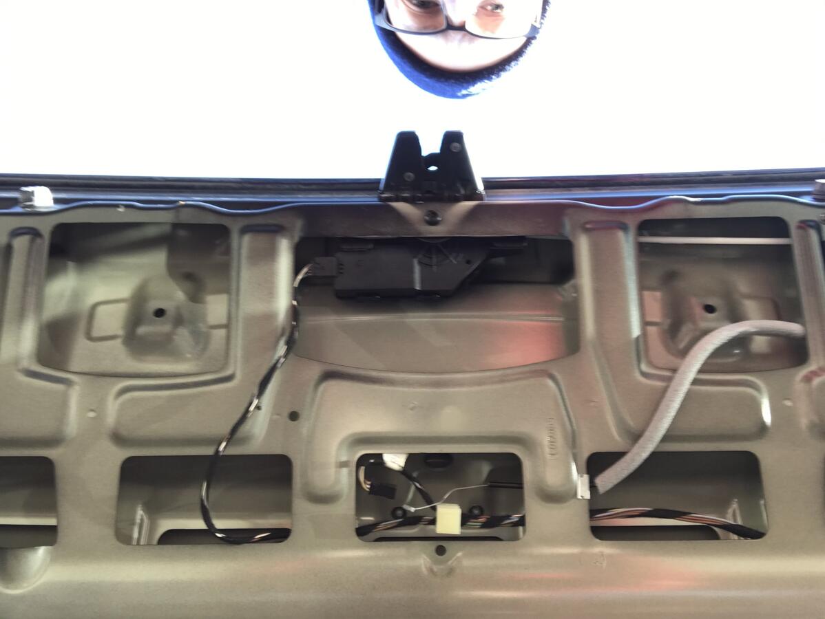

      Next I went after the back up camera and transmitter. I initially tried to run through the trunk release wiring hole but with the weatherstripping tight there was no way to get the release trim back in place snuggly. Following some deep through I pulled out the drill and poked through in the trunk with two new holes for the camera and wiring. I mounted and tightened the camera about 85% so I could twist after and get it dialed in. From there I spliced the transmitter wiring with the camera and splice those both into the rear left reverse light power and ground. I let things hang out until the rest could be buttoned up.

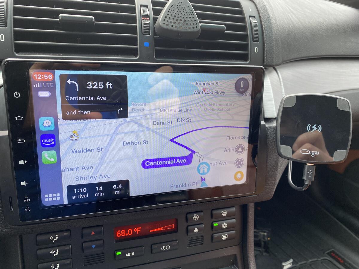

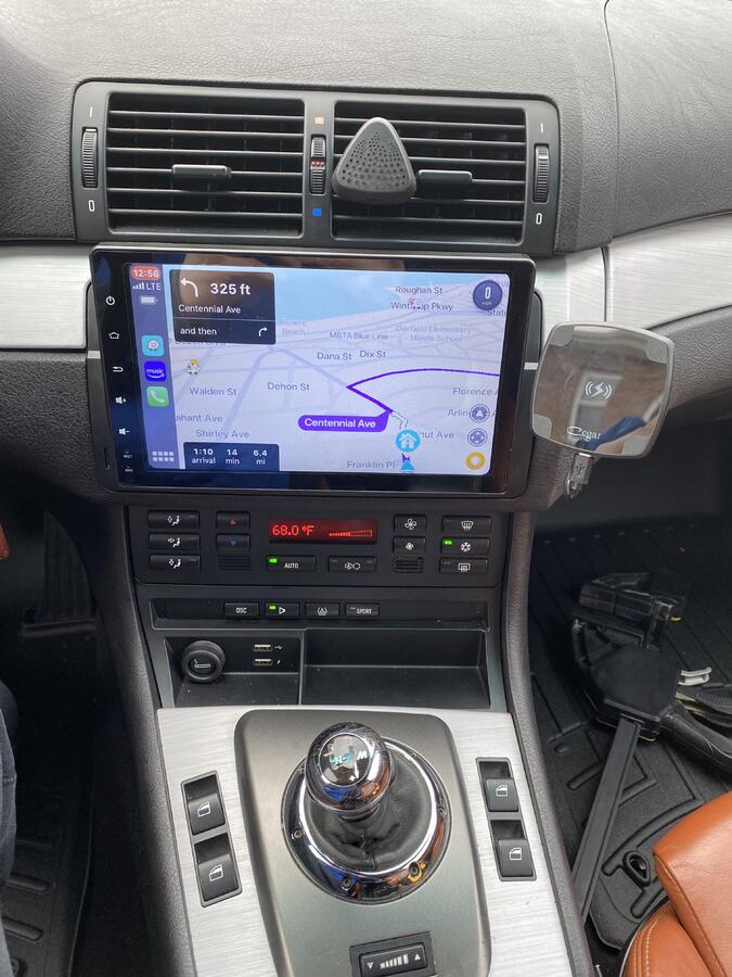

      Moving to the interior the head unit install was relatively painless. The timeliest thing I did was run the microphone cabling to the factory location. Having identified which harness was needed earlier I took all the cabling and plugged it all into the head unit. There are 3 USB ports, one went to the USB in the cig lighter tray, one went to the IBUS, and the last one went to the wireless charger.

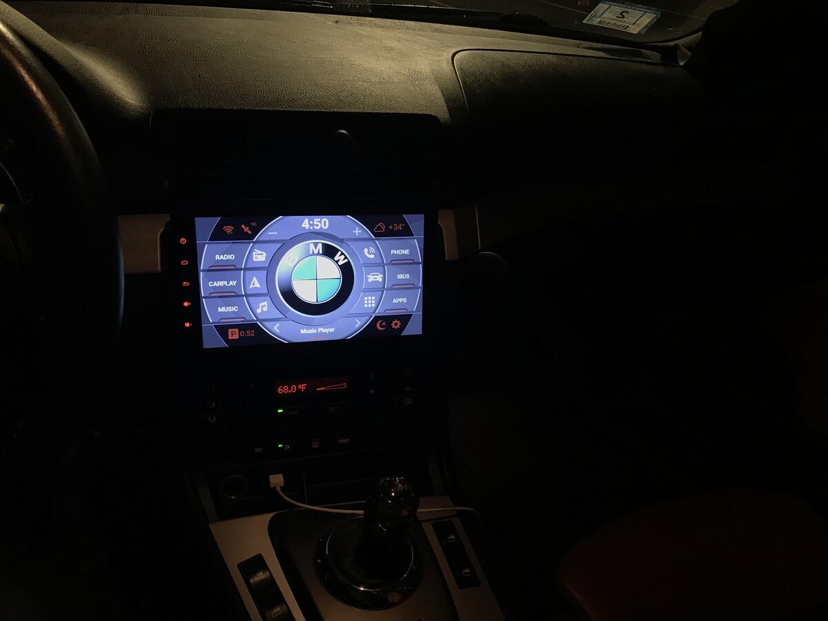

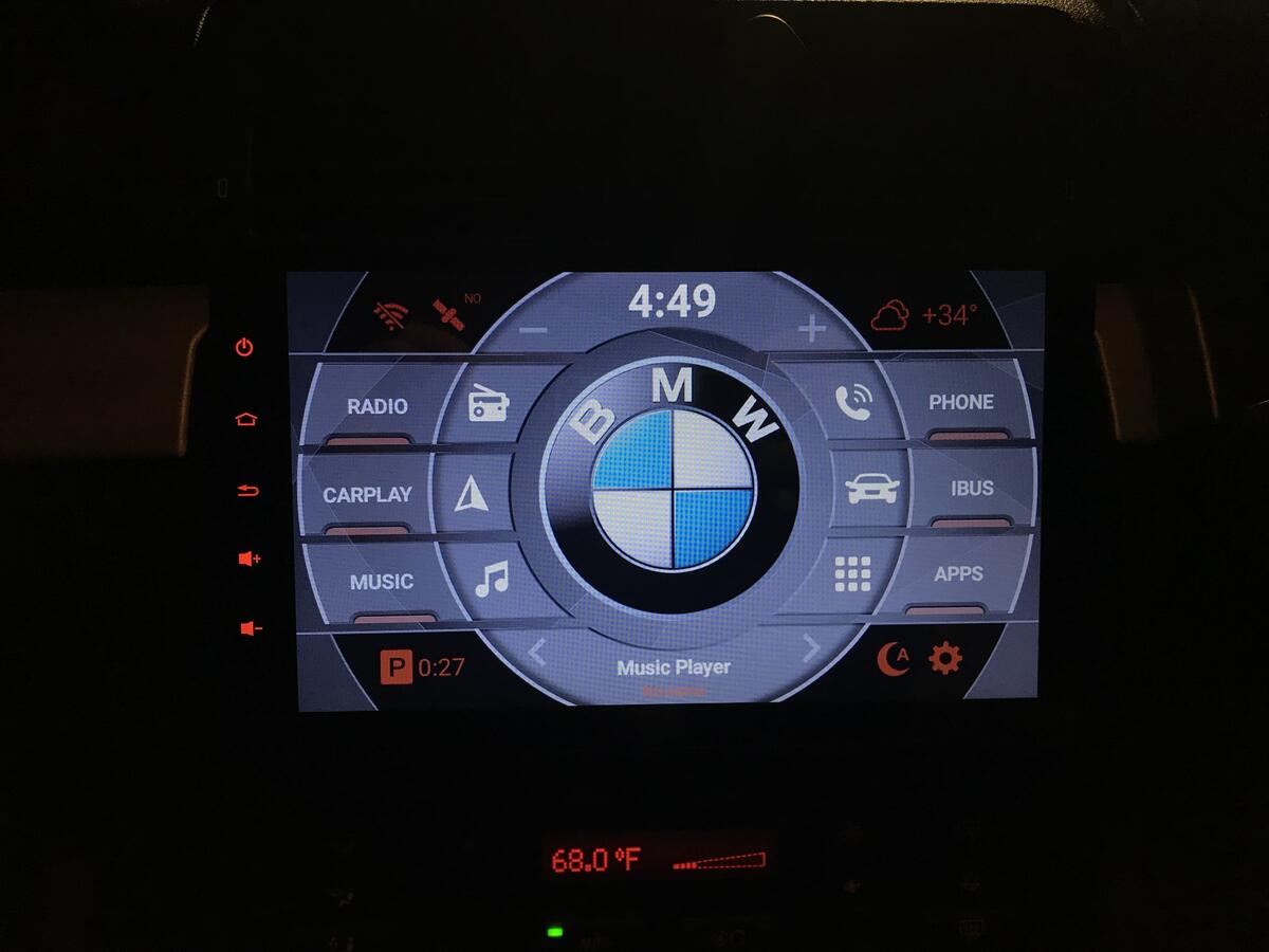

      I left the unit out for start up as I assumed there would be some general trouble shooting but to my surprise there was very little needed. The unit fired up quickly and with the help of a hot spot I was able to download the IBUS and airplay apps required for those functions to work. I also implemented the AGAMA Car Launcher app which has provided a much more thought out display.
      I messed around with the camera and found a position I liked. Once I settled that I was able to button everything up. The one tricky part at the end was getting the dash trim in over the unit. The unit is proud of the dash by about ¾” and makes it impossible to get the trim piece above on after the unit is in. Leaving this piece twisted in place while installing the head unit proved to be the solution.

      • If you’re doing the back up camera the trim kit above and a handy set of tools are a must

      • I also ended up using the AGAMA Car Launcher app which I think provides a good user interface and experience

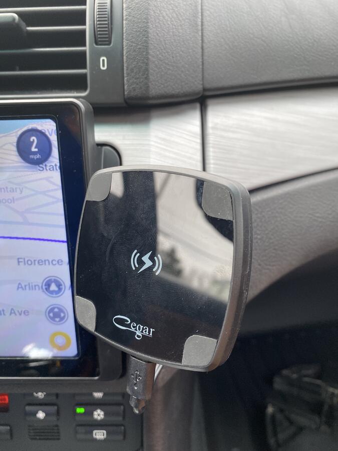

      After install pictures of head unit, magenetic mount, back up camera, and car launcher interface.
