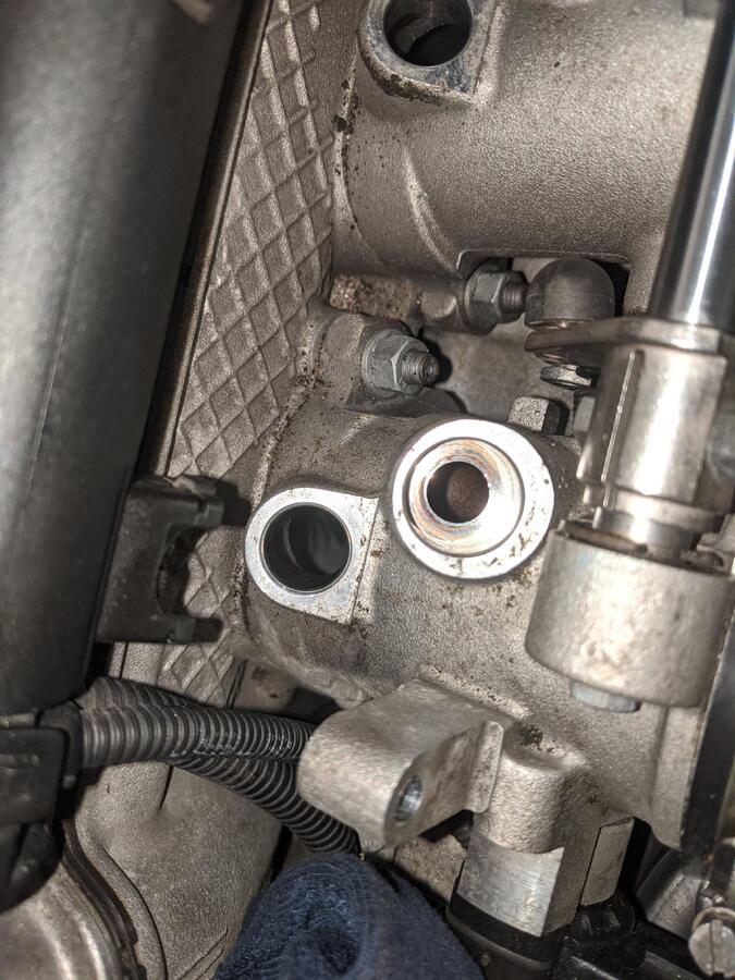

        The V1 box had the brake booster and bottom large hose connectors completely unglued. Probably why I always felt the car was a bit off since a few months after the original install last year.

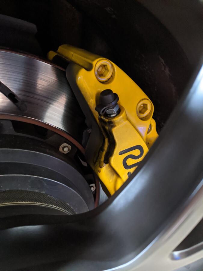

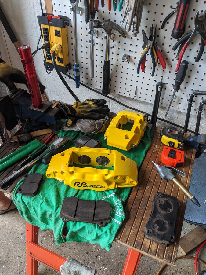

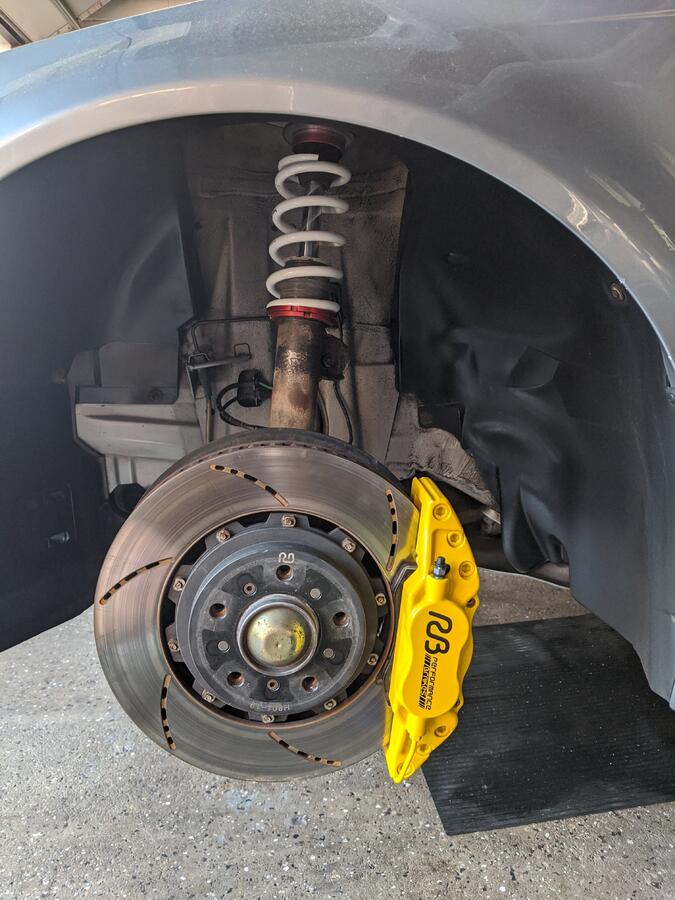

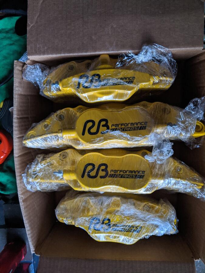

          Finally go my calipers back from powder coat and repaint, reseal. Since then I've noticed some quality issues with the rebuild, down to the fact that the shop doesnt deal with this caliper set at all. I was the first theyve ever seen. Still, if I can install seals better than them... yah annoying.
ID:	127162 Click image for larger version
ID:	127163 Click image for larger version
          For reference, I had to reseal the driver side of the calipers last year just after winter due to leaks. Seals had gone bad and they were the cause. From the pics you can see that this setup has both oil and dust seals inside the piston cylinder, when reseating the piston its quite a pita to get back in without screwing up the seals. Which I later found out they didnt do appropriately. You can see the seal peeking through in the pic below.
          The result after a track day
ID:	127166 Click image for larger version
          Ill keep monitoring this and trying to get it to work. For reference this is the kit thats on the car https://racingbrake.com/bmw-irp-11
          When its working properly, it's quite good. I've since ordered track rated pads from RB since that track day where I had aggressive street/sport pads. Another track day in 2 days time will tell me what the next steps are in this regard.

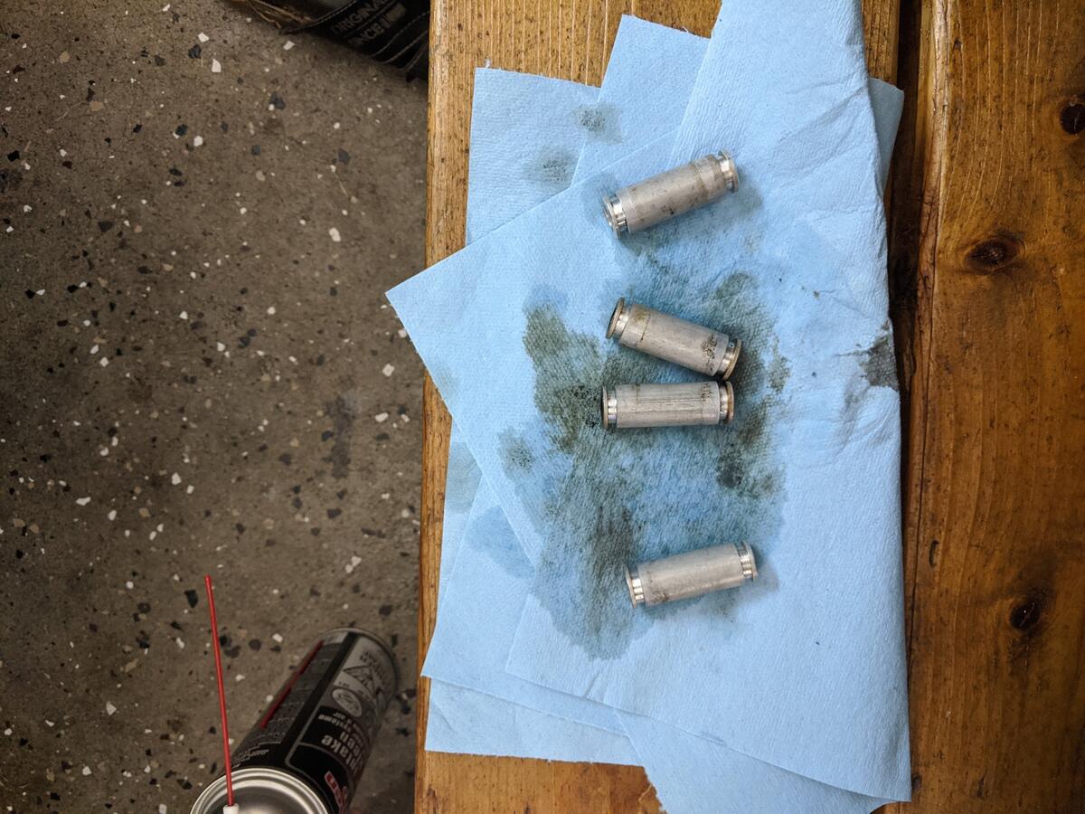

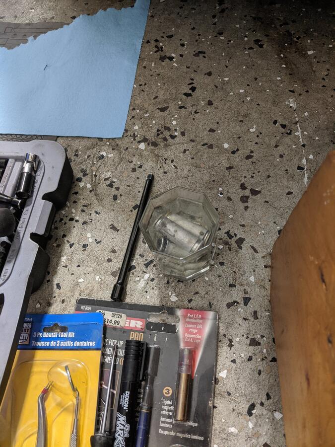

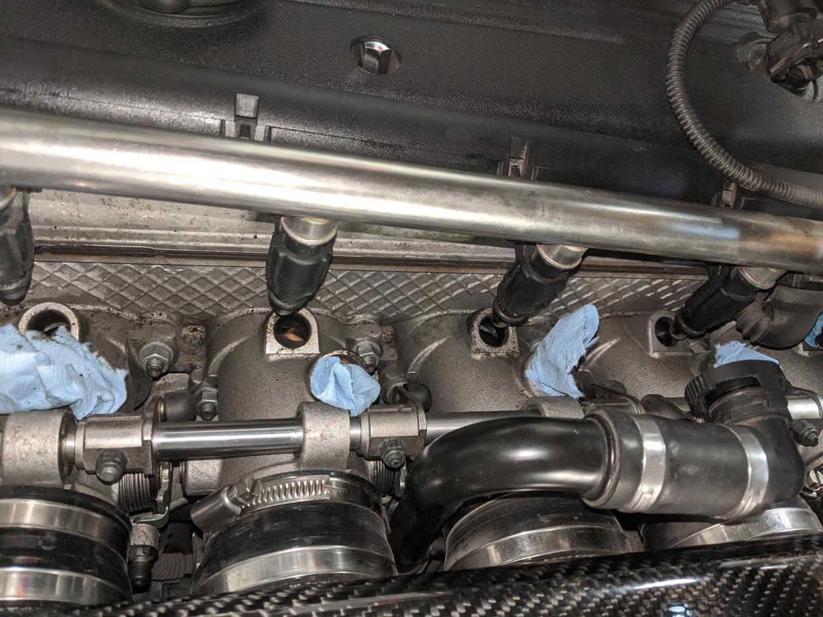

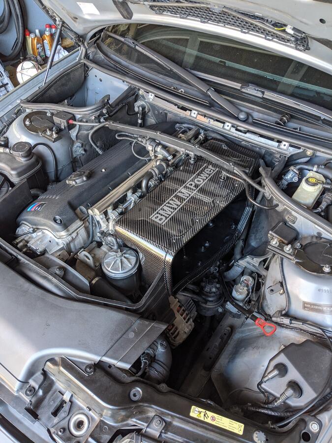

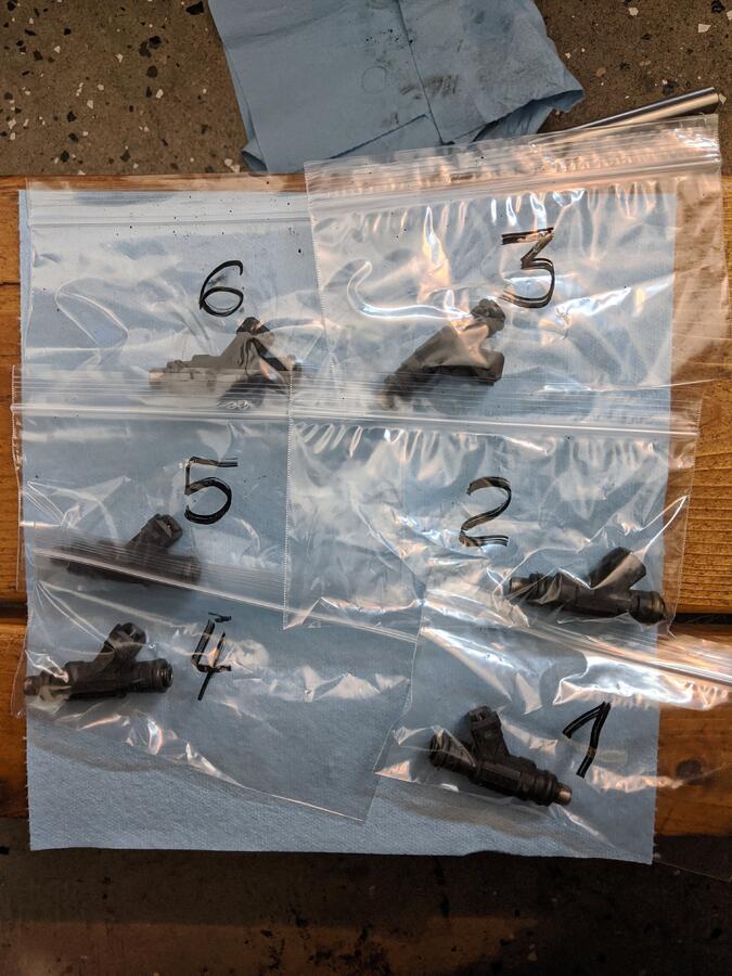

              Spring cleaning included, rebuilt injectors, cleaned air rail/valves.
              Bit of warm water and throttle body cleaner did wonders. Gentle scrub with Qtips to agitate gunk then shop towel for wipe down and clean. Mega satisfaction.

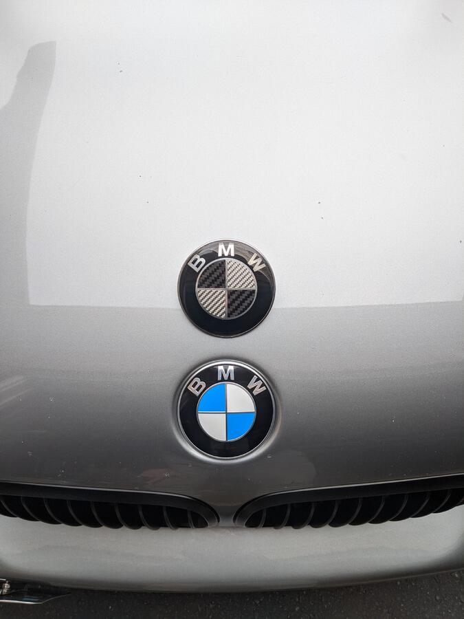

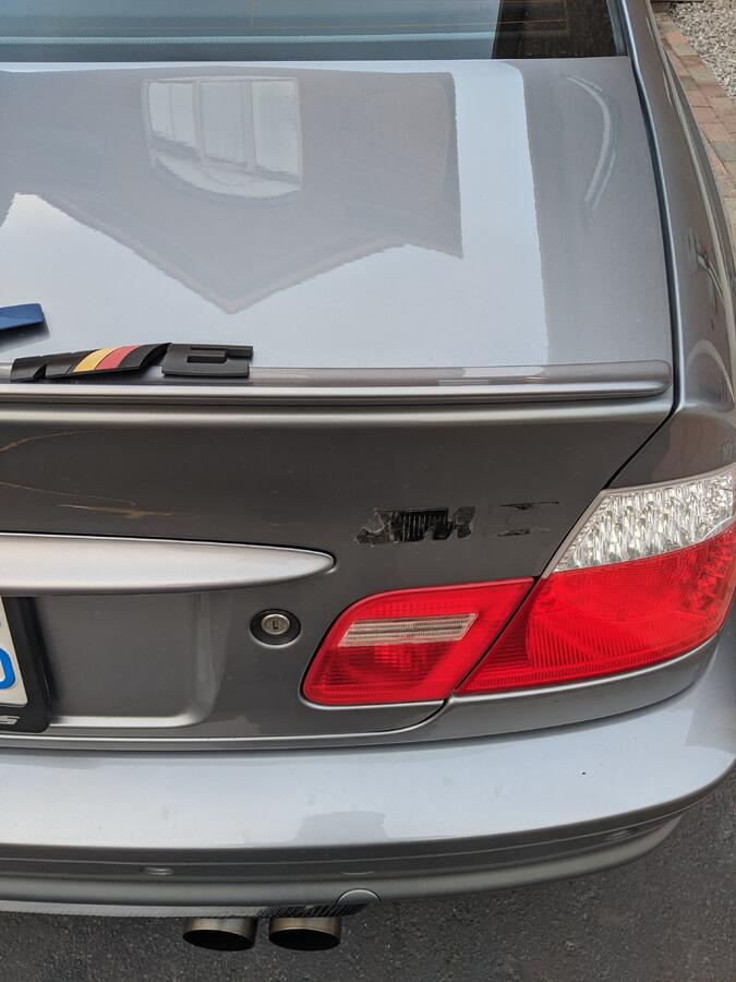

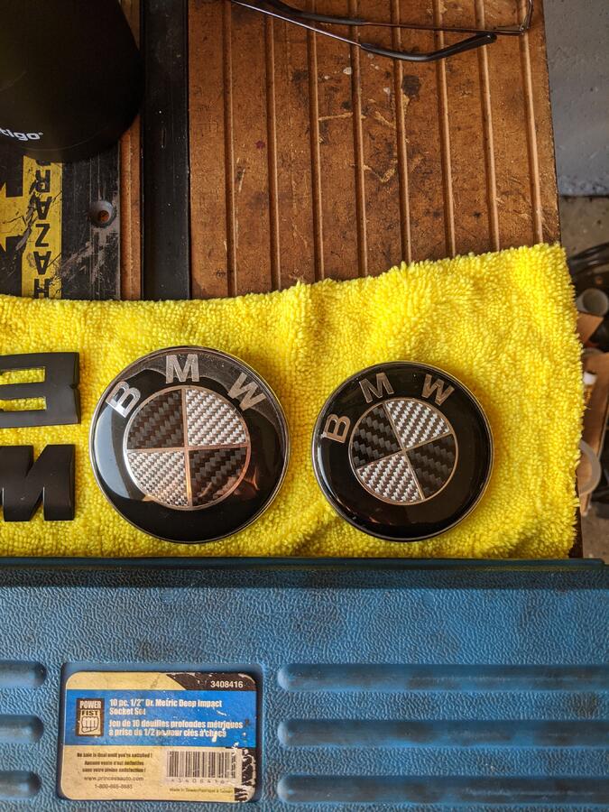

              Oh and also new OEM roundels and rear M3 debadge as its out of spec, way too large. I have a gloss black emblem but I'll wait to put it on until maybe a CSL trunk that I deem worthy arrives. Until then I live that 318i life.

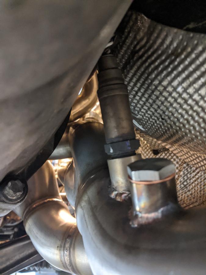

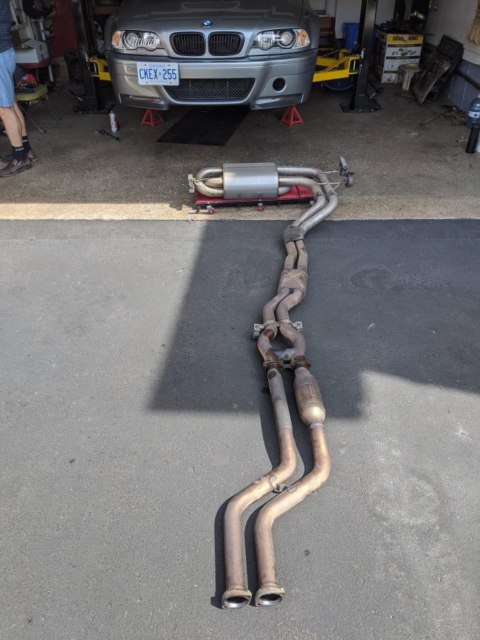

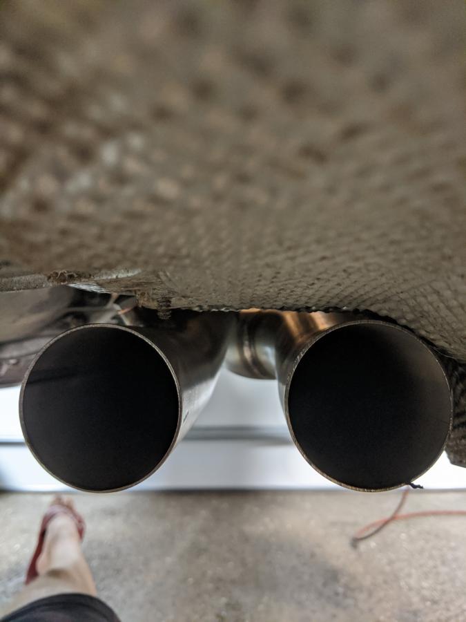

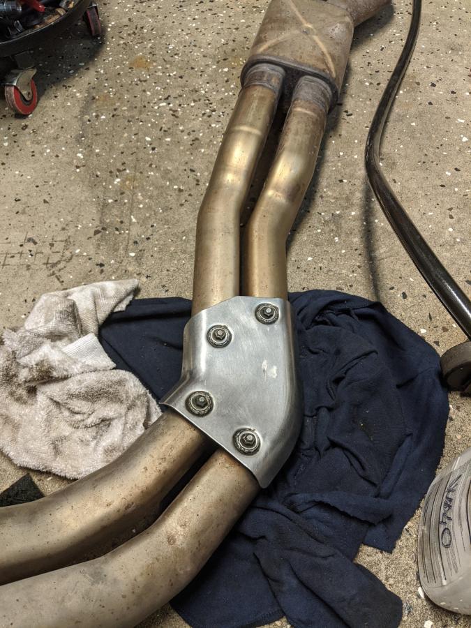

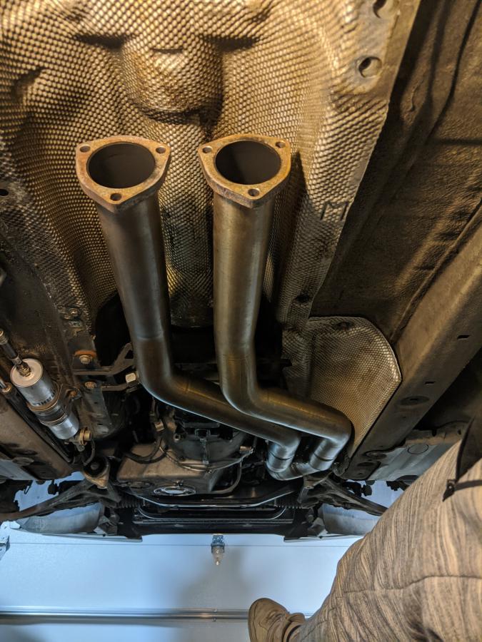

                To pick up right after the above. Fitted ssv1 catless dual exhaust and kept scza. This install was a pita due to the heft of the v1s. Didn't not enjoy at all. Then tuned a month or so after with Hassan again.
ID:	203125 Removal was quite easy lots of room with euros.
                Cleaning and making nice too.
ID:	203124 Click image for larger version
                Used the provided spacers from SS had no issues with rubbing of heat shield on sec2.

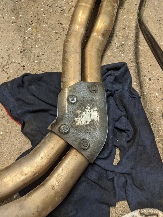

                Had to negotiate this gap a bit, some aggressive pressing to bend the heat shield was necessary.

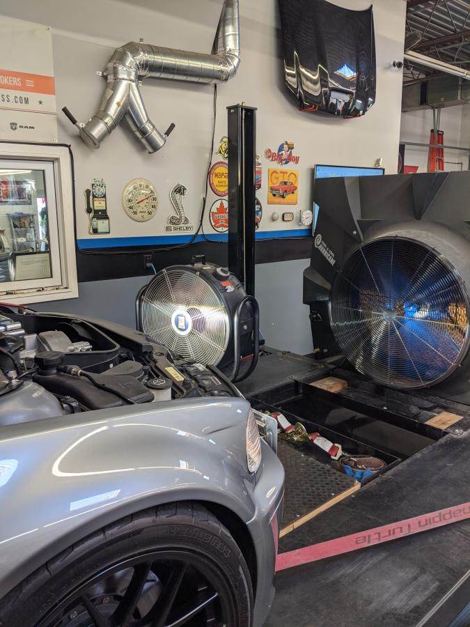

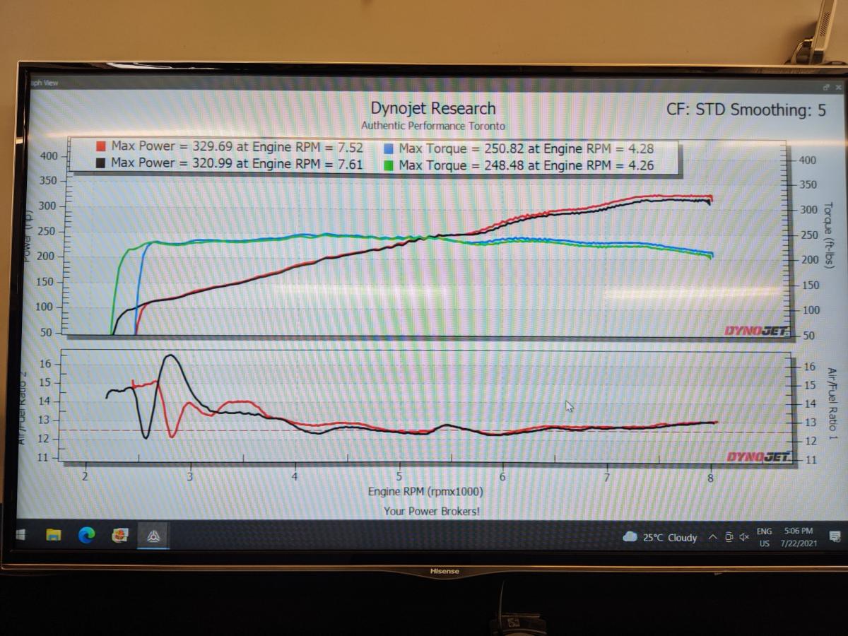

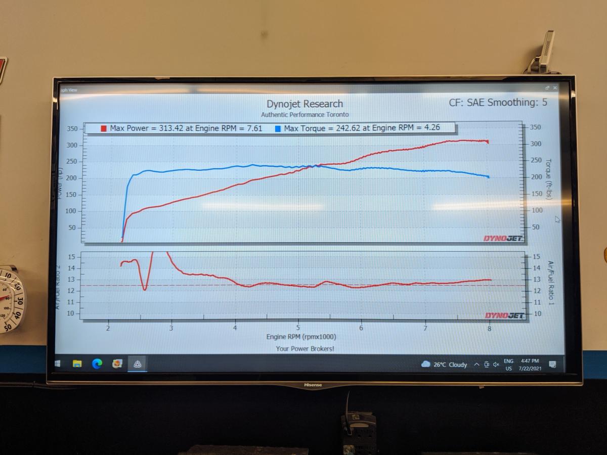

                  Tuning after on a different dynojet and different shop, done on July 22, 2021. The first run showed a baseline of 313whp and then Hassan went to work. The shops setup was quite good , large fan with condenser for blowing cool air. It was decent not great the temps outside were quite hot and eventually we would hit higher iats.
                  Was happy with the end result. Hassan mentioned car was making on average 10deg less timing than cars in the us on 91 octane. I had filled my car with 94 octane from Petro. Always have. Canadian cars do seem to struggle to meet timing targets vs US counterparts.
ID:	203139 Still need blower fans imo, car was heat soaked by run 4 numbers just started to drop off.
                  From the previous posts baseline run of 313whp ended with 329.69whp/250.89wtq sizeable gain. Hampered by temps in the shop ambient was high 80F i believe. We tuned my brothers E36 M3 just beforehand. I was hoping for something above 330whp but i couldn't book the same Dyno as last time and that has a huge effect, as well as similar time of year to tune. The overall delta of the session is what is amazing and super happy with.
                  Butt Dyno when I first drove this setup vs the euro OEM 1 and 2 with same scza was slightly increased midrange torque. Just felt more shove if that makes sense. Had no issues with quality and fitment, it was just a collosal pain in the ass to get these v1s on the block then tightening those FUKING nuts. I'd honestly rather pull the engine then do that shit again.

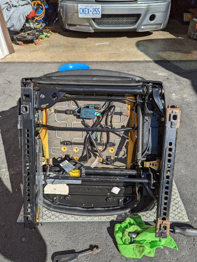

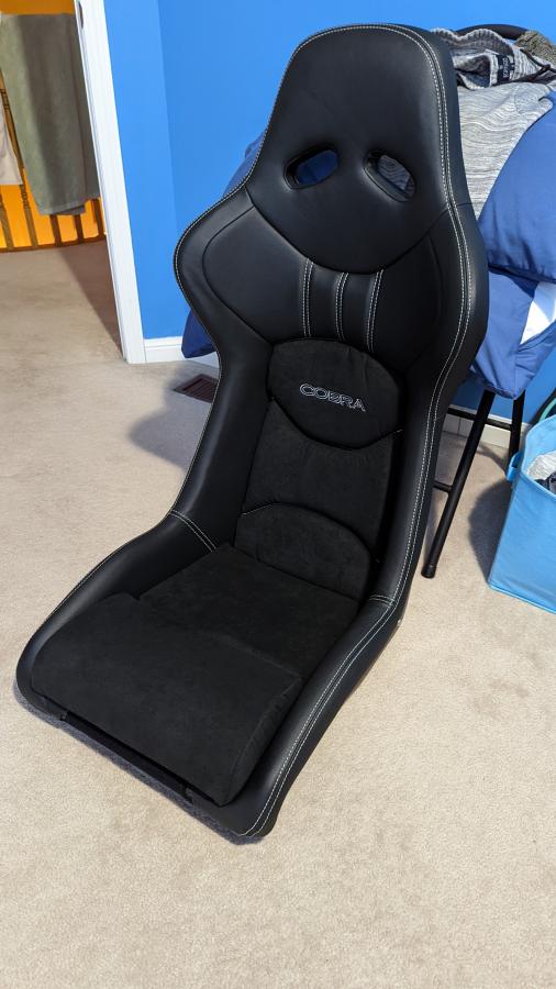

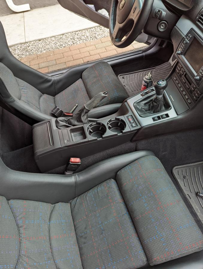

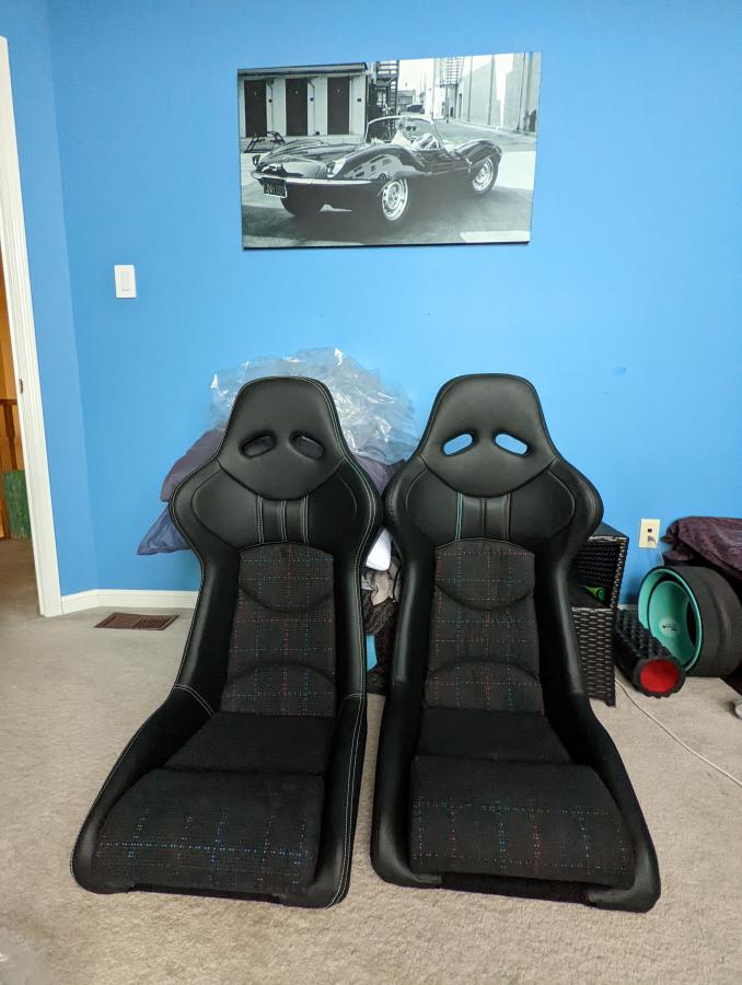

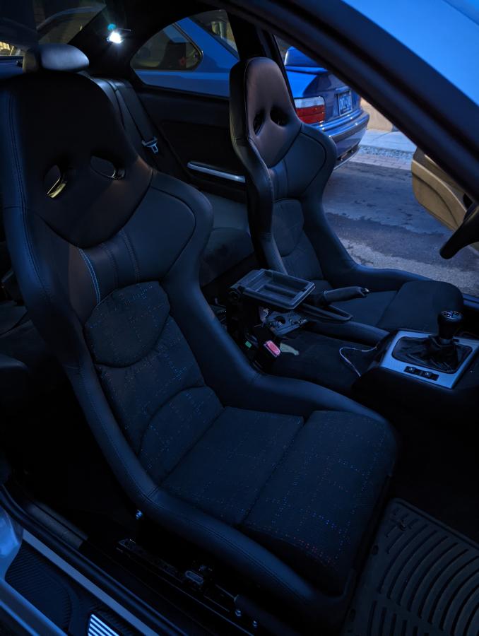

                    Started tracking, quickly noticed my OEM seats are terrible for it. Went with the OG option of Nogaros Circuits, thanks to Tbonem3 COVID-19 and Obioban for the help throughout the process.
                    Ordered from deemontweeks, was the cheapest option and went with the vinyl and dynamica center. Then had them reupholstered with mtexture from ASC fabrics. Then Tyler fabric marker mod. Other than CSL intake, hands down vest mod. And saves a shit ton of weight off my full option car 😔.
                    Each OEM seat was about 65lbs (side bolster, lumbar and heat) and the Nogaros with OEM manual sliders and Brey mounts about 34lbs. The Brey mounts did give me issues the holes mounted when not attached to the rails and then didn't line up when on the rails. Had to file them for space. Bit of an annoyance and not ideal. May look at other options later on.
ID:	203147 Click image for larger version
ID:	203150 Stock vs Modded
ID:	203152 FInal look, did the arm rest delete console as i sat too low and the arm rest was no longer optimal like it was before.

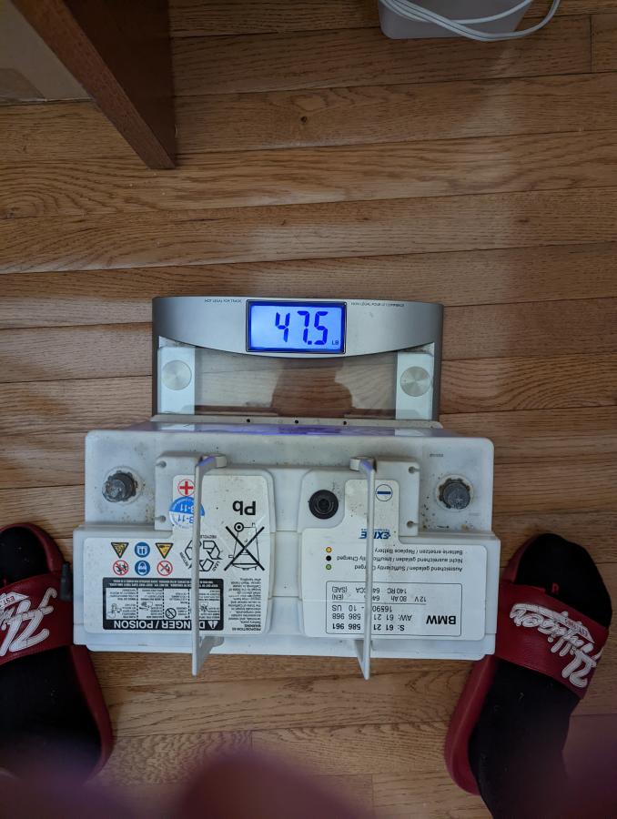

                    CSL battery vs OEM as well, another few lbs lost. Around 75lbs or so gone from the car with a few grand from my pocket as well.

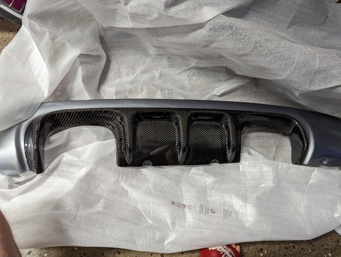

                      Then the last aesthetic piece was to paint my ebay CSL diffuser and the vorsteiner CSL trunk i had recently acquired.
                      No idea what diffuser this is.

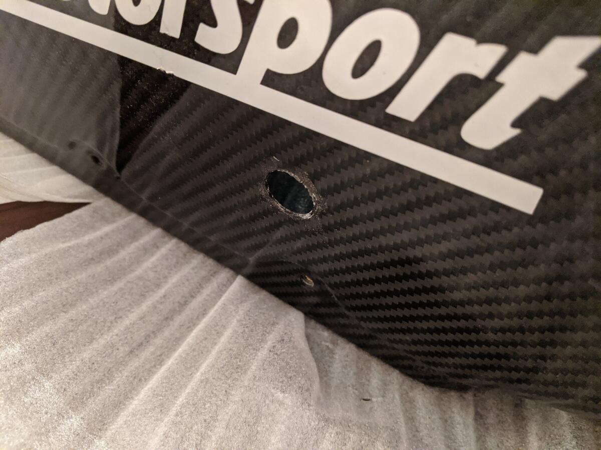

ID:	203163 First fitment not great. Can get the latch to close without a firm push. Trunks super light and even on old worn shocks it shoots up. It looks unbelievable fml, a single tear...
ID:	203158 I'll keep trying to get it close to 99% tips are very welcome.

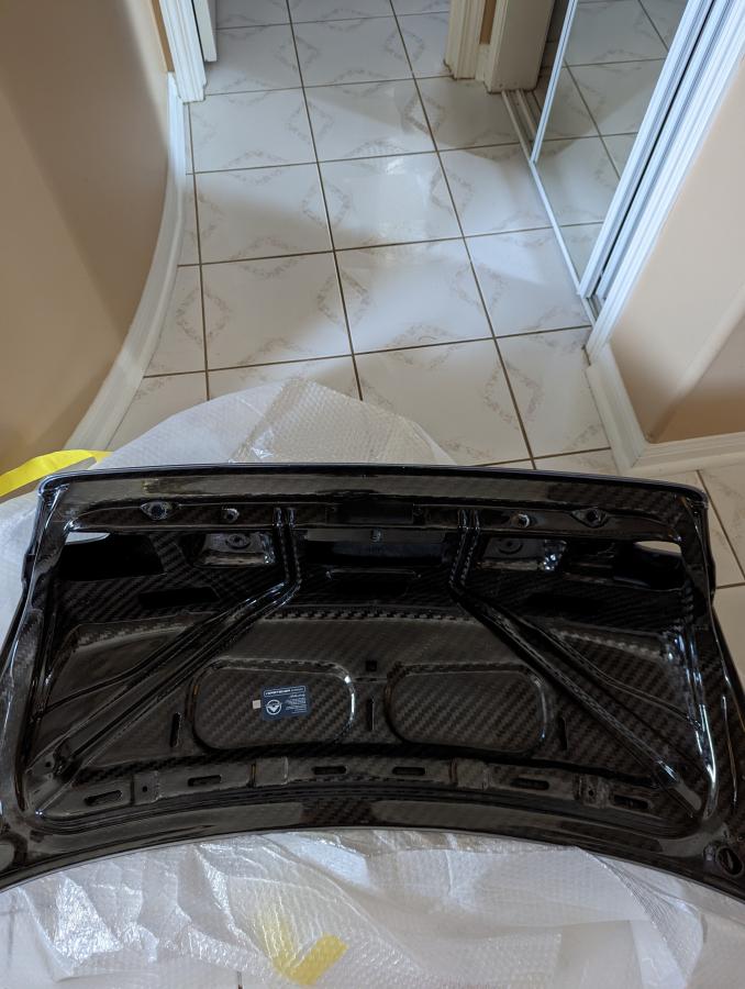

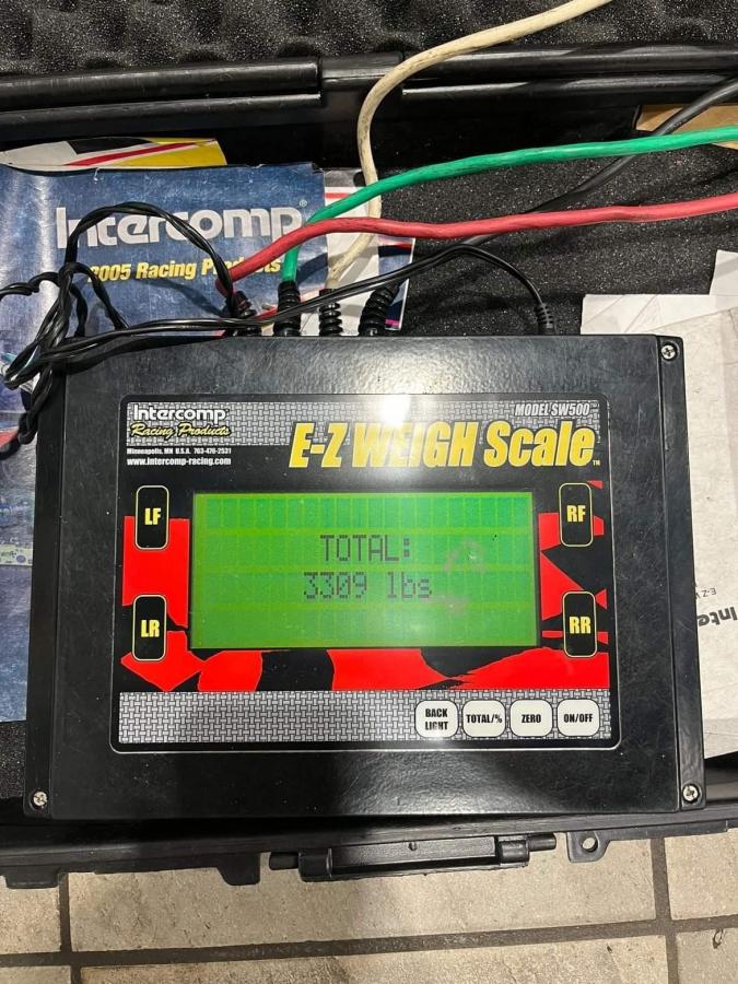

                          With fitting the trunk i measure weight as follows.
                          OEM trunk naked 26.8lbs Vorsteiner trunk naked 11.3lbs
                          I mounted the CSL trunk without the grey cardboard trim or the tool kit. Wanted to see the CF and also save as much weight. I will weight the rest to see total weight lost but I'm assuming another 5lbs roughly. Give or take -20lbs loss off the rear.
                          After these mods i had some rear camber arms installed along with a full rear bushing refresh on the trailing arms. Then had the car corner balanced with a generous 3/4tank (rounding down from maybe 7/8). Total weight was 3309lbs.
                          Click image for larger version  Name:	IMG_20220731_160808_302.jpg Views:	0 Size:	126.6 KB ID:	203168
                          Click image for larger version  Name:	IMG_20220731_160723_055~2.jpg Views:	0 Size:	137.7 KB ID:	203167

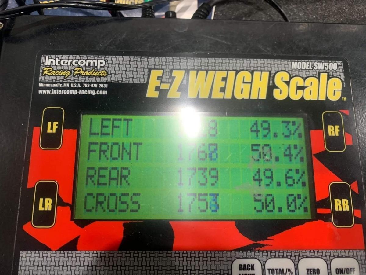

                          That was before the trunk install, so hopefully I'm somewhere around 3280lbs. I tried removing some of the rear scaffolding since car has nav and CD changer back there. If i remove the CD/nav the head unit goes blank and i kinda like it. The way around this is more expensive, anvin and interior tear out to remove everything including the cables. Eventually I'll get this done. I'd love more functionality and less weight overall.
                          What can I expect with this in weight loss, if anyone knows please chime in.

                                - trunk subwoofer assembly (7 lb)
                                - interior and dash out so tore out the brown firewall sound deadening like the CSL (4 lb)
                                added the following back in:
                                - business CD wiring harness (10 lb)
                                - business CD radio (2 lb)
                                - sunglass tray!
                                And got the smaller amplifier mount and trunk liner with the extra space. I tried an Avin in my E39 and it was garbage, sent back within a day. The business cd is functional and looks timeless IMO
                                Fuck, I was afraid of this. Really the anvin was that bad? what didnt you like about it?
                                But damn, thats 20lbs gone, wow.
