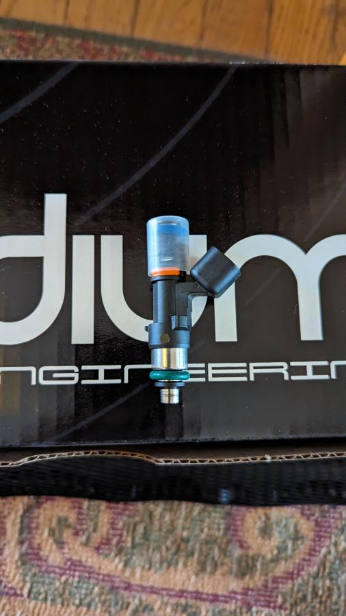

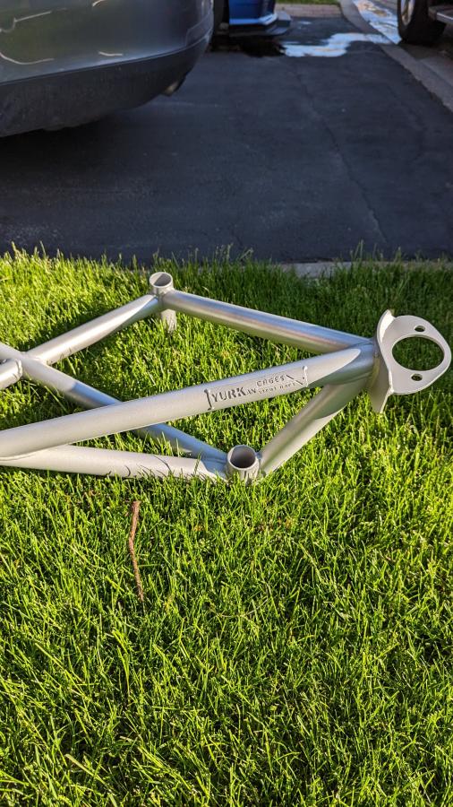

    And these are from Germany. My dream rear strut bar, organized a group buy with my track buddies and team mates. Ordered 3 variants for the E46, and one piece for my brothers E36. Don't think I'm ready for the monster I'm building. I just want to hunt m2s on track, and shut those FRS bois up. Not a fucking peep out of them. Cars way faster than i am at this point i need the most work as is always the case.
    Click image for larger version  Name:	PXL_20230119_161628122.MP.jpg Views:	0 Size:	78.4 KB ID:	203231
    Click image for larger version  Name:	PXL_20230124_013043356.jpg Views:	0 Size:	51.5 KB ID:	203227

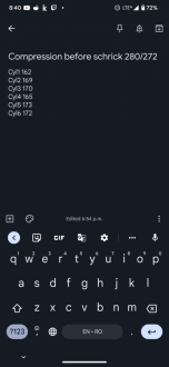

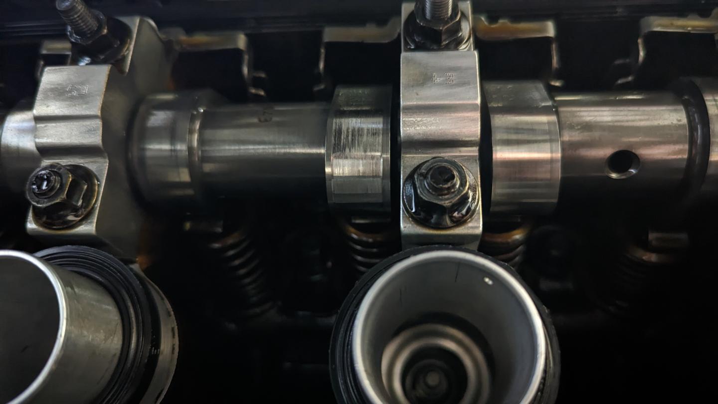

            Couple of updates.

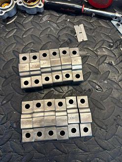

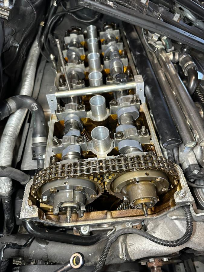

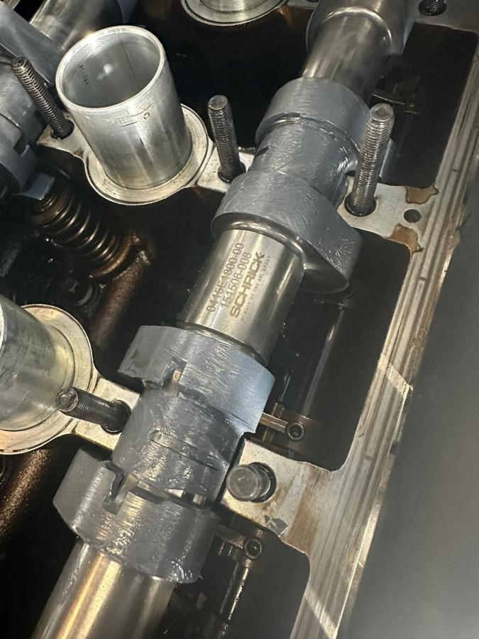

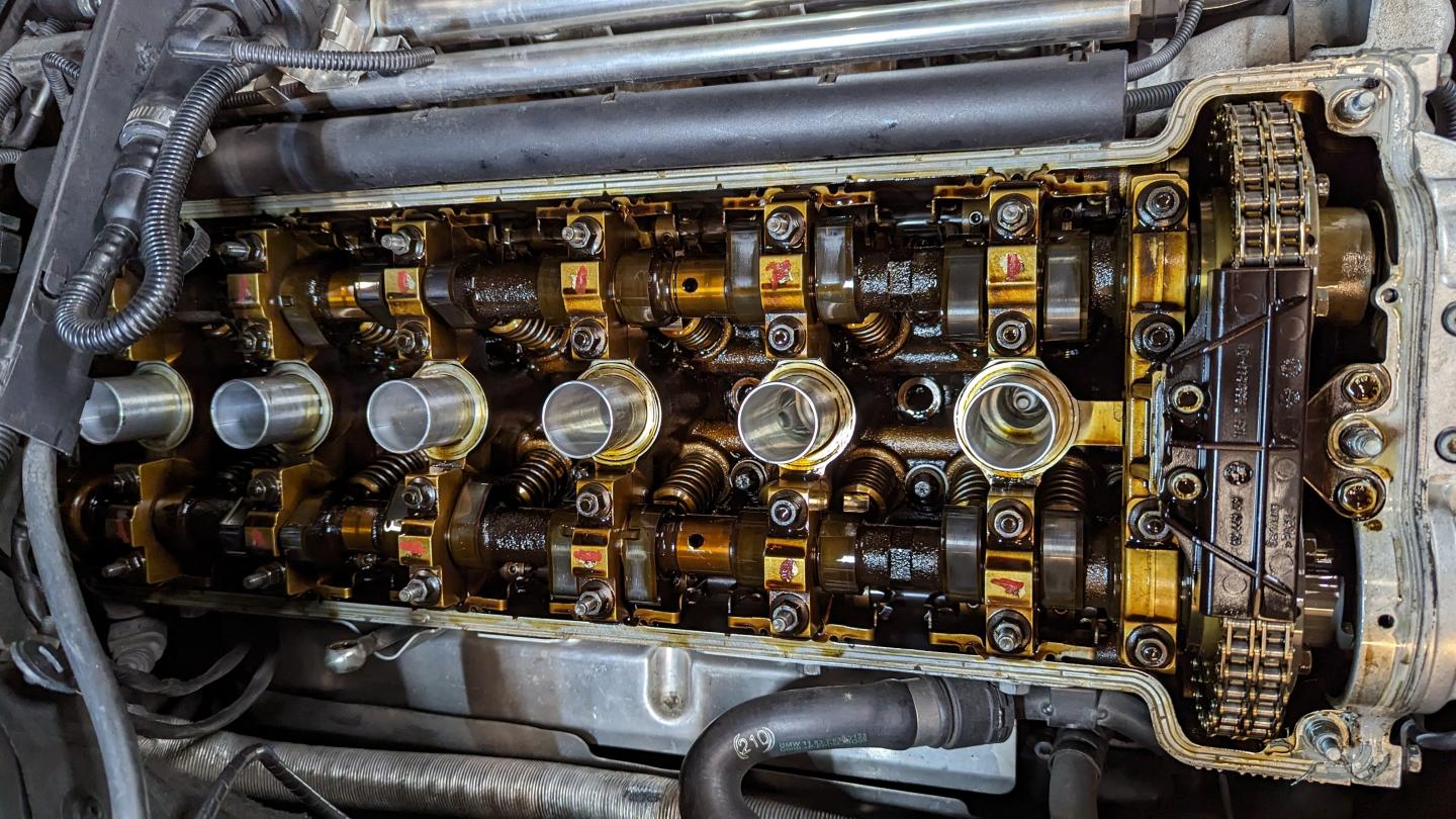

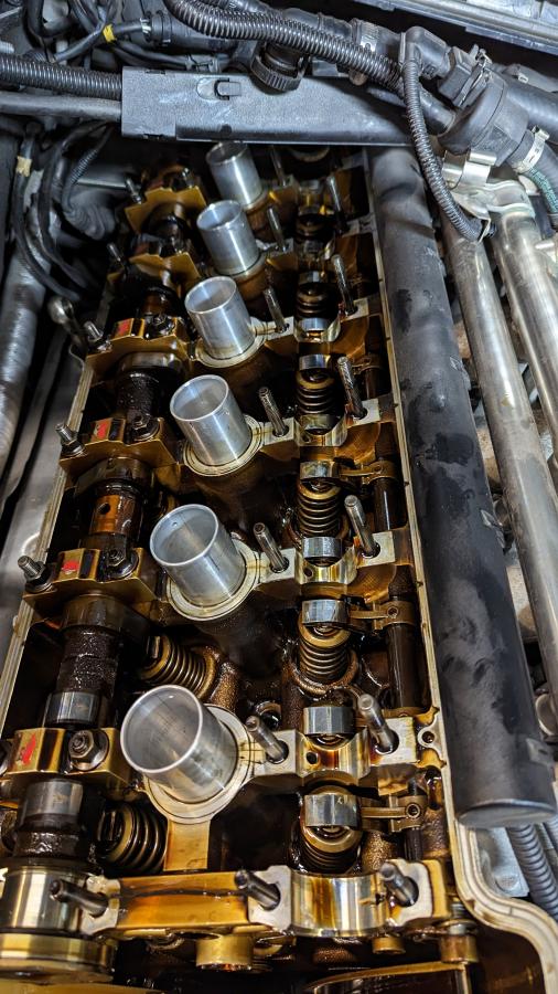

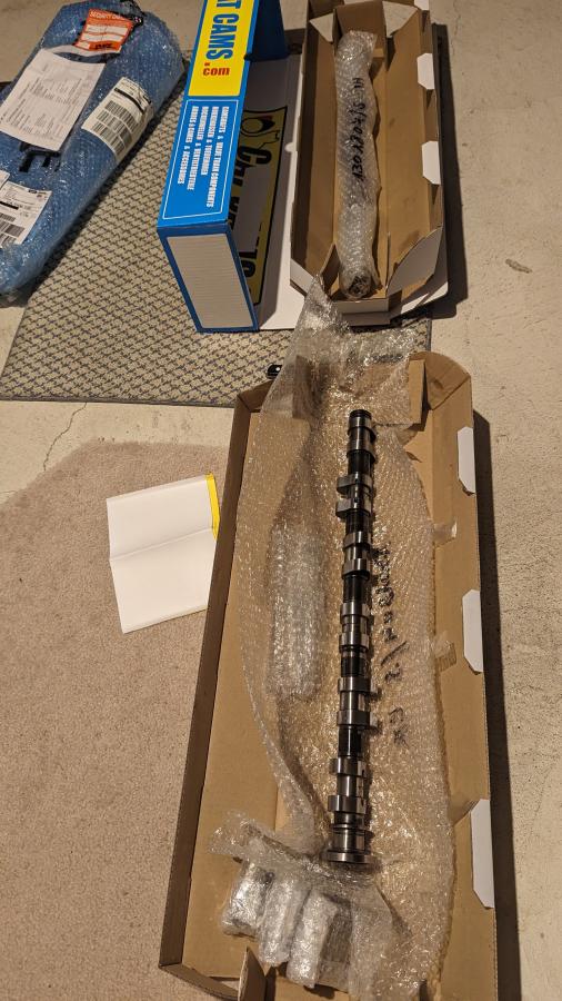

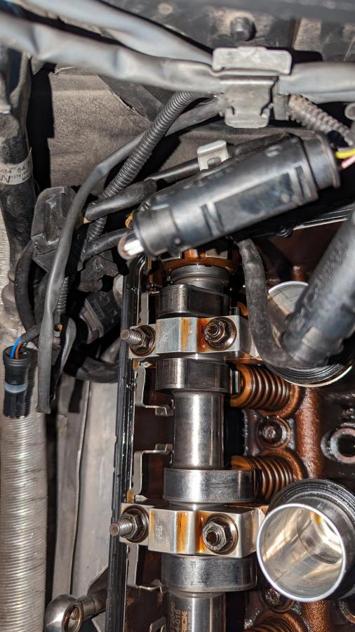

            Cams went in, went with 280/272 to forego followers and keep a healthy torque delta. My brothers E36 also got cams but there were some complications that arose that could've been found early with a compression and leak down test. We found a burnt valve on his car on cyl6. Head off and the 3 angle valve job and port polish, extra money we weren't looking to spend.
            We did the compression on my car before taking anything off.
            Not great but not bad either. Seems like 167psi for standard compression is average so cyl 1 and 4 are a bit off. Cleaned the follower retainers, toothbrush and sunlight dishwasher with warm water. Many metal cuts later they looked brand new.
ID:	209518 Click image for larger version

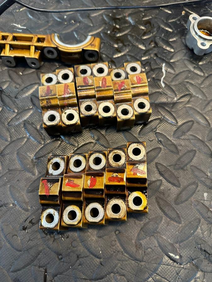

            The valve train before.
ID:	209521 Click image for larger version

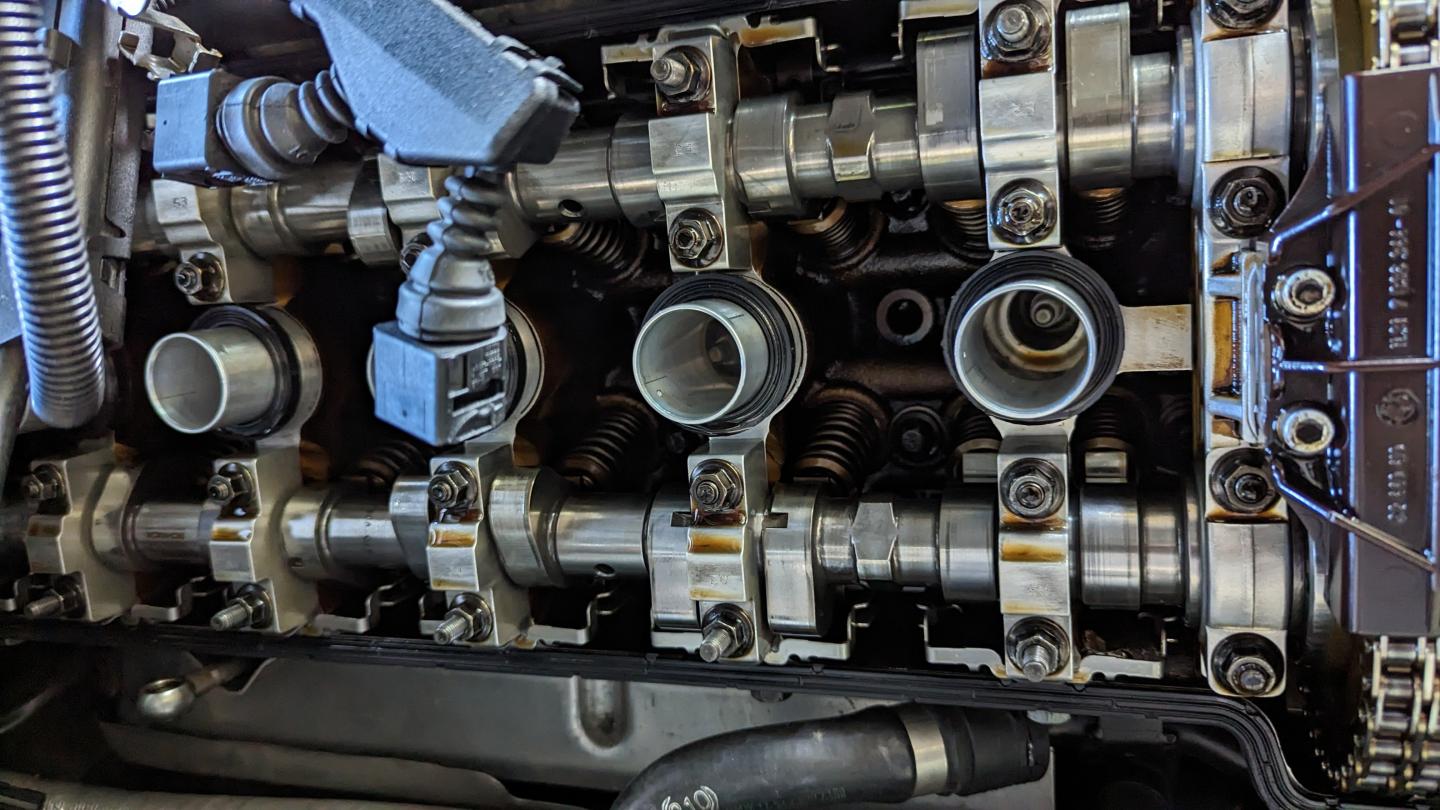

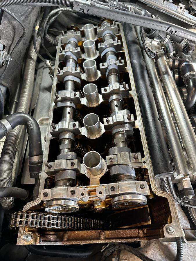

            And after.

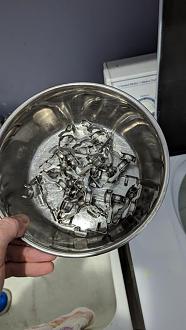

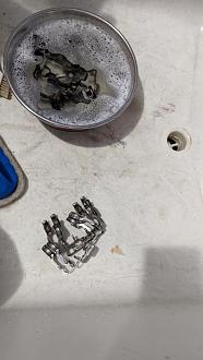

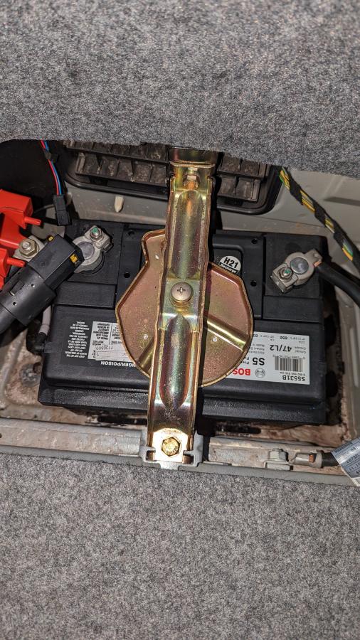

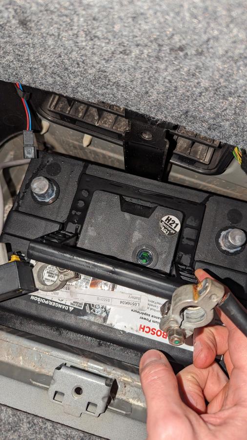

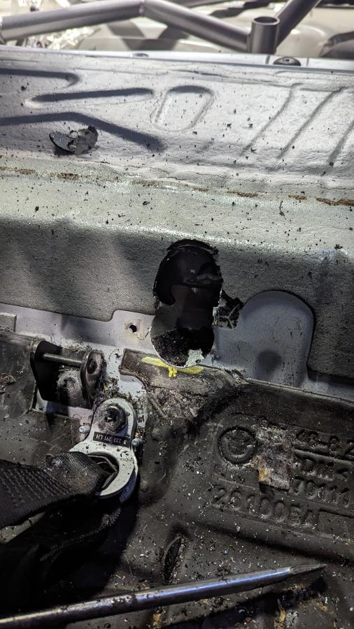

              After starting the car I noticed something in the trunk compartment as we tried to boost another M3 to get into the garage with my car.

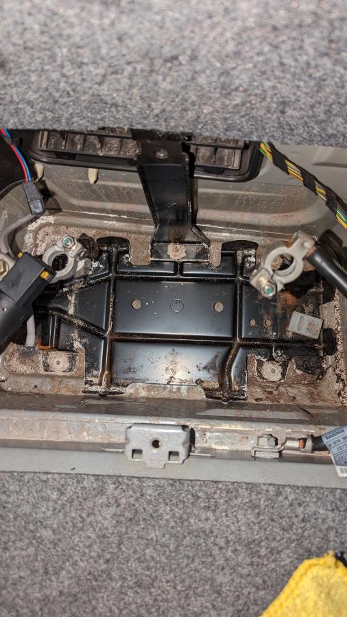

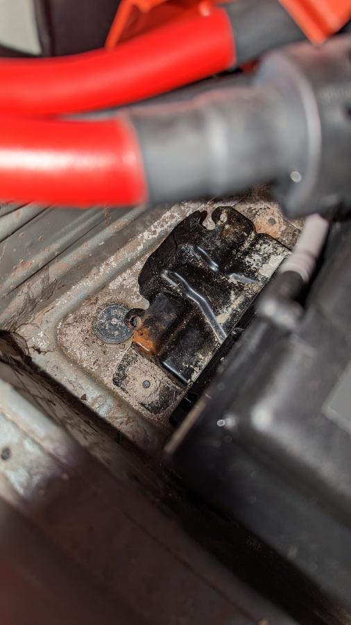

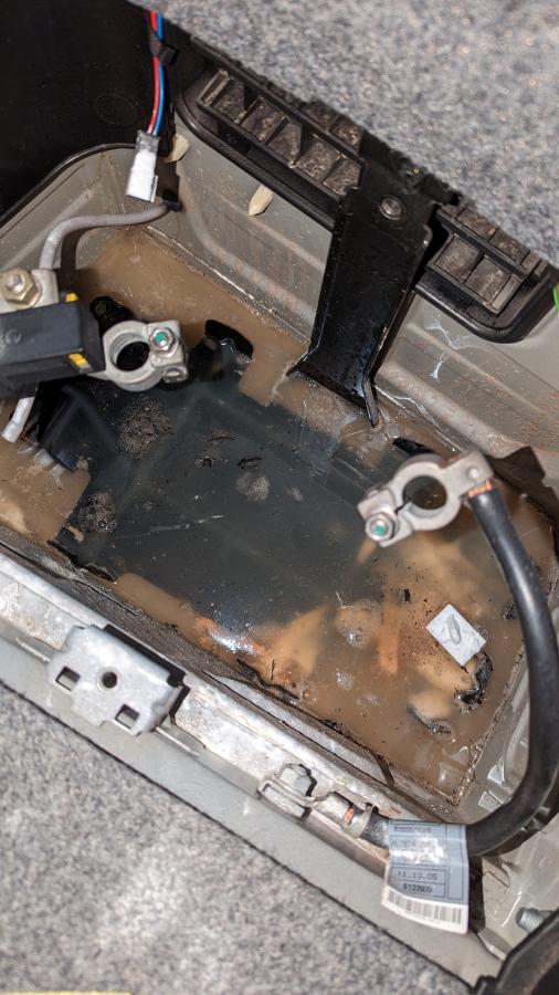

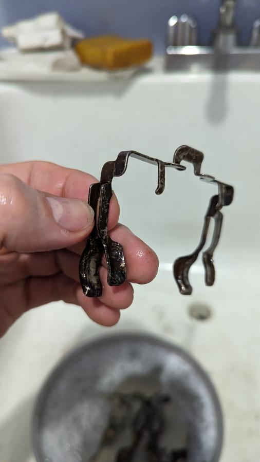

                Car was on CTEK trickle while in storage, some how it overcharged the battery and this happened. Voltage was 12.89 after i had removed it from the car for some time. Really upset as the battery well was pristine.
                Deionized water and baking soda to soak and scrubbed it like a mad man. It went all the way to the metal that will have to be monitored and most likely repainted soon. Batter was brand new last year as well.

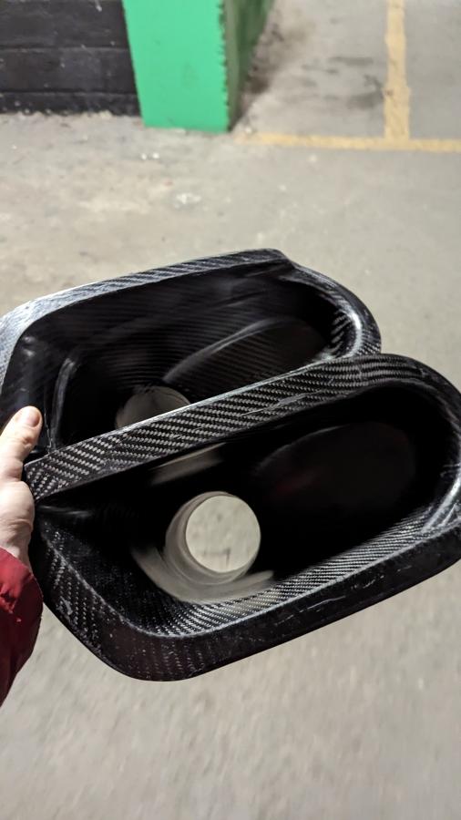

                  Found some cf brake duct intakes for cheap locally, the bimmerworld ones. They will go back on the OEM bumper and will pair nicely with the mk rennsport lip that's coming soon. They are super light, I've already hacked up the OEM bumper and they fit perfectly behind the main side vents. Click image for larger version  Name:	PXL_20230312_212246203.jpg Views:	0 Size:	47.8 KB ID:	209539 Then the steering wheel was also fitted before going in for cams. This I'm most happy about. OEM thickness with nappa and perforated leather sides and alcantara grey stripe to match the car. The stitch is original M colors which is just the bees knees. Big shout-out to TexaZ3 for the work on the trim, wild to me that I didn't do this earlier, it's literally the thing you use most in the car. Will be a mod I'm sure will rank top 5 going forward.
                  Click image for larger version  Name:	PXL_20230206_230622390.jpg Views:	0 Size:	131.1 KB ID:	209540 Click image for larger version  Name:	PXL_20230207_001413454.jpg Views:	0 Size:	71.1 KB ID:	209537 Click image for larger version  Name:	PXL_20230226_192041351.jpg Views:	0 Size:	63.0 KB ID:	209538
                        That's super annoying. Should be easy to fix since you caught it relatively quickly. POR 15 makes some stuff that's a pretty good match to silver grey: https://nam3forum.com/forums/forum/m...112#post100112

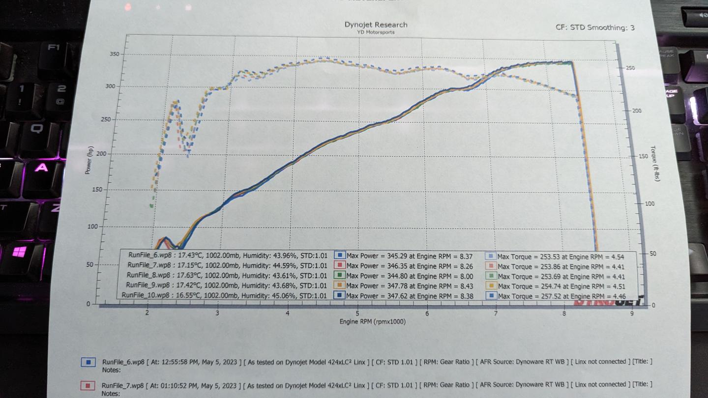

                          I ended up getting the Braille 21lbs AGM battery to replace the unit in the above posts. Considerable weight savings and the fit was pretty easy to get right.
                          That however was the last thing to go decently in 2023. Coles notes: spent a lot of CAD rupples, new Schrick 280/272 on old good oem followers ruined the cams and followers, CatCam 280/272 set bought - exhaust cam was out of spec with the vvt orifice being .015-25in out of round/cylindrical (I dont know the engineering speak but basically the hole was conical). I did about 1,500kms all in in 2023 which was just break in and a bit to drive to a garage to store and work on it.
                          Click image for larger version  Name:	PXL_20230528_211116980.jpg Views:	7 Size:	86.3 KB ID:	276172 Exhibit A : intake cyl 3 I think.
                          Click image for larger version  Name:	PXL_20230528_211056703.jpg Views:	0 Size:	175.0 KB ID:	276192 Larger picture. I have more but you can gather an idea. The damage is enough to make a very audible top side valve train noise consistent with "ticking". I took the valve cover off pretty much right after the dyno session. For reference, break in was about 1200-1300kms, on new oil, 4k rpm max, always below 50% throttle or less. Drives were around 80-100kms long per session varying rpms even while on the hwy.
                          Click image for larger version  Name:	image.jpg Views:	7 Size:	66.8 KB ID:	276173
                          Click image for larger version  Name:	PXL_20230707_220707726.jpg Views:	7 Size:	93.7 KB ID:	276186
                          Click image for larger version  Name:	PXL_20230708_151124160.jpg Views:	7 Size:	38.3 KB ID:	276174
                          Click image for larger version  Name:	PXL_20230708_145131256.jpg Views:	7 Size:	29.4 KB ID:	276175
                          Click image for larger version  Name:	PXL_20230708_145122933.jpg Views:	7 Size:	35.1 KB ID:	276176

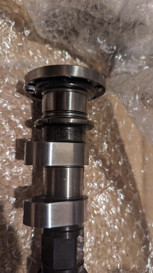

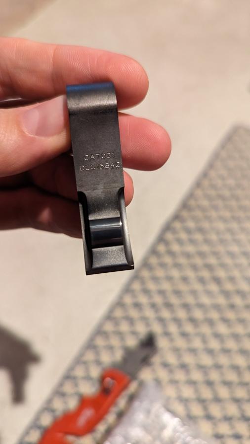

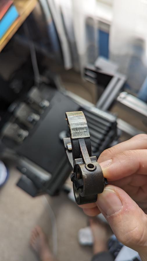

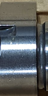

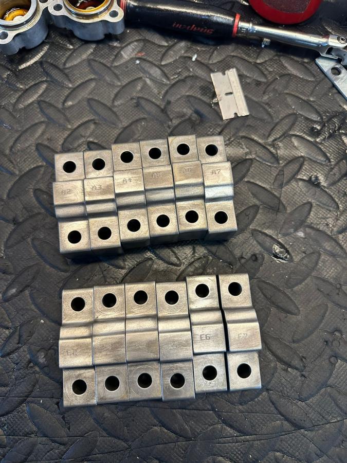

                          New CatCam set bought from a member, with the oil bridge and the followers. No drilled rocker arm shafts though.

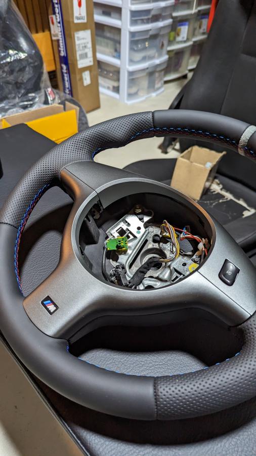

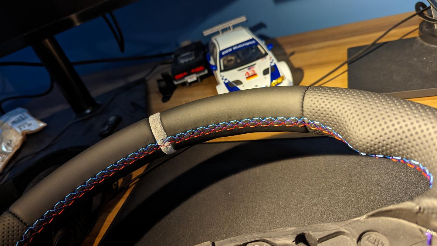

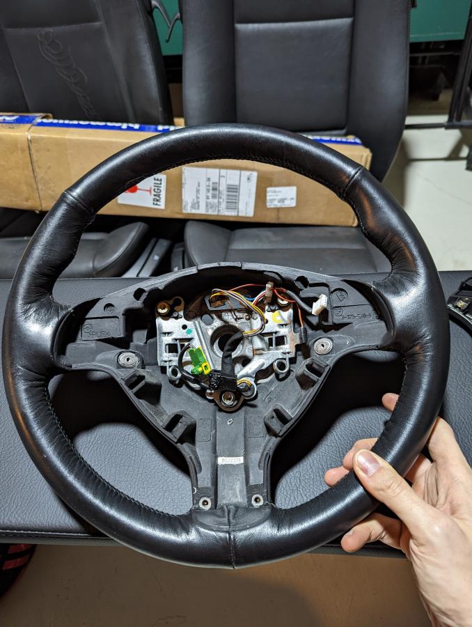

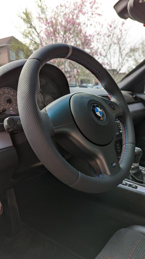

                          Favorite mod easily is the Roaddefined reupholstered steering wheel, opted for oem foam thickness, and OG colors blue purple red, with an alcantara center stripe and nappa perforated 9-3 and nappa. It's the thing you use most in the car, dont cheap out, so worth it. Maybe get and OMP/Sparco/Momo for track and weigh savings but for now I'm super content.

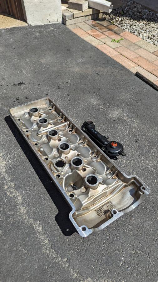

                          Did as much cleaning as I could when the cam work was being done. Cleaned the valve cover by hand, took a long time and chemicals but was super satisfying. Love doing stuff like that, restoring to like new, feelsgoodman.

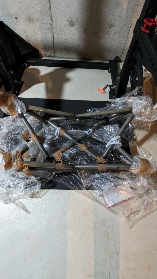

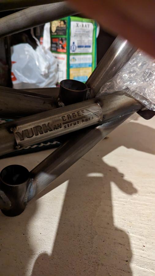

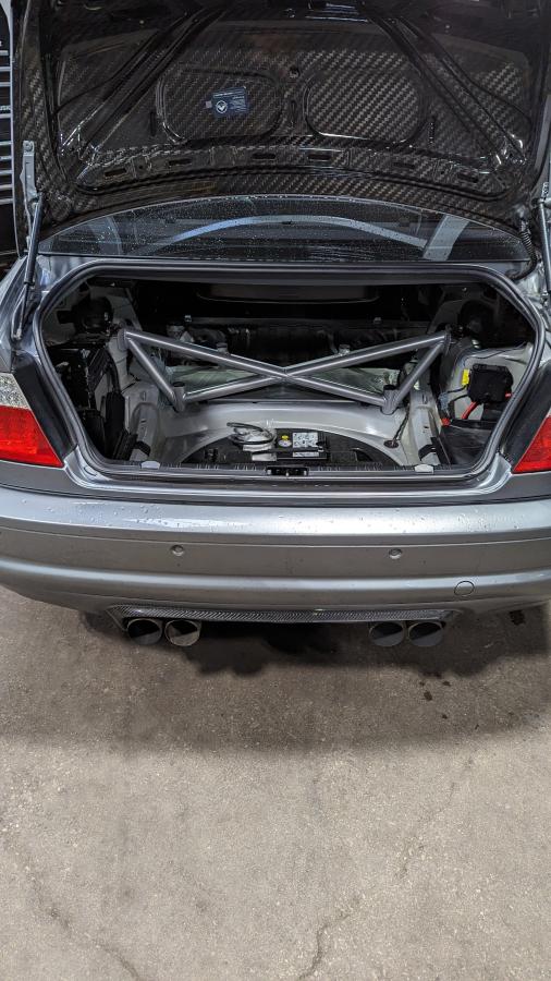

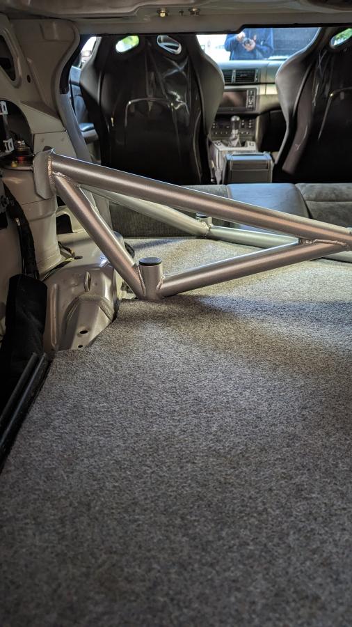

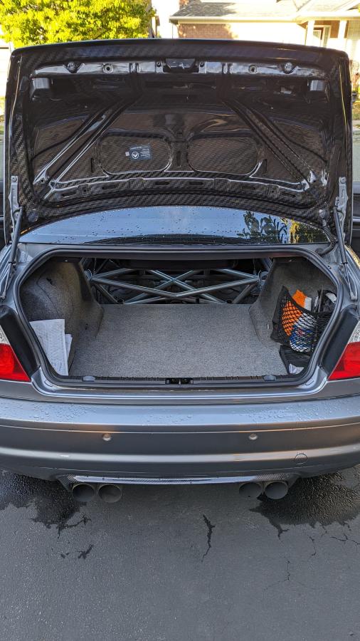

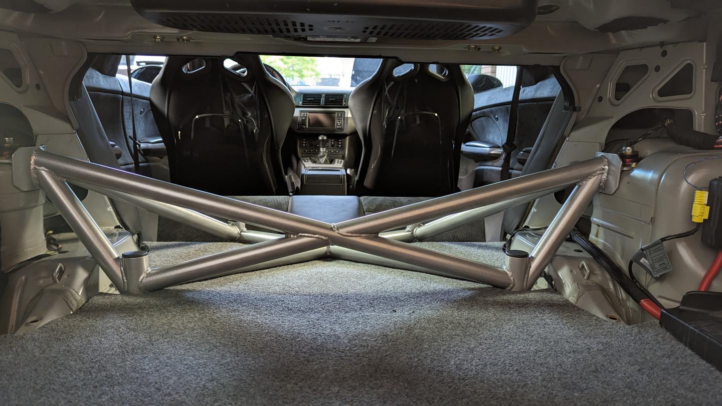

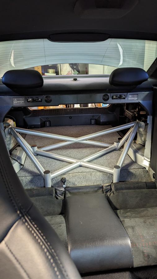

                            After installing the CatCams, and then sending the exhaust one back to Belgium for fixing. It was time for the Yurkan X brace to go in. I'd organized a group buy for it for me and my track buddies. Total of 6 were bought. Marin is the best to deal with. Install was a right pain in the ass, its not easy and you'll need help and proper tools, the worst is getting the passenger front most bolt out. Theres no fuking space and its a struggle that alone took an hour just to get out.
                            Depending on how old your chassis is, the brace may just drop in or will require more fiddling, I've installed it on 2 other cars and all are not the same. Mine it just dropped in to my surprise.

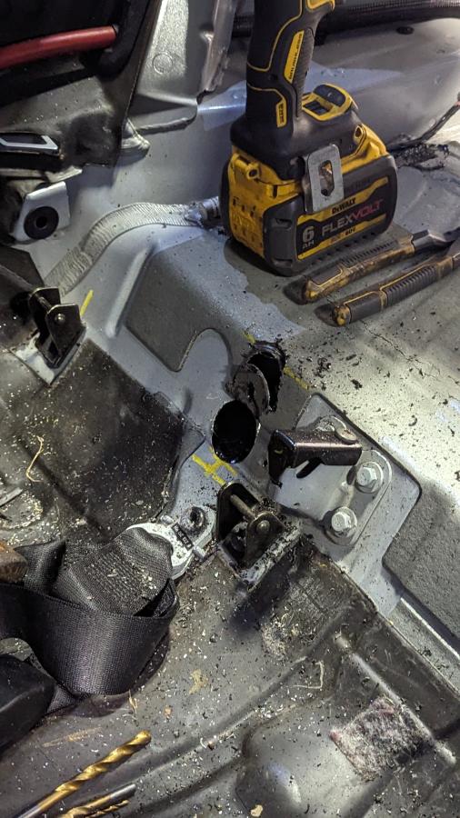

                            Not gonna lie it was amateur hour, but I tried to be as careful as possible and still made some mistakes. None were bad but enough to get my blood pumping. The difference is immediate. The rear end is extremely solid and responsive. You lift wheels on inclined driveways, scary at first since its a new sound but you get used to it. Anything to remedy the paper mache rear end of our cars is a must do. Either this or the Slon wall, I wanted scaffolding so I went with that.

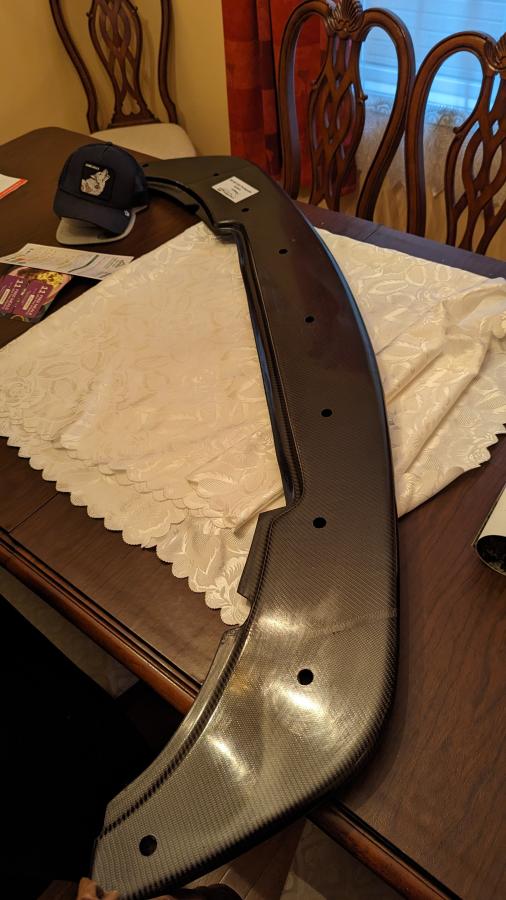

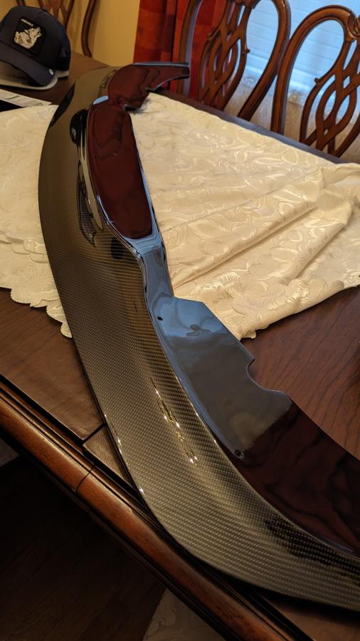

                            MK Lip, looks on point. Still not installed.

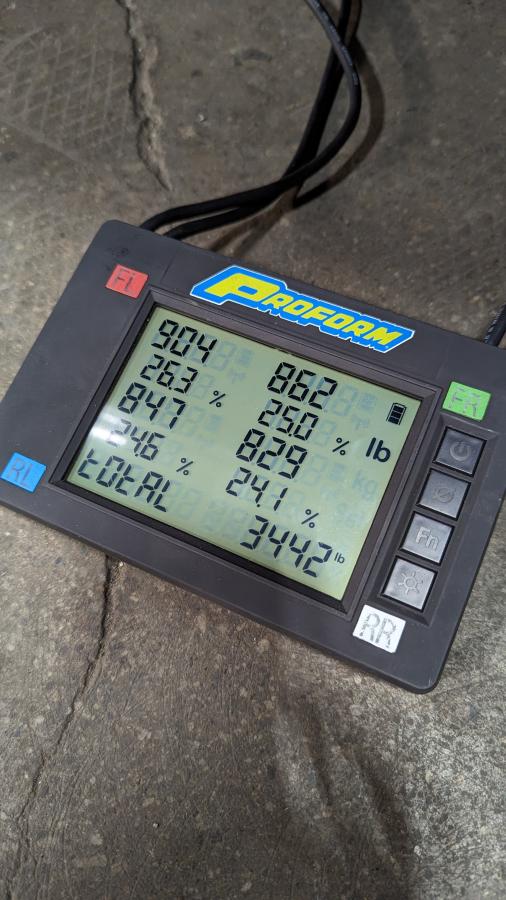

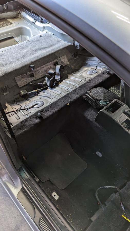

                            After Yurkan, without top side of back seats, no side wheels arch trunk trim, and a full tank, with me in the driver seat.
                            Without driver.
                            10/10 would do again.

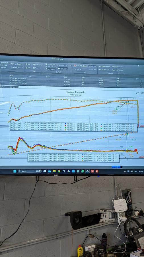

                                The combination of all those things, weight loss, increased rigidity and the extra power just make the car really really fun to drive. On the street with no sound deadening I got to admit is not very nice but if you have an ounce of motorsport in you the noises are truly amazing. I'd debating whether or not to put back the trunk side wall interior bits or a bit of sound deadening. Also the Vorsteiner trunk doesn't seal well without any trunk trim. At speed you can hear it flap against the rear windshield. Have to find a solution to help it seal or properly diver air. Definitely not great above 100mph.
                                At the track this new setup was amazing. Mosport here is our best track in Ontario, it was so confidence inspiring I tried just to lift in turn 1. Hind sight is 20/20 and I should have eased into it more ie. tap brakes. I was drifting at around 90mph which was not fun when you're looking at a wall. It was my second time at the track ever, but the confidence from the car was supreme. It just underlined the need for a better braking system, one that's simply more consistent.
