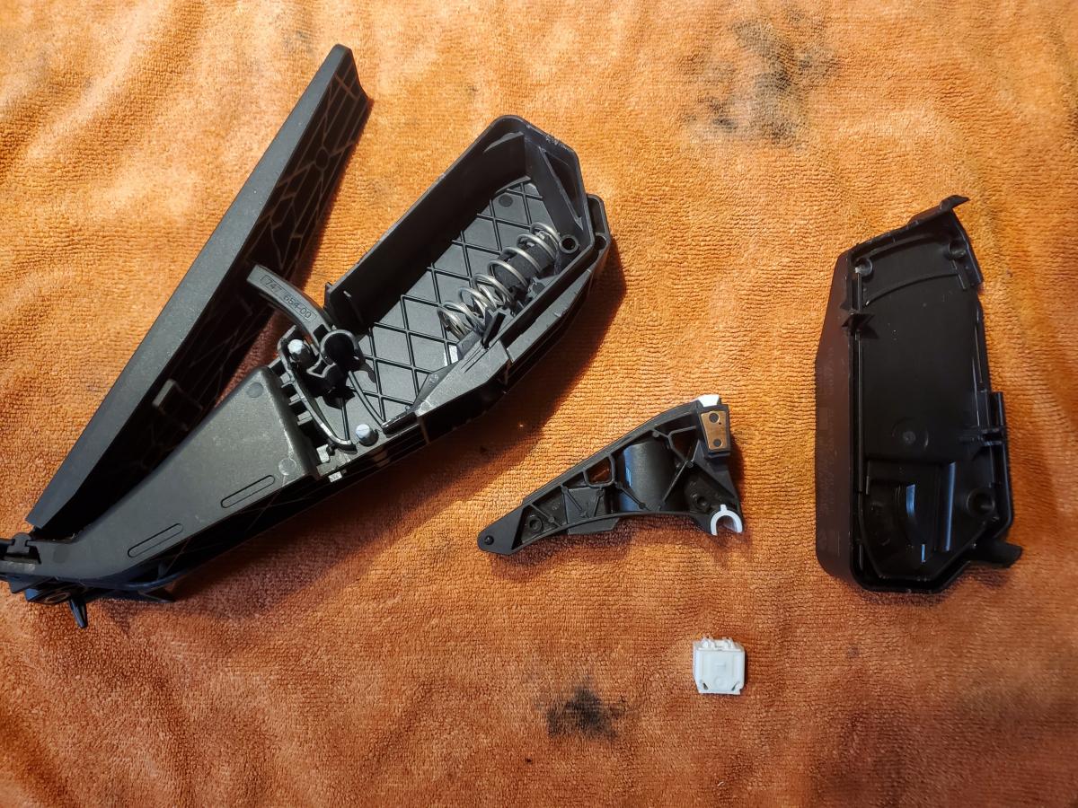

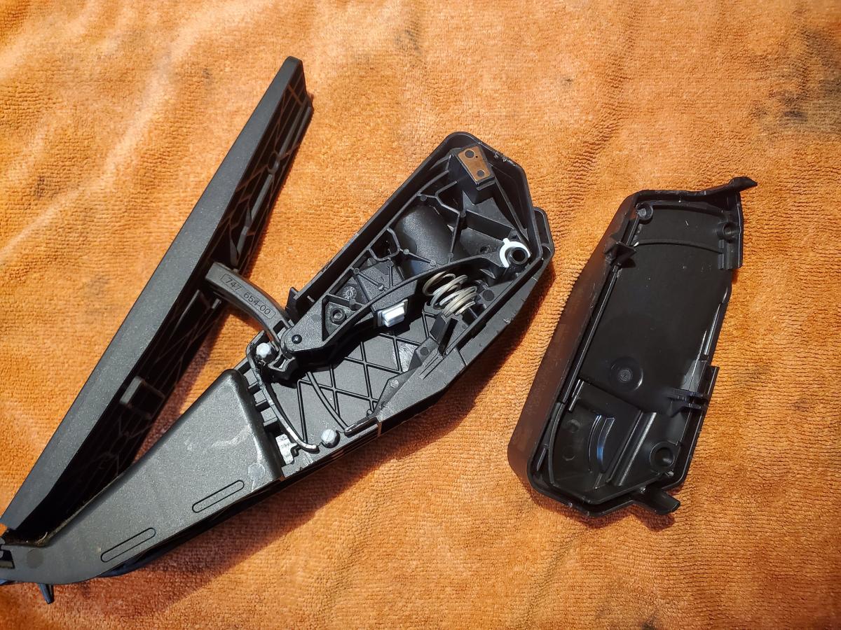

    After having the 6MT M3 as my only car for the past 5 years, the kickdown in E82's gas pedal felt extremely weird. Decided to open it up and remove it.
    Pedal was much easier to take out than in the E46. Pop a plastic cover off, undo a torx bolt and done.

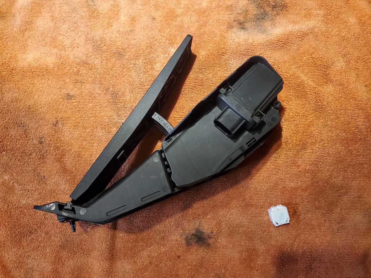

    Pedal was significantly harder to take apart than the E46 one though. It's held together with plastic clips instead of screws. Lots of messing around later I got the cover off:
    Disassembled it further to get to the kickdown switch (square white thing). The switch is fully mechanical, so the way the car drives will not change with it missing.
    Popped the switch out and reassembled everything:
    As expected, the car drives exactly the same, except that now it doesn't annoy me everytime I want to go full throttle (which is admittedly not all that often in this thing).

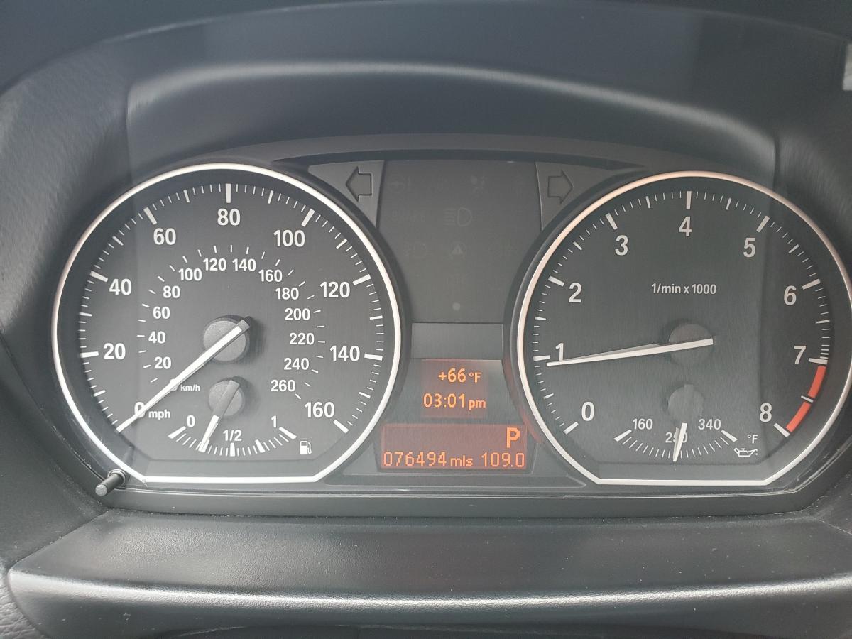

      Next mod was the cluster. Apparently there is no temperature gauge of any kind anywhere in a 128i. Not in the cluster and not in the iDrive screen. Only thing you can do is go into the cluster's secret menu and display coolant temp, but you have to do this every time you start the car, so not an option.

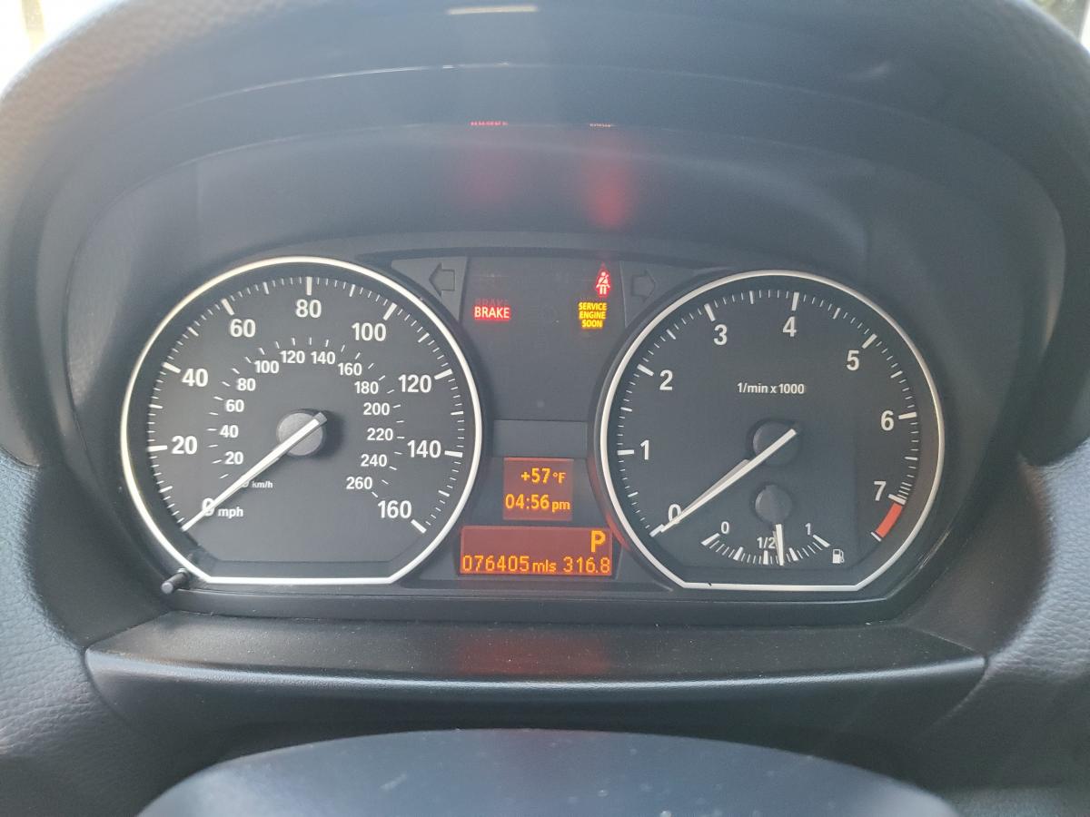

      This is the stock 128i cluster:

      Fortunately, the 135i cluster has oil temp on it and is a direct replacement. Just need to mess around with it a bit to get rid of the tamper dot and done. Followed this guide when doing this: https://www.1addicts.com/forums/show....php?t=1655093

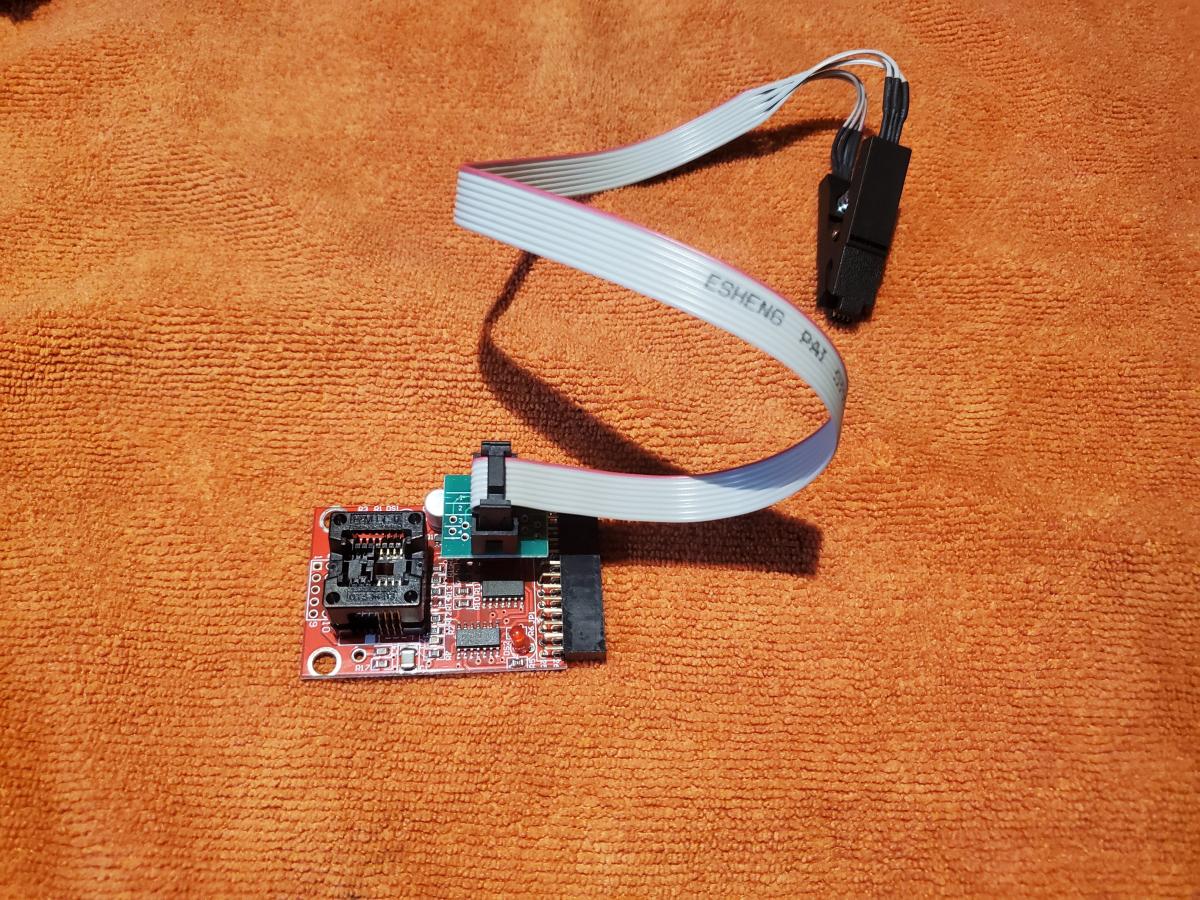

      First step was to modify the programmer. I bought a test clip so I wouldn't have to desolder the EEPROM and it came with a couple boards to solder into DIP8 shaped spots. The programmer had a matching DIP8 shaped spot, but it wasn't socketed, so I added a socket first (top right of the board):

      Pretty easy to attach the test clip after that:

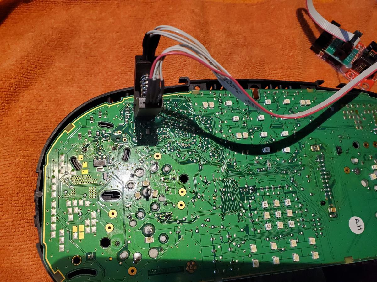

      Then grabbed the 135i cluster, disassembled it and zeroed out the VIN:

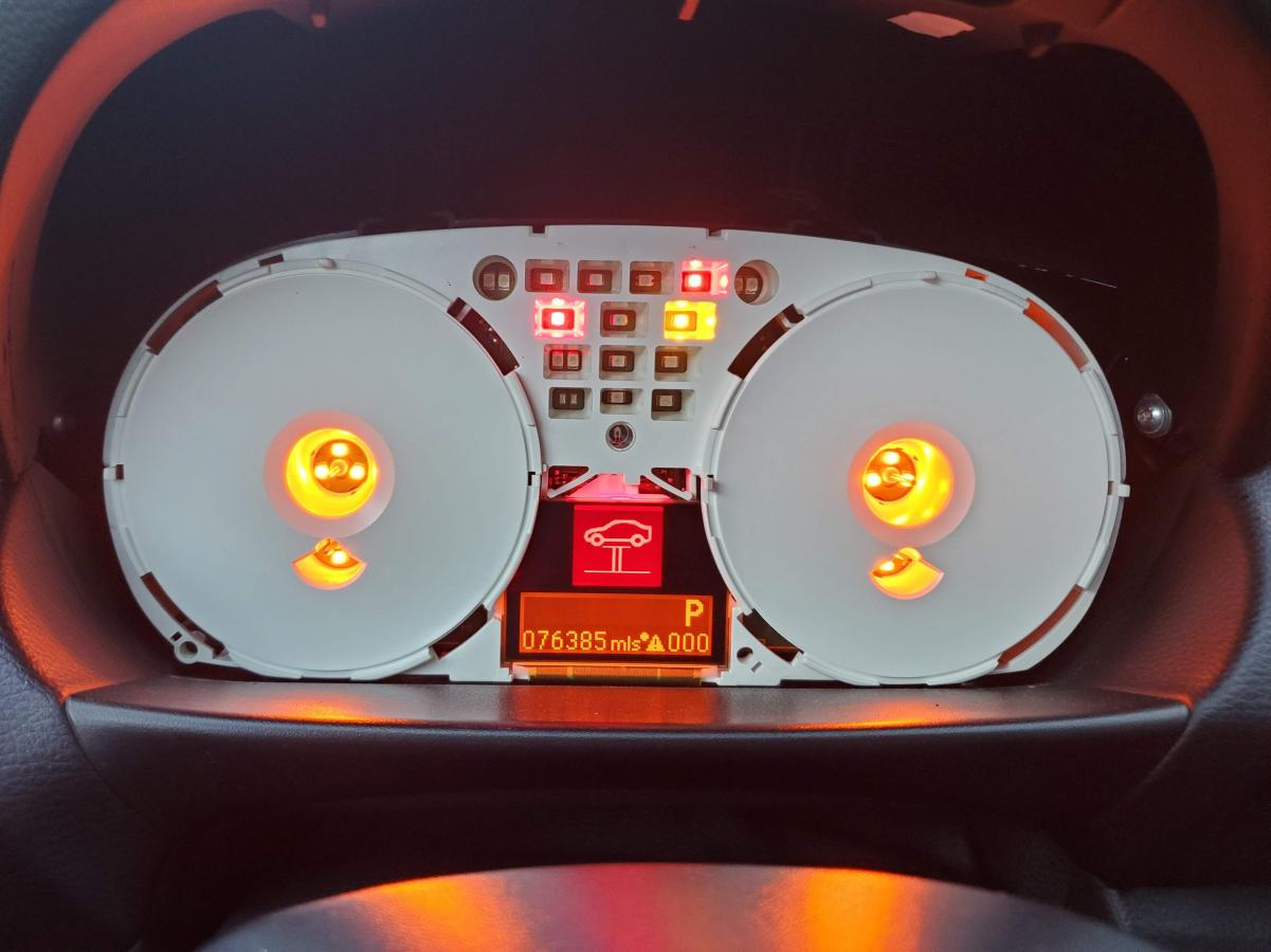

      Semi-reassembled and plugged into the car to see it if was still working:

      Looking good.
      Also noticed that the cluster I bought had exactly 20 mi less than the original at the time of the swap (eBay listing didn't have mileage on it). Crazy close. Had I known this, I would have avoided driving the 20 miles and then just done a straight swap. Oh well.
      Reassembled the cluster, coded with NCS expert (took the opportunity to code some other stuff to the car too) and went for a drive.

      Much better!

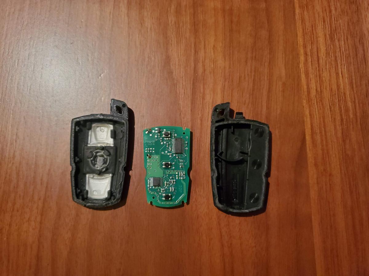

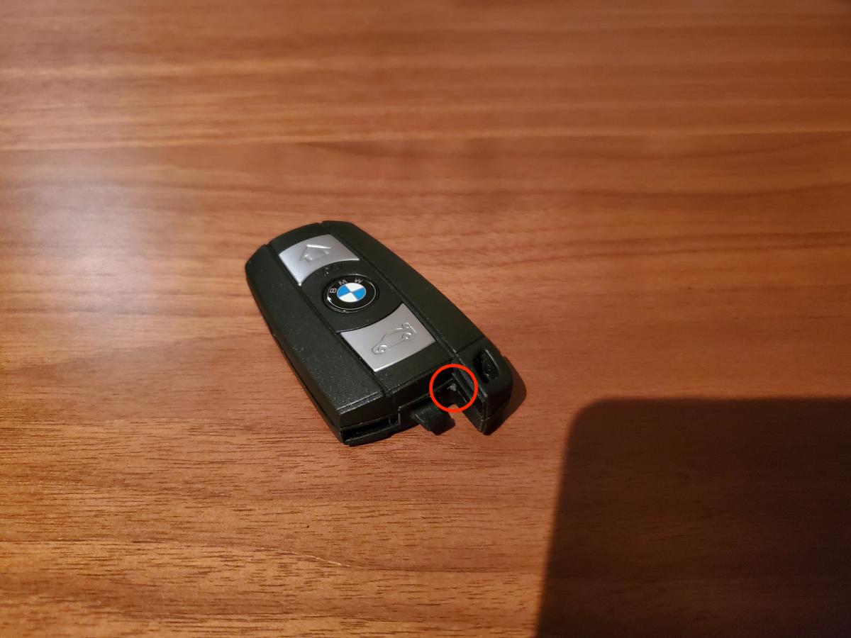

                    Was given two keys with the car, but one was completely dead. Tried driving around with it so that it would recharge and no dice. Then thought that maybe the key had gotten unpaired from the car, so tried repairing, but once again, no change.
                    Since the key was pretty much useless anyway, I decided to open it up. Managed to get it open with very little effort. Razor blade was all I needed, no heat or anything. Took out the metal key and started cutting/prying from a spot that isn't normally visible:

                    Worked my way around and got it open pretty quick:

                    Battery inside measured something like 0.8V, so yeah, pretty dead. Desoldered and rigged up a pair of AA batteries to test. Good news is the fob works just fine, so I bought a new battery on eBay for ~$10 and will finish fixing it whenever that arrives. It might turn out terrible and shitty looking, but figured it was worth a shot for the amount of money and time needed to do this.
