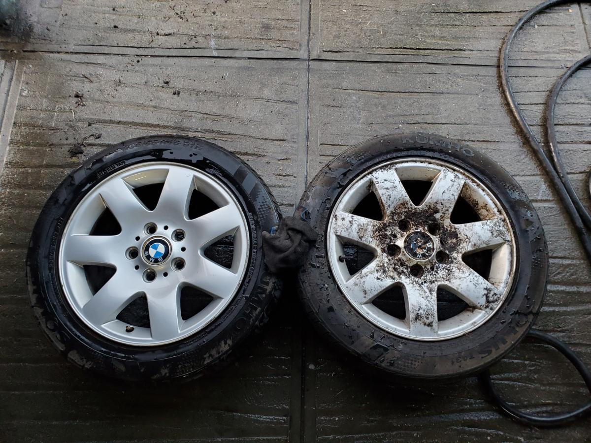

    Yes, I know it's kinda sketch, but these were only like this for a quick run over to the tire shop. Doesn't make it less sketch, but at least the exposure time was small. Anyway, I'll feed some stainless steel cables through them next time.

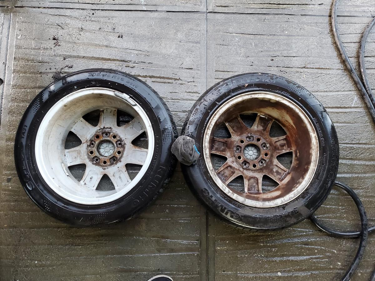

    Gave the wheels a quick clean before taking them to the tire shop as well, as I was ashamed of how disgusting they were. This was quick, so the wheels aren't completely clean, but the difference is still quite noticeable:
    Click image for larger version  Name:	20230316_190106.jpg Views:	0 Size:	193.1 KB ID:	210020
    Click image for larger version  Name:	20230316_190952.jpg Views:	0 Size:	256.9 KB ID:	210021
    The other two were even worse. Barrels were 100% black.

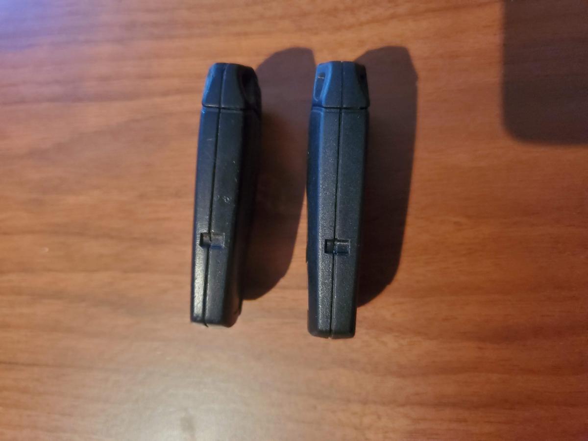

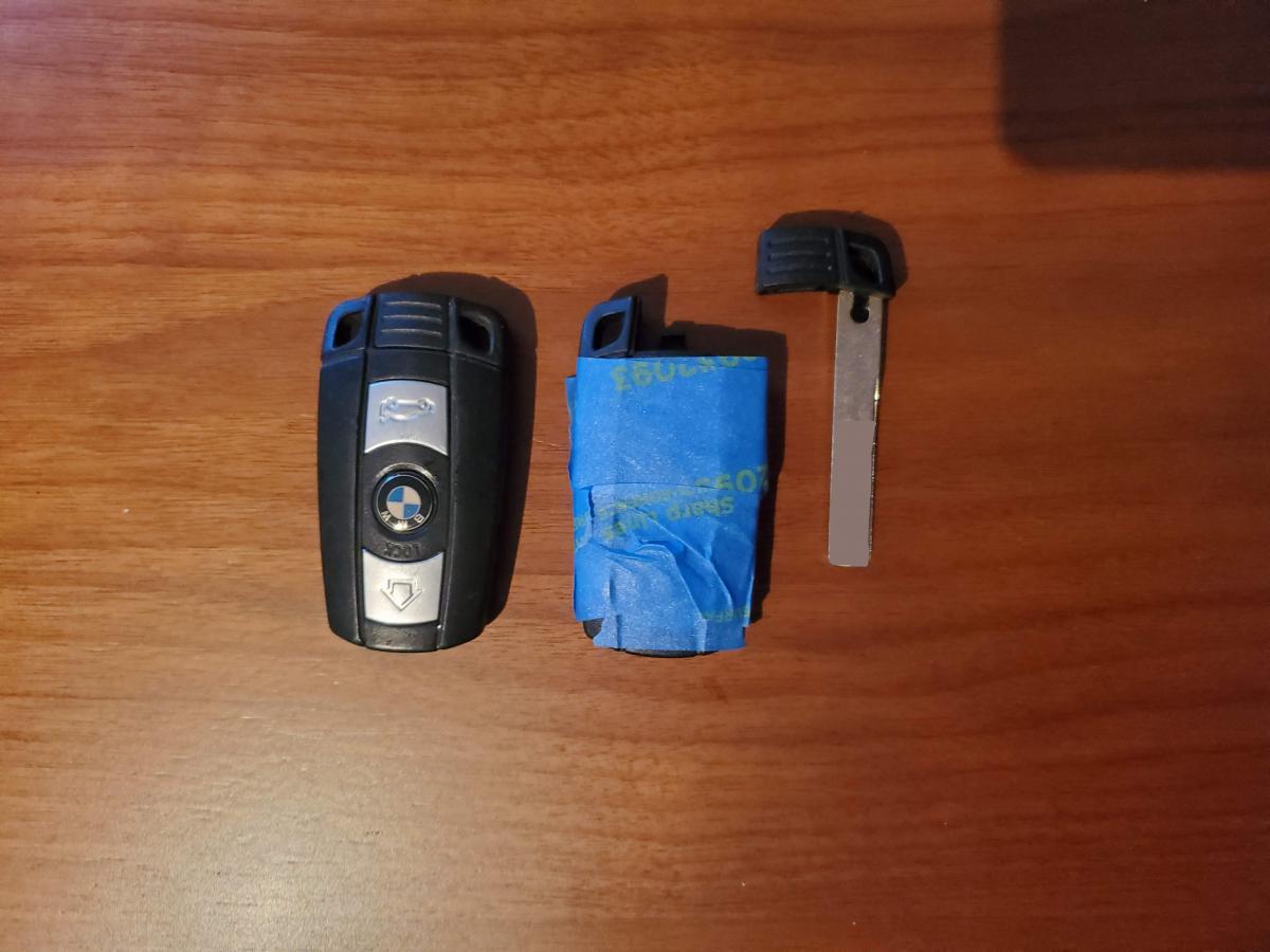

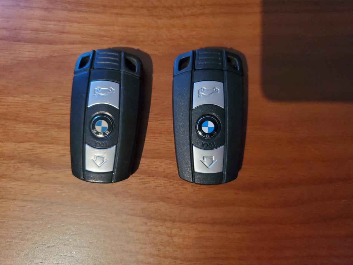

        Also, quick update. Finished up the second key. Soldered the replacement battery on and glued the two halves of the key back together. Used 3M emblem and trim adhesive (mostly because I had some on hand) and some masking tape to hold it shut. Worked great.
        Worn key on the left:
        Pretty happy with how it turned out. Feels much nicer to use the brand new key than the worn one. Will have to see how the adhesive used holds up though.

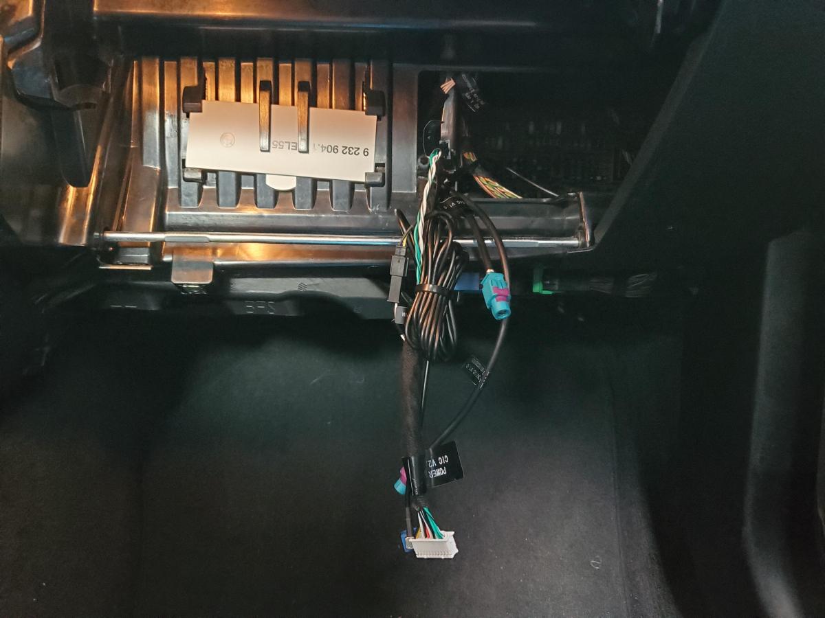

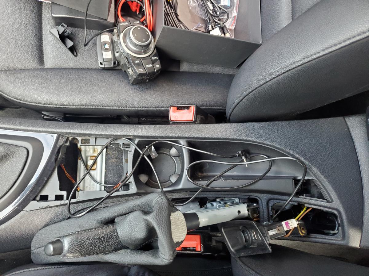

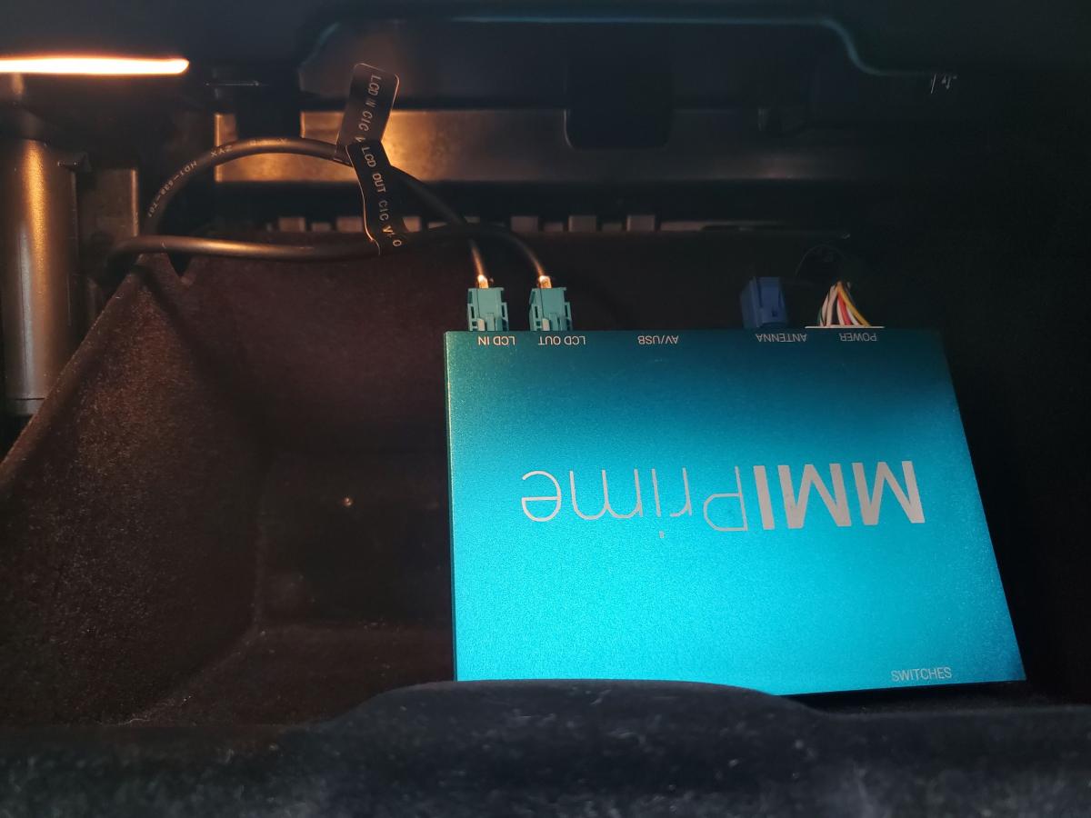

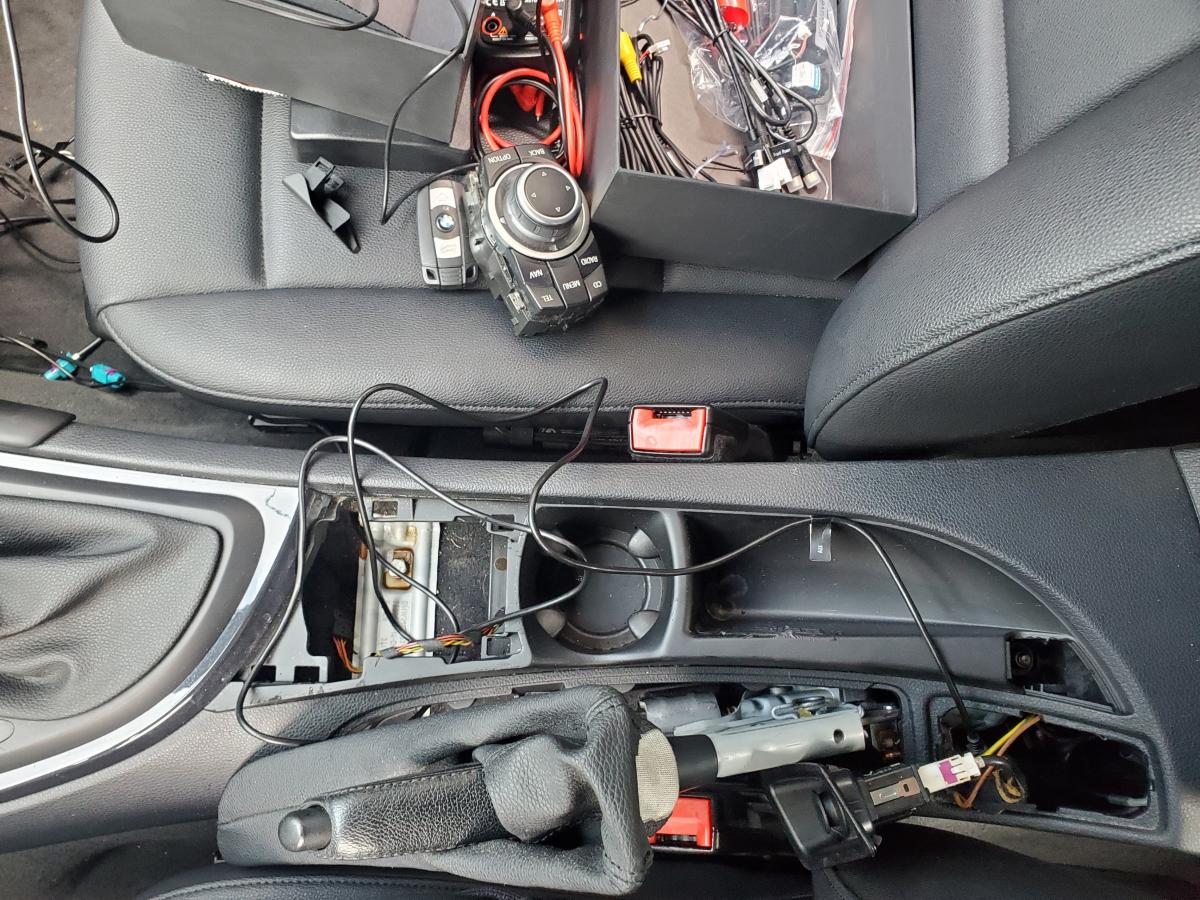

          First off was a Carplay/Android Auto module install. I ended up going with the BimmerTech unit, even though it was significantly more expensive than other options. I thought about getting one of the eBay units, but wanted something that would just work and that I didn't need to mess with too much.
          Install was super straight forward, especially with the install videos they have on Youtube, but I did do a couple things differently. Instead of running the aux cable along the center console and plugging it into the aux jack, I ran it under stuff in the center console and out the hole where the aux jack panel sits:

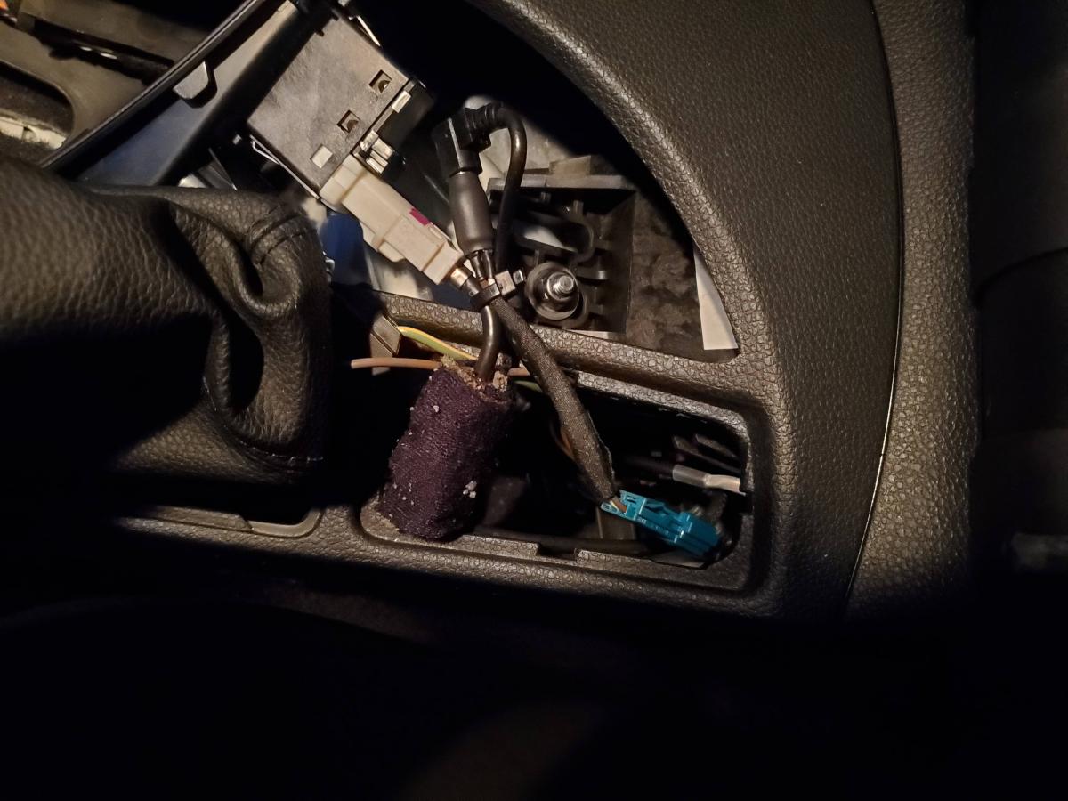

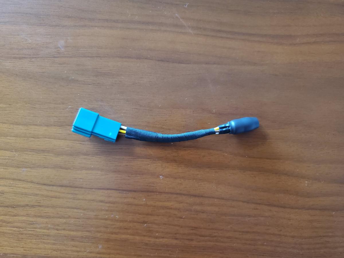

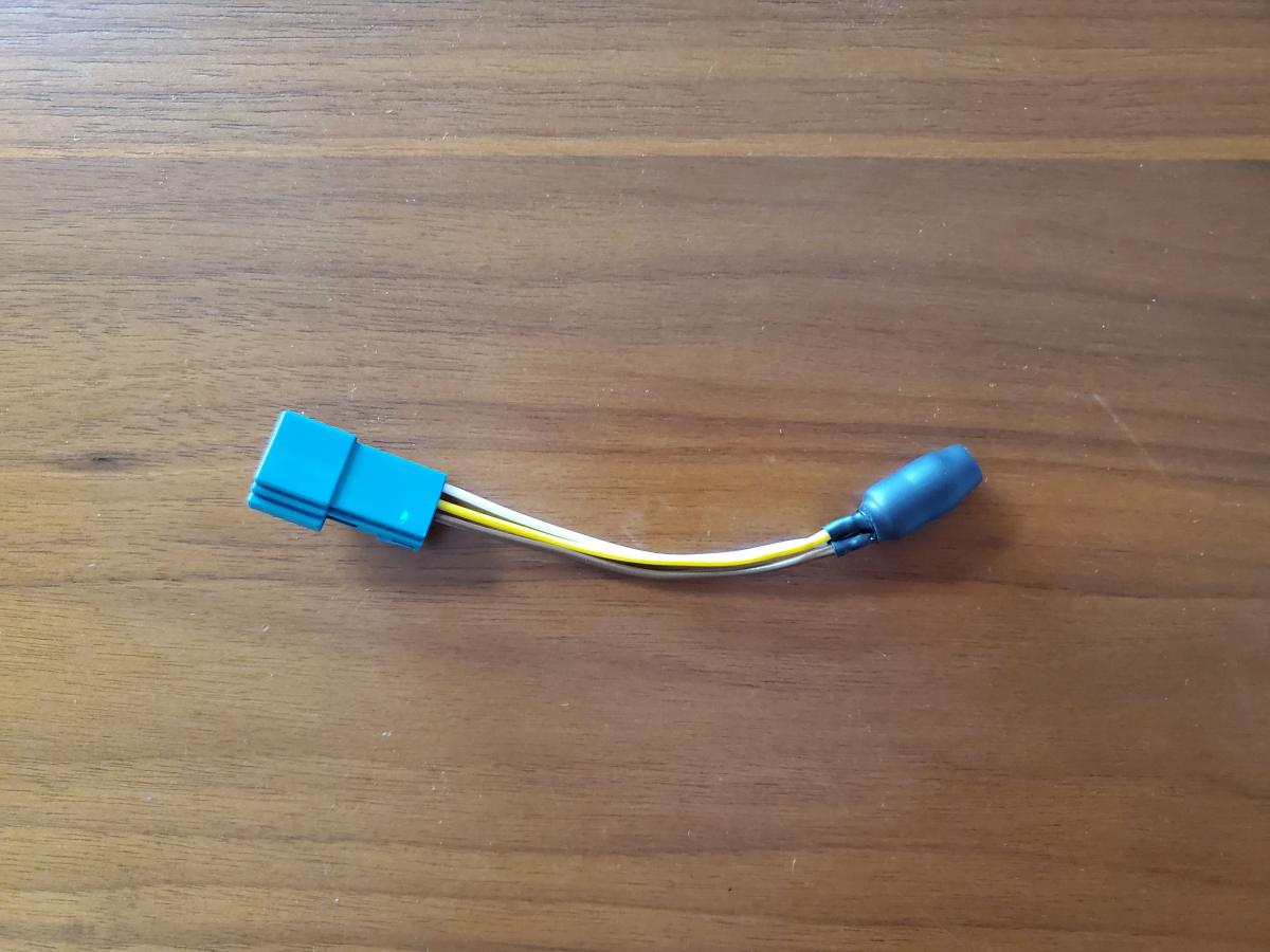

          I ordered a female connector that will plug into the harness connector for the aux jack. Once I have that, I'll remove the 3.5mm part from the cable and crimp some pins on to go into the female connector. With that, I'll be able to have everything hidden under the center console, instead of having a cable snaking up along the outside of the center console. I'll lose aux jack functionality, but who cares.
          The other thing I did differently was the placement of the module. The instructions say to place it in front of the fusebox, which I did not like at all. If installed like that, access to the fuses is completely blocked unless you remove the module, which isn't trivial. Instead, I decided to just leave the module in the glovebox. Takes up a bit of space, but it's not a big deal. Plus, this way I have super easy access to it if needed and it doesn't block access to the fuses at all.
          Wiring harness ran behind trims and cleaned up:

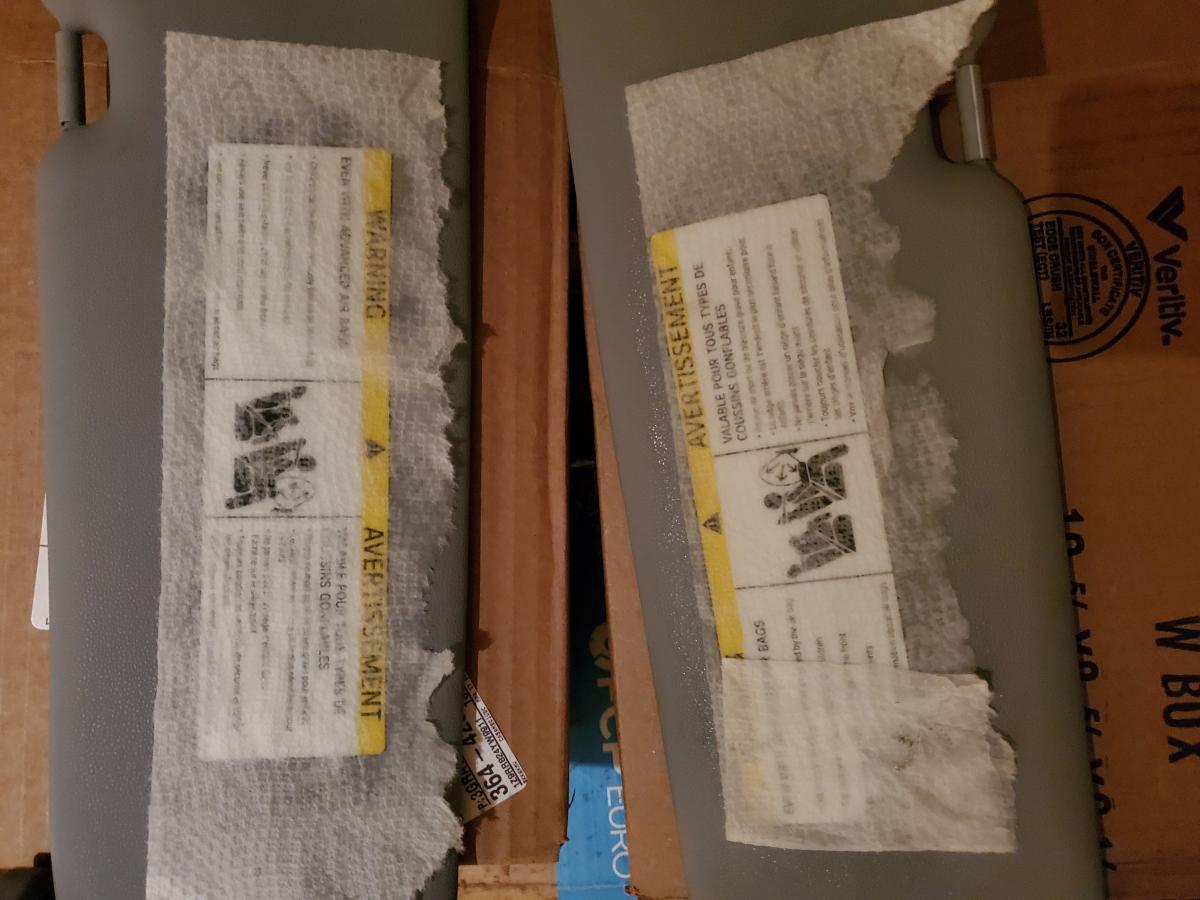

          Next, I removed the airbag warning stickers. Isopropyl and paper towels made this pretty easy:
          Much better.

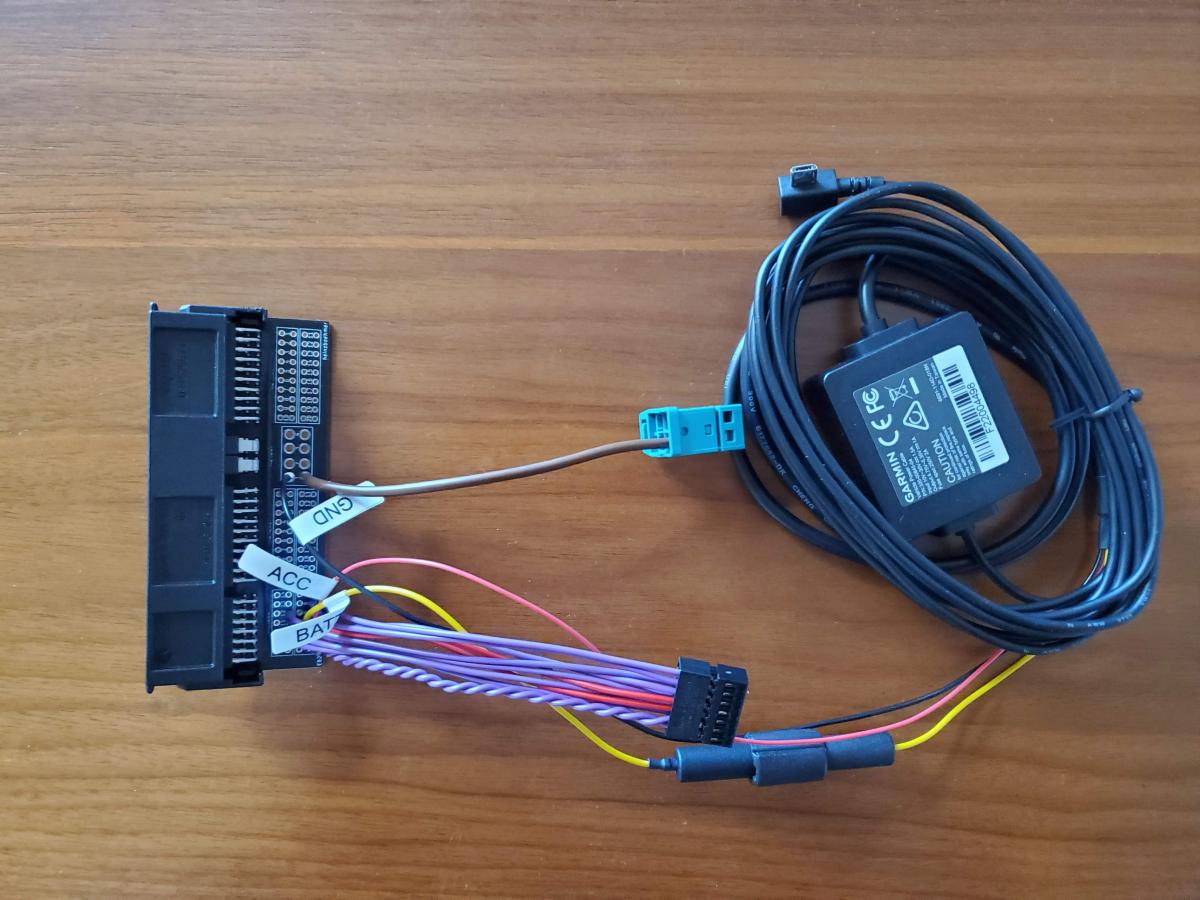

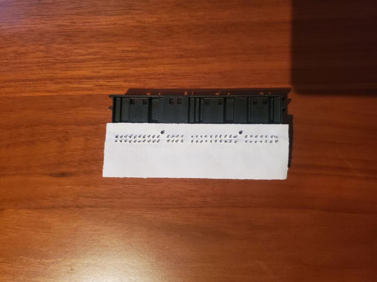

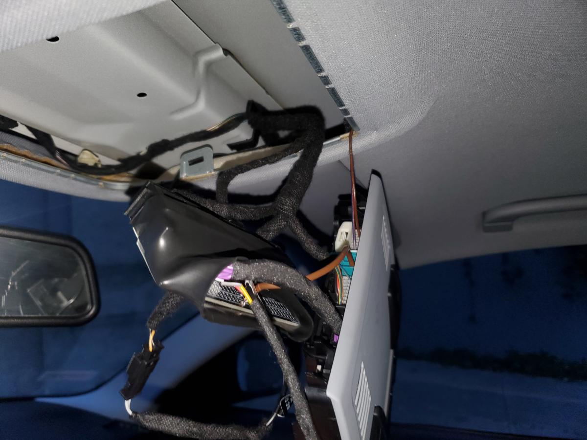

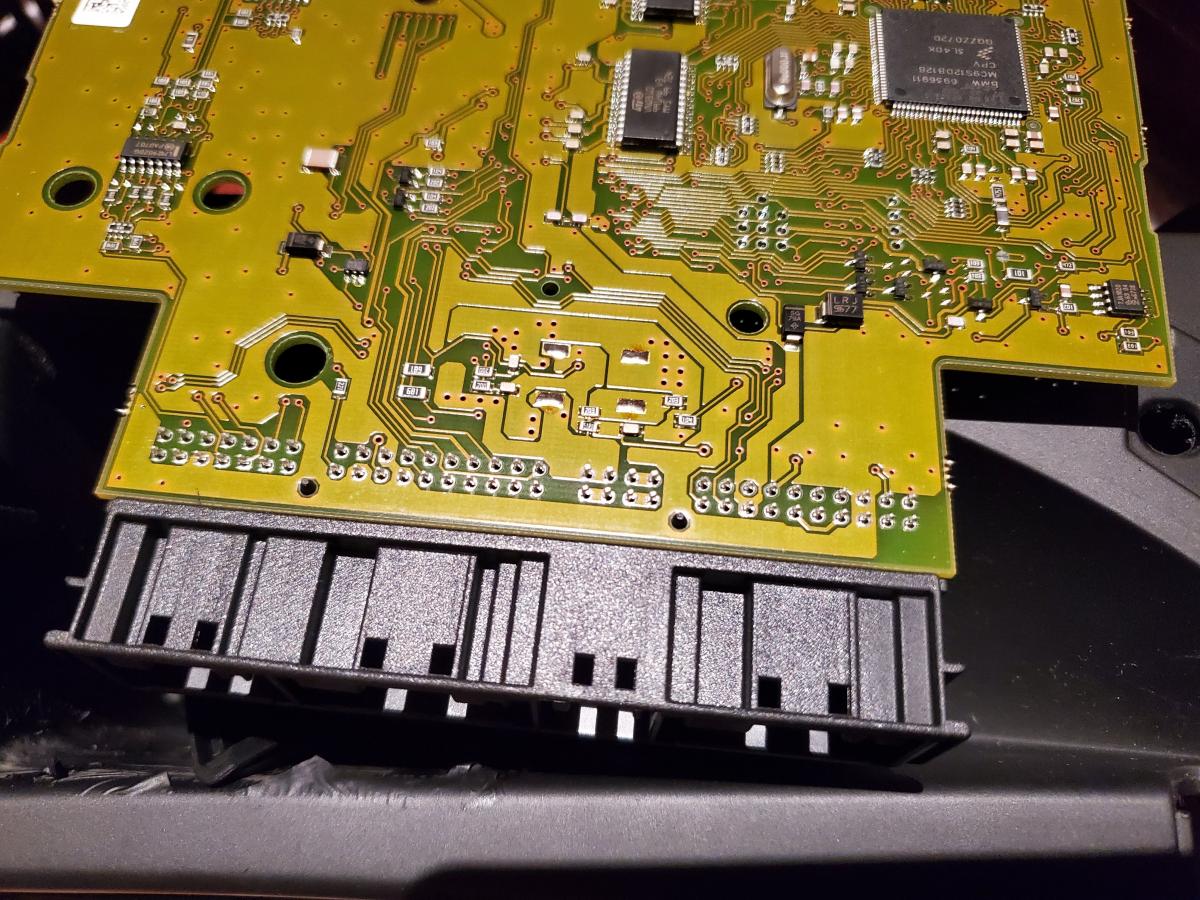

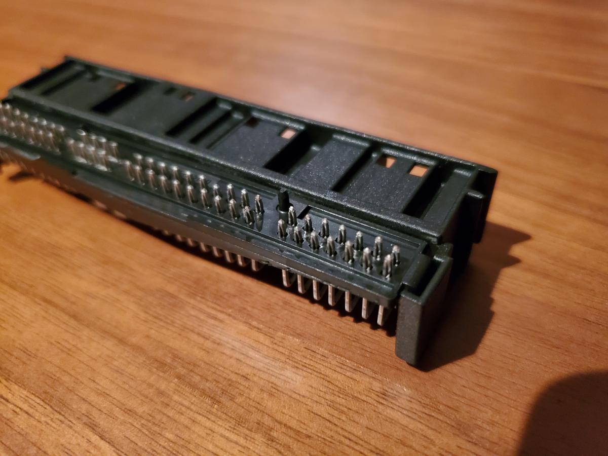

          After that came the dashcam install. Turns out that there's some plugs in the dome light that have constant and switched 12V, which is great! Unfortunately, the female connector seems to be BMW specific, so I was unable to find it at the regular electronics distributors, so I ended up buying a used dome light panel and scavenged the connector from it. Then I designed a quick breakout board to use to tap into the wiring harness.
          Surprisingly, the connector was not soldered on, just pressed in. Honestly, this made it a bit annoying to remove, but I got it off after some messing with it:
          Here's a closeup of the pins, you can see the protrusions that dig into the PCB when pressed in:

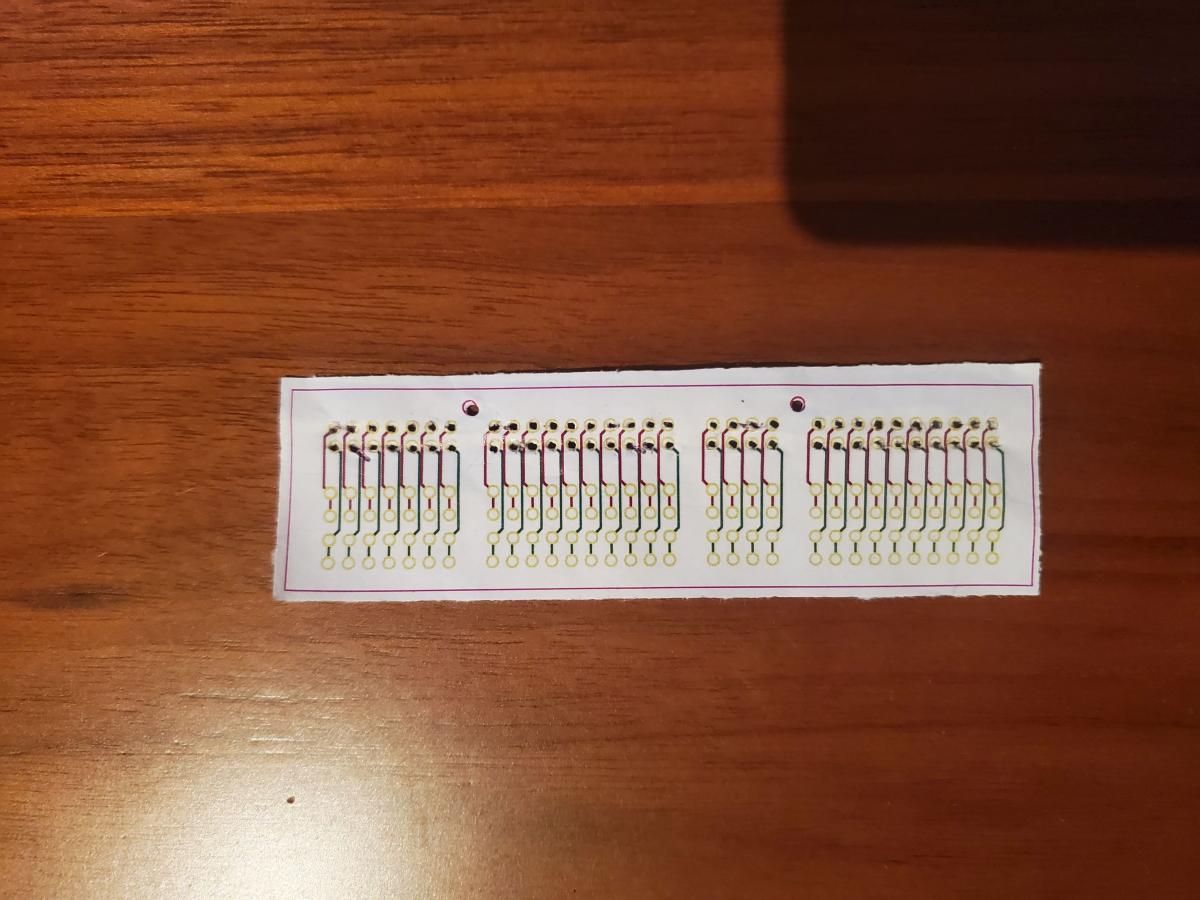

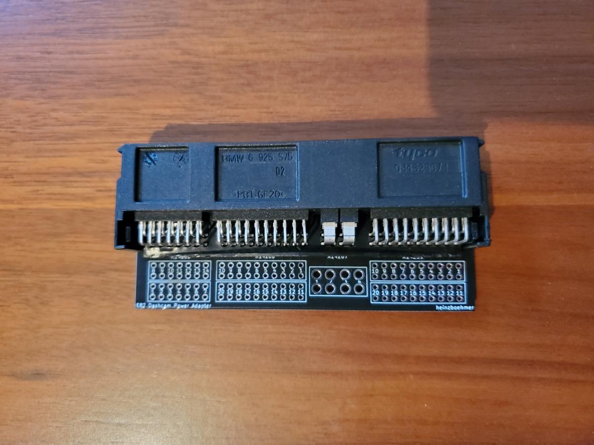

          Since the connector is proprietary, I wasn't able to find a datasheet for it either. This meant making a footprint for it off of my own measurements. Before getting the PCB made, I printed it out and checked that everything fit well:
          Nice, got it correctly on the first try. Now I just need to wait for the PCB to arrive and then I can finish up the harness for the dashcam.

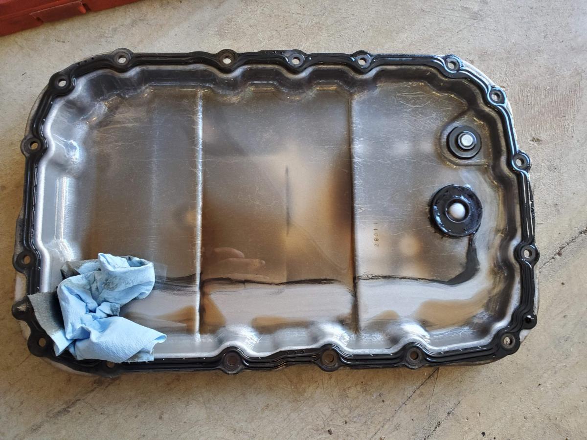

            Also gave this thing a fluid service this weekend. The car came with service records and it had been recently serviced at the dealer, so it wasn't a huge priority, but still wanted to do it to make sure everything was good.
            Did oil, coolant, transmission fluid (+ filter and pan gasket) and RBF600. Didn't do the diff fluid because it was surprisingly expensive and the car is at 76k mi. Plus, I'm kinda okay with the diff failing, since that means I can replace it with an LSD
            Nothing out of the ordinary with any of the fluids, but thought the before and after of the transmission pan cleaning was interesting enough to document:

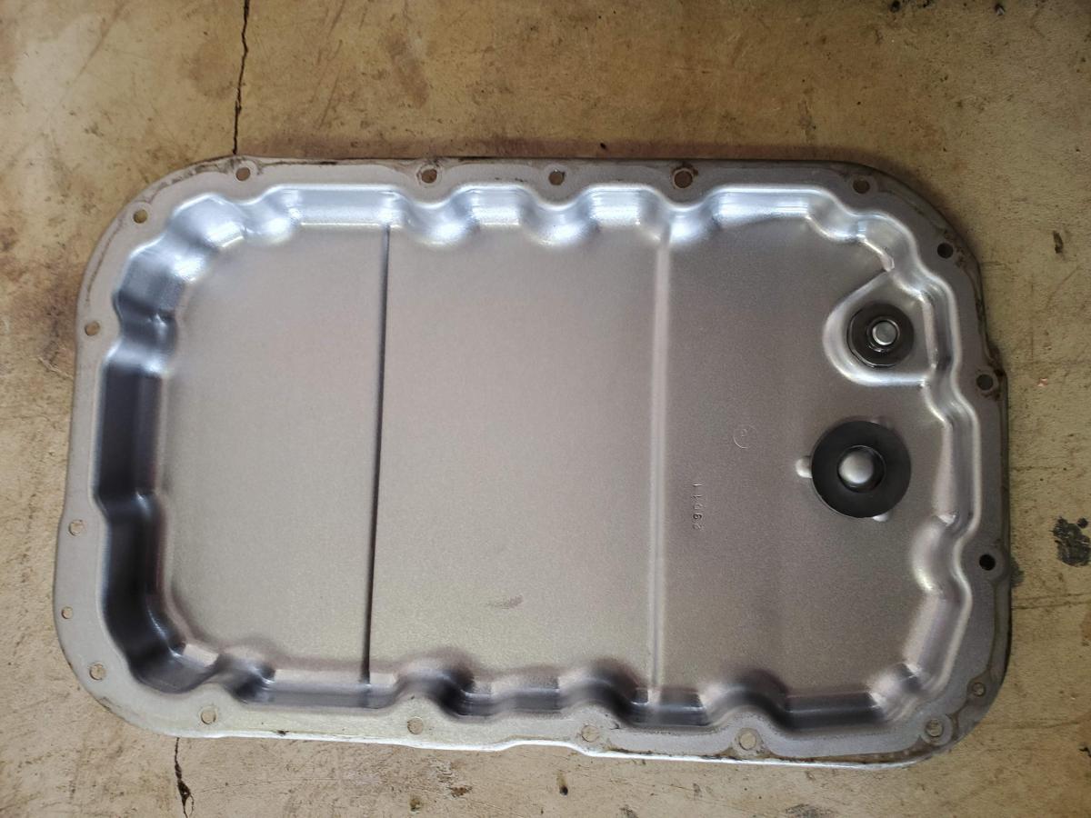

            I'm very unfamiliar with torque converter autos, but I think that amount of metal is normal/expected?
            I did make a very stupid mistake though. Did the service at a friend's house and used his jack stands. He has a set of those aluminum torin jack stands and at first glance all four look exactly the same. However, it turns out he has two from one batch and two from another. Most of the dimensions are the same, with the exception of the height of the outer red cylinder.
            When jacking up the car, I put the front up first at a height that seemed appropriate and then set the rear stands to have the same number of holes visible above the red part. I didn't realize this at the time, but because the jack stands are different, doing it this way meant that they ended up at different heights. This, in turn, meant the car was higher at the front and led me to underfill the transmission (by a lot).
            I realized something was very wrong quite quickly on the test drive and immediately drove back to put it on the stands again. This is when I realized that I had set them to different heights and had underfilled the thing. Jacked it up correctly and I was able to put 2 more liters in before it started coming out the fill hole (yikes). Unfortunately, I did drive the car around when underfilled, so I circulated a good amount of air through the hydraulic passages. After filling up to the correct level, the car shifts fine, but I can hear some gurgling in first and second gear. I'm assuming that's just air trapped somewhere. Gonna need to mess around with INPA/DIS to bleed this stupid thing and then recheck the level.
            Things would have been totally fine if this was a manual...
            I did also drain a bit of fluid when I realized things were wrong and saw no glitter, so I think the internals are okay. Just gonna have to spend a bunch of time getting the air out because of my stupid mistake. Lesson learned though, not gonna trust my eyes to tell me that a car is level in the future.

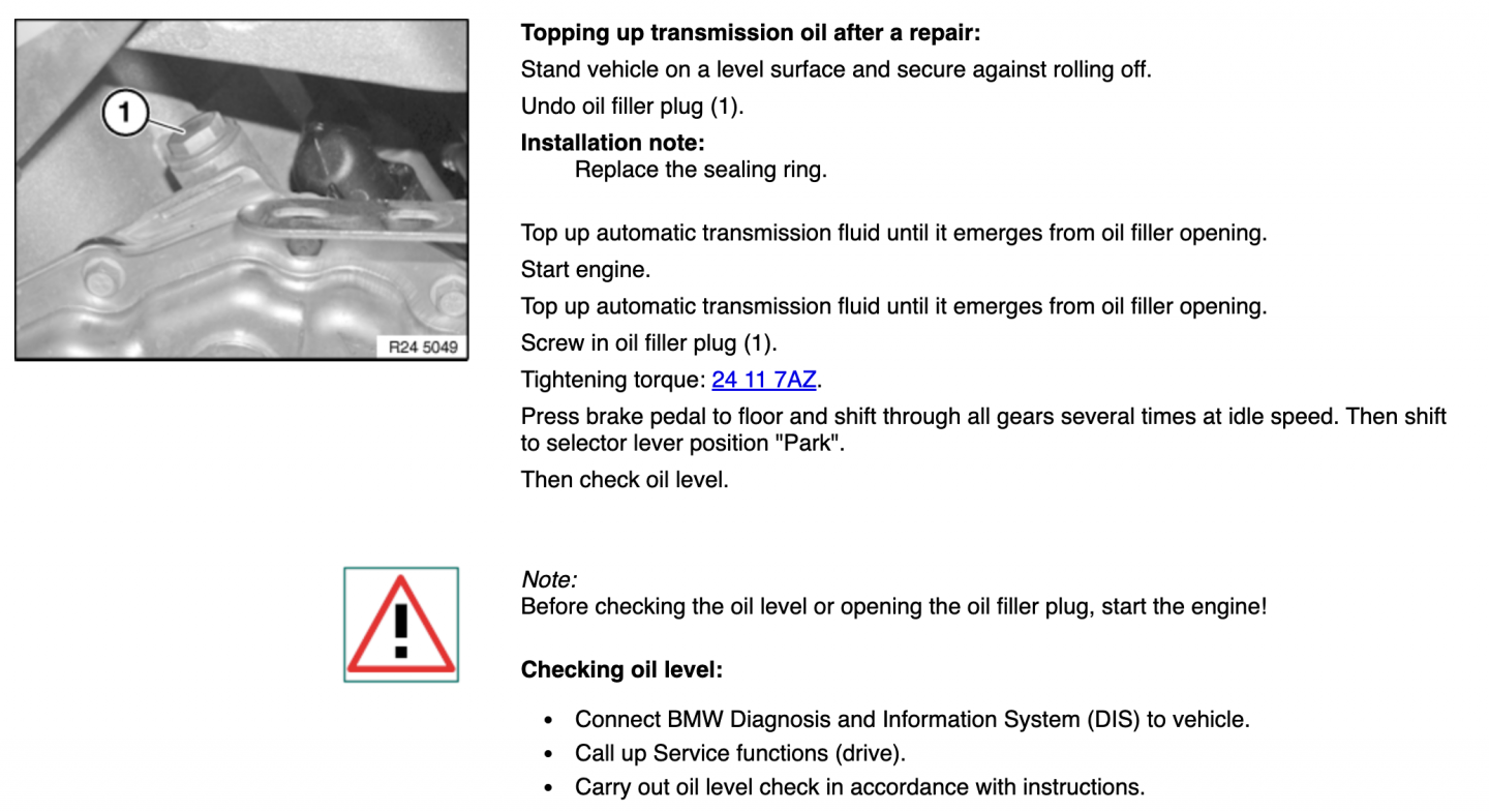

                Also, I fixed my transmission yesterday. It was shifting fine, but still making gurgling noises. I went back and read through TIS and realized I made another stupid mistake. I used this thread as a reference for doing the service: https://www.1addicts.com/forums/showthread.php?t=995991 . Just skimmed through it since I thought I mostly knew what I was doing. The one thing I didn't realize is that after filling the transmission back up cold, you're supposed to start the engine, get it up to temp and leave it running when you fill it back up to spec. I was getting it up to temp and then shutting the engine off. The thread doesn't ever say to turn it off, but for some reason I assumed that you needed to. TIS makes it super clear though:
Name:	Screenshot 2023-04-06 at 11.54.25 AM.png
                Honestly feel like an idiot about this, but that's what I get for skimming stuff and being overly confident in my skills as a mechanic (especially when servicing a system that I've never worked on before). Oh well, another lesson learned. Not gonna make that mistake again.
                Transmission took another 1.5 L when filled up correctly (yikes again) and the noises are now gone! Still no glitter, so think I managed to avoid killing it.

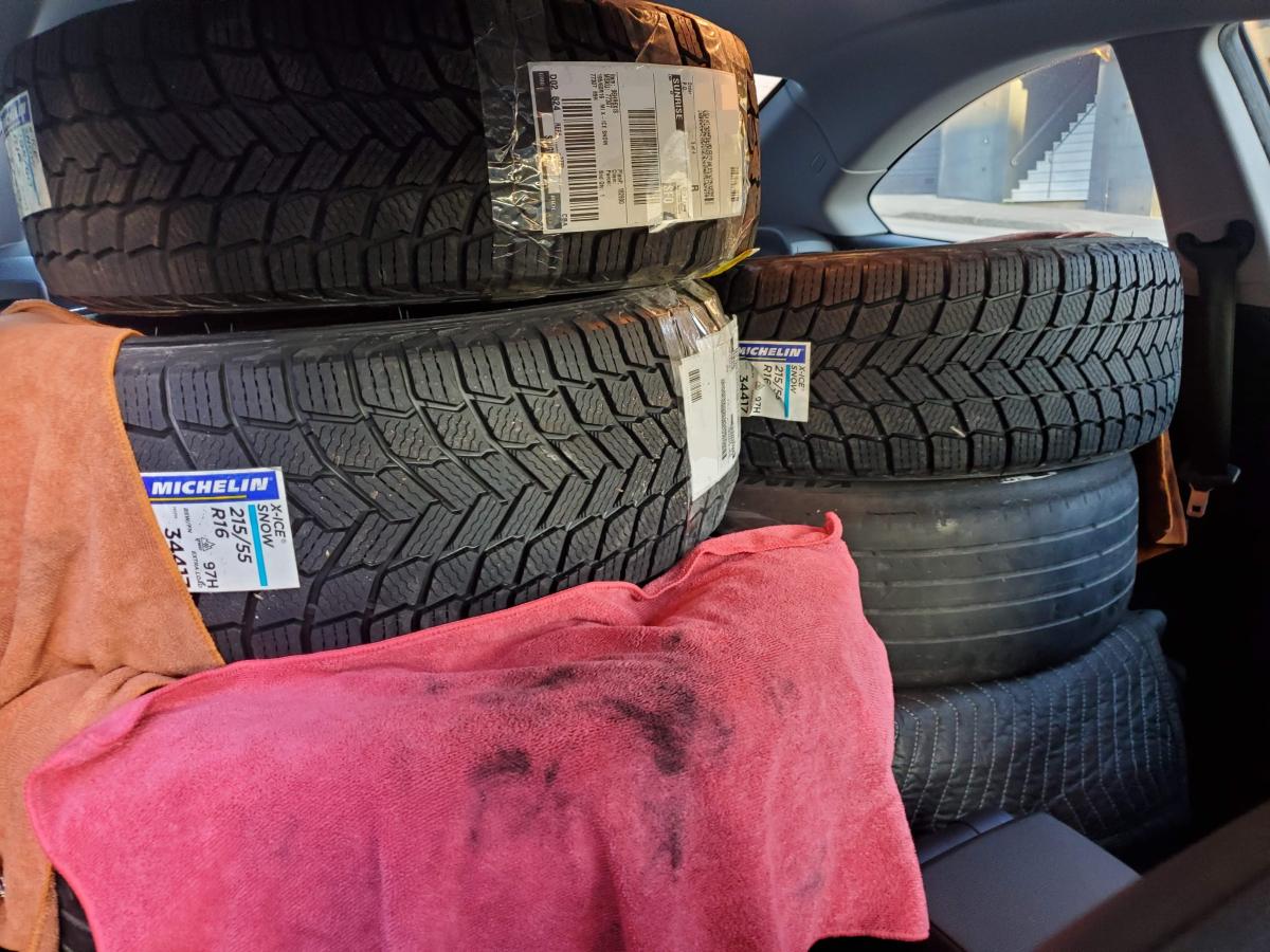

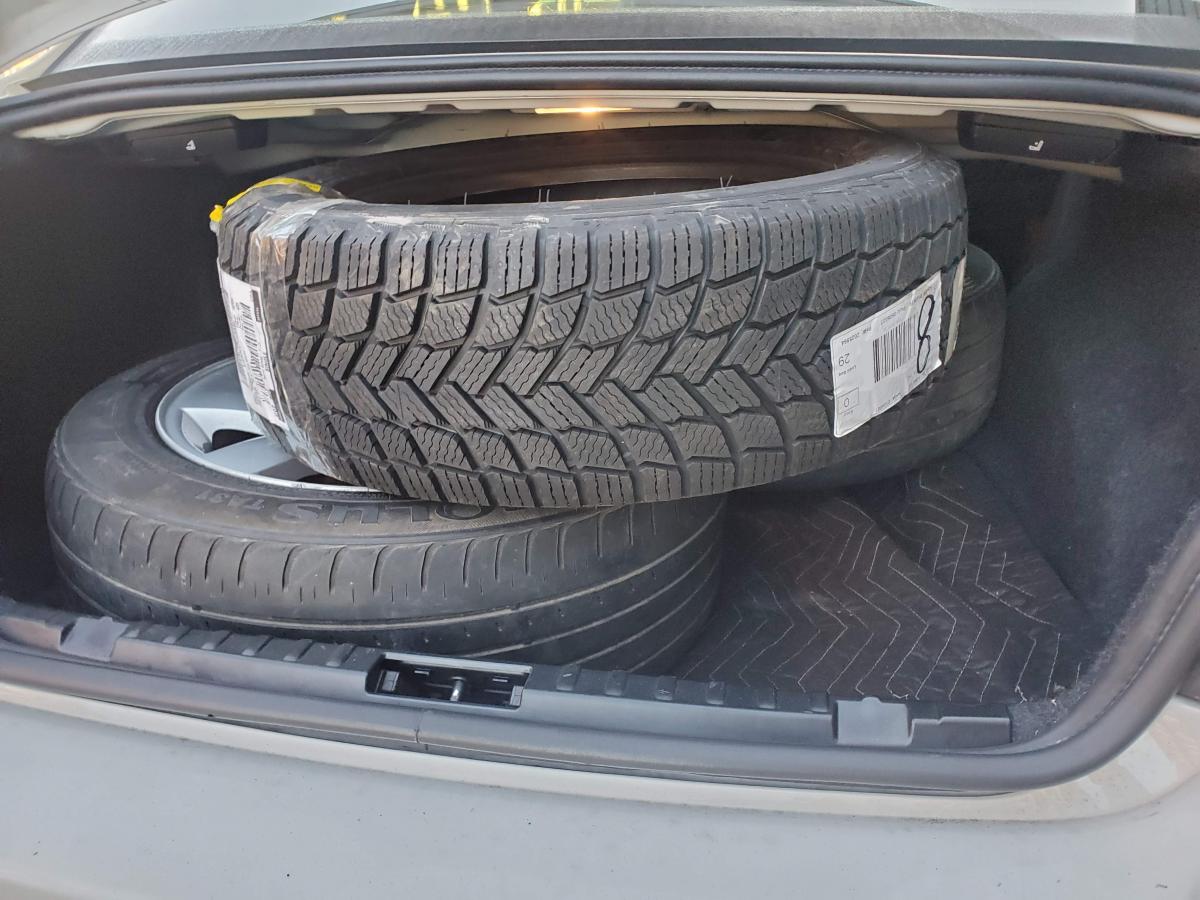

                After that, I swapped on snow tires cause this car is going up to the slopes soon. Surprisingly, the hubs were extremely rusty. Car has been in CA all its life, so no idea how they got like this. Even the hubs on the M3 —which was driven through winters a good chunk of its life— looked nothing like these. They cleaned up well though.

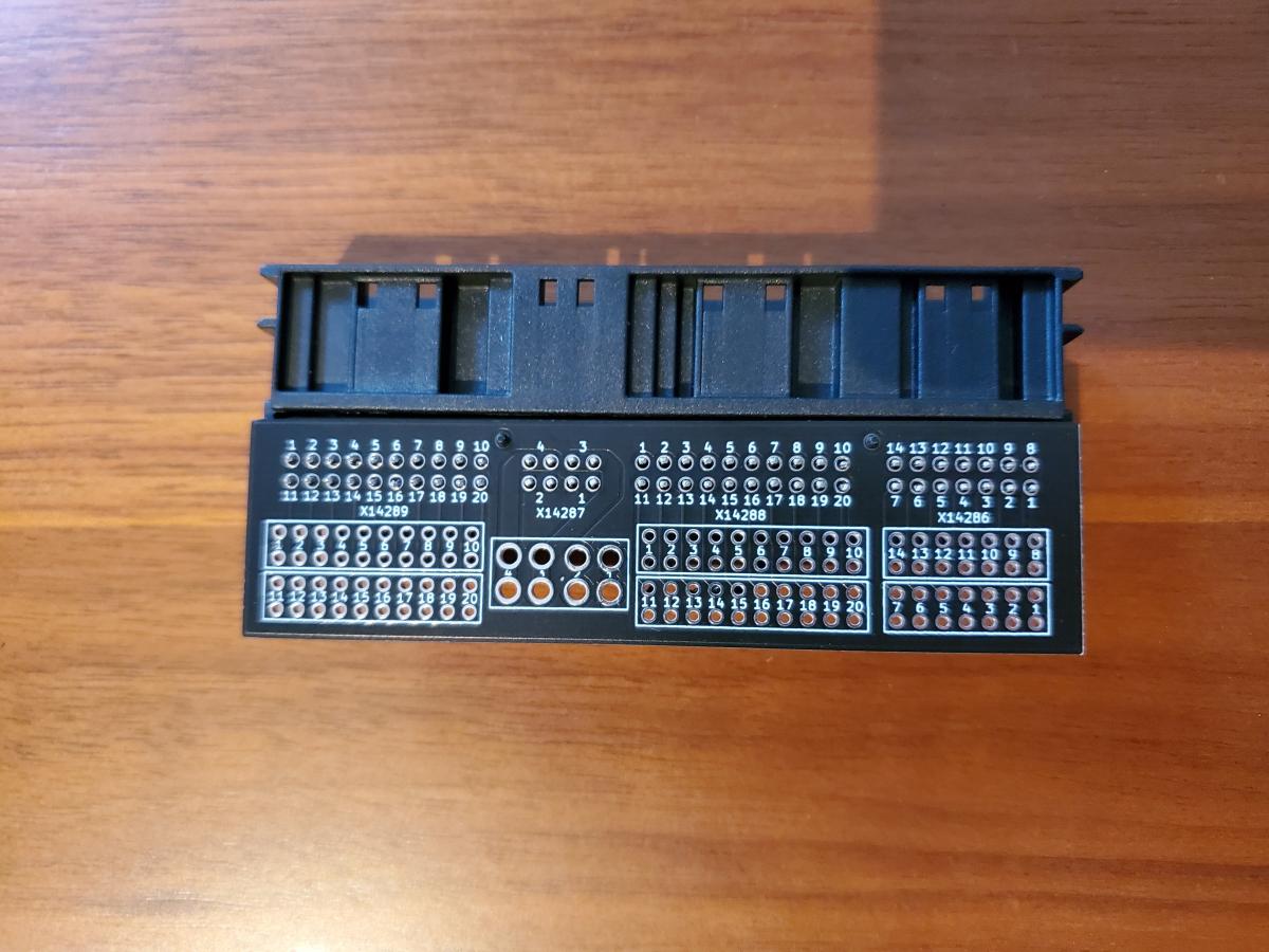

                  Ooh dashcam PCBs just arrived. Fit is great. Proud of my measurements.

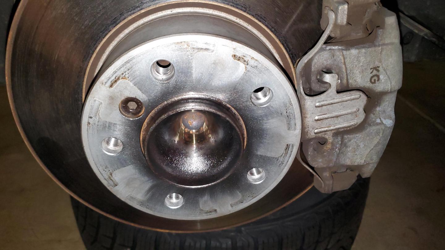

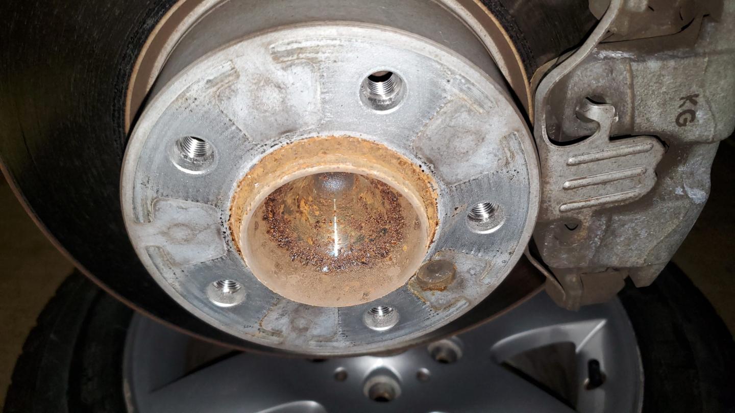

                    What did you use for hub clean-up? I got one of those drill brush attachments, it's kind of plastic-y feeling and I don't think it does a fantastic job.
                      Nothing fancy. Just a wire wheel on a drill and some brake cleaner. After that I added a thin film of WD-40 just to keep water away. Sprayed it on a rag first, not directly on the hub.

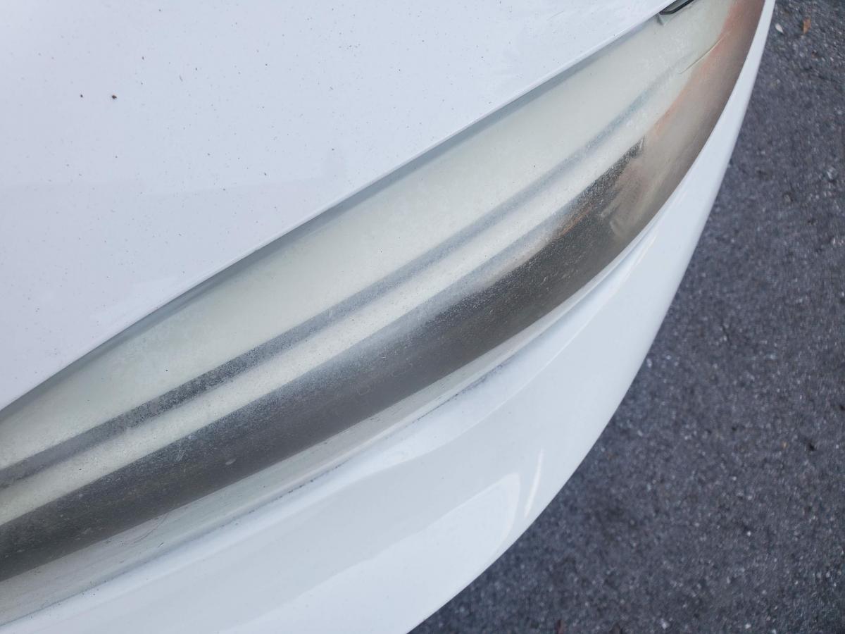

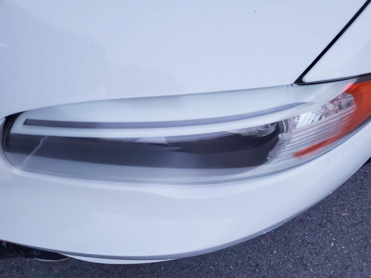

                        Did some small things.

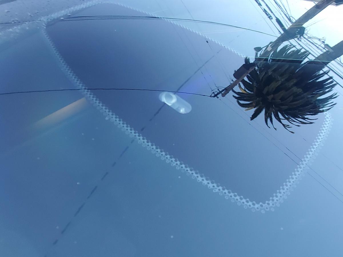

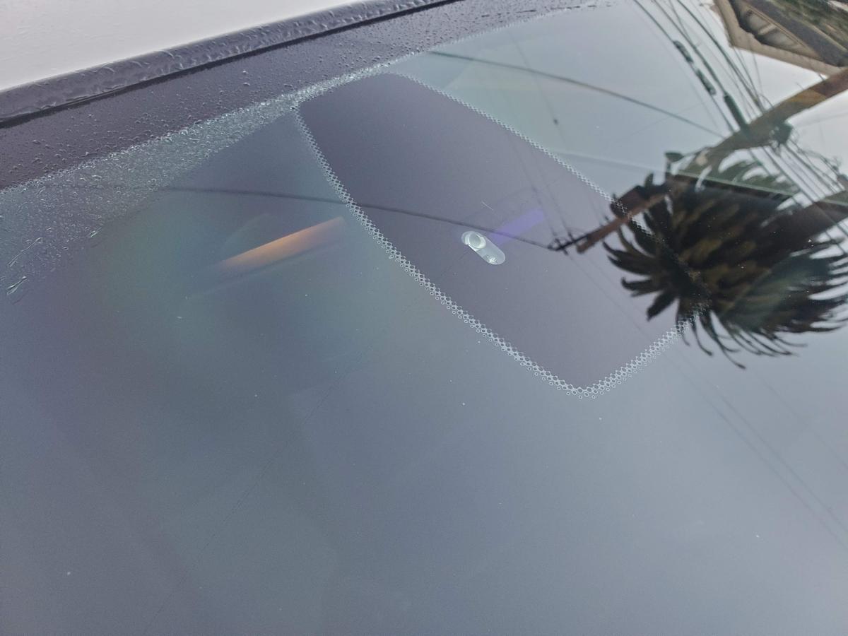

                        Windshield was getting a bunch of streaks when using the wipers, so I cleaned it up with some 0000 steel wool and then washed it. Did a quick coat of wax on it too to help the rain glide off.
                        Streak:
                        Click image for larger version  Name:	20230411_185235.jpg Views:	0 Size:	67.0 KB ID:	213826
                        No streak:
                        Click image for larger version  Name:	20230411_191425.jpg Views:	0 Size:	73.8 KB ID:	213827

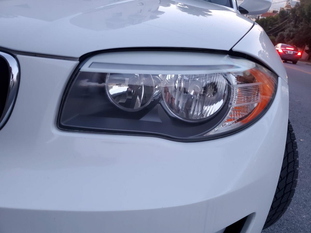

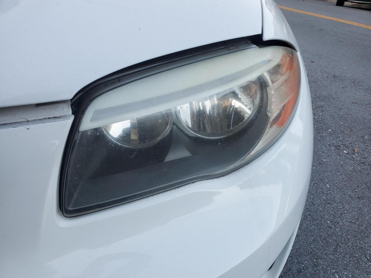

                        Headlights were looking pretty tired, so I polished those up quickly:
                        Click image for larger version  Name:	20230411_191455.jpg Views:	0 Size:	86.2 KB ID:	213828
                        Click image for larger version  Name:	20230411_191504.jpg Views:	0 Size:	100.1 KB ID:	213829
                        Click image for larger version  Name:	20230411_194830.jpg Views:	0 Size:	71.4 KB ID:	213830
                        Click image for larger version  Name:	20230411_194834.jpg Views:	0 Size:	81.4 KB ID:	213831
                        They're not perfect, but this is about as much as I was willing to go. The light output of the halogens is pretty terrible, so I'm considering one of those LED retrofit kits. Still need to look more into it because I'm not fully convinced that the retrofit kit won't blind everyone else on the road. Gonna need to see if I can find one to check out in person.
                        Anyway, point is that the headlights might get worked on again, so just did a super quick polish. Also, the car desperately needs a thorough wash. Will get to that after the car has finished its snow duties.

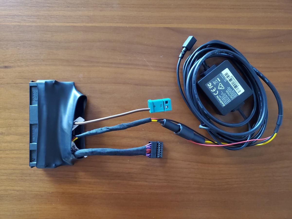

                        After that I finished up the dashcam install. Got the PCB soldered up and made it look niceish:
                        Click image for larger version  Name:	20230412_113452.jpg Views:	0 Size:	121.7 KB ID:	213832
                        Click image for larger version  Name:	20230412_114858.jpg Views:	0 Size:	113.2 KB ID:	213834

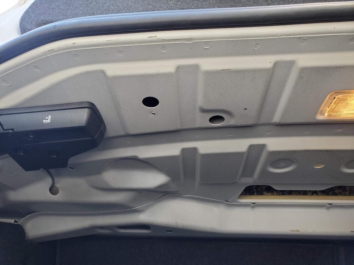

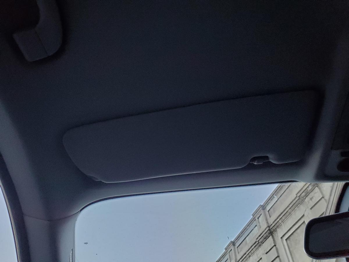

                        Went into the car without any issues. Since there's no sunroof, there's tons of space up in the headliner, so tucking it out of the way was super easy.

                        I also finished up the aux adapter so that the carplay module cable could be run fully inside the center console:
                        Click image for larger version  Name:	20230412_113351.jpg Views:	0 Size:	104.6 KB ID:	213835
                        Click image for larger version  Name:	20230412_115042.jpg Views:	0 Size:	99.0 KB ID:	213836
                        Click image for larger version  Name:	20230412_200244.jpg Views:	0 Size:	110.6 KB ID:	213837
                        No more visible wires . Center console is all taken apart cause the trim was pretty destroyed. More on that later.

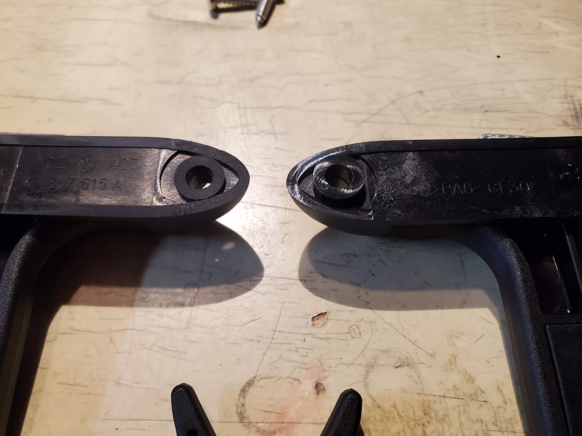

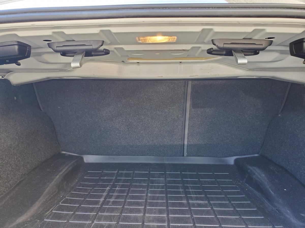

                        And finally I installed the same VW grocery bag holders that I have on the M3.
                        Just like before, I removed the locating dowel things to have them sit flush against the trunk panels:
                        Click image for larger version  Name:	20230413_111323.jpg Views:	0 Size:	89.9 KB ID:	213838
                        And installed:
                        Click image for larger version  Name:	20230413_113026.jpg Views:	0 Size:	91.8 KB ID:	213839
                        Click image for larger version  Name:	20230413_114851.jpg Views:	0 Size:	127.4 KB ID:	213840
                        Love these things, I use them a ton on the M3. They'll be even more useful on the daily.
