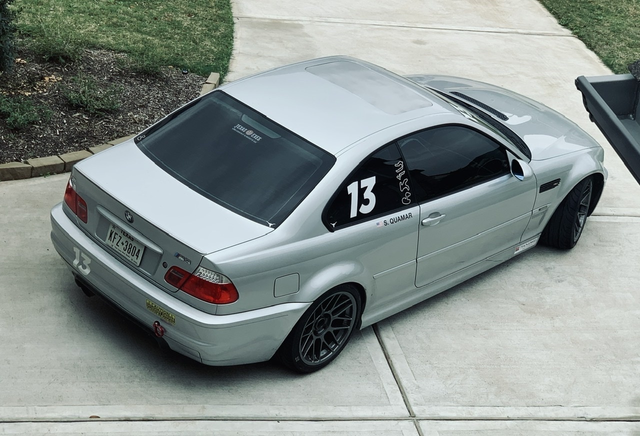

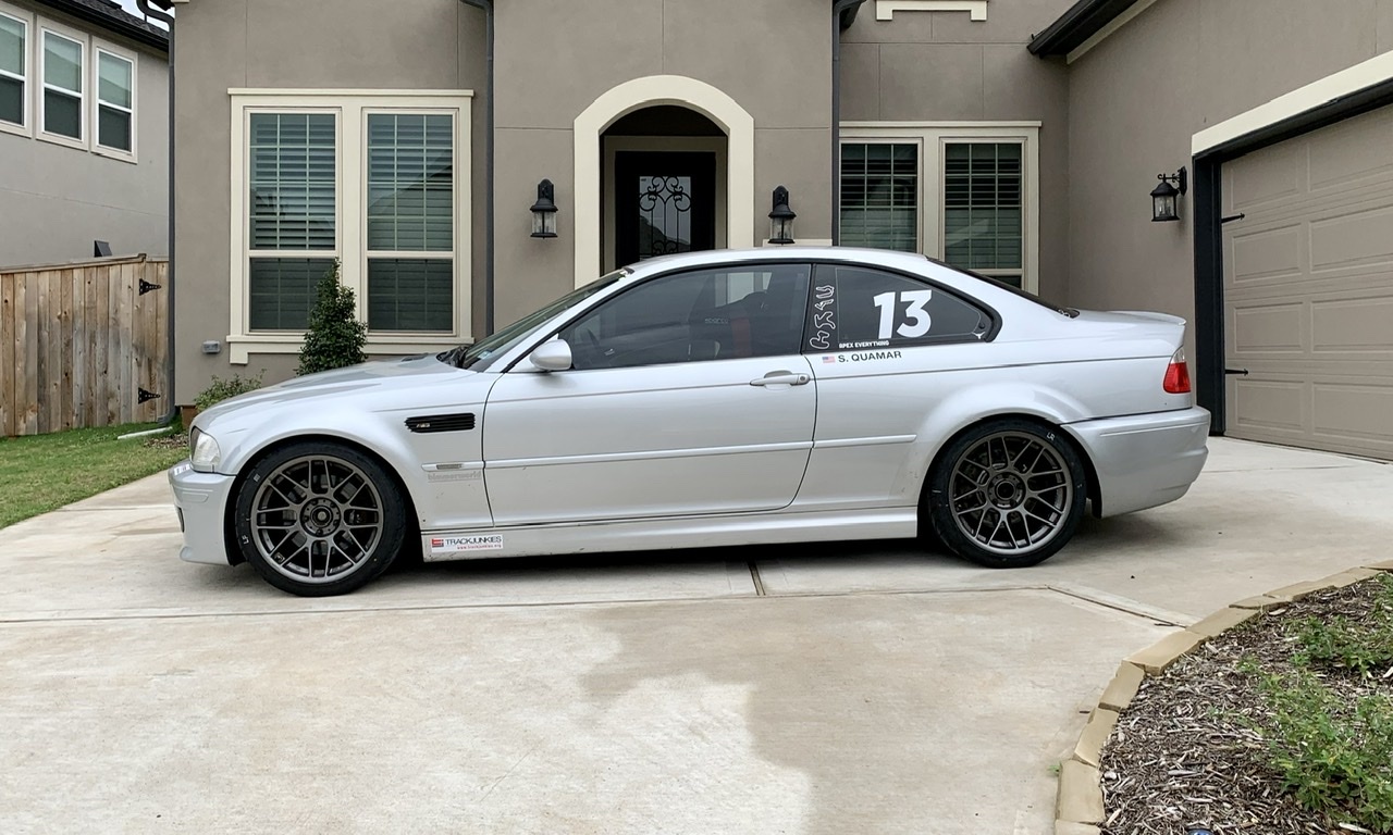

                              Hyper black ARC-8s look pretty good.

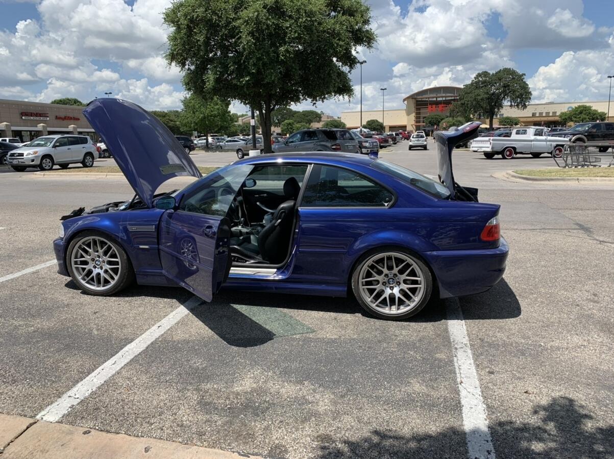

                              Three or so months later, the SMG became problematic again, so I said fuck it, parked it indefinitely, and used the track car as my primary car. Ever drive your car while wearing a shirt with a picture of your car?

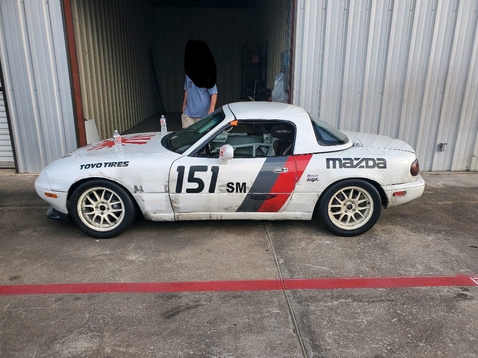

                              At around this time, a buddy invited me to do W2W racing in his Spec Miata. Well I was hooked, so I purchased my own racing suit, boots, and socks (owned everything else needed). And since I have this safety gear now, I figured I’d use it at all track events.
