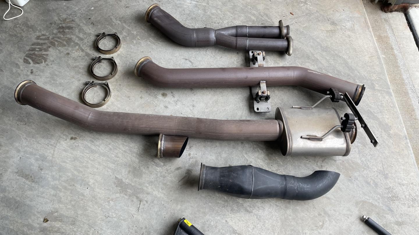

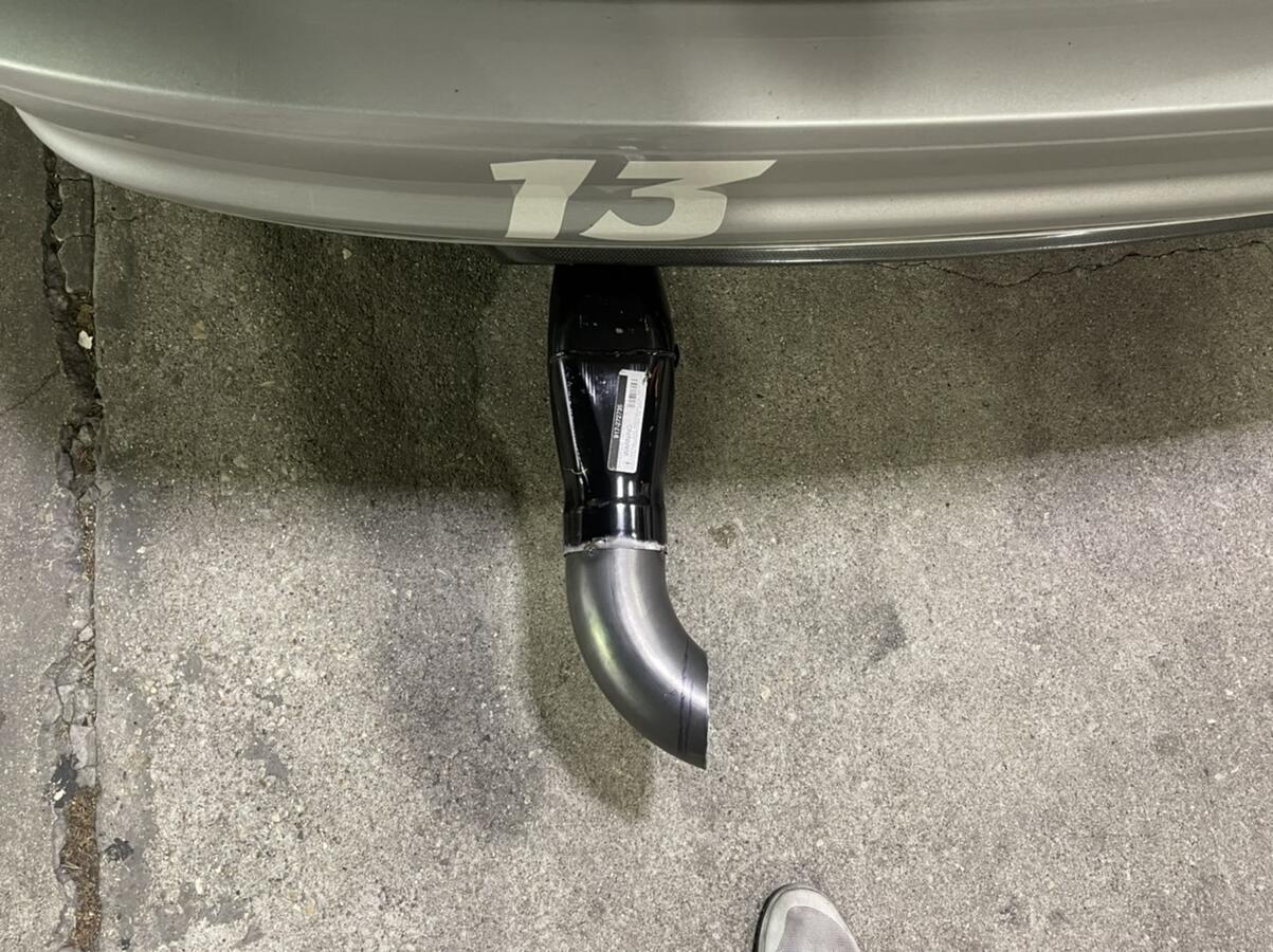

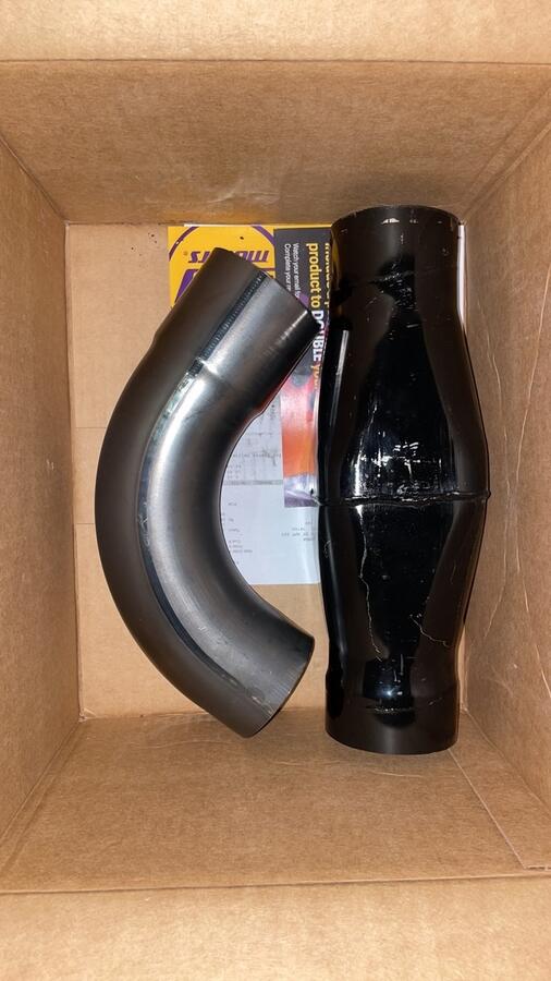

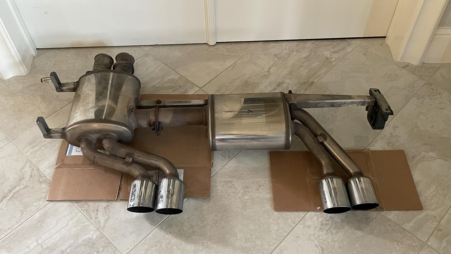

    The car needed a Laguna pipe so I could drive the car at Harris Hill. Pretty much copied KenO’s setup since his had been proven to work.

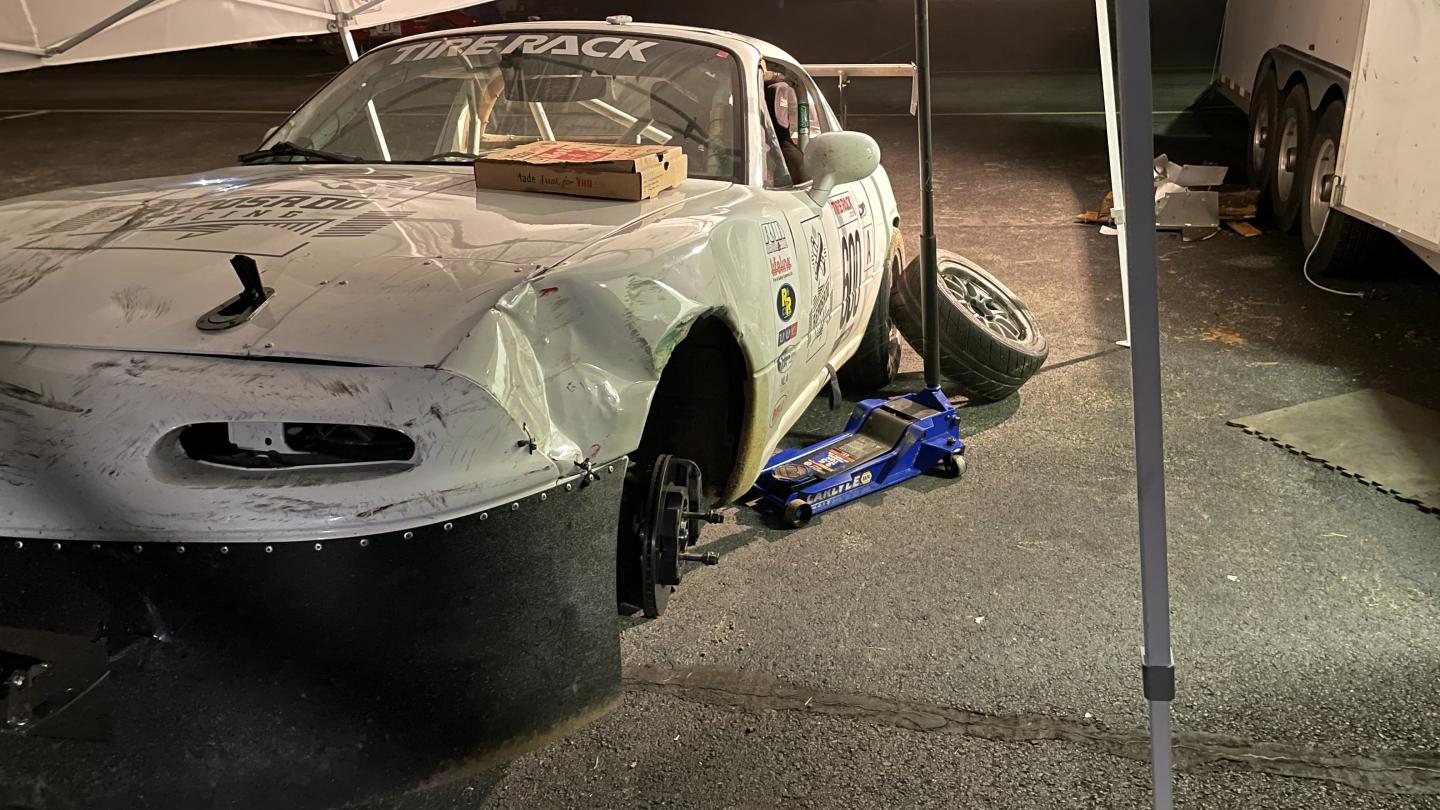

    Three days later, I did another enduro race in the SM. On the second day towards the end of my stint, some contact hurt me and took me out for the rest of the race. The car was able to complete the race though.

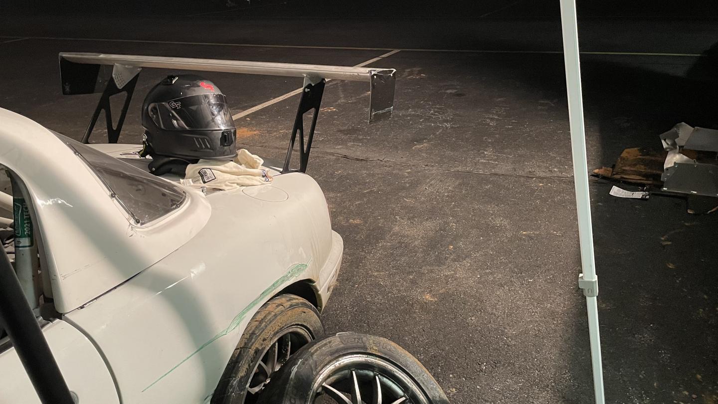

    Tech inspection bc I went off roading at Harris Hill

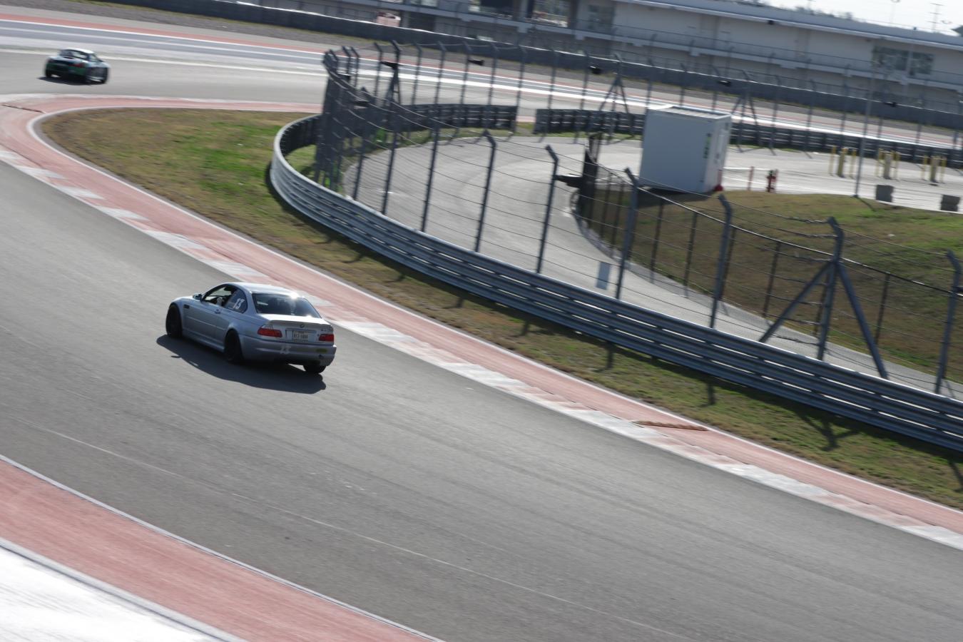

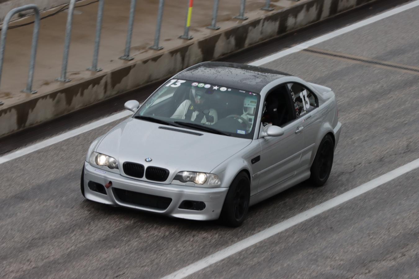

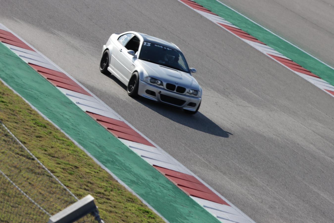

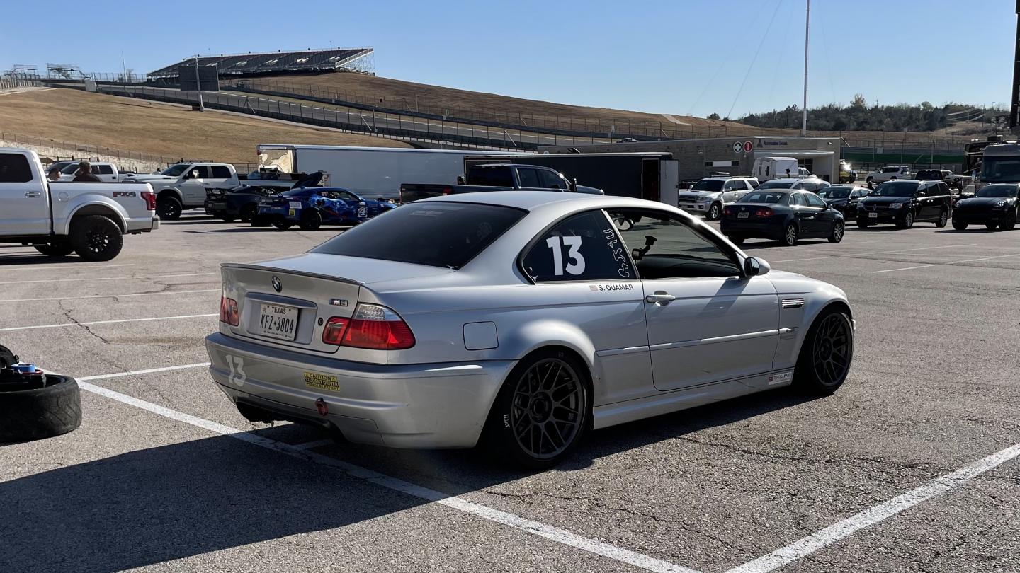

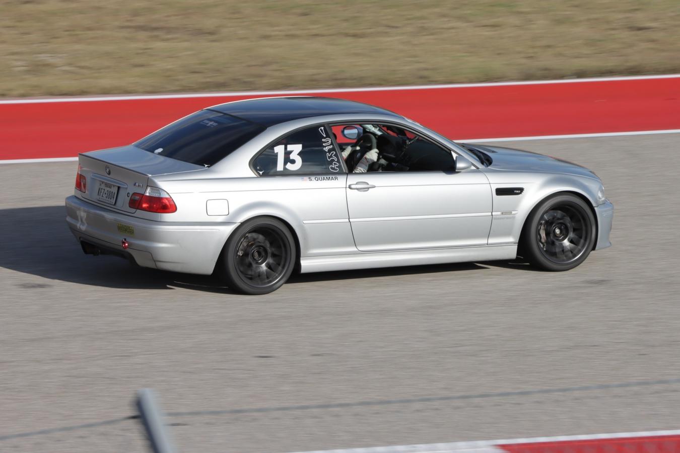

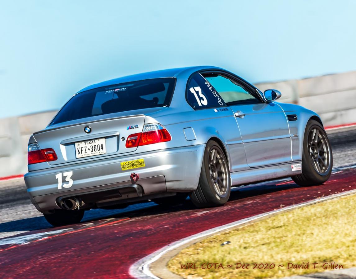

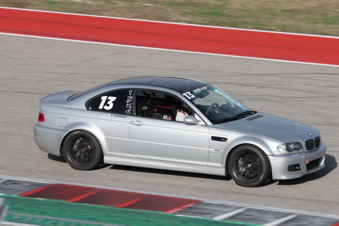

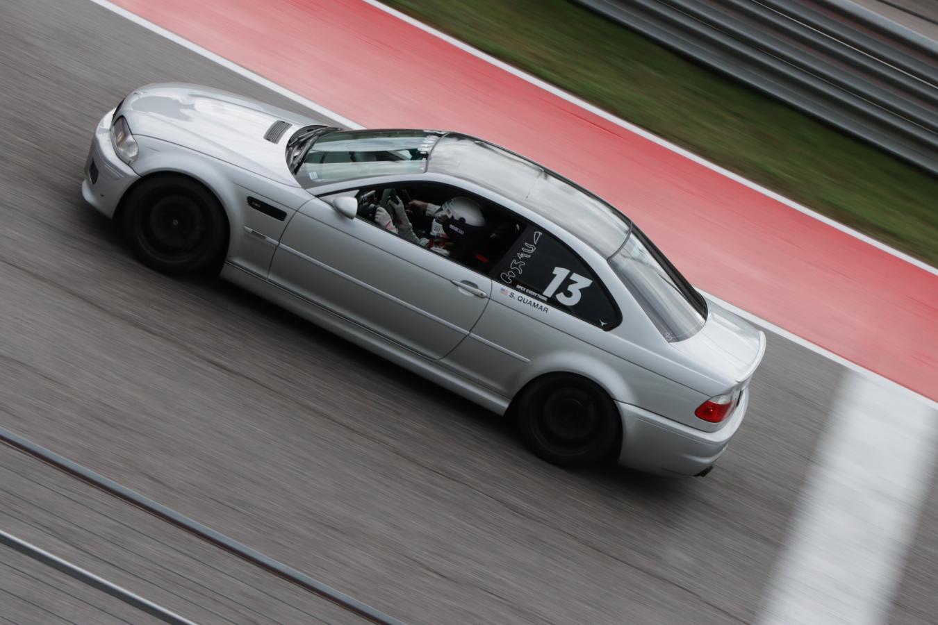

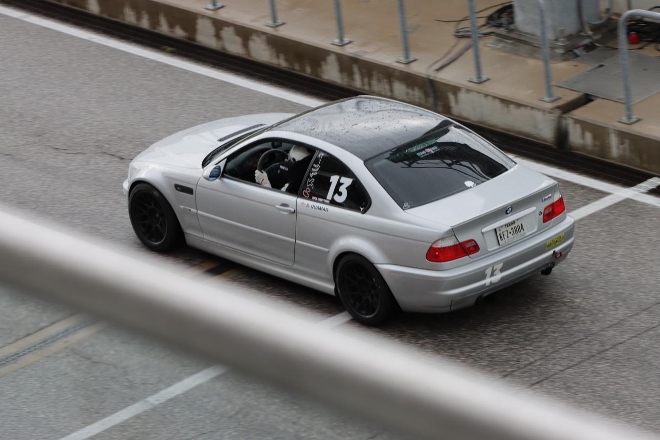

      Track day at COTA with WRL. What I love about the WRL DE is that I’m pretty much driving my car on track during the racers’ practice sessions. So I get to share the track with M3 racecars and $200k GT4 class cars which is super fun.

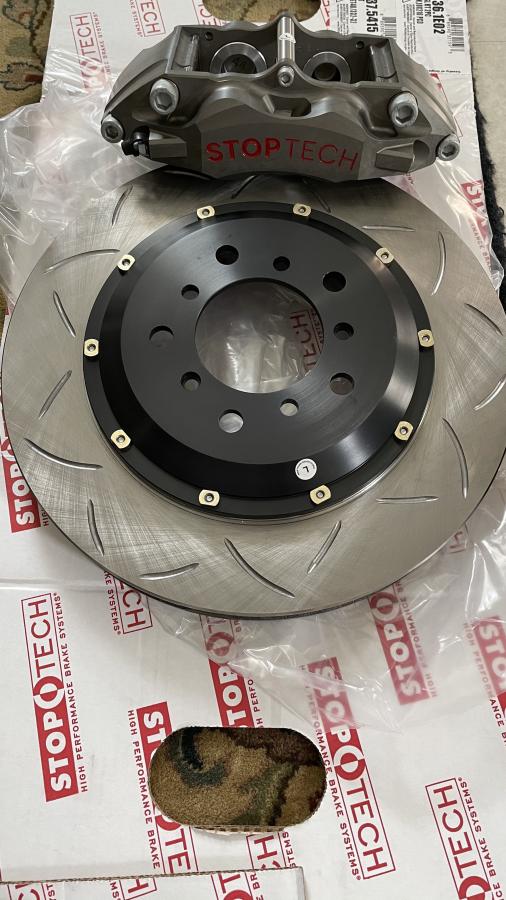

        Feb 2021

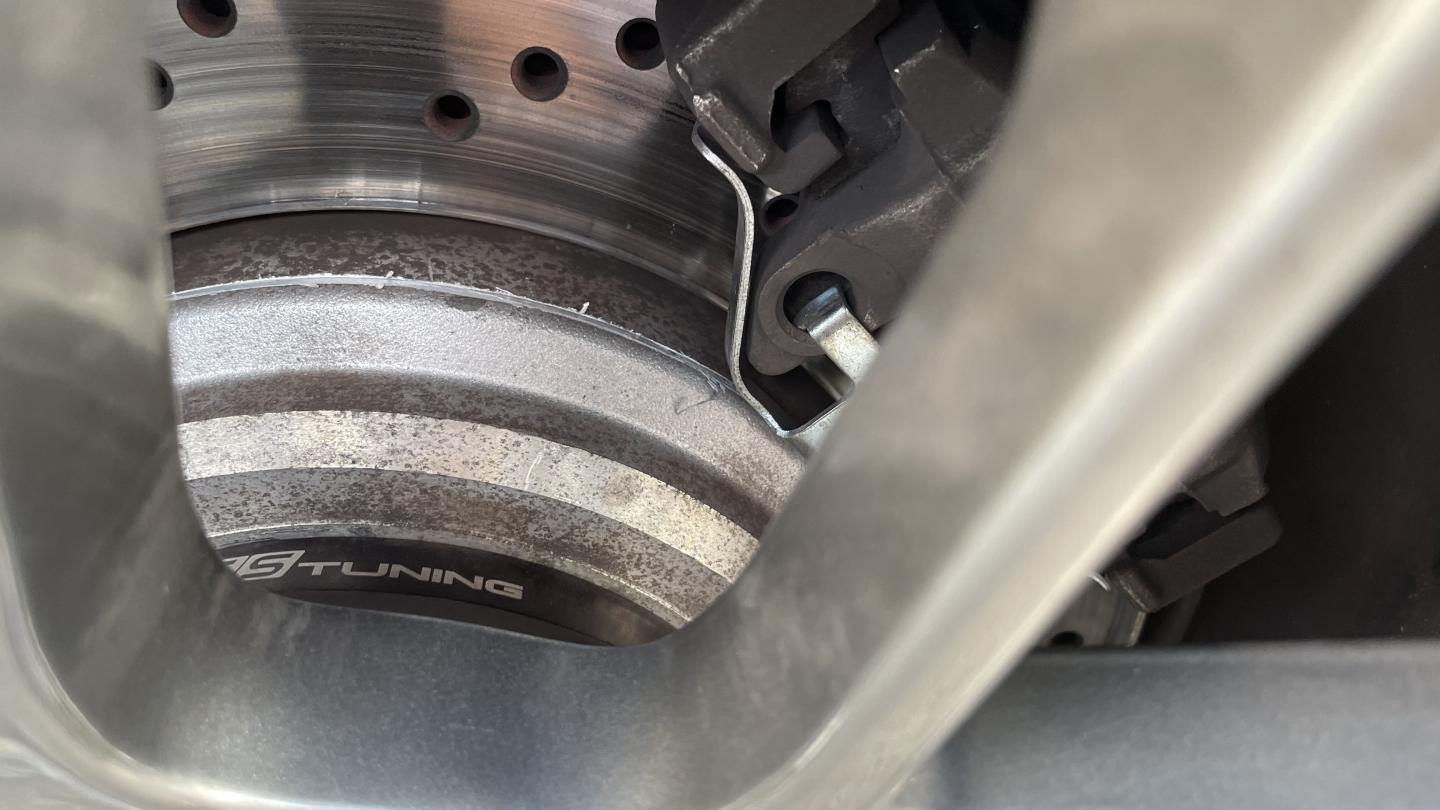

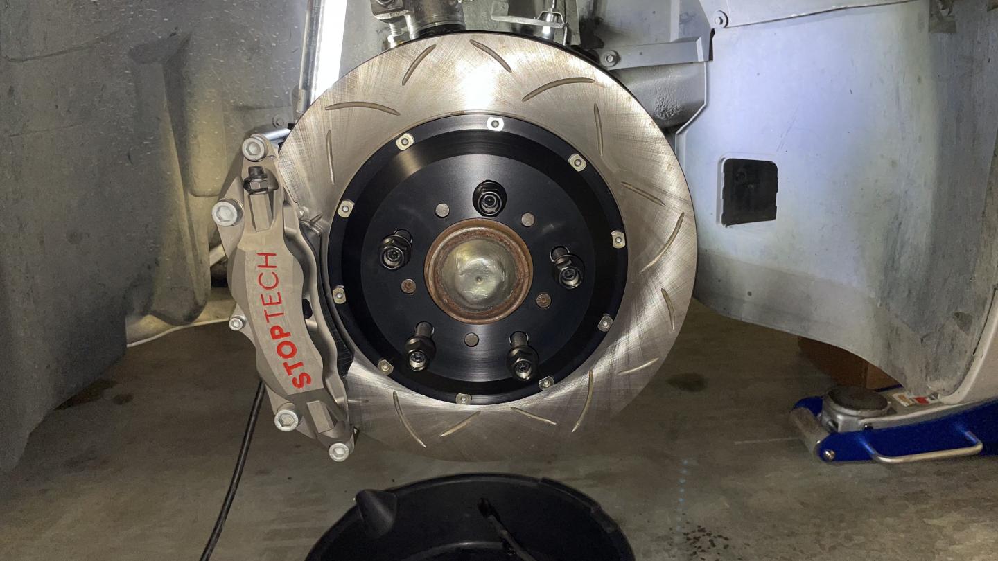

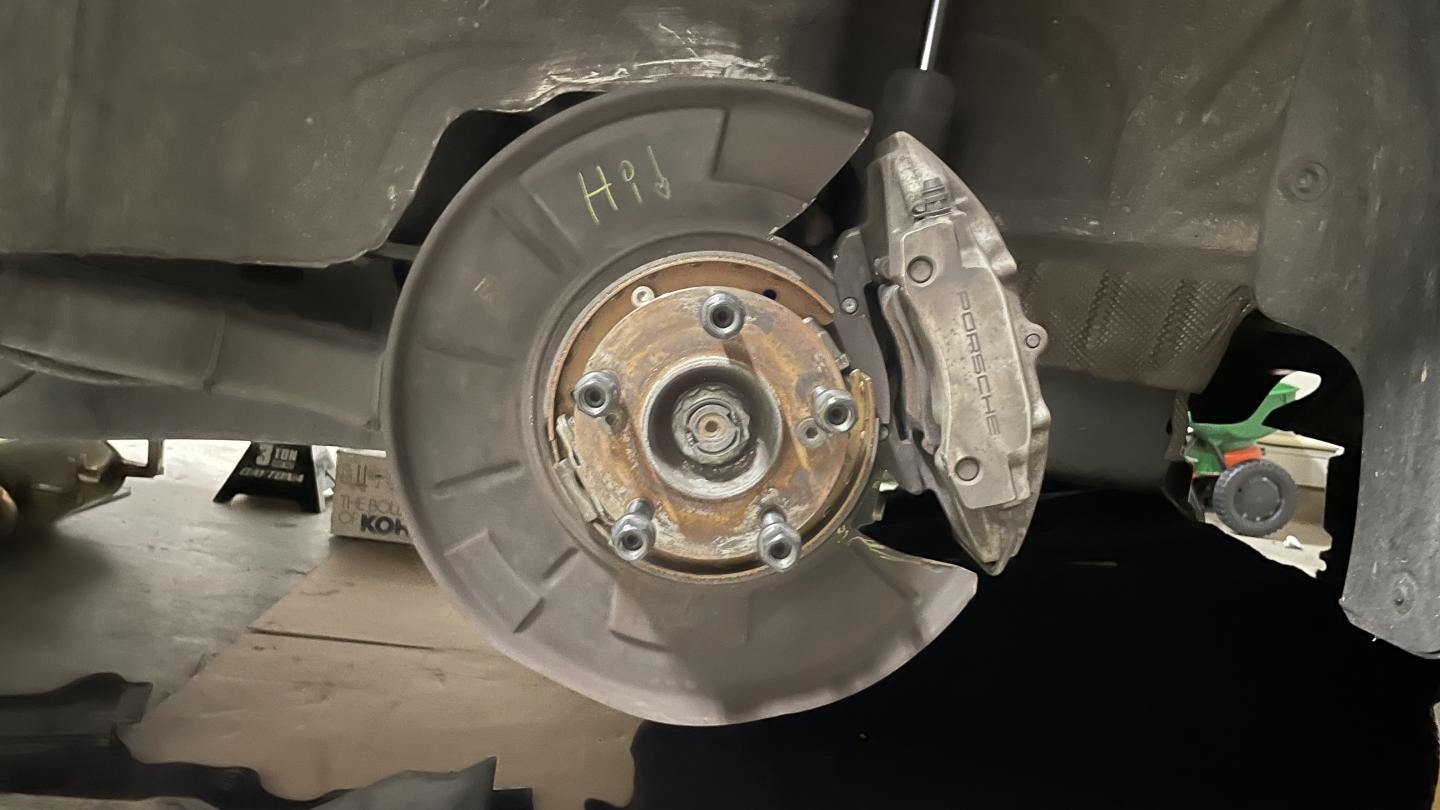

        Manual swap just completed on the blue car. Didn’t like how the stock brakes performed at the WRL event, so I got a StopTech C43 front BBK and rear 996 calipers. I held off on installing the 996 calipers bc I needed to refinish them.

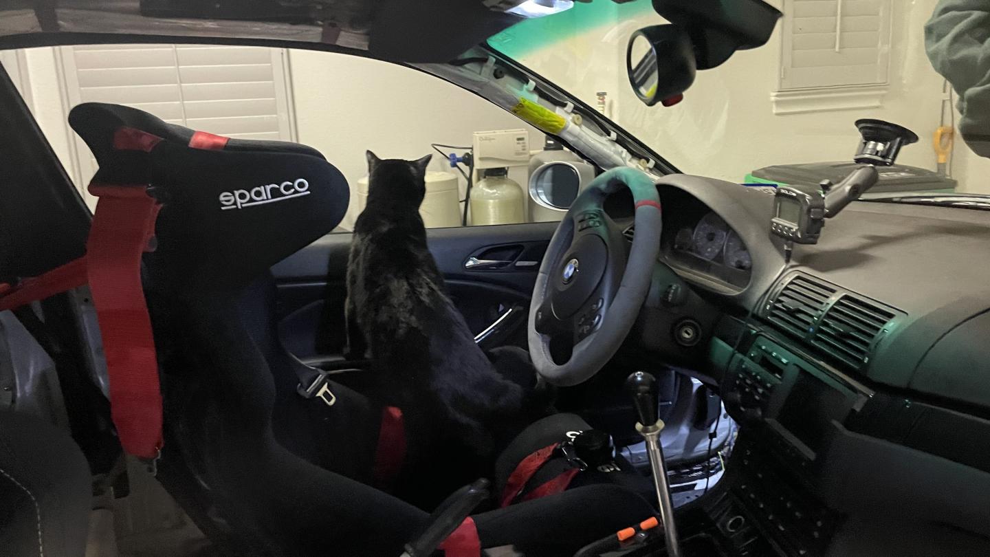

        Garage kitty

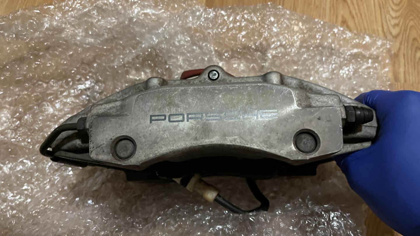

          Was going to do an open track day with some friends in May, but my rear brakes said no. Idk what changed to cause it, but the spring clip decided that it wanted to make contact with the rotor hat. The 996 caliper pistons and seals were good, so I threw them on with new rotors.

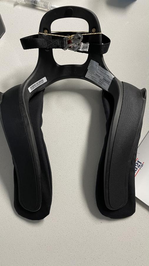

          New HANS

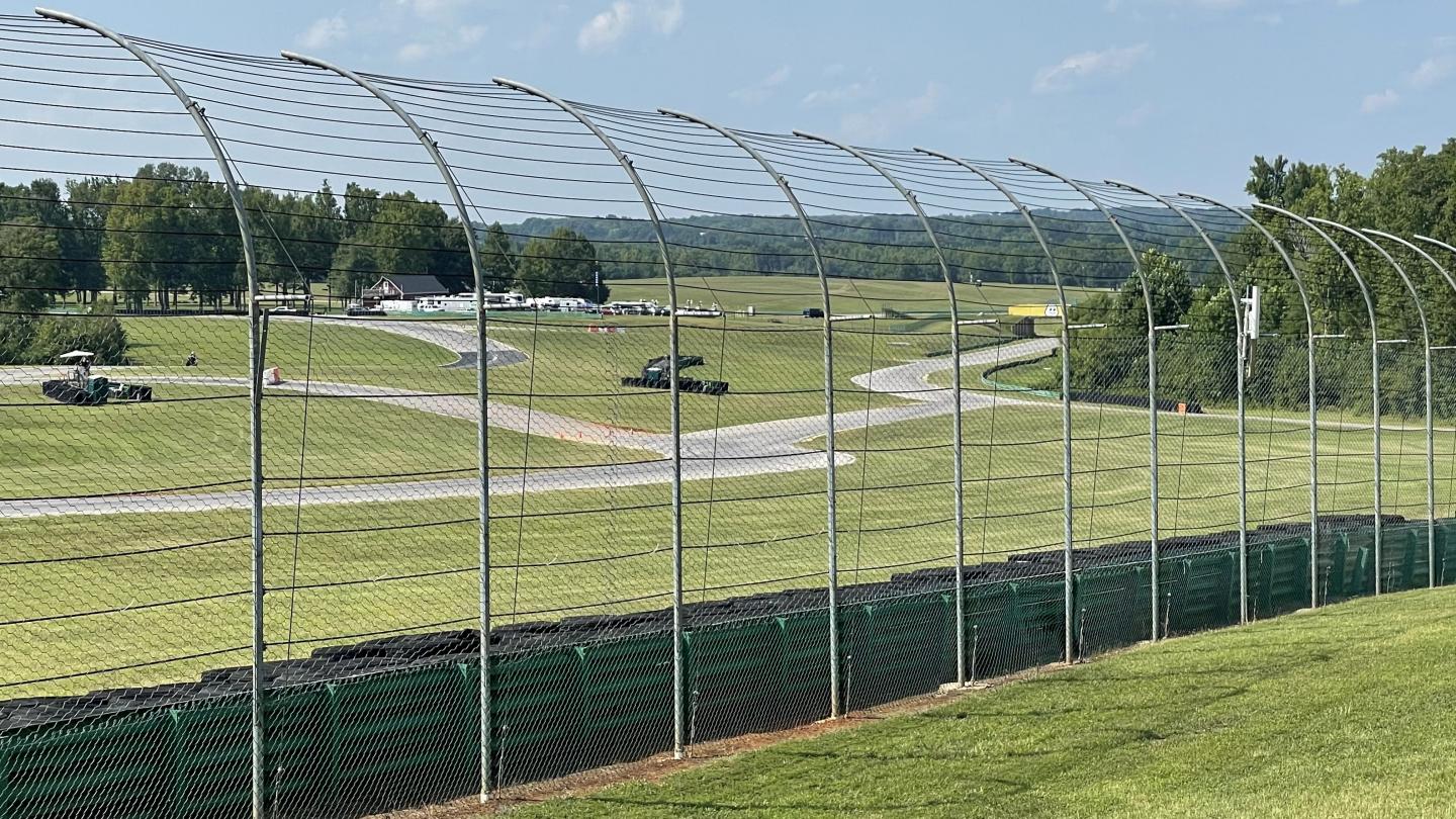

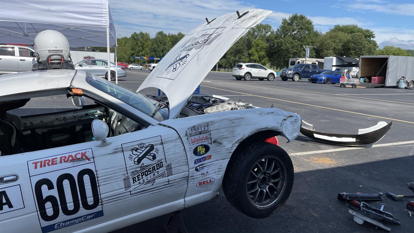

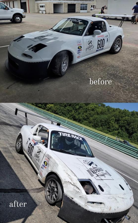

          Unrelated to this car, but we did a 24h race at VIR in August 2021. One of our drivers was being a dumbass by passing in a runoff area and crashed into the tire wall…two hours into the race and just before it was my turn to go smh. Eventually put the car together. At night it’s foggy and raining. Super sketchy esp with a Porsche driver who was passing under yellow, almost made one of our drivers crash. We were taken out of the race again when a tie rod failed, sending us into the main straight wall. We almost called it until I decided to search for a replacement rack on FB marketplace. Found a dude was like two hours away and was willing to drop off a nice manual rack, and we were able to get it up and running again. A couple more contact incidents and a failed tire later, we somehow finished the race. Out of six drivers, only me and two others kept it clean. Bucket list track for me and such an awesome experience! Hope to go back someday

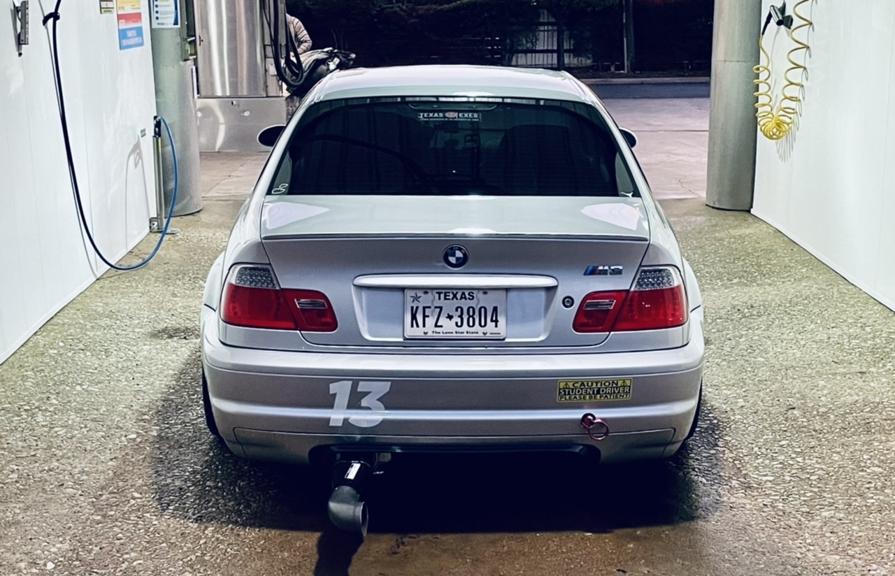

              Washed

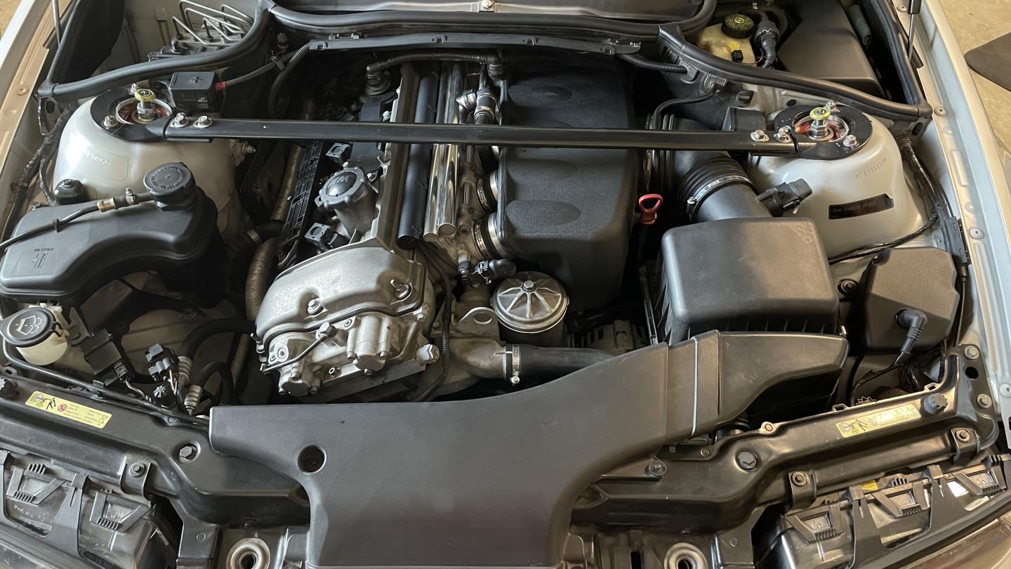

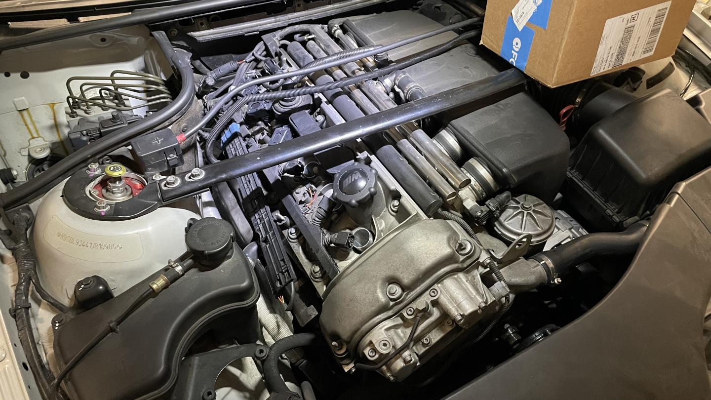

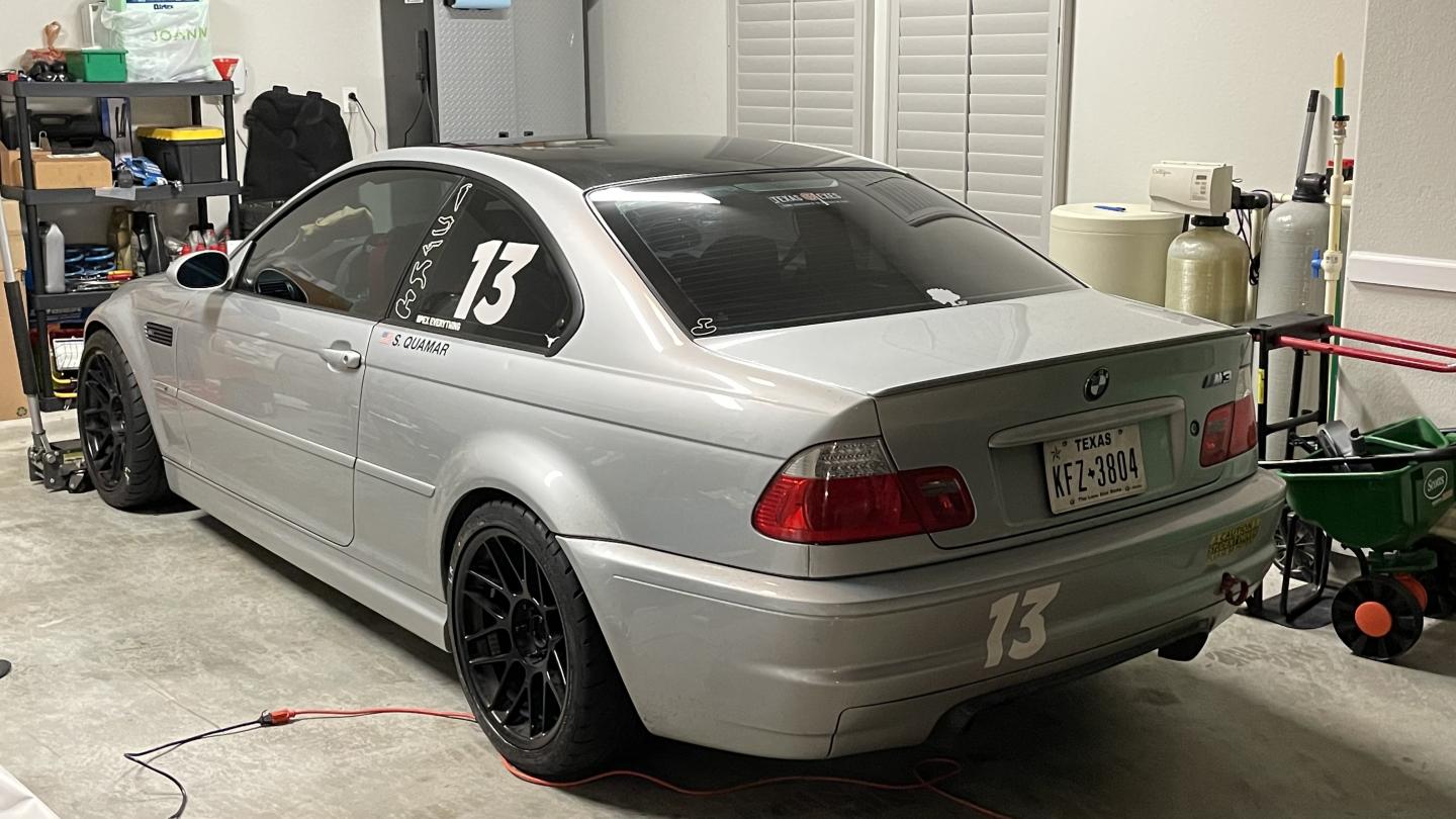

              Replaced the coils, wrapped the roof black, and cleaned the engine bay. I would like to get a Karbonius CF roof, but that’s a project that I’ll take on much later.

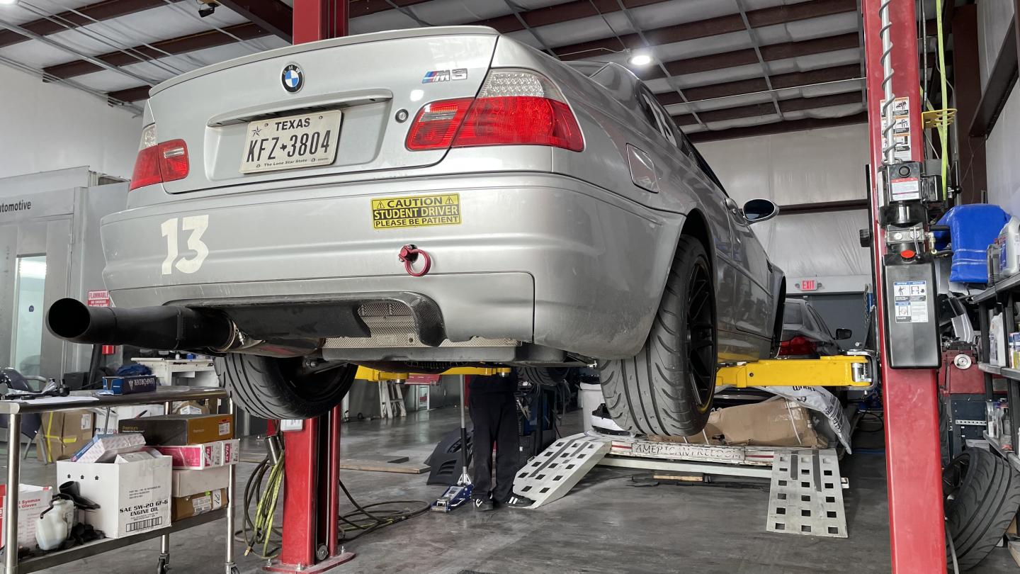

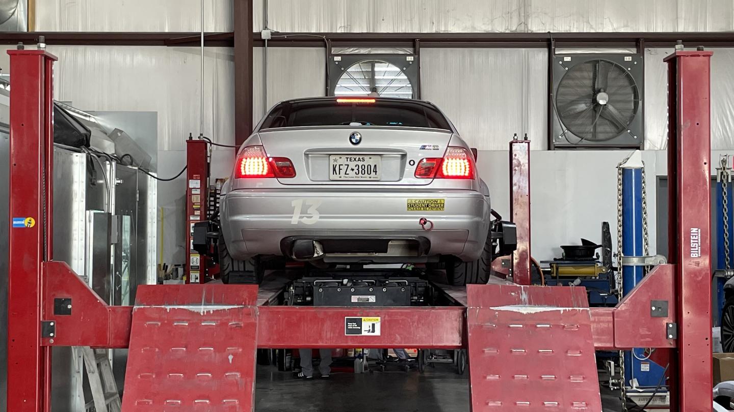

                Outer tie rods replaced, then aligned

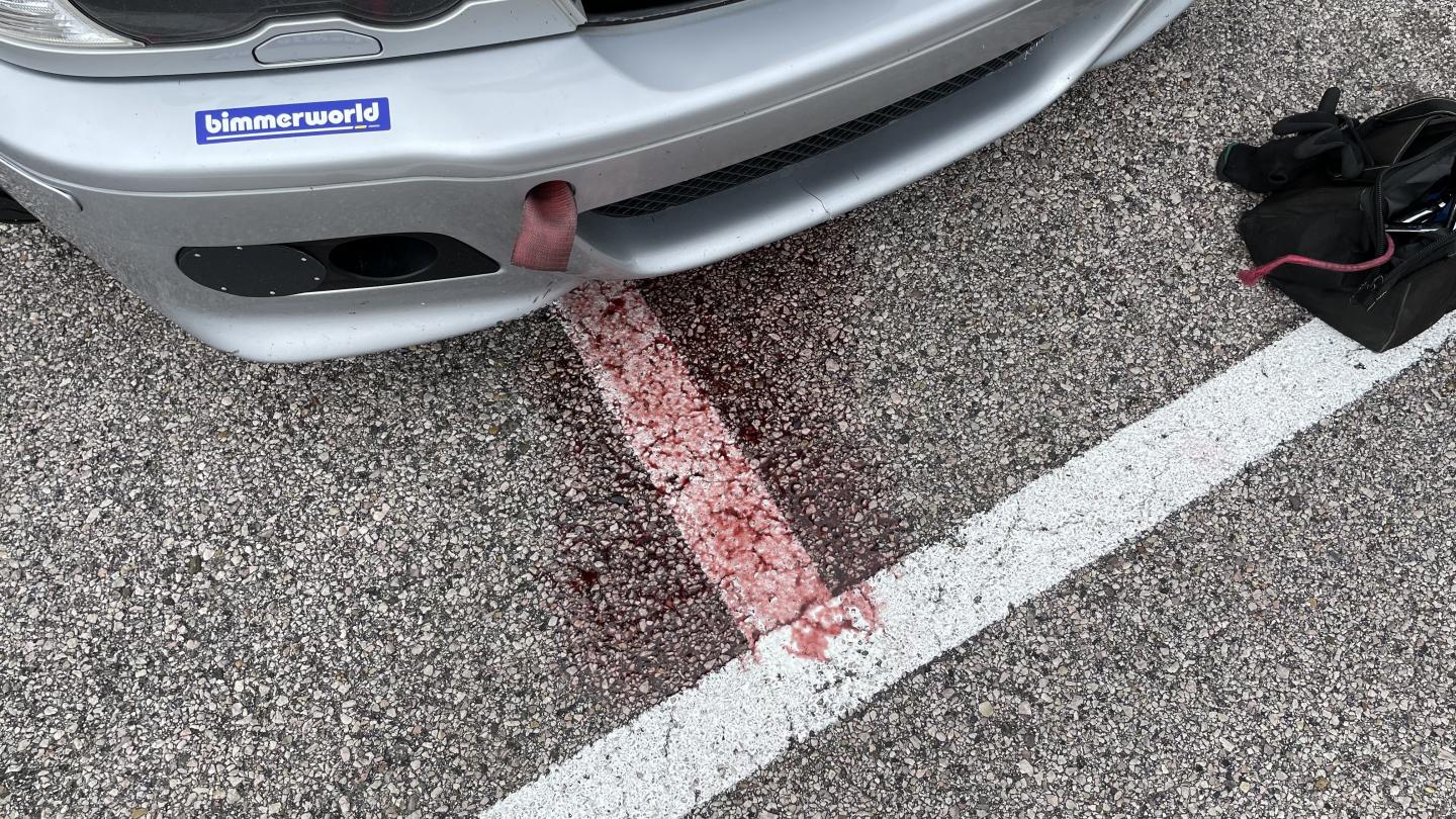

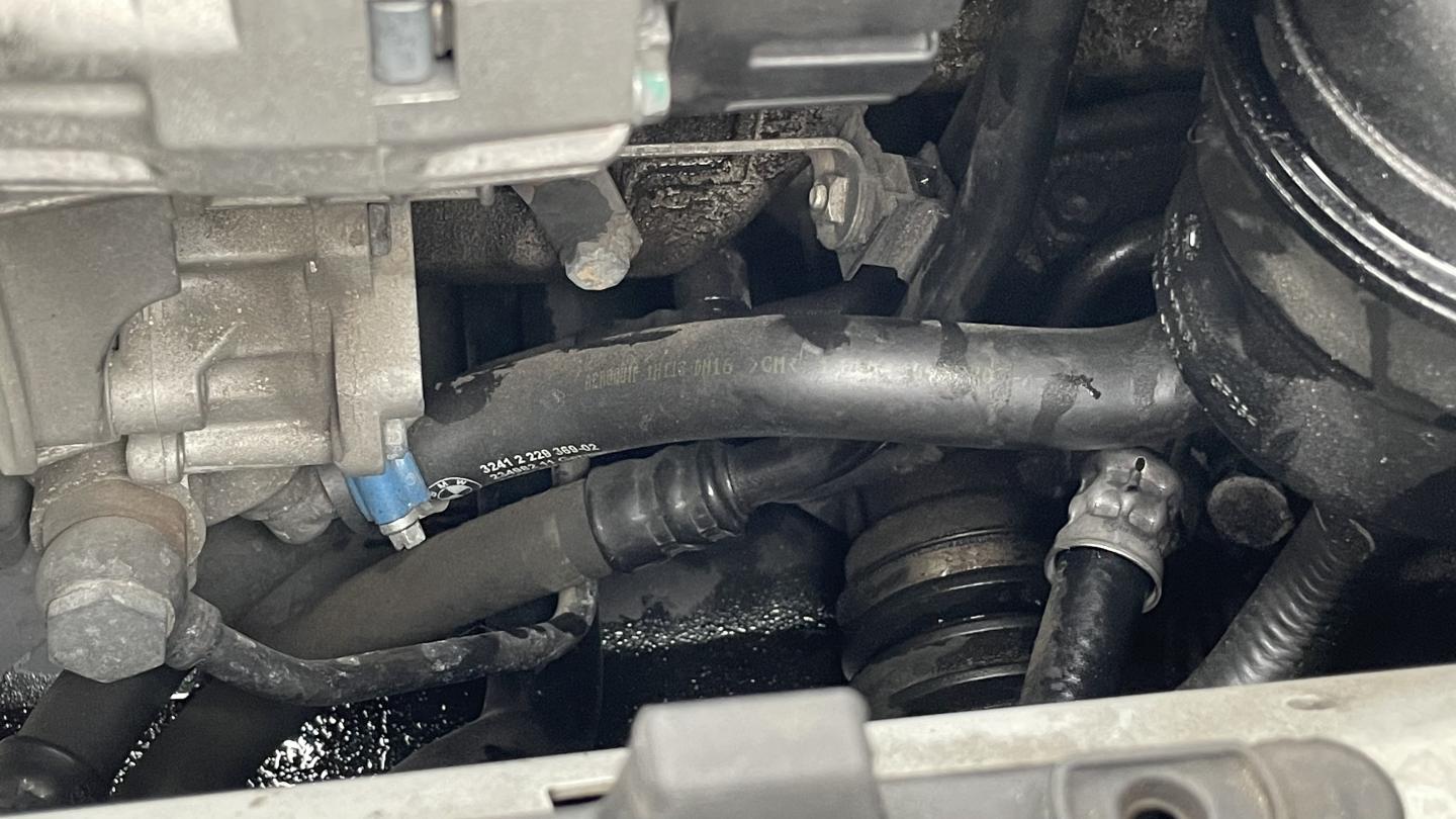

                Another trip to COTA with WRL. During the first or second session, I lost power steering. One of the hoses that hooks up to the reservoir was over tightened, causing the clamp to dig in to the hose and eventually cut thru. Totally my fault. I removed the partially decapitated top 1 cm portion and installed the remaining line to the reservoir. Worked well.

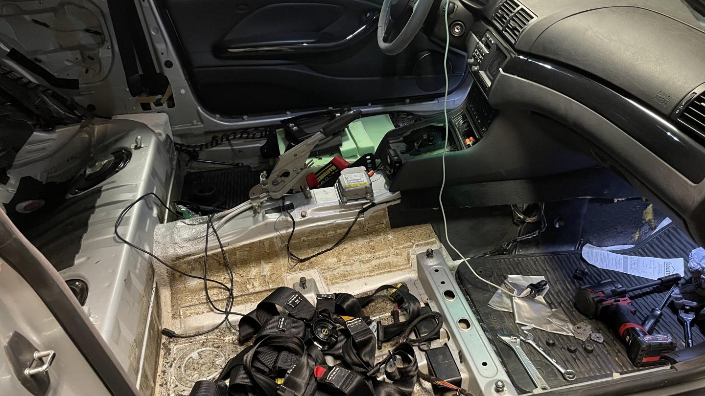

                  Drove the car again after it sat in the garage for a while. I forgot my earplugs, and within five mins I hated driving it thanks to the loud exhaust, trans noise, and squealing brakes. Total drive time that day was 25-30 mins, and when I got back, I started to take parts off the car, as I had finally lost all interest in keeping it as a dedicated track car. For a while I had been wondering what to do with the car since I stopped tracking it often (maybe once a year now that I was doing endurance races).
                  In the end, I decided I would keep the car and turn it back into a street car. It won’t be a quiet, super comfy car like the blue car – will have louder exhaust, stiffer springs, monoball suspension components, more aggressive camber setup.

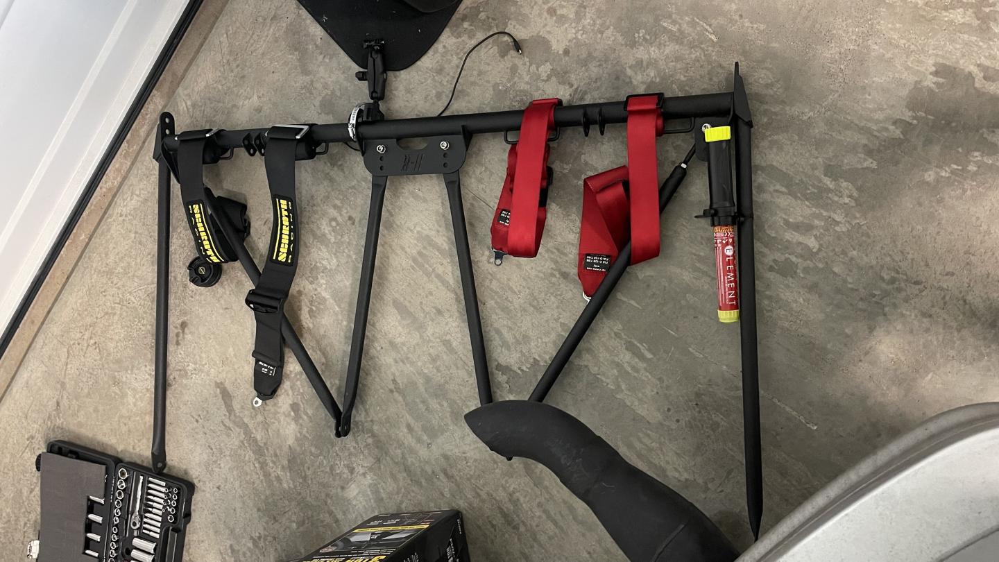

                  Stripping the car of parts I don’t want

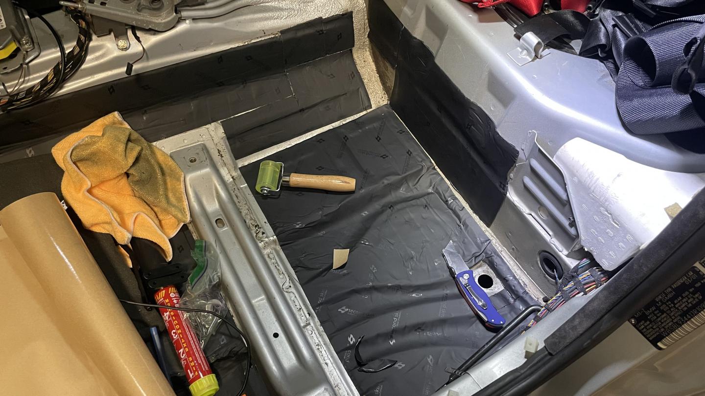

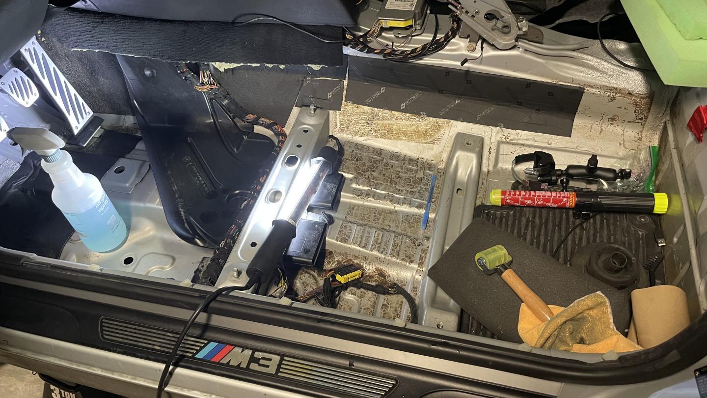

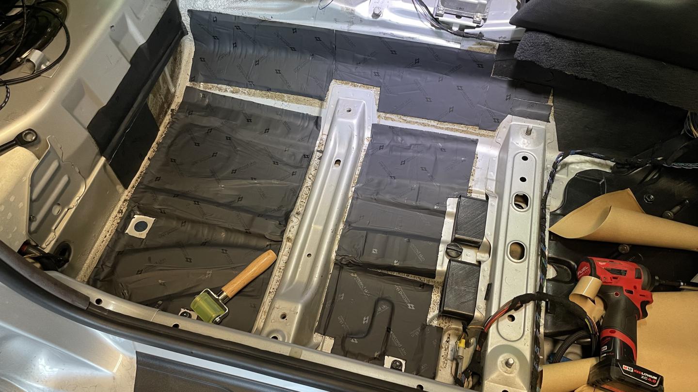

                            Installed Damplifier Pro sound deadening on the floor and trans tunnel. I used a lot less than I expected. Initially thought I needed 20 sq ft, but I only used 10 sq ft. Added seven pounds to the car..not bad.

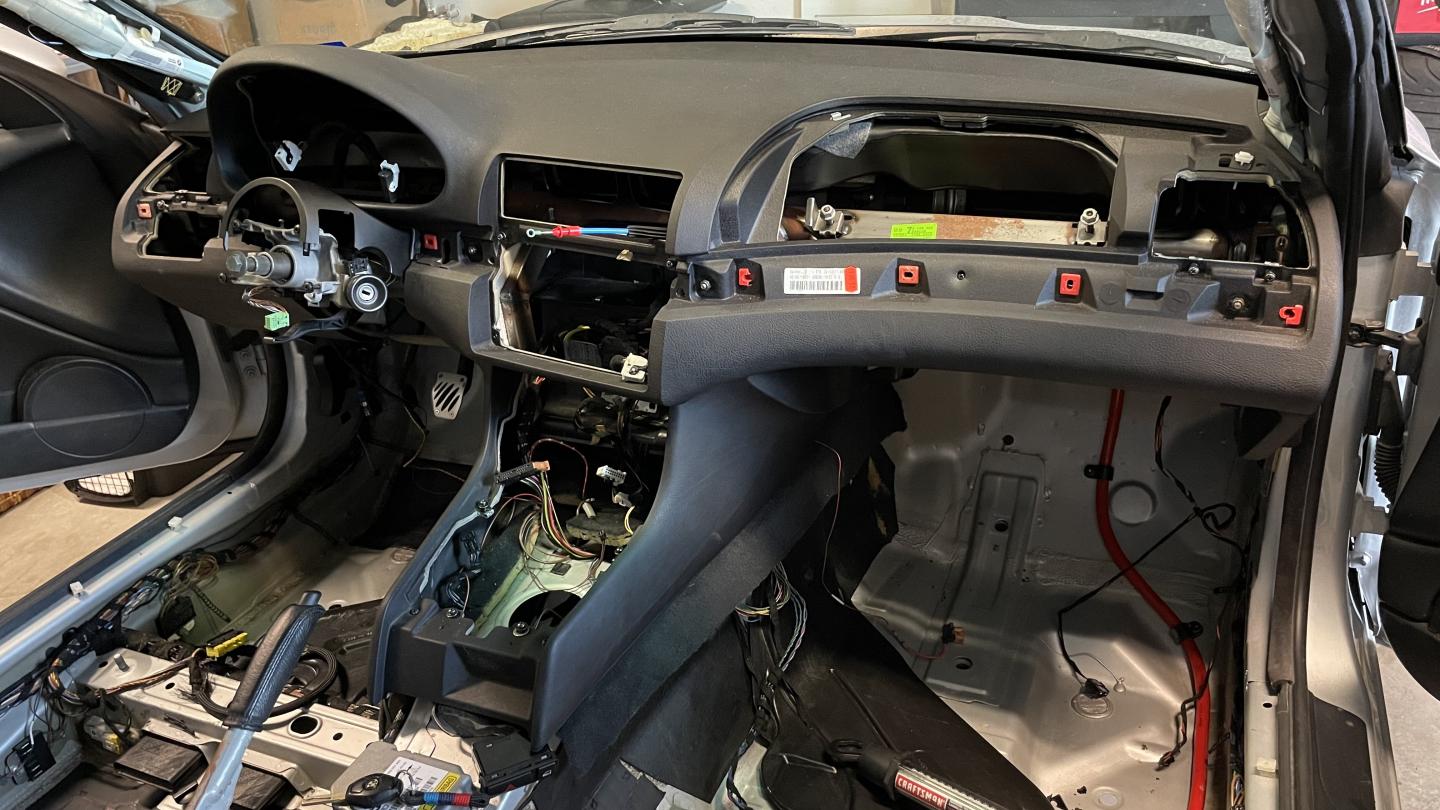

                            Then I removed the rest of the things needed to allow for dash removal – glovebox, foot well panel, steering column parts, and instrument cluster. Just a few nuts and screws, and the dash will pop off. Interestingly, the footwell panel and glovebox had cracks around a few of the screw holes. Maybe I overtightened the screws when installing the footwell panel, but I’ve never done anything with the glovebox so idk? Maybe tracking the car put stress on the plastic? Will order new pieces from FCP.
                            Click image for larger version

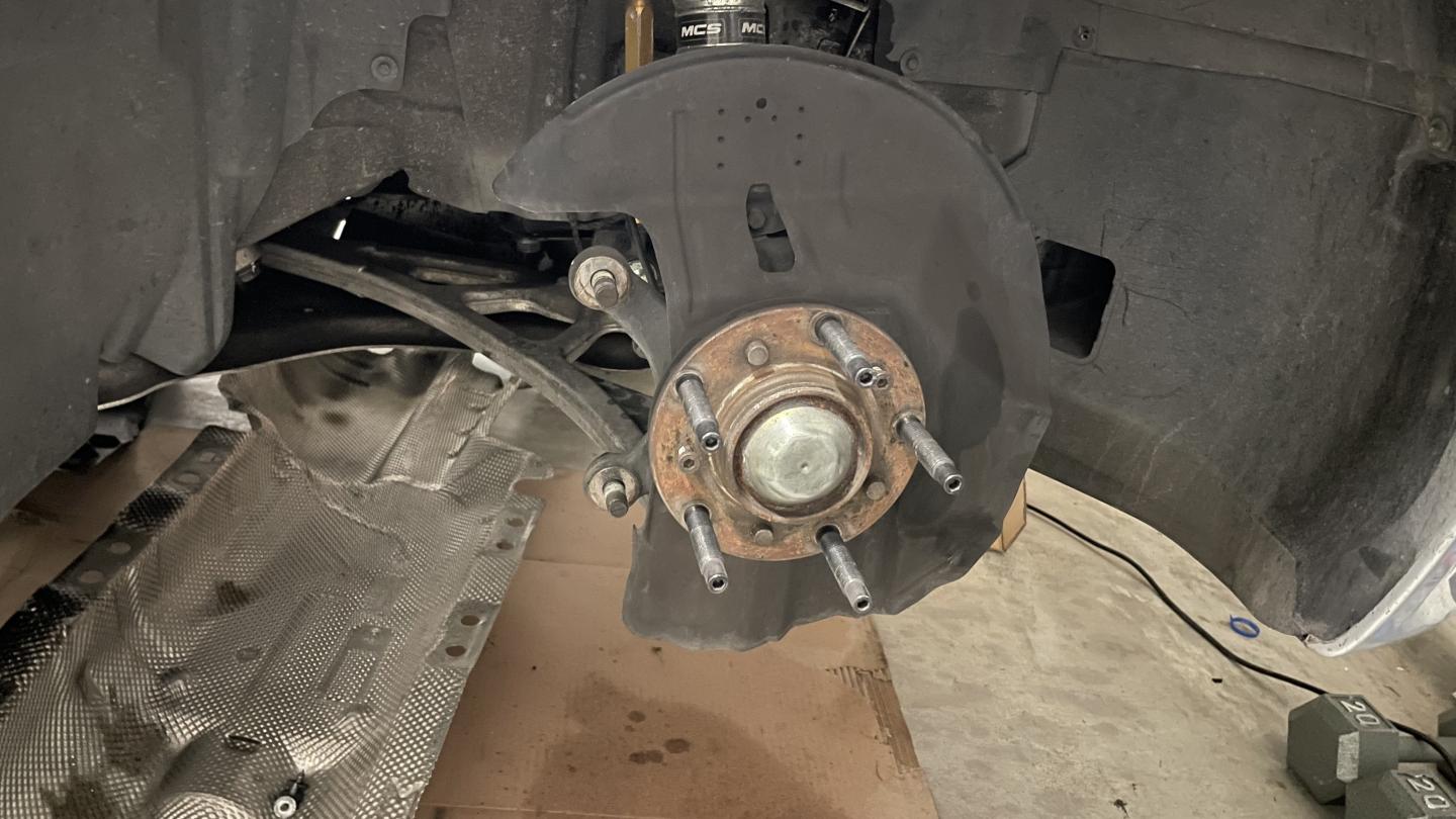

                            Pulled the rear rotors and listed the stock brake stuff for sale. I previously left the rear Porsche calipers grey bc I was too lazy to paint them, but I will attempt to paint them yellow soon.
