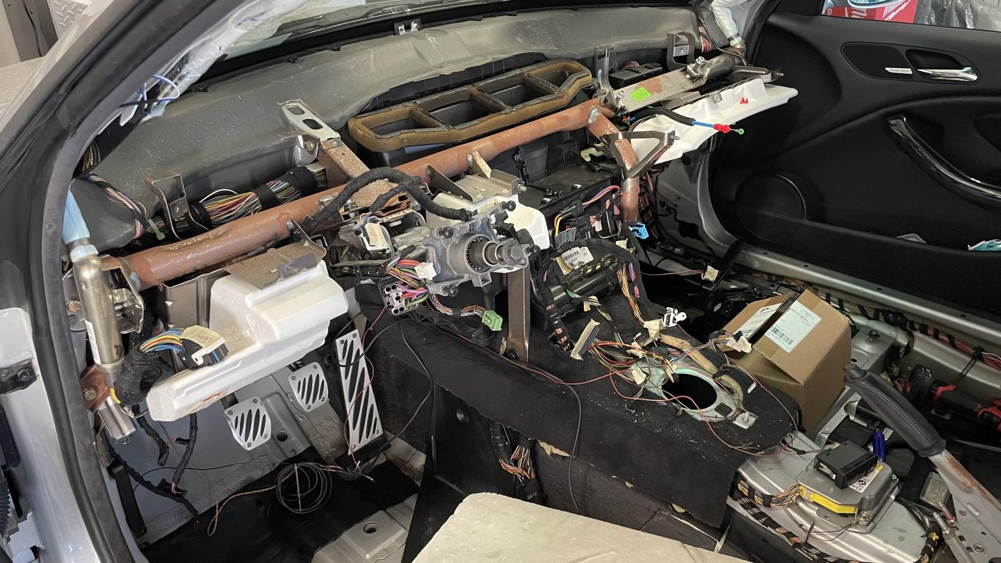

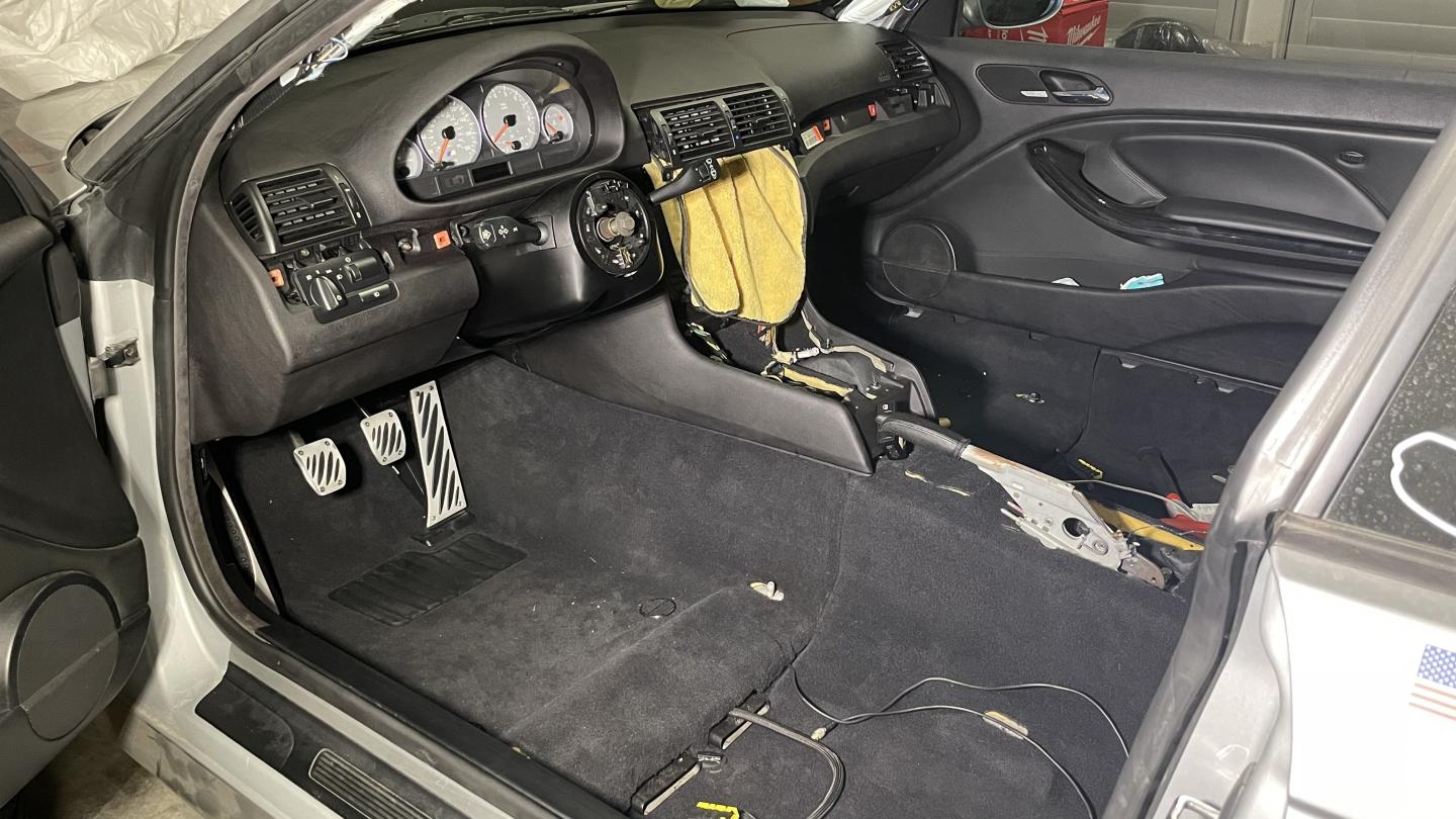

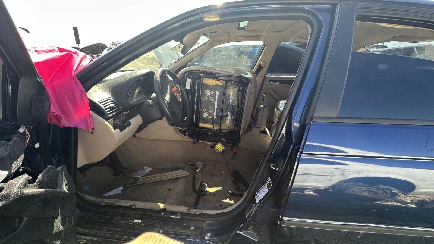

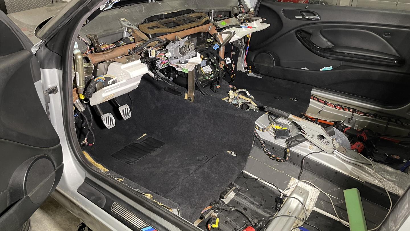

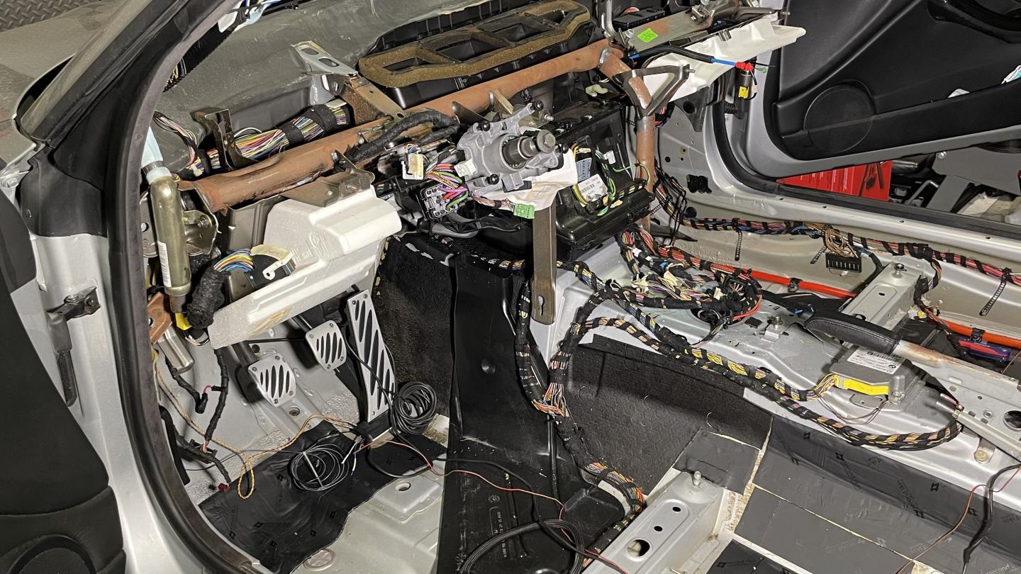

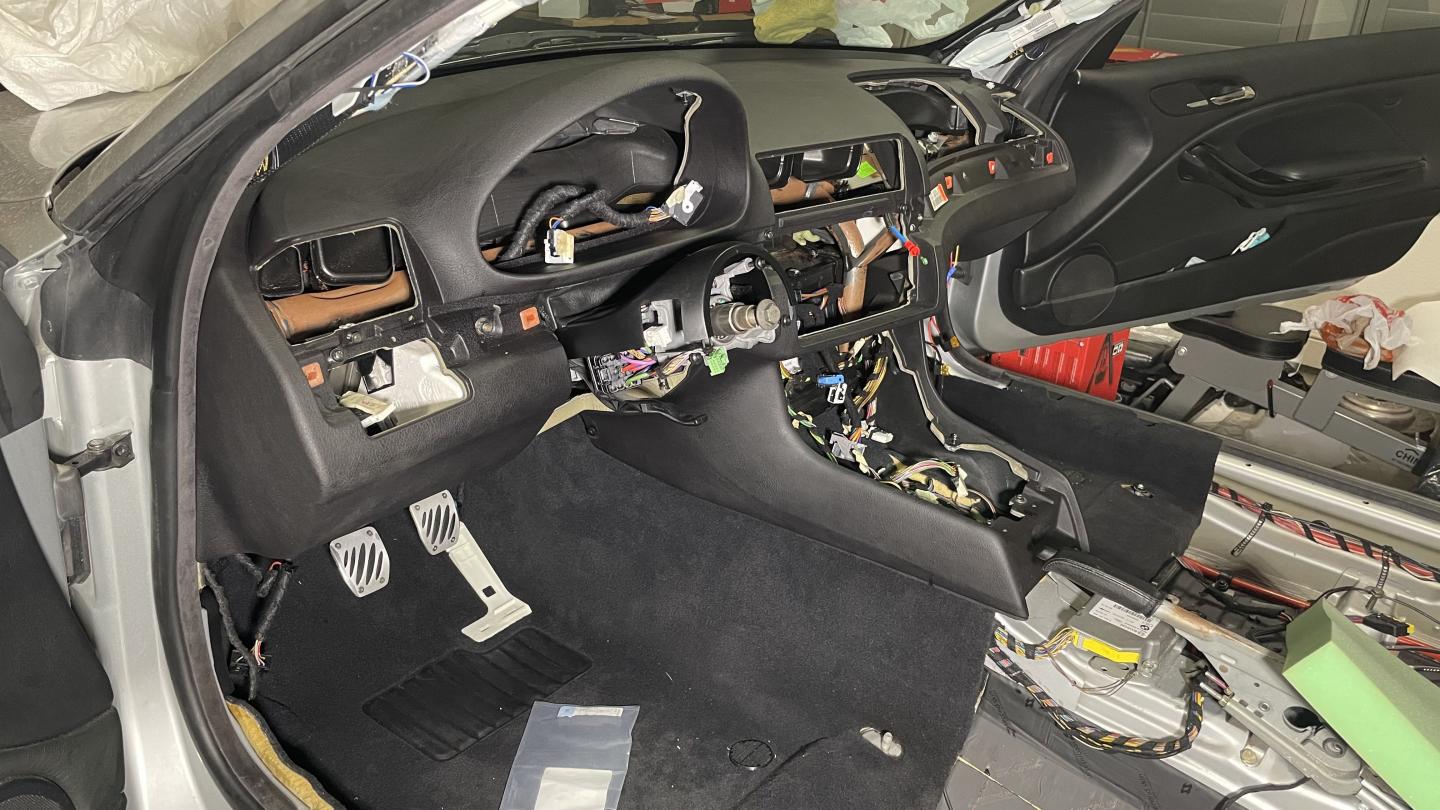

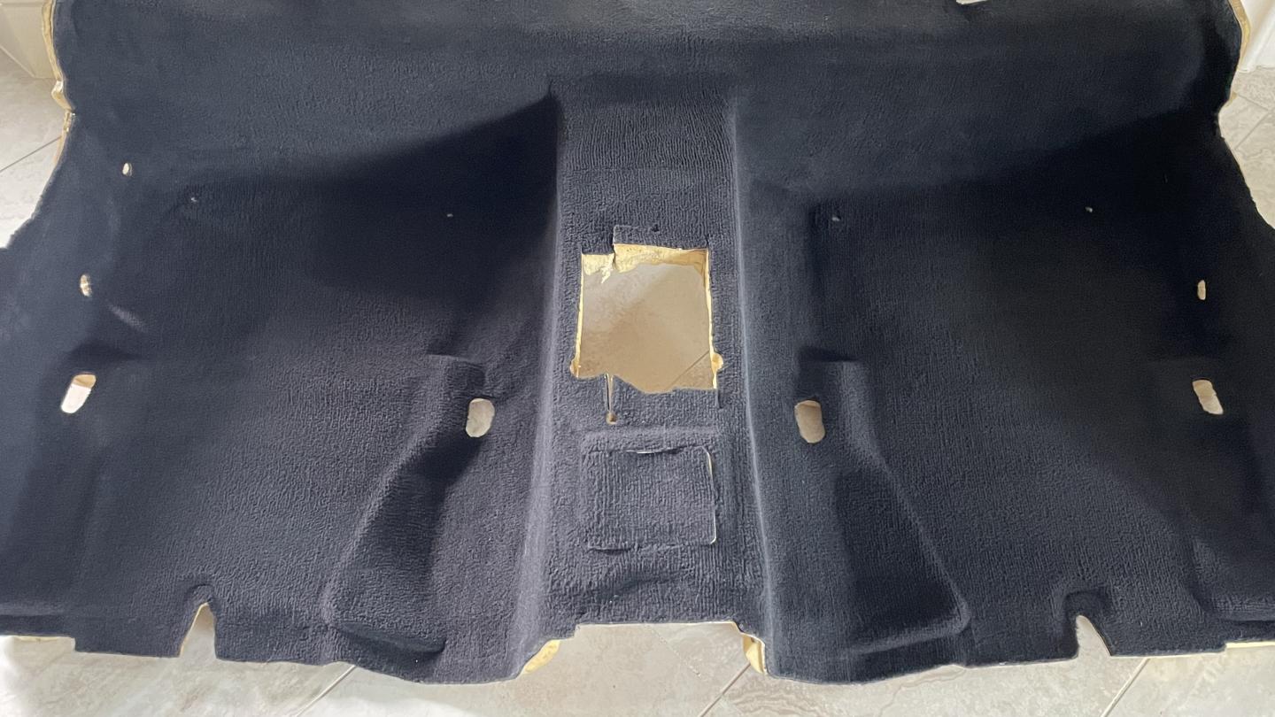

    Cleaned the replacement carpet and pulled the dash. This is why I decided to turn this car into a track car after the flooding, but here I am, exactly five years later, doing exactly what I wanted to avoid doing lol.

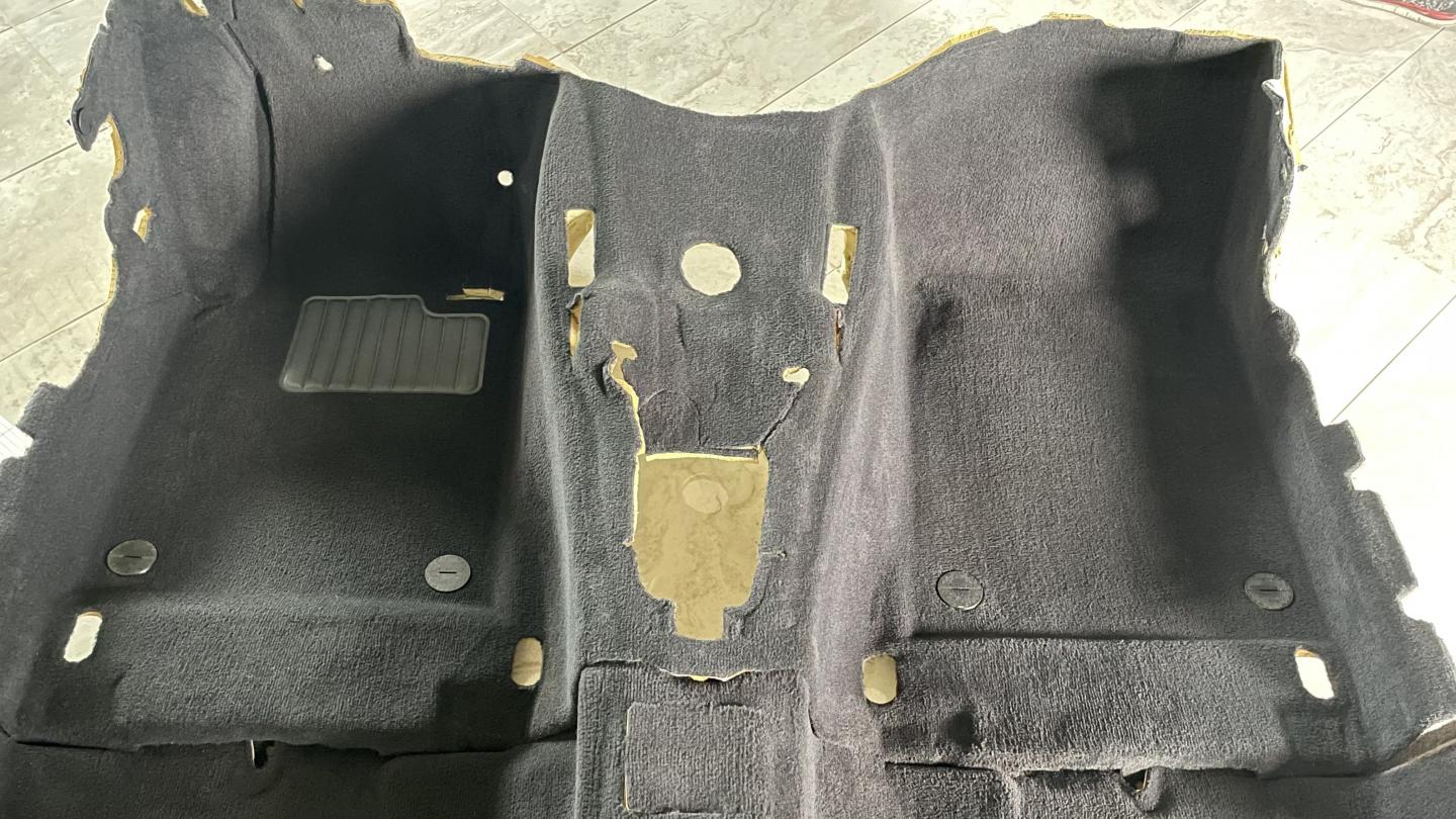

    Remaining original carpet pulled out.

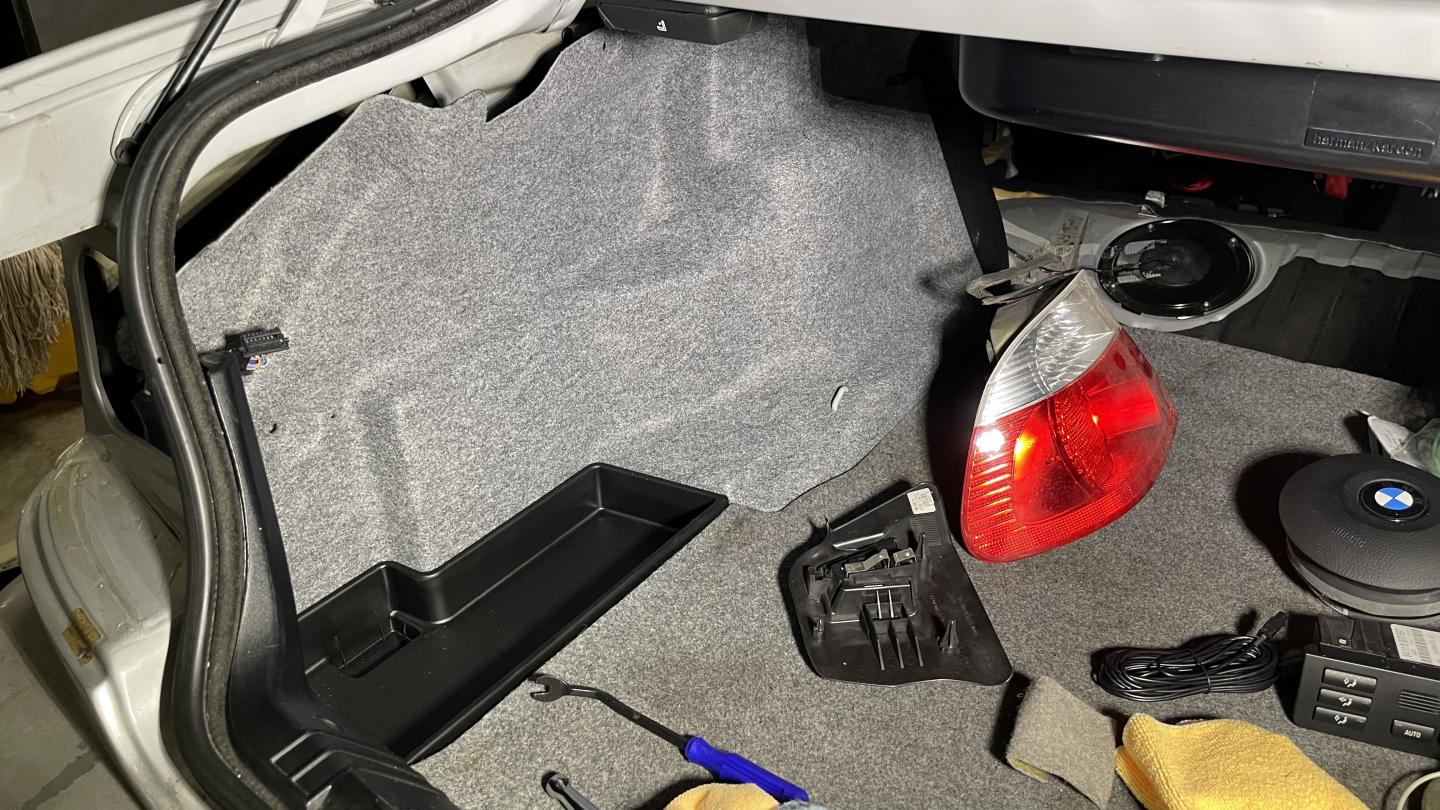

      I made some space in the trunk by removing all of the nav and audio stuff on the left side, minus the amp.

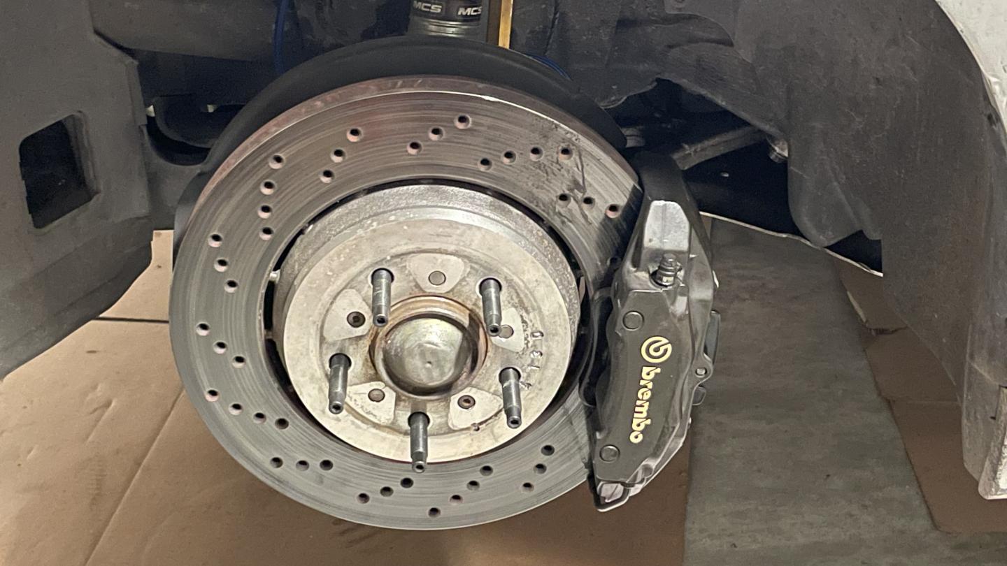

      996 brakes installed in the front and rear. Black looks good, but I think I’d prefer more pop with yellow painted calipers.

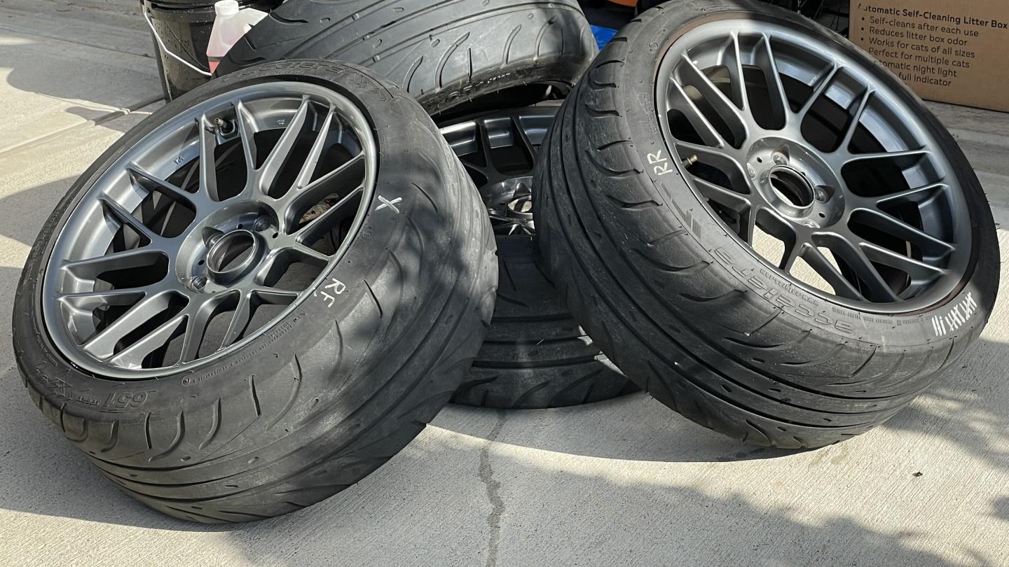

        Cleaned and ceramic coated the wheels, then I lowered the car. The car seemed to run fine except for a loud grinding noise coming from the rear. I found that the left brake shield was grinding against the rotor hat. Fixed that pretty quickly and no issues afterwards.

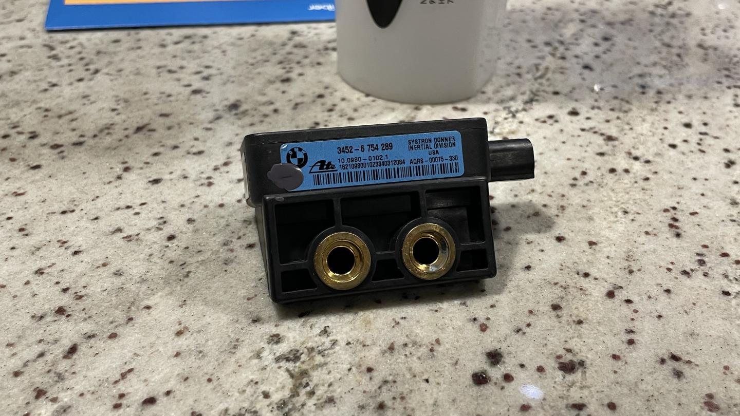

        New yaw rate sensor installed. No issues since then.

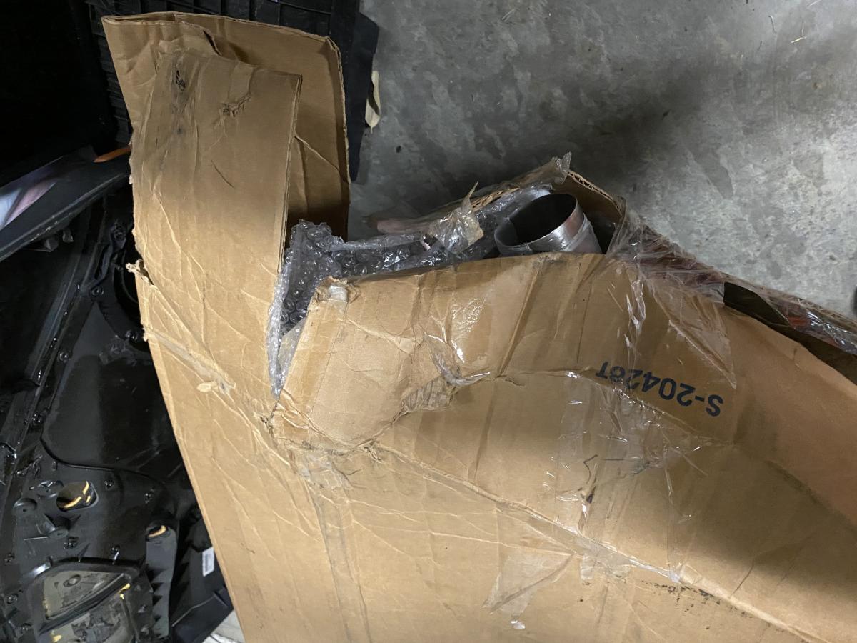

          The Supersprint parts from the group buy finally arrived. Three out of the four sections were damaged due to poor packing.

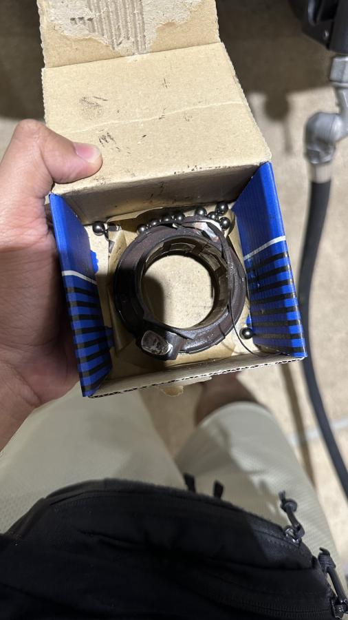

          The throwout bearing was fucked. Clutch still looks good, but I had all internal wear parts (aside from the flywheel) and 24k mile old giubo replaced anyways. The rear main seal was replaced preventively. The diff input shaft seal was leaking, so I had that replaced as well.
          Click image for larger version  Name:	B41C1B33-4CAA-46DE-8E3C-34F3C868B5EF.jpg Views:	0 Size:	55.3 KB ID:	198542

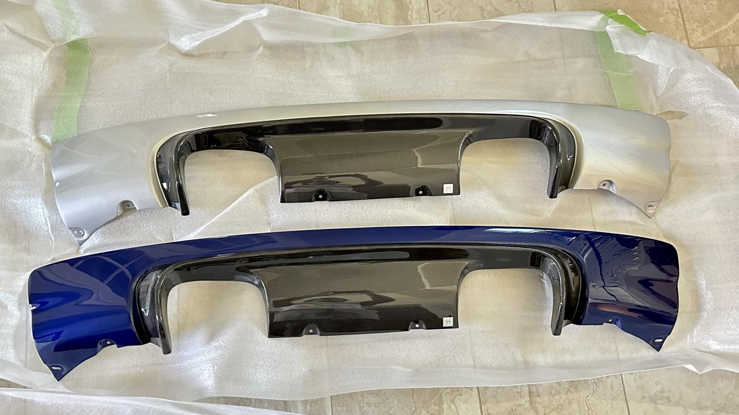

          The diffusers also arrived. They’re not perfect..I’d say maybe 8/10 is a fair rating. They fit well tho and look better than my old happybuyitnow diffuser.
          Click image for larger version  Name:	77E04103-4E90-4078-94E3-468F10B84D94.jpg Views:	0 Size:	166.8 KB ID:	198539 Click image for larger version  Name:	1FCB0BC9-7101-4475-AF7C-47C7807E7C55.jpg Views:	0 Size:	140.0 KB ID:	198537

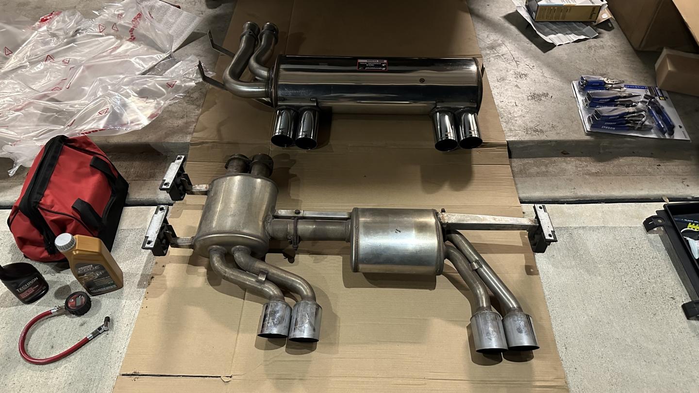

            #35
            Dec 2022

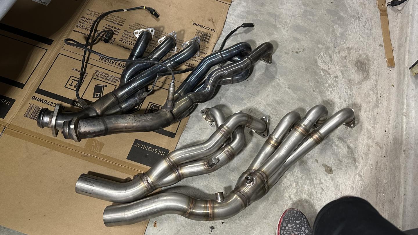

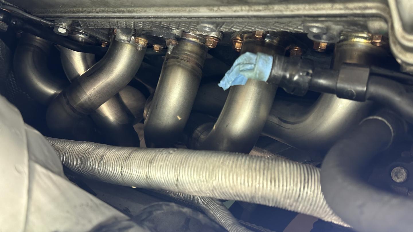

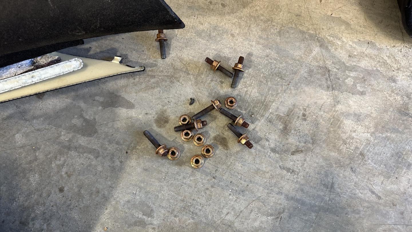

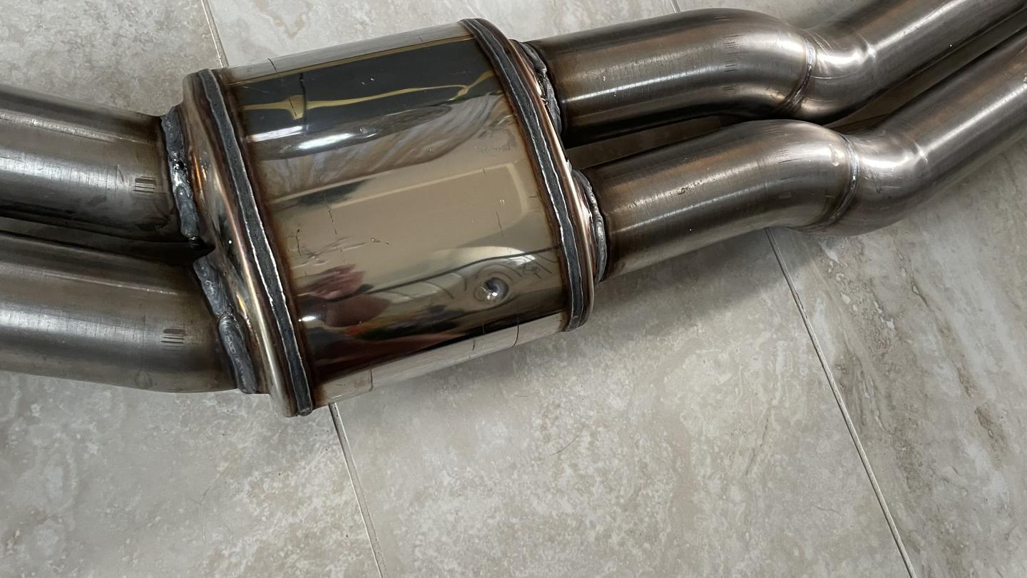

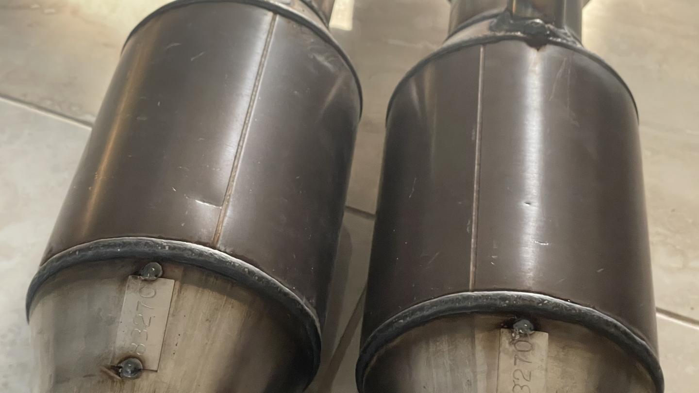

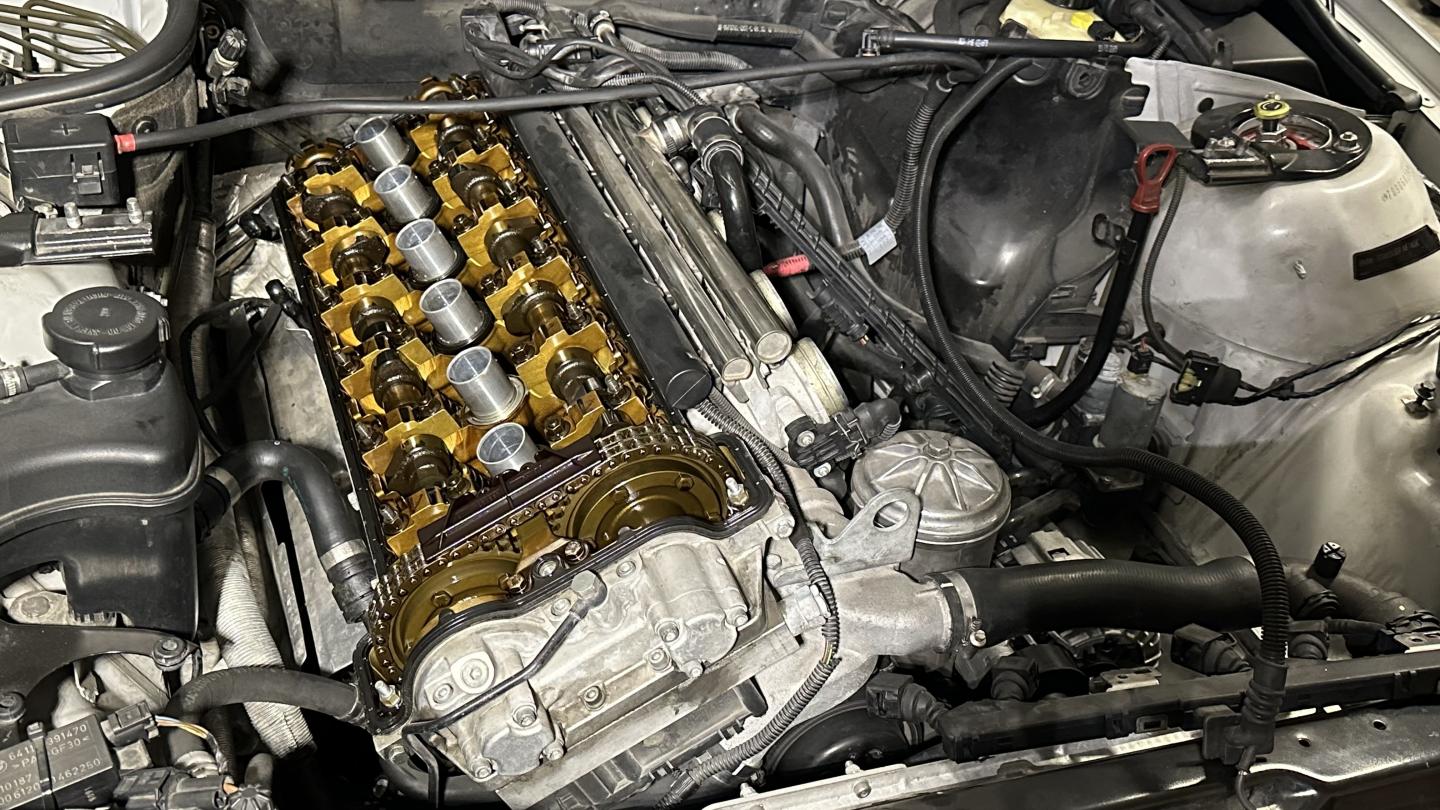

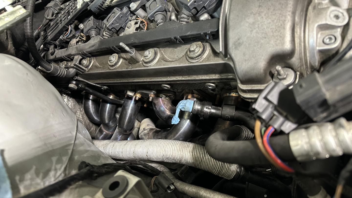

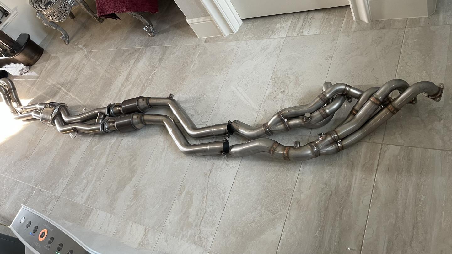

            Last week I finally installed the Supersprint parts. This is my fourth and final header install on this car lol. Went from stock to AP to Euro to CPI to SSV1. The install was really easy..having the right tools helps a lot. I also removed the BW GroupN motor mounts and replaced them with OE mounts, and installed a new slave cylinder bc the old one was leaking. I spent a few hours over four days to install everything. The exhaust is rattling under the passenger floor, so I’m going to try using a plate to link the two sec 1 pieces at the header connection, as suggested by a member on here.
            CPI headers
            Click image for larger version  Name:	A973BA70-7580-4335-A23A-32C84A1D34F0.jpg Views:	0 Size:	163.3 KB ID:	198549

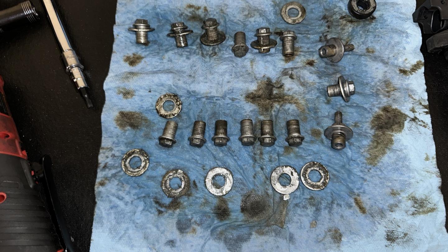

            Thankfully some of the long studs came out with the nuts.
            Click image for larger version  Name:	8B561A8C-AD5A-4BD0-BBE0-31E725DF5E57.jpg Views:	0 Size:	233.2 KB ID:	198558
            Click image for larger version  Name:	E04E29FB-327A-4741-A268-C6DA28B21F97.jpg Views:	0 Size:	199.2 KB ID:	198556
            Click image for larger version  Name:	7495ABC4-6CB5-4B7F-B76E-778D3043DAFB.jpg Views:	0 Size:	205.1 KB ID:	198557
            Stock studs and SSV1 headers installed
            Click image for larger version  Name:	AF28CDB1-1C13-40FD-AF8F-BA7C8FEB4550.jpg Views:	0 Size:	118.1 KB ID:	198555

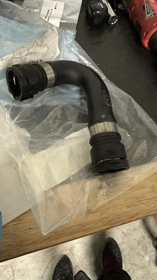

            Leaking coolant hose had to be replaced
            Click image for larger version  Name:	52E2DDC9-7F1A-4E29-AD75-09712158F3BB.jpg Views:	0 Size:	59.3 KB ID:	198551

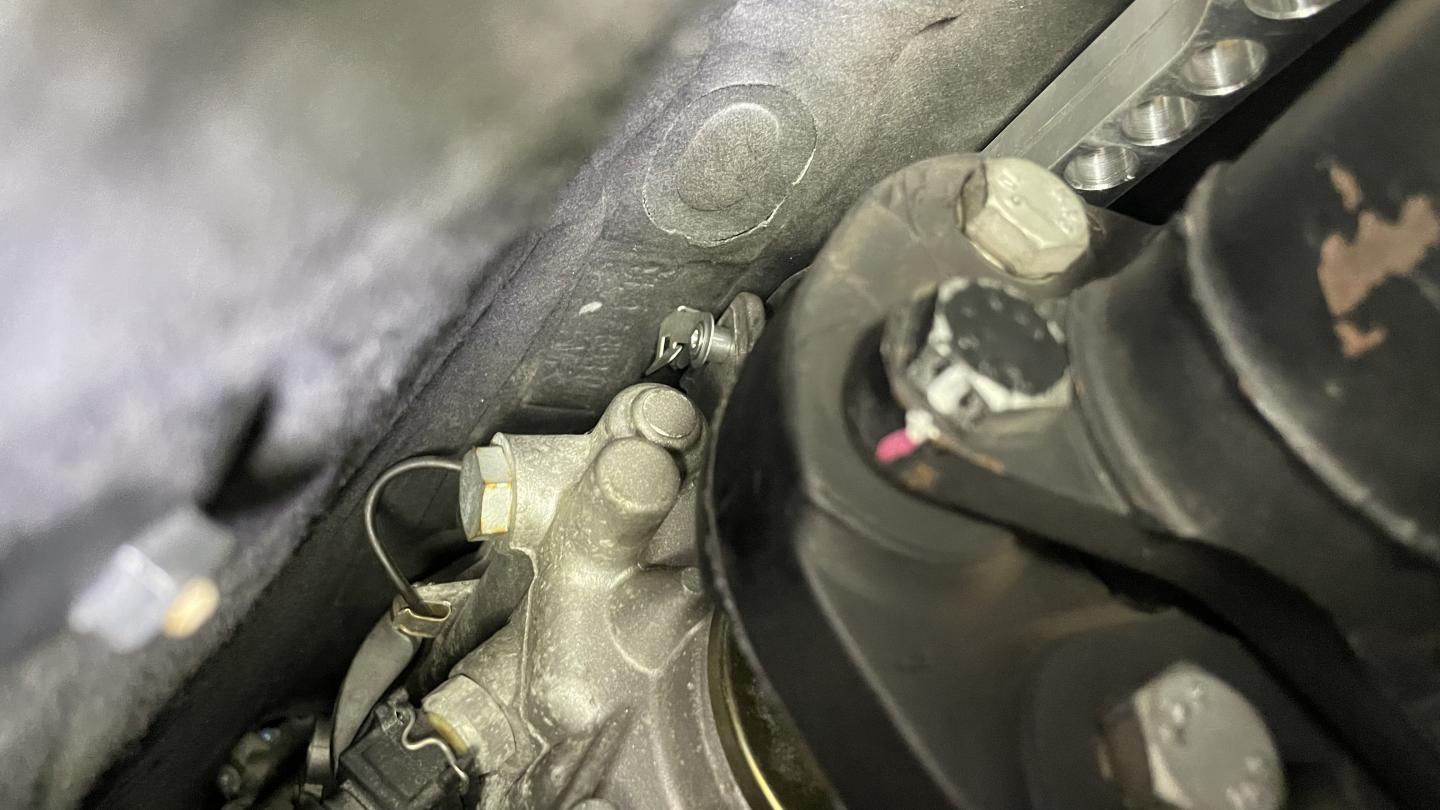

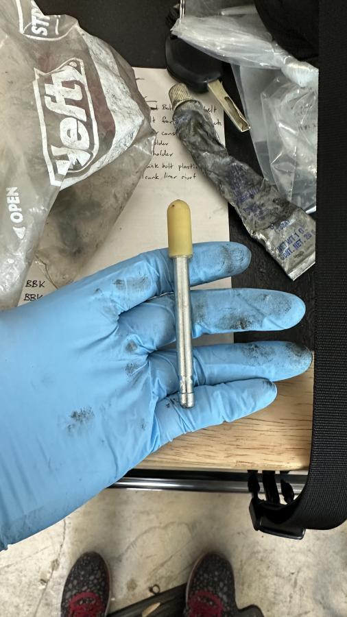

            While I was installing the slave cylinder, it went in way too easily, so I pulled it out to try again. Well….the rod came out and I heard it roll to the bottom of the very front, deep part of the bellhousing. I went to Lowe’s to finally pick up some tools I’d been too lazy to buy, including a flexible magnetic pick up tool. Thankfully I was able to grab the rod on the second try.
            Click image for larger version  Name:	C251A2AE-C71C-43CE-9682-3CB3938B59FD.jpg Views:	0 Size:	70.8 KB ID:	198553
            Done
            Click image for larger version  Name:	E5EFD453-2BCE-45F9-9E16-B80C0F10ABAA.jpg Views:	0 Size:	157.8 KB ID:	198554 Click image for larger version  Name:	62AC7CCC-1A01-4B1A-978D-A705F275FC15.jpg Views:	0 Size:	81.6 KB ID:	198550

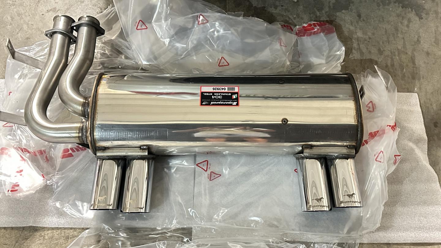

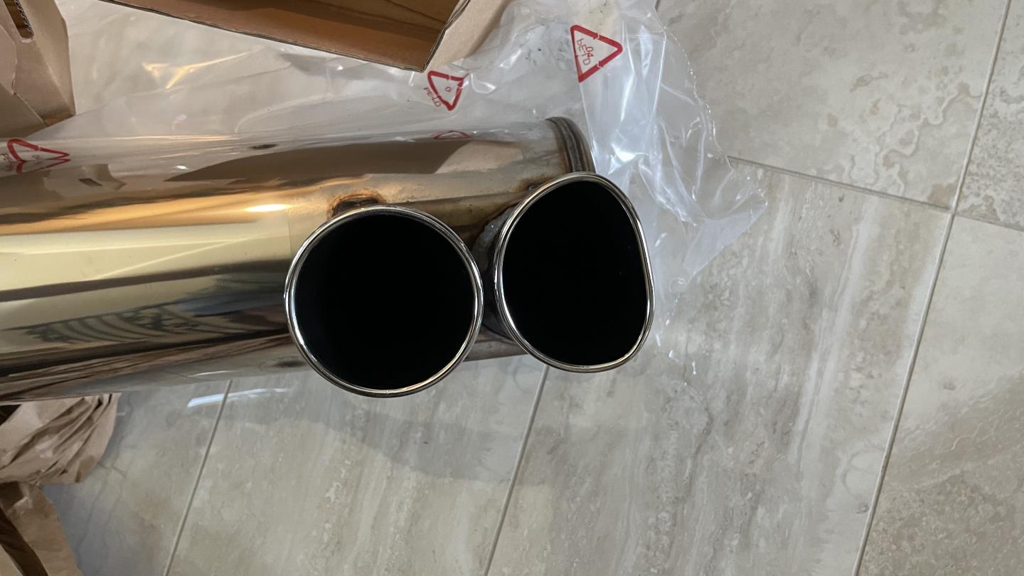

                SS Sport muffler finally arrived from the painful group buy. The exhaust is quieter and produces less drone than the SS Race, which is what I was going for.

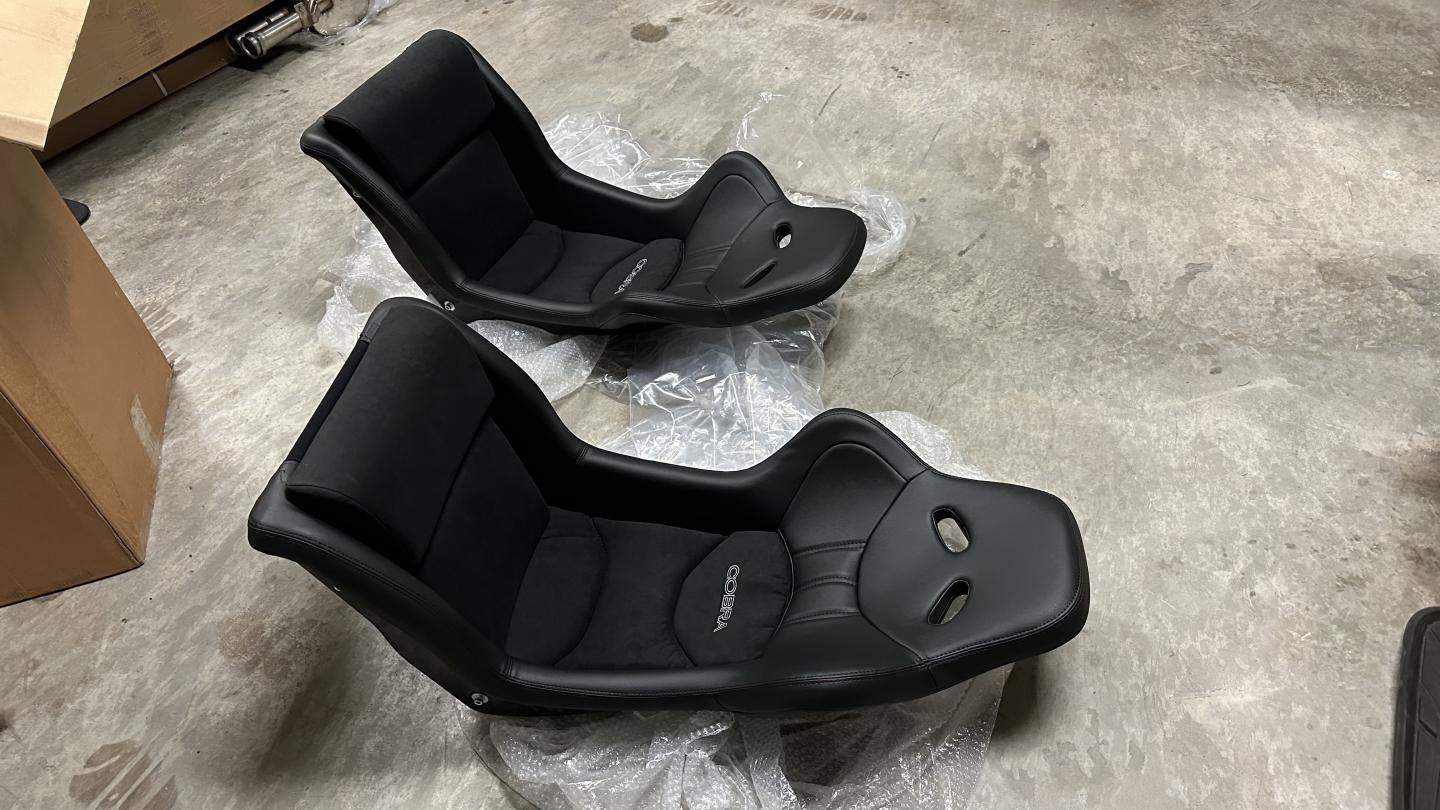

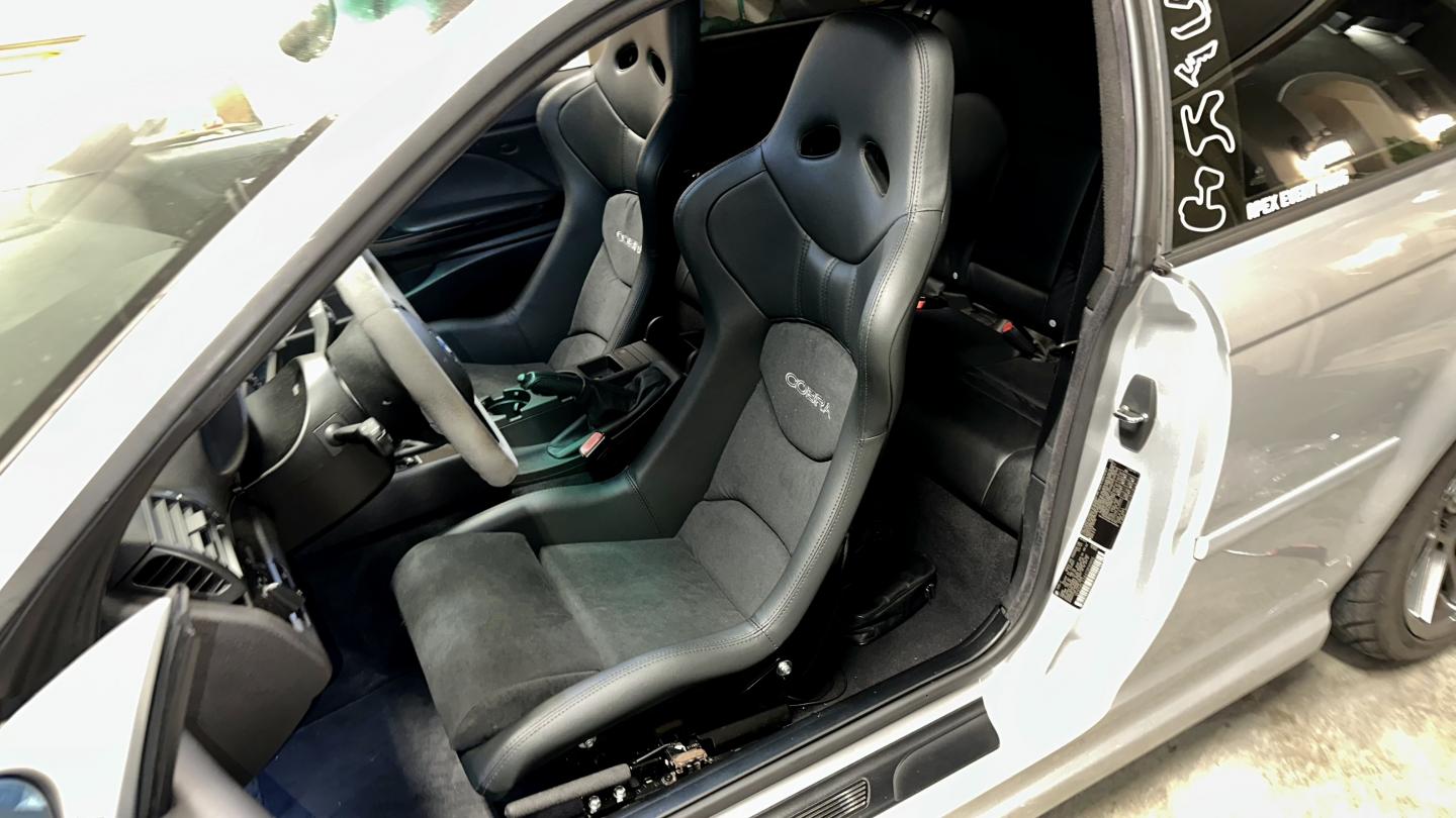

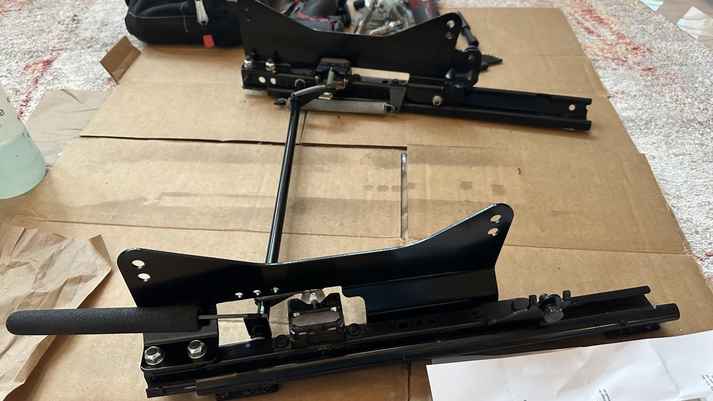

                  I really needed better seats, so I started searching for a good deal on Nogaros. I found a vendor in the UK that had a sale on Nogaros with black vinyl outers, dinamica center cushions, and black stitching. After shipping and the import fee, it cost me around $1800. I was able to snag a set of manual seat rails at the junkyard for $30.

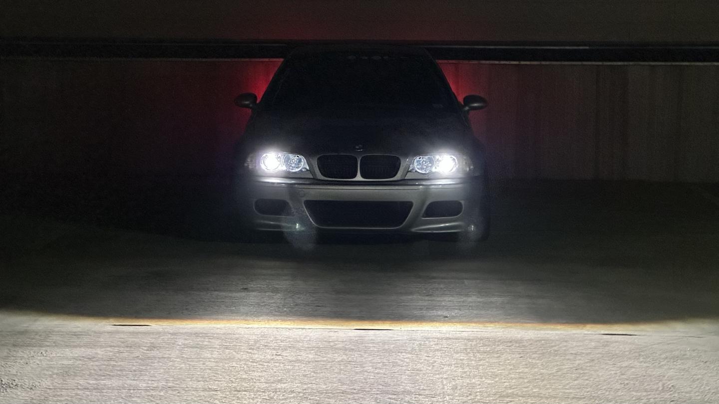

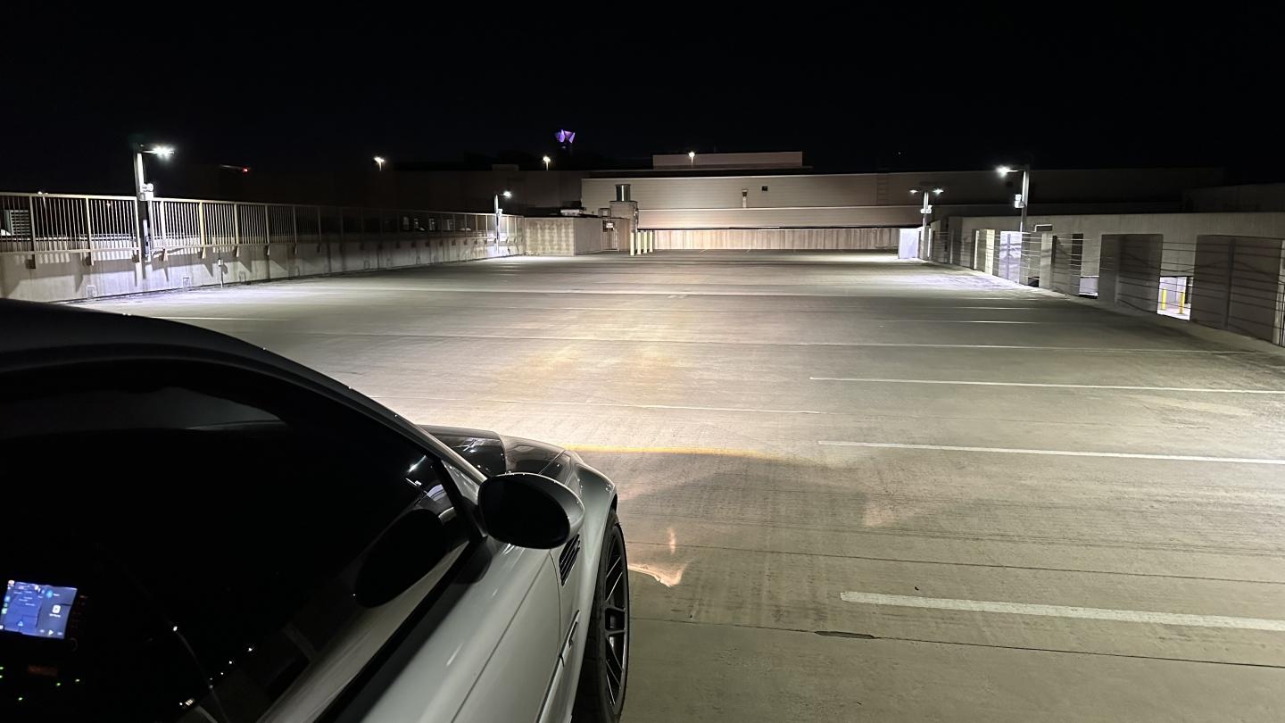

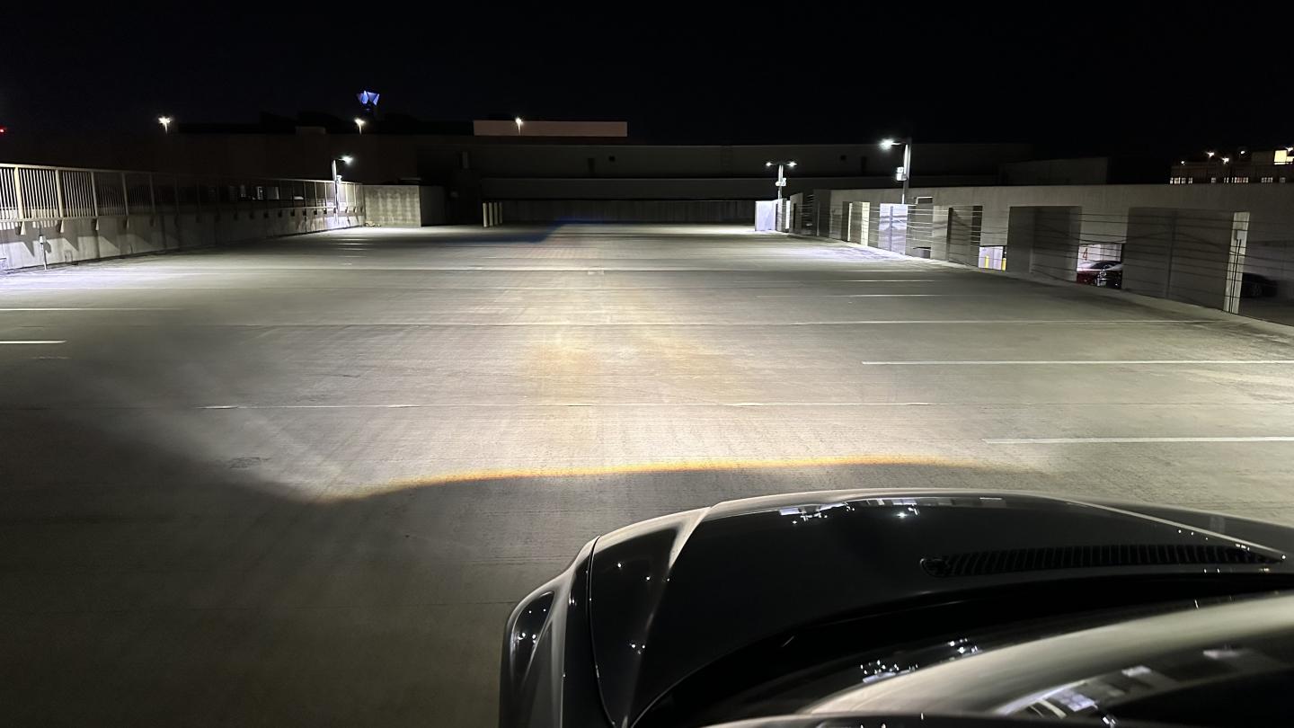

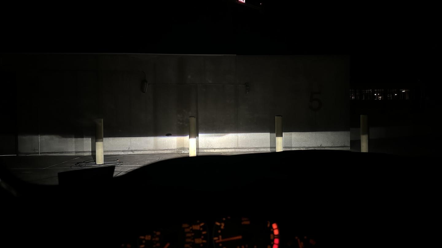

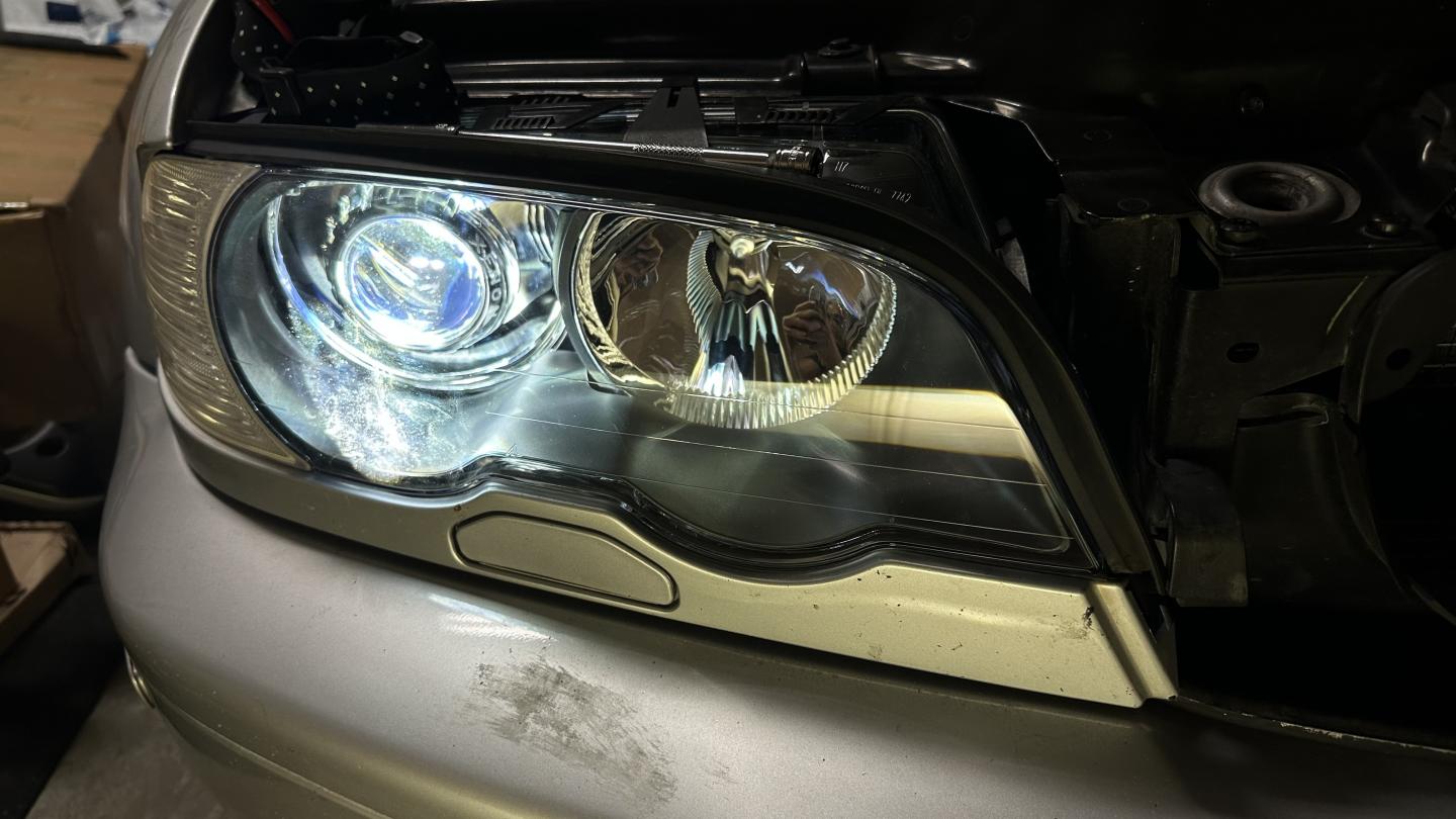

                  After learning that there’s a bi-xenon upgrade for 01 cars with single xenon 2.5” projectors, I reached out to Lightwerkz to order the parts needed for the upgrade, which only cost me $360. If I could go back, I would pay the few hundred dollars in labor charges to have them install the parts. Amazing upgrade, 10/10 would recommend. Linked below is a write up I shared.
                  My silver car’s OE projectors were shit, and I was under the impression that there weren’t good upgrade options for the 2.5” single xenon lights. Replacing the bulbs with Osram Nightbreakers didn’t help. A few months ago, a member on here informed me that Lightwerkz had upgraded a single xenon car with Bosch Mini projectors

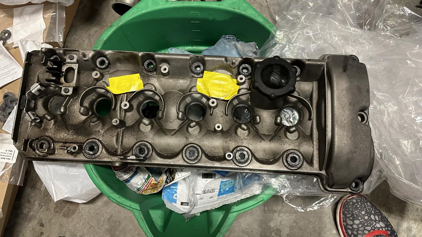

                              #44
                              March 2023

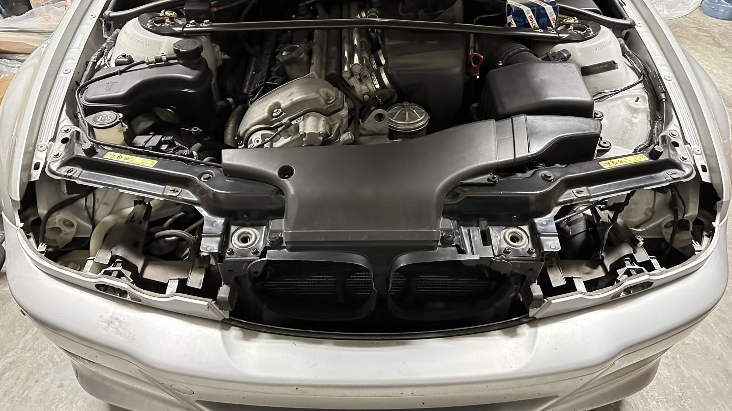

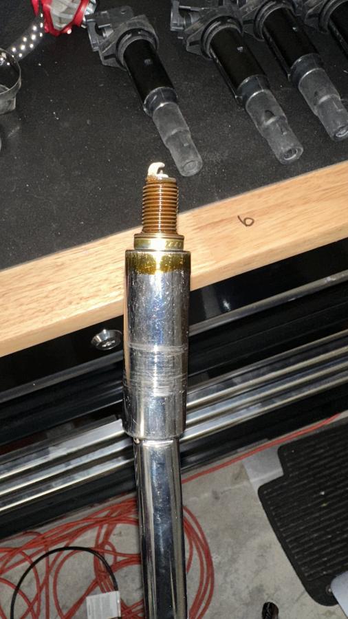

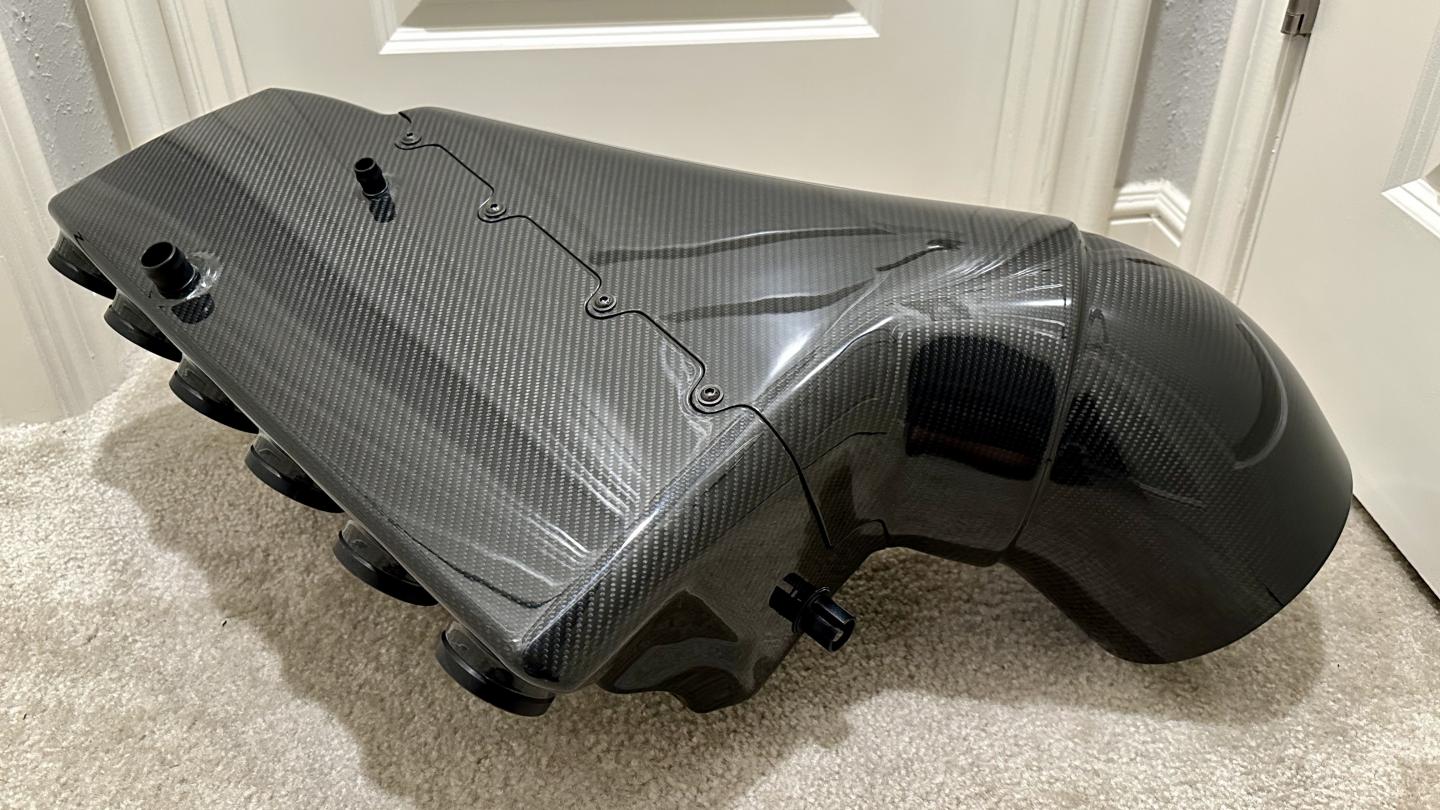

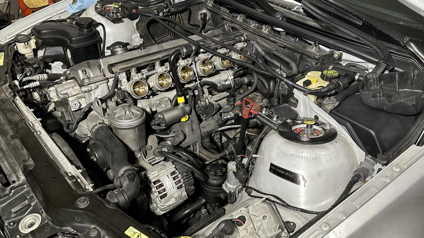

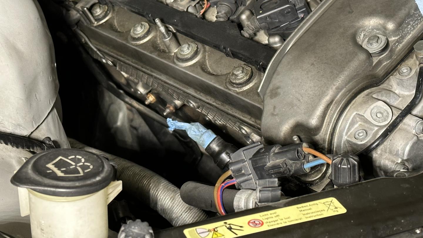

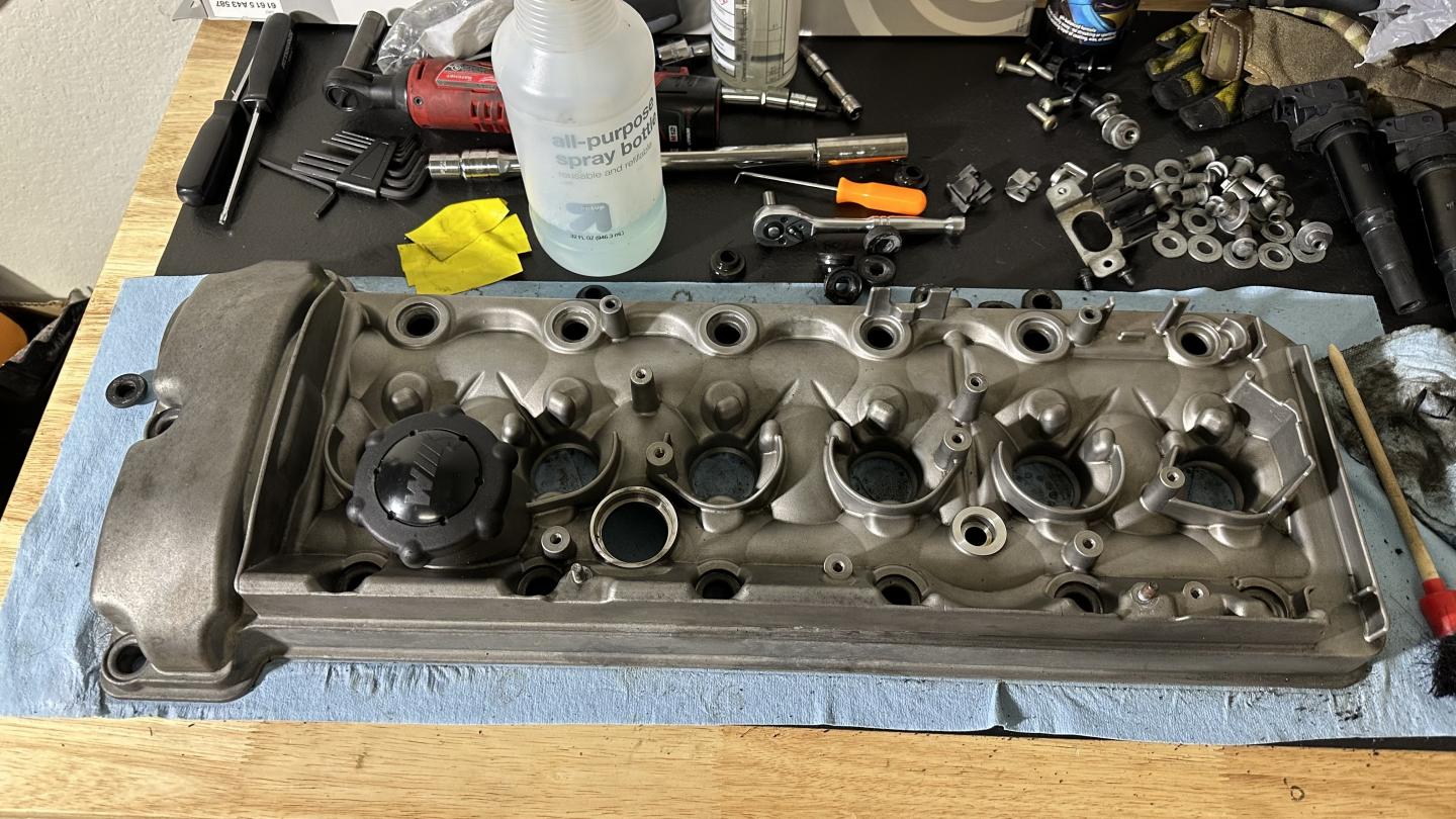

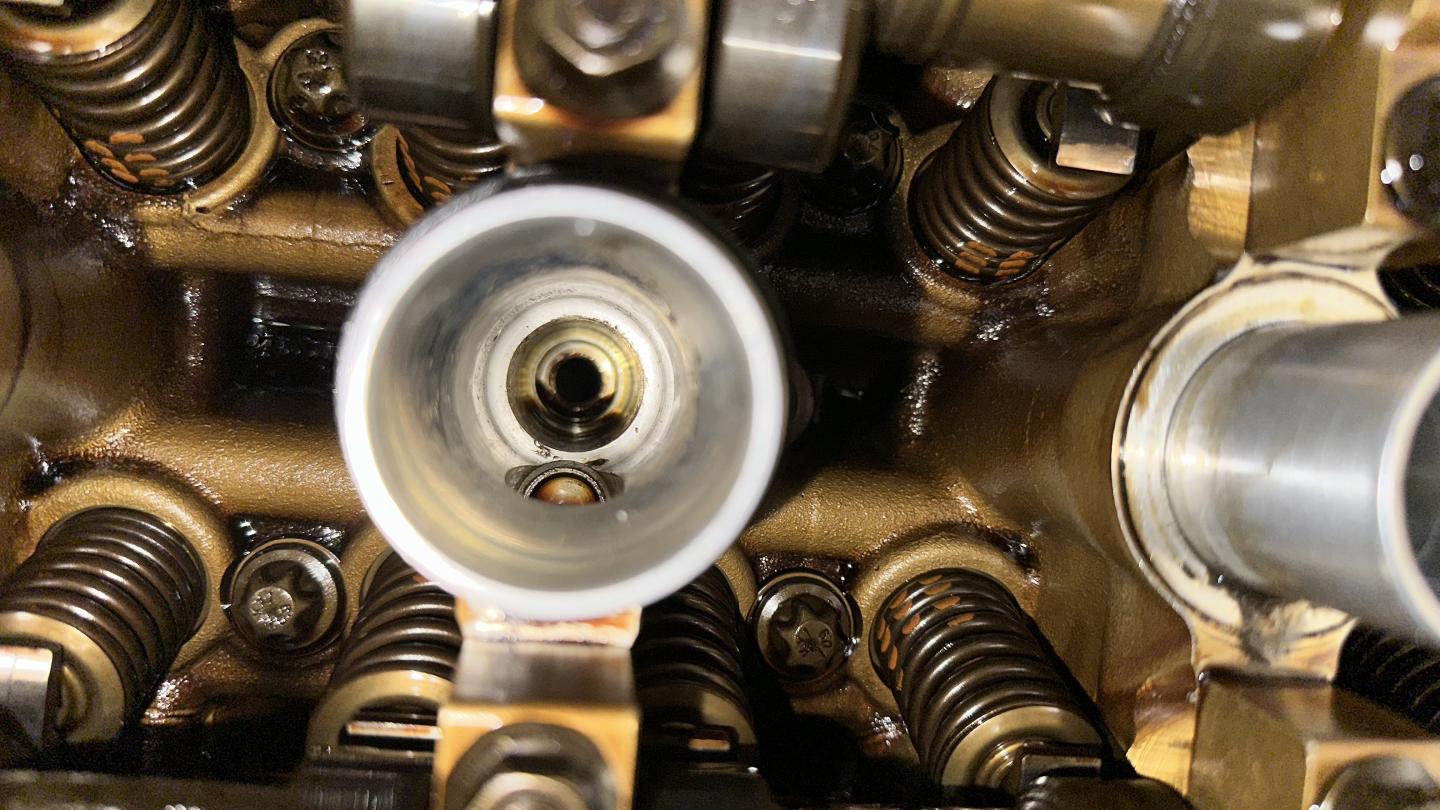

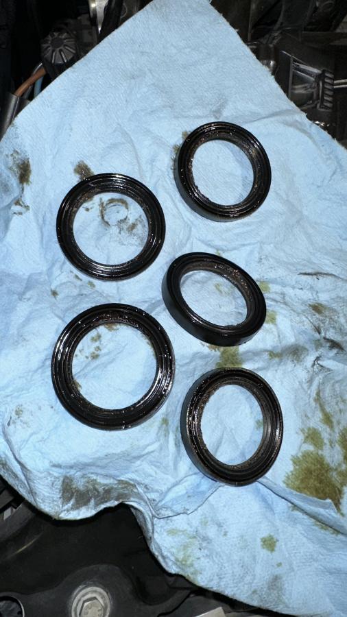

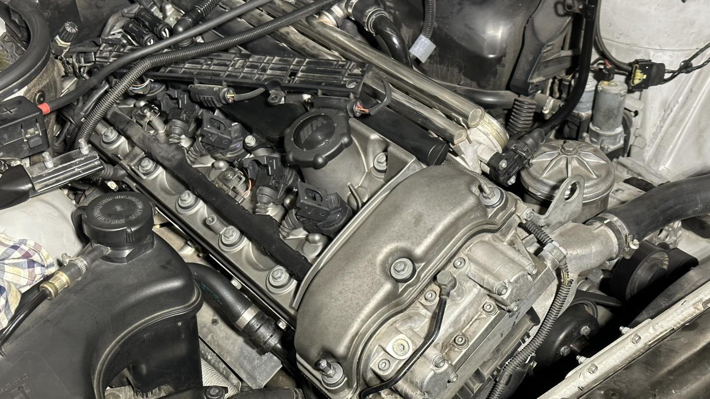

                              Since January the engine hadn’t been running right, and at 22 years old and 107k miles, I figured I’d start throwing parts at it. So far, I’ve replaced the two TPS in the engine bay and pre-cat O2 sensors. Other stuff I’ll be installing are new spark plugs, 386cc Bosch injectors, and crankcase vent valve/oil separator. The large hoses that attach to the ICV are starting to dry rot, so I hesitantly paid a ton of money for those overpriced hoses thru the dealership. Once they arrive, I can complete the CSL airbox install. Also plan on installing OE cooler (then oil change) and slave cylinder.
                              Right now the hold up for me are the ICV hoses and injectors (Rockauto order is partially lost in transit, and ECS order just shipped today). Hoping to complete everything by Wed.
                              One of the holes didn’t line up, so I had to open it up.

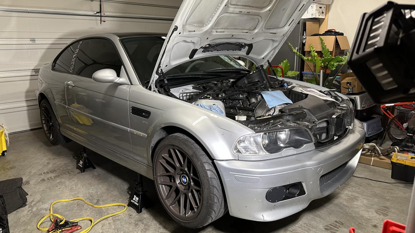

                                Last night I pulled the valve cover to replace the seals/grommets bc the guy who did my valve adjustment ~20k miles ago overtightened the hardware, causing leaks everywhere. The spark plug tube seals and valve cover were covered in grime.
                                It took me about three hours to clean the spark plug tubes, valve cover (did 5+ passes until it looked good again), valve cover hardware, and oil separator channel (almost no buildup thankfully); replace the oil separator; and install new OE spark plugs. I was tempted to check valve clearance, but I’ll worry about that when it’s actually time to do Inspection II.
                                Click image for larger version  Name:	D1DE29DF-2640-4A4F-9BAF-A43D8AD5E6E0.jpg Views:	0 Size:	221.3 KB ID:	211406 Click image for larger version  Name:	0A150F68-05DA-45A5-8D81-4FE5F363A3EB.jpg Views:	0 Size:	186.5 KB ID:	211402 Click image for larger version  Name:	ED40A875-514A-43CD-A928-566BE6FC0FA1.jpg Views:	0 Size:	78.2 KB ID:	211401 Click image for larger version  Name:	2C79BAEC-2B6E-4CAF-9067-69797FC6F6E1.jpg Views:	0 Size:	247.8 KB ID:	211403
                                While pulling the spark plugs, I panicked when I saw the cylinder 3 plug covered in oil. I’m hoping that everything I’m doing right now will help reduce or eliminate the leak. Will occasionally pull the plug to monitor.
                                Click image for larger version  Name:	5000E7EC-24D2-492F-BF82-03B10BFE7656.jpg Views:	0 Size:	71.3 KB ID:	211400 Click image for larger version  Name:	0E187BA7-8D33-43AA-8B00-88F3DCD9E3B9.jpg Views:	0 Size:	181.4 KB ID:	211407
                                Done..kinda. Just need to torque the valve cover hardware.
                                Click image for larger version  Name:	F79EABB2-B91C-400B-AB09-26A272017114.jpg Views:	0 Size:	216.3 KB ID:	211404 Click image for larger version  Name:	94054135-4AA7-4BA7-8754-E97E7281AD21.jpg Views:	0 Size:	220.9 KB ID:	211405
