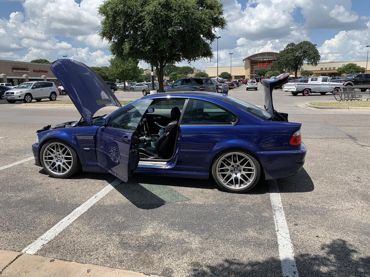

    In June I was driving around and was making a stop at the grocery store. In the lot, it threw itself into neutral and threw the cog lights. Parked it, come out 45 mins later, and I can’t even get out of the parking lot without it going into neutral like 10 times. Emergency salmon relay replacement in the Texas heat. That’s what I get for putting off the manual swap. 😭

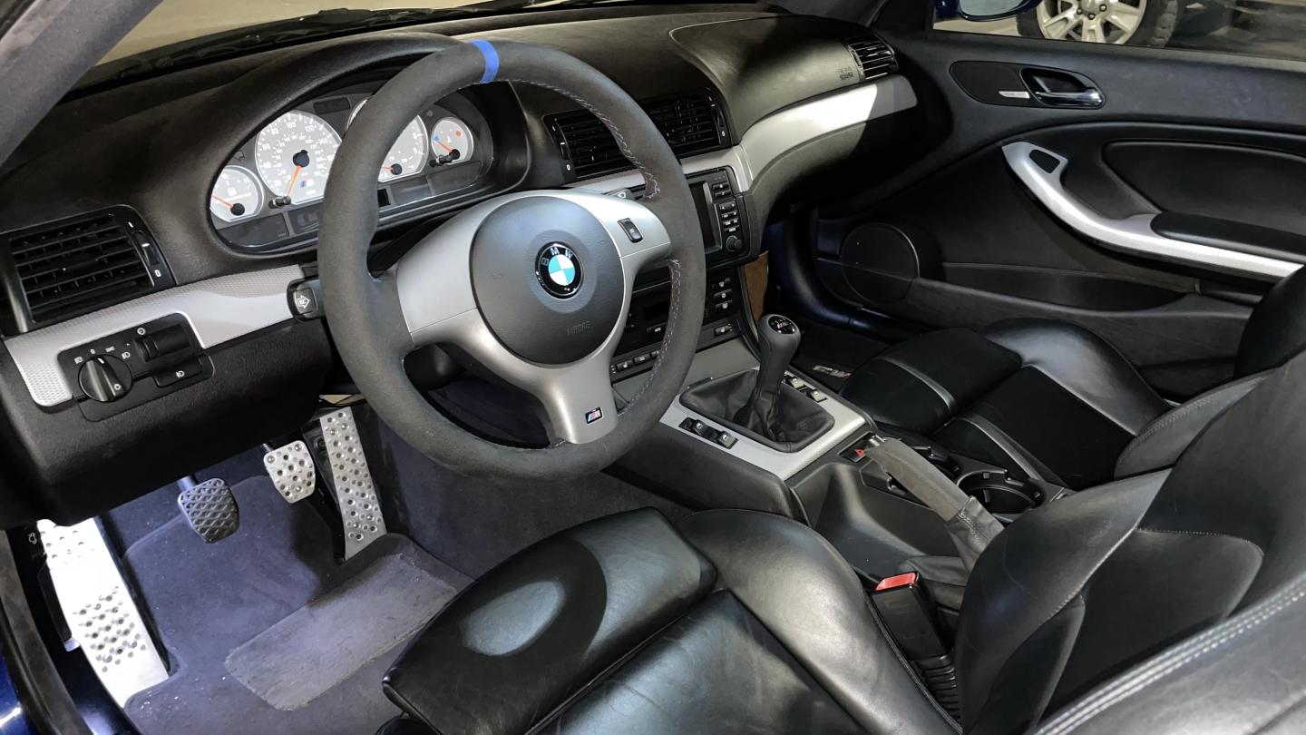

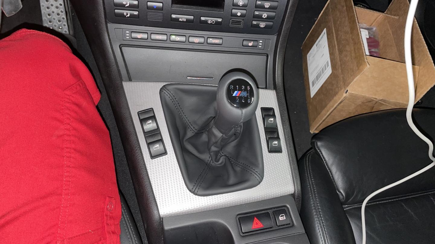

        Getting car ready for manual swap. Installed a 6MT Coby wheel (would not recommend) and a blank plate to remove the gear indicator. I’ll replace the Coby wheel for something better later on.

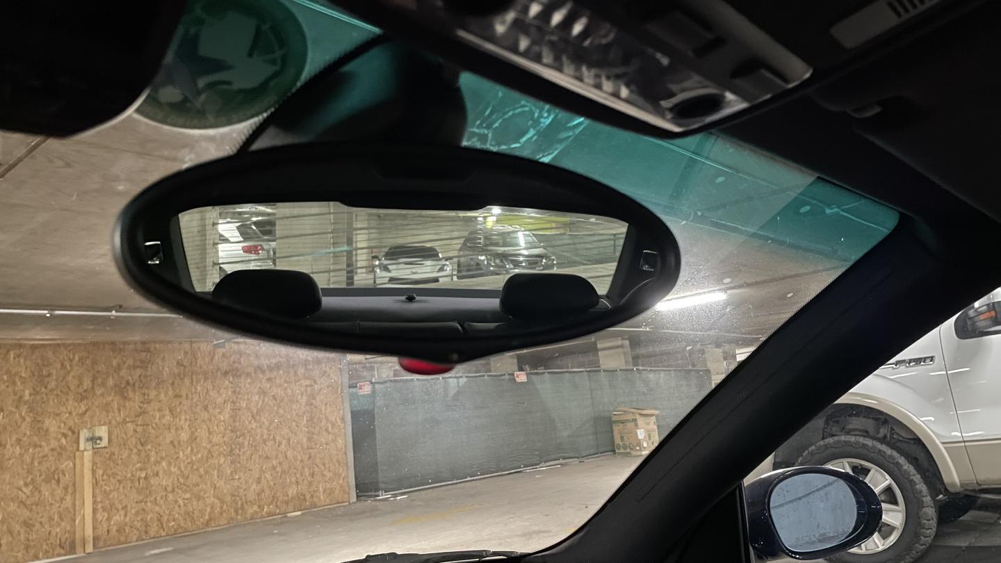

          Also installed an oval mirror and LED lights. Interior complete for now, minus pedal situation.

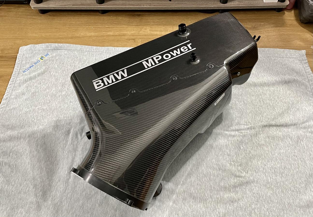

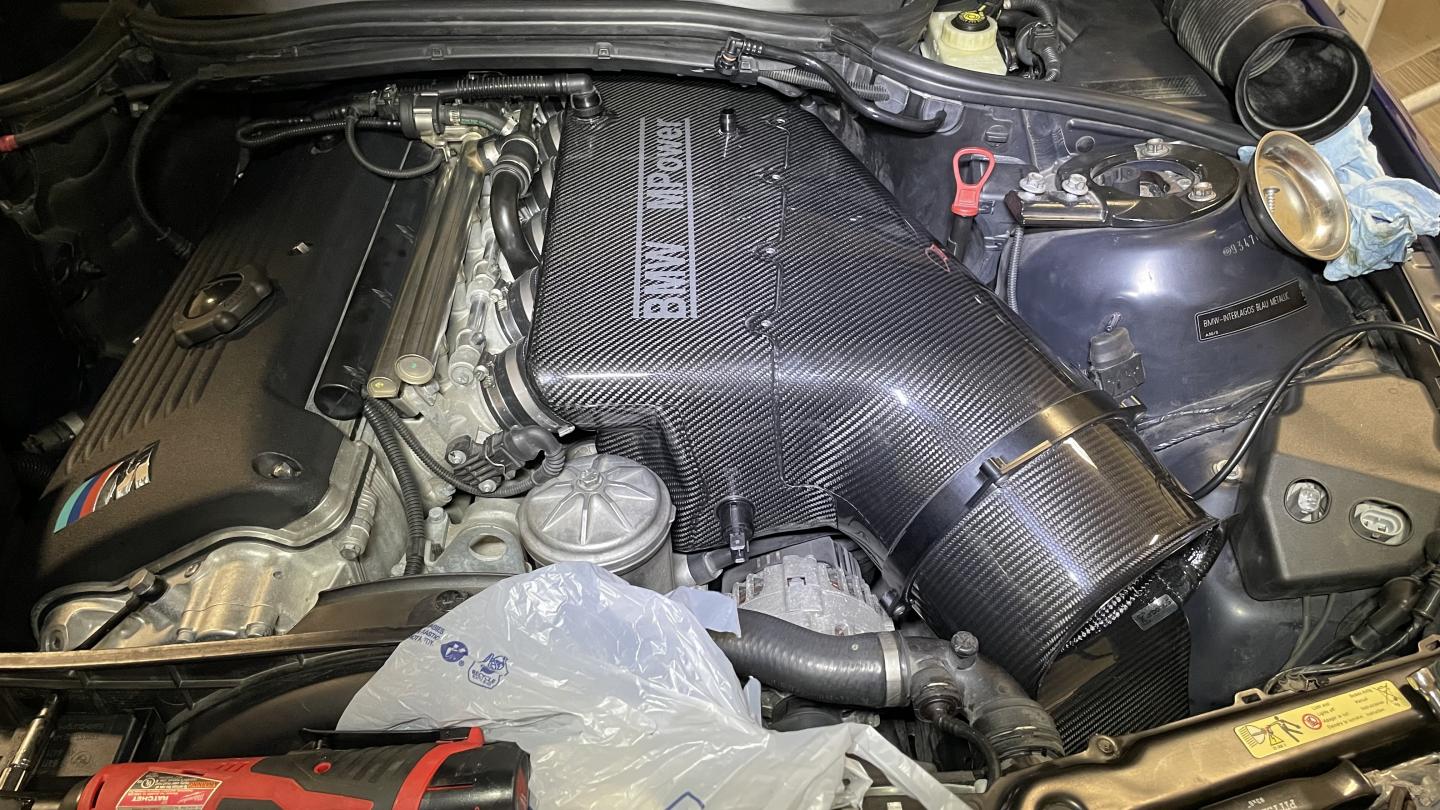

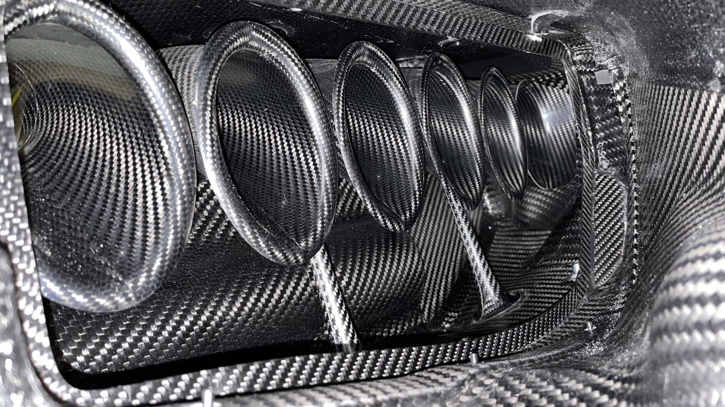

                Always wanted one but cost was an issue. I was initially going to buy a Turner intake, those things have been problematic. When I saw this new Karb intake up for sale, I said fuck it, I’m gonna make this happen.
ID:	168300 Click image for larger version
ID:	168299 Click image for larger version

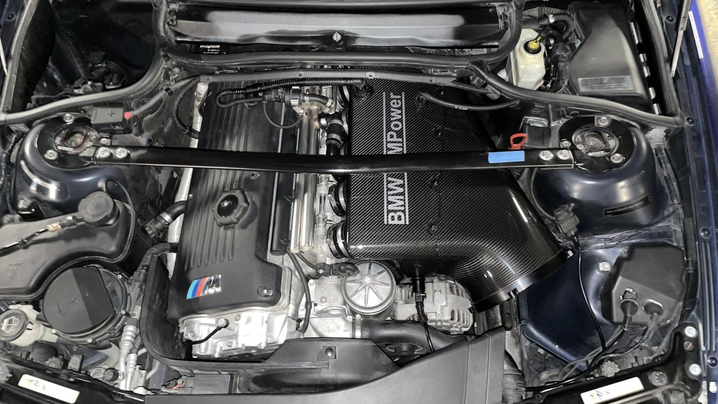

                I’m a little impatient, so I ordered the parts I needed to install and got it on the car 12 days later.

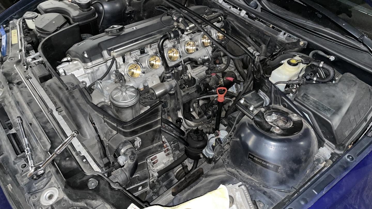

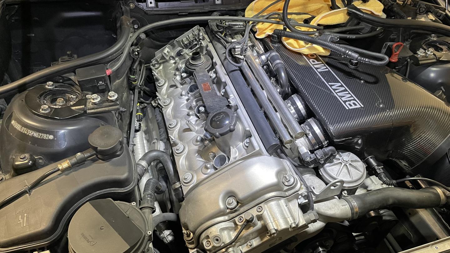

                    Finally gathered the courage to do a valve adjustment. It honestly wasn’t bad at all. IIRC, three or four shims needed to be replaced. I’d say the most difficult part was R&Ring the wiring stuff on top of the valve cover, which wasn’t even hard..just took me some time to ensure proper reinstallation/routing of all wires.
                    I also installed the Karb snorkel and wiped down the engine bay. Think I’m going to buy an Eventuri scoop to help with feeding air. One problem this presents is that I may have to drill into the snorkel to relocate the IAT sensor.

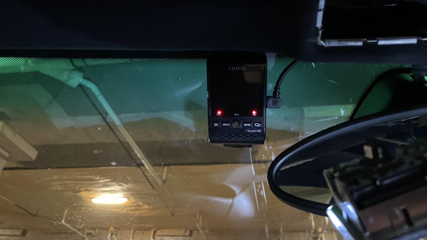

                      Finally got around to hardwiring my dual channel dash cam. From the rear view mirror, I tucked the power cable under the headliner, behind the A pillar cover, then routed it inside the dash. This allowed the cord to be completely hidden and not be half-assed like some “pro” installers’ work.
                      Click image for larger version  Name:	B2D2BFD5-C03C-422D-A2FA-D0C98FF5EEED.jpg Views:	0 Size:	152.9 KB ID:	168317 Click image for larger version  Name:	E2EF49C8-F808-4AB1-846E-85EE35A79D32.jpg Views:	0 Size:	173.8 KB ID:	168321 Click image for larger version  Name:	48B5790C-50B5-4EE0-A625-6F1509CD74F3.jpg Views:	0 Size:	208.3 KB ID:	168322 Click image for larger version  Name:	D039C5A3-97DD-4DE9-9899-B9D470E48AD7.jpg Views:	0 Size:	191.2 KB ID:	168320
                      Click image for larger version  Name:	image_35170.jpg Views:	141 Size:	87.8 KB ID:	168319

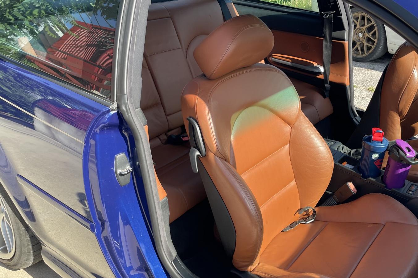

                      …because I acquired a cinnamon interior. Had to drive the car from Houston to Austin with no rear seats and holy shit the road noise made me want to cry. I’ll eventually get Cobra Nogaro seats in cinnamon leather, but right now my focus is on restoring the silver car.

                        Love the build so far. ILB on Cinnamon is my favorite combo. Were you able to find doorcards with the ZCP trim that matched the stock black interior? Why don't you like the Coby wheel? I've only heard good things.
                        2006 Interlagos Blue 6MT | PNW
                        Fortune Auto | Hotchkis F + R | Racing Dynamics | Auto Solutions SSK | Megan Headers | Supersprint Race | Apex 18x9.5 ET28 | 275 Squared | OEM CSL Trunk | CSL Diffuser | Euro Bumper
                          Thanks. Was initially going for a red interior, but I quickly realized that cinnamon is the way to go. The silver car will get a red interior soon tho. Not sure what you mean by matching the stock black interior. I had the ZCP trim already and just swapped them over to the cinnamon door cards.
                          Coby wheel quality is lacking - single joint at 6 o’clock instead of four joints, blue stripe looks like it’s been stitched over the alcantara, stitching width is too wide and inconsistent, and the way the back was put together is atrocious.

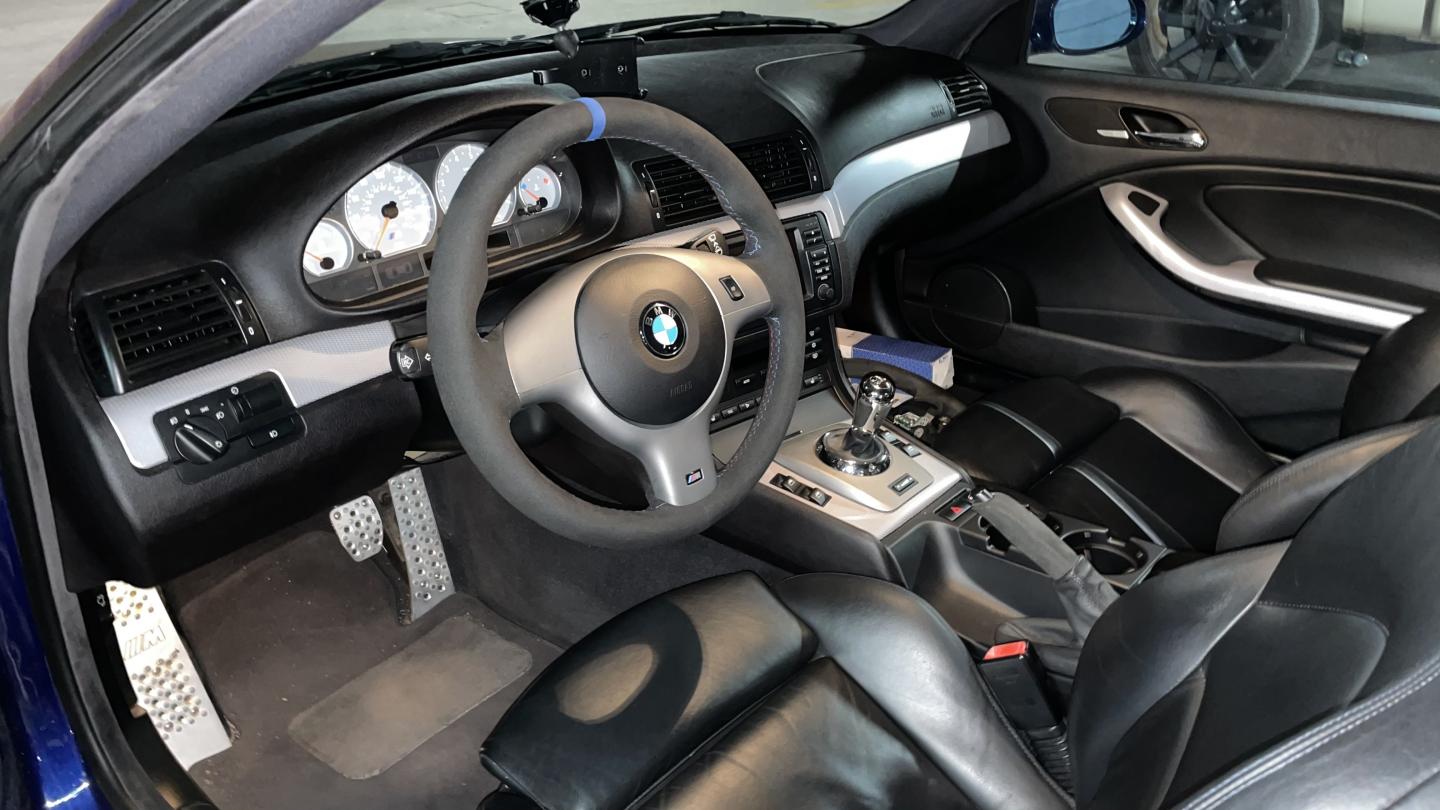

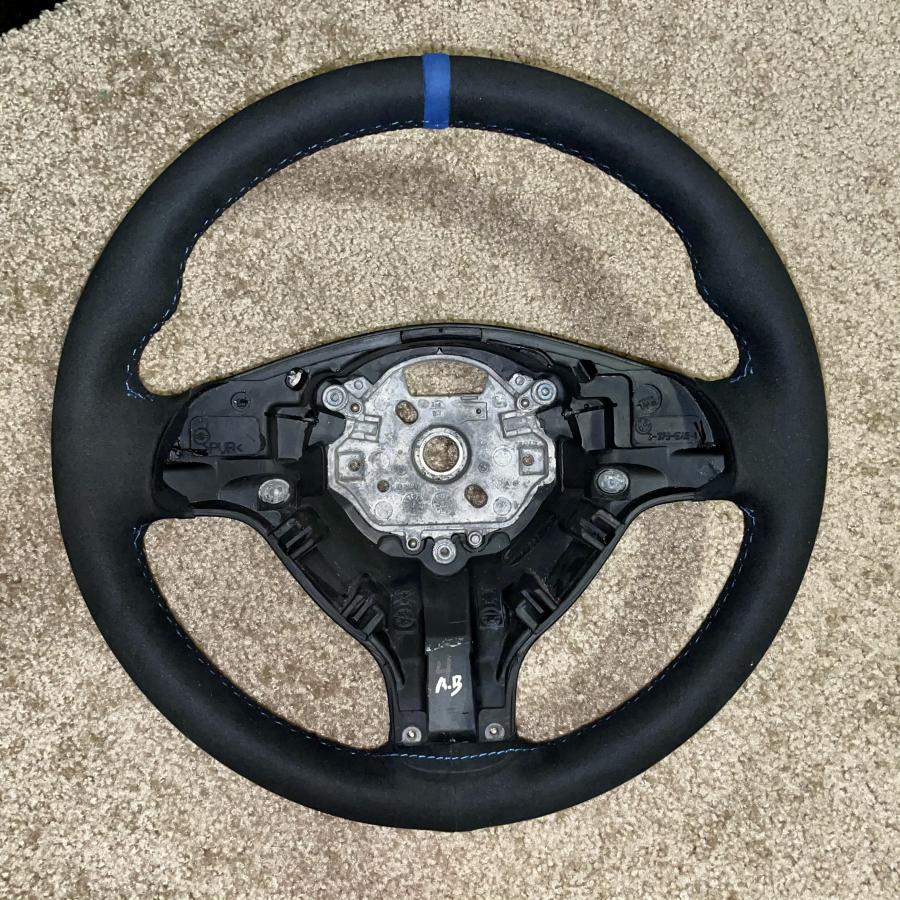

                            Got rid of the old wheel and installed a Tainik wheel in 9002 alcantara. The quality is so much better. I also replaced the yellowed side markers and the coin holder.
                            Click image for larger version  Name:	B2037E5B-641A-45C9-B5A4-D150E59681AD.jpg Views:	0 Size:	157.7 KB ID:	172056 Click image for larger version  Name:	2CD617CD-CDBE-47E7-B1B8-A3BB812D3897.jpg Views:	0 Size:	152.4 KB ID:	172055 Click image for larger version  Name:	8084F6C6-BFB4-420F-B972-0B387ED10E1C.jpg Views:	0 Size:	117.5 KB ID:	172057 Click image for larger version  Name:	9BEF8E49-6939-4572-BA56-07ACA4747122.jpg Views:	0 Size:	134.1 KB ID:	172058
                            To finish the interior, I need to replace A and C pillar covers, rear ashtray cover, front ashtray cover/bracket, and I will also install new pedal covers and an Avin Avant 4 (if I like it in the silver car). The Nogaros (again, if I like them in the silver car) and CF roof + slick top headliner are longer term projects.

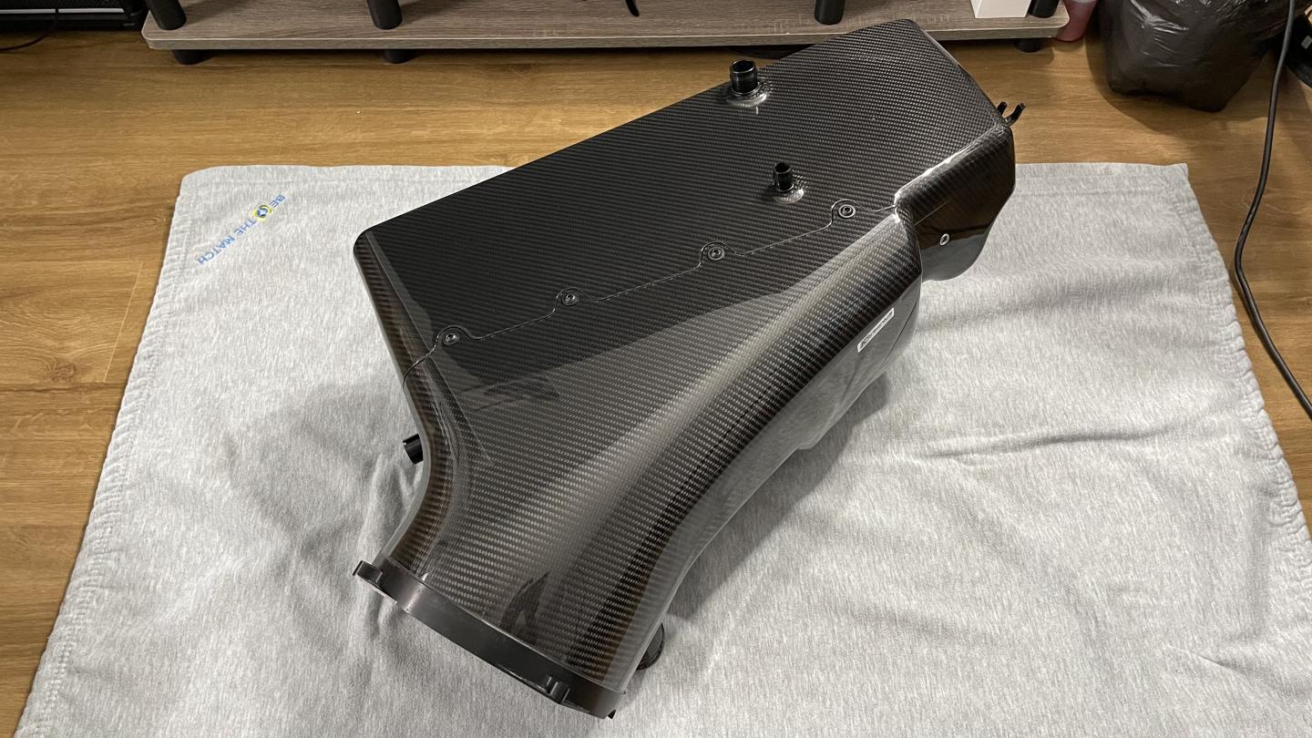

                              Whoever is responsible for this is a fucking dumbass.
                              Click image for larger version  Name:	B922C650-690B-4CF3-B66B-9A8AB24DA2FD.jpg Views:	151 Size:	121.7 KB ID:	168302
                              Airbox looks amazing - hope to have one some day.
                              I'm curious about the rubber boots - from what I've read, you have to a source an intake from a pre-LCI car or purchase 6 of the boots individually (11617830265).
                              Did you have issues with this?
                                Yeah, you need to use the smaller pre-LCI boots. I would’ve preferred to use OE boots but didn’t want to pay hundreds for a set, so I just got the Turner silicone boots.
