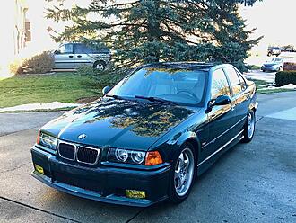

    First pics of the car after I purchased it from a private dealership in NC back in January 2019. Pics were taken on the drive back to my folks in Indiana, where the car say parked till spring. Somewhere around the Virginia turnpike:

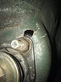

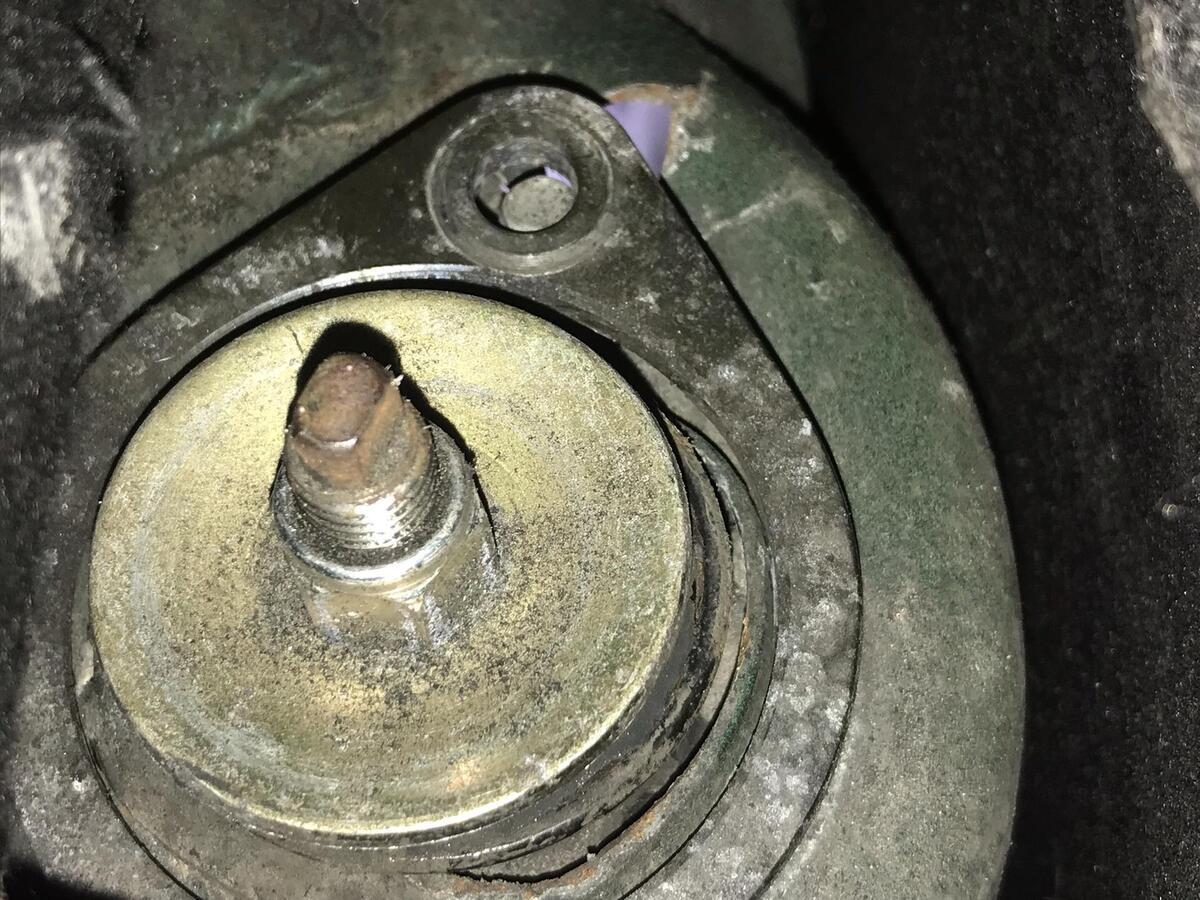

    We'll start with the most recent development and work our way backwards: finding a band-aid that decided to come loose today and reveal a nasty RSM (rear shock mount) failure.
    Last weekend, I was back home visiting family (in particular my brother who flew in for father's day) when I discovered that one of the 7 (yes, SEVEN) prior owners had decided to put a reinforcement plate on top of a failed shock mount/strut tower. I had always heard a slight rattle in the rear of the driver's side but could never track it down. I tried securing trim pieces in the trunk, checked my C-pillar covers, etc. but nothing seemed to remedy it. That was until on my drive back to Michigan from Indiana, I heard what sounded like concrete being pulsed in a blender whenever I encountered the slightest surface variation. I immediately took the next exit on the interstate and upon removal of the drivers side trunk trim panel was greeted with this:
Name:	RSM missing bolt.jpg
    The constant rattle I had been hearing must have been my shock rattling in this hole. Upon further investigation the missing nut that should be on the shock mount bolt had been crossthreaded and decided to back itself off. I limped the car back to a friend's place who has a garage full of tools and we chopped/pounded the hold bolt out since we couldn't get it lined up with the reinforcement plate hole and shoved a new one in. What you see below is more or less the fix that a previous owner thought satisfactory once he or she found the tower had failed.

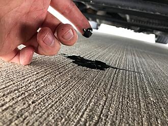

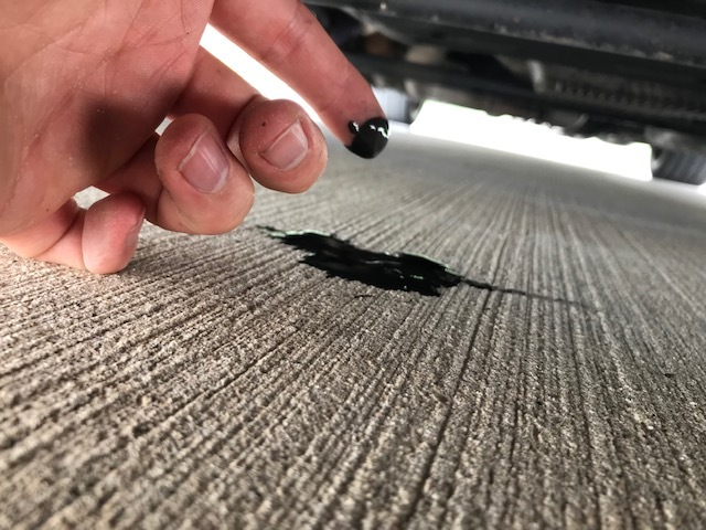

    This one appears to not be an incredibly common failure mode, though I did come across a few posts from owners who experienced something similar. I perform an oil and spark plug change, and after a few miles of driving I noticed a lot more fan/induction noise than I used to. My first thought is that I've overfilled the oil, but after checking the dipstick on both a hot and cold engine, it appears all is normal. I drive for a little more with the same noise (an loud whirring that sounds like an industrial dryer that gets louder as the RPMs increase) and I look under the hood after a drive while the engine is running. I can see the rotational path of the clutch fan is starting to destabilize and get wonky, coming dangerously close to a hose clamp on the coolant hose that runs to the thermostat housing. Alleuro to the rescue again as I order a new Sachs clutch and Uro fan. The next morning, I go out and check underneath the car before I drive to work and notice a small puddle of dark blackish-grey fluid. It super thick, almost like epoxy and has no smell or taste (probably not my smartest move, but I wanted to make sure it wasn't some form of stop-leak). I can't tell if its from my car or someone else's that live in my apartment building, so I cautiously drive to work anyways. That day during lunch, I go out to the parking lot at work, parking in a clean spot with nothing on the ground and I see the same fluid on the ground directly underneath the clutch fan.
Name:	fan clutch fluid 1.jpg
    Uh oh. I limp the car home after work and luckily, my parts have arrived. Replace the old clutch which had given up all of its fluid along with a new fan for good measure. Whirring noise is gone and all is well.

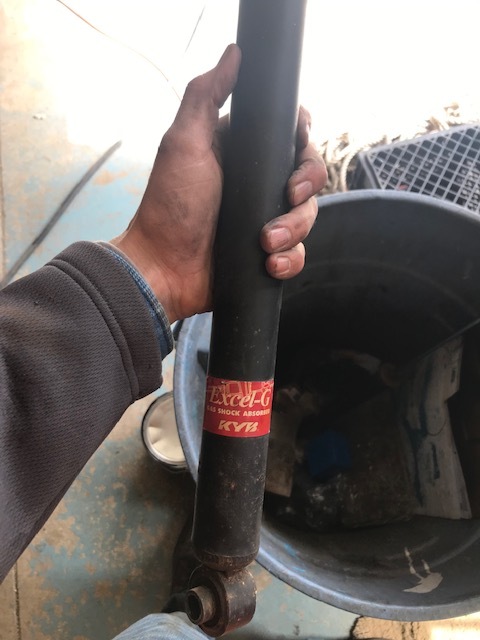

    Well, before the impending recession reared its ugly head, I had planned on converting from HR Sport springs over stock front struts and crappy aftermarket rear shocks (don't even know the brand, the tubes are red??) to HR OE Sport over Konis. I've got the new springs, spring pads, Meyle HD front sway bar links, OE lemforder rear end links, new Corteco OE front strut mounts and '95 upper spring plates for the front all sitting in a box in my living room. Was planning on ordering the Konis this week but things have changed... I've got an x-brace that I found on OfferUp several months ago that's all cleaned up and ready to install, but I figured I should probably do engine and trans mounts while I'm in there. May be able to justify the price of the mounts seeing as I can get everything from FCP for about $100. Was planning on getting a rear spoiler painted and redoing the seat covers with ones from LSeat later this summer, but all of that has come to a screeching halt. Will try to update with pics if I end up installing anything.
    At long last, I've rid myself of the inferior and downright awful suspension setup that came on the car when I purchased it over a year ago. The car was sitting on H&R sport springs with stock Sachs struts (approximately 30K miles on them) and KYB Excel-G shocks (which had an estimated 50K miles on them). The car was severely under-damped; clunked, thudded and rattled over any imperfection in the road, and I practically fell into the car every time I got in. After hours and hours of research and deliberation, I settled on Koni adjustable and H&R OE Sport springs. I wanted an OE+ feel to the car, and wanted the added longevity of the Konnis over the stock Sachs (adjustability doesn't hurt, either). The install process is pretty well-documented, but I managed to take a few pics along the way.
    Honestly couldn't believe someone put these on the car. Had never heard of the brand, but did some research and they appear to be pretty unloved (I can see why, now).

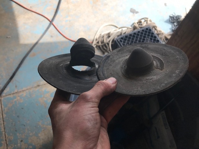

    One of the previous owners decided to run dual lower spring pads on both sides, rather than source the correct upper pad. The one that is torn was being used incorrectly as an upper. The pads were rock hard and only about 1/3 of their original thickness. Sometimes I'd like to strangle at least 3 of the 7 previous owners

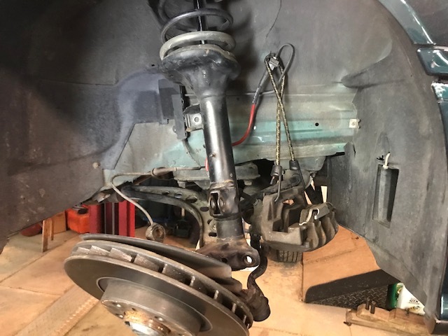

    Removing the front struts.

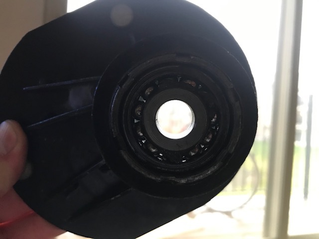

    Maintenance records showed that the front strut mounts had been replaced about 30K miles ago, but upon investigation they looked terrible (pretty sure you aren't supposed to be able to see daylight through the bearings...). Lemforder OEM units have been out of stock everywhere for the past several months, but I managed to snag a set of brand new ones from someone on OfferUp a few months ago.

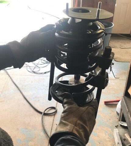

    Building the Koni strut units was simple enough. Not much drama in the cutting and drilling of the original housing. When the time came to assemble the units in the car....things got messy. For some reason, when I went to install the strut assembly, all of the bolt holes on the strut were 1/2 to 1 inch below where they needed to be in order to line up with the holes on the knuckles. I broke the assembly down twice, making sure I didn't forget any washer or put something together in the wrong order and things still weren't lining up. This led to a desperate (and non OSHA approved) method of compressing the springs, then compressing the strut and ziptie-ing eveything together in order to decrease the overall height of the assembly. After getting things situated and the bolts loosely tightened, I cut the zipties and the assembly seated itself. This was the only hiccup in the whole process, but it took me about 2 hours of trying to get the new assembly to fit before I gave up and compressed everything.

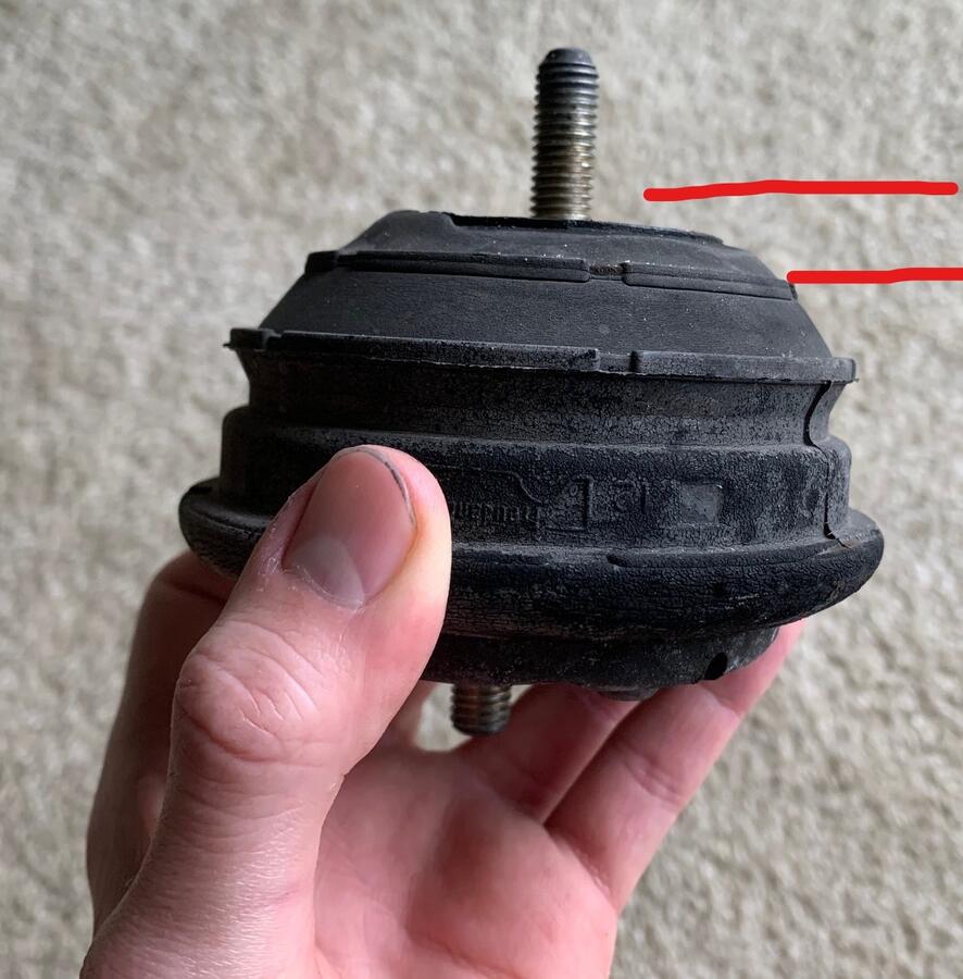

    I went ahead and installed new Meyel HD sway bar links just to be safe, even though the adjustable units that were came with the car seemed to be serviceable. I also replaced the engine mounts, trans mounts and threw the X-brace on. Have put about 100 miles on the new setup and the car feels amazing. Turn-in feels superb and while I can still feel most imperfections in the road, the car communicates what's going on rather than beating you over the head (or your tailbone in this case) with every crack and bump.
Name:	old engine mount.jpg
    I should have taken a pic of the the old mounts (pictured) next to the new ones, but from the crude lines above, you can see just how deformed the old mounts were. There was a good 1/2 - 3/4in less material compared to the new mounts. And the old ones were rock hard and weighed considerably more, due to the absorption of oil and moisture over time.
