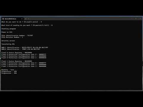

    I try to do a bootstrap loader on my Bosch MEVD17.2.G (TC1797 mcu) in bench mode without opening the ecu as my PCMflash tool does but I am stuck at the security access before transfering the bootloader. I think it is a sort of seed key : ecu sends 10 kind of random bytes and the host must answer with 20 bytes. I was sure the algorithm was in the BootRom (0x8FFFC000-0x8FFFFFFF) but after successfully dumped and disassembled it I haven’t found the algorithm in the code (only 16kb). Maybe someone know where is located this algorithm in the code ?

        I've finally succeeded to find where is located this algorithm. It is in hwel1 and hwel2 (OTP area). I now understand why some programming tools don't succeed to pass the security test on last version of this ecu. It is because Bosch had modified their algorithm on the last version of hwel1 and hwel2.

                        The final challenge is to have a correct BSL signature. For HWs before 07/2020 (TPROT V00.00.00), the BSL signature verification can be bypassed but after 07/2020 (TPROT V00.00.02), they also increased this mechanism. I currently don't find a way to bypass it. I was able to notice that professional tools have a correct BSL signature for this new HW. It could mean two things : either they were able to access to an original Bosch BSL or they were able to access to the private key to generate a valid signature. When I take a look at the code I think the first hypothesis is correct.
