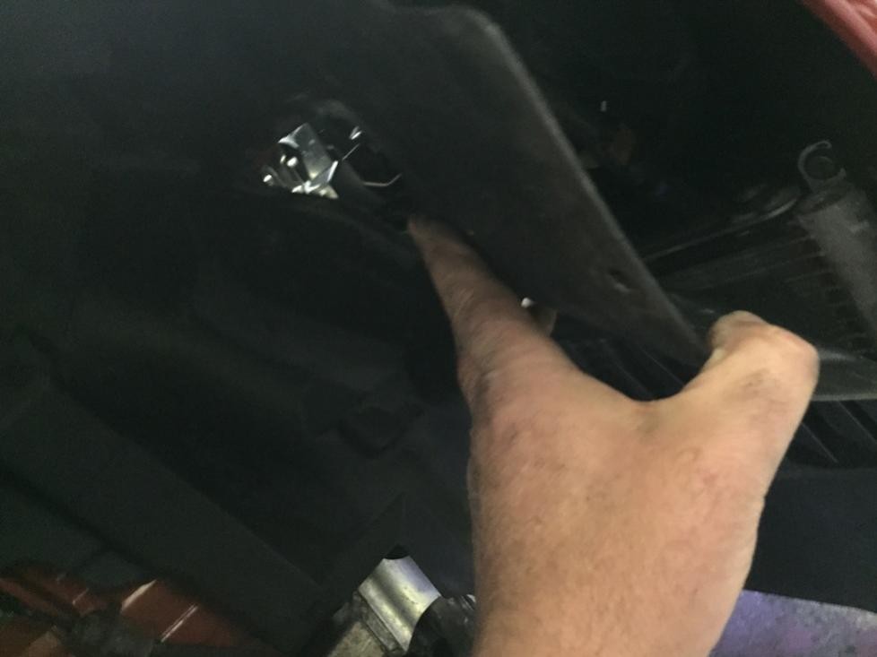

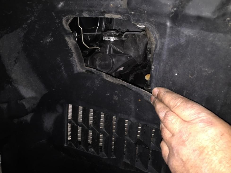

3) Remove the access panel from the wheel arch.

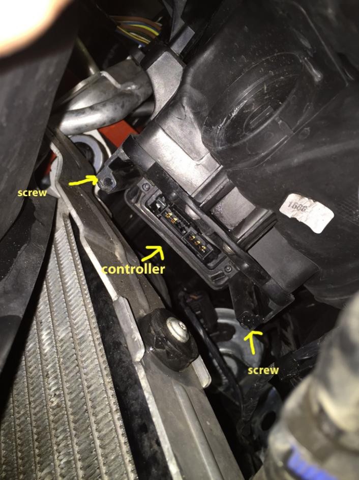

4) Pull out the arch from the bumper to gain access to the bottom of the light toy will see 2 torque screws holding the controller in place remove the screws.
5) Then put your hand under the controller and pull it towards you where you removed the screws from.

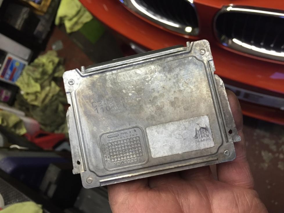

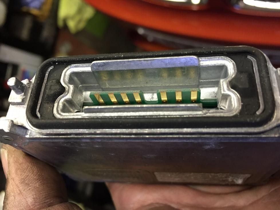

6) Check there is no water or corrosion on the connections.
if its good just clean the rubber gasket and refit but check it every 6 months as its not covered by warranty :banghead:
This is the part and where it is fitted there is one on each light.
