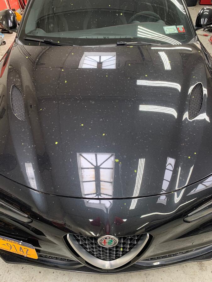

    First up was a Alfa Romeo Gulia Quad.
    The paint of this car was really thin, rock chips really dug into the paint exposing the bare surface
    It was not hand washed and it showed.
    The car has been on track day many times... fantastic car.
    The whole process took about 32-35 hours (inside and out)
    2 step paint correction.
    2 layers of Ceramic coating was applied.

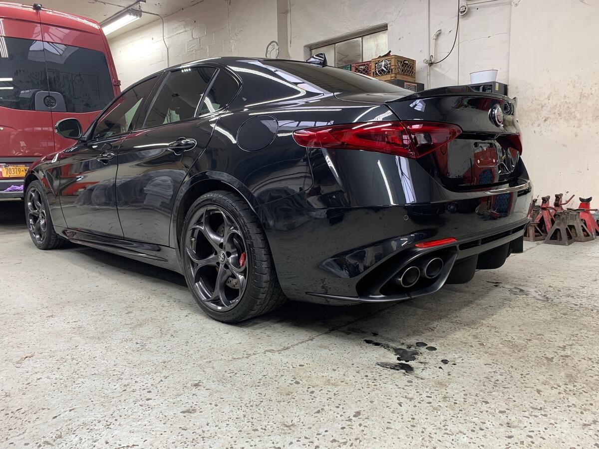

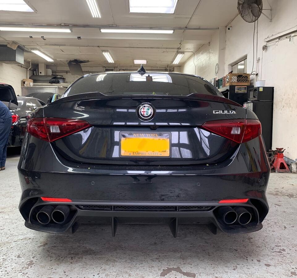

    And after a 2 step paint correction
    and ceramic coating treatment.
