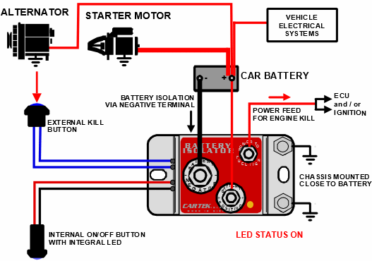

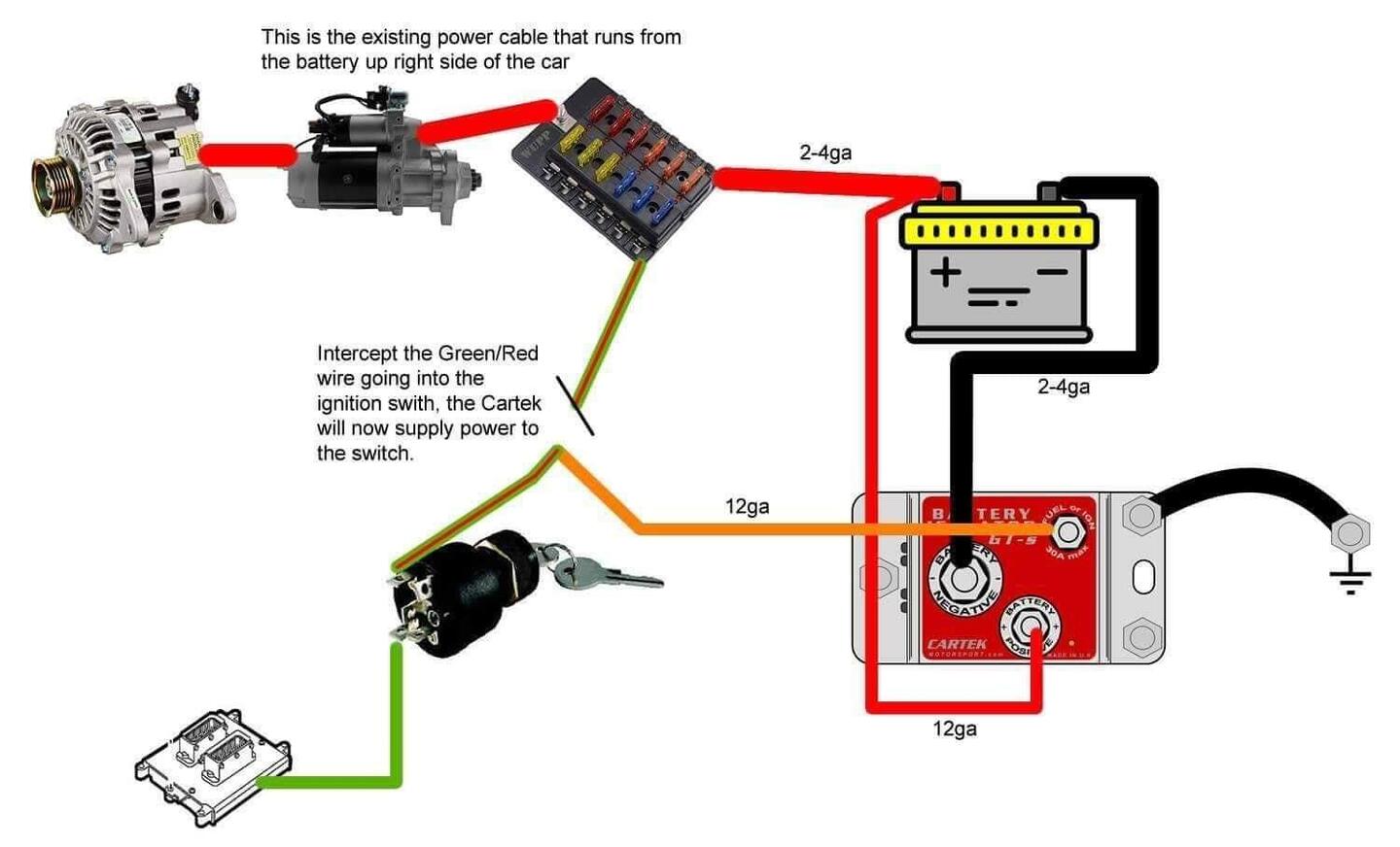

    The battery ground, battery positive, and a harness for the kill buttons, is straightforward. But what would be the easiest or best place to connect the 12V to ecu or ignition for the cut out?
    "This kills the engine by taking in a fixed 12v input and sending a 12v output that would power your Ignition or ECU. When the negative side of the battery has been disconnected it will also cut the 12v output powering your Ignition or ECU. This will kill the engine. Designed for cars with Standard ECU’s or Historic Race cars."

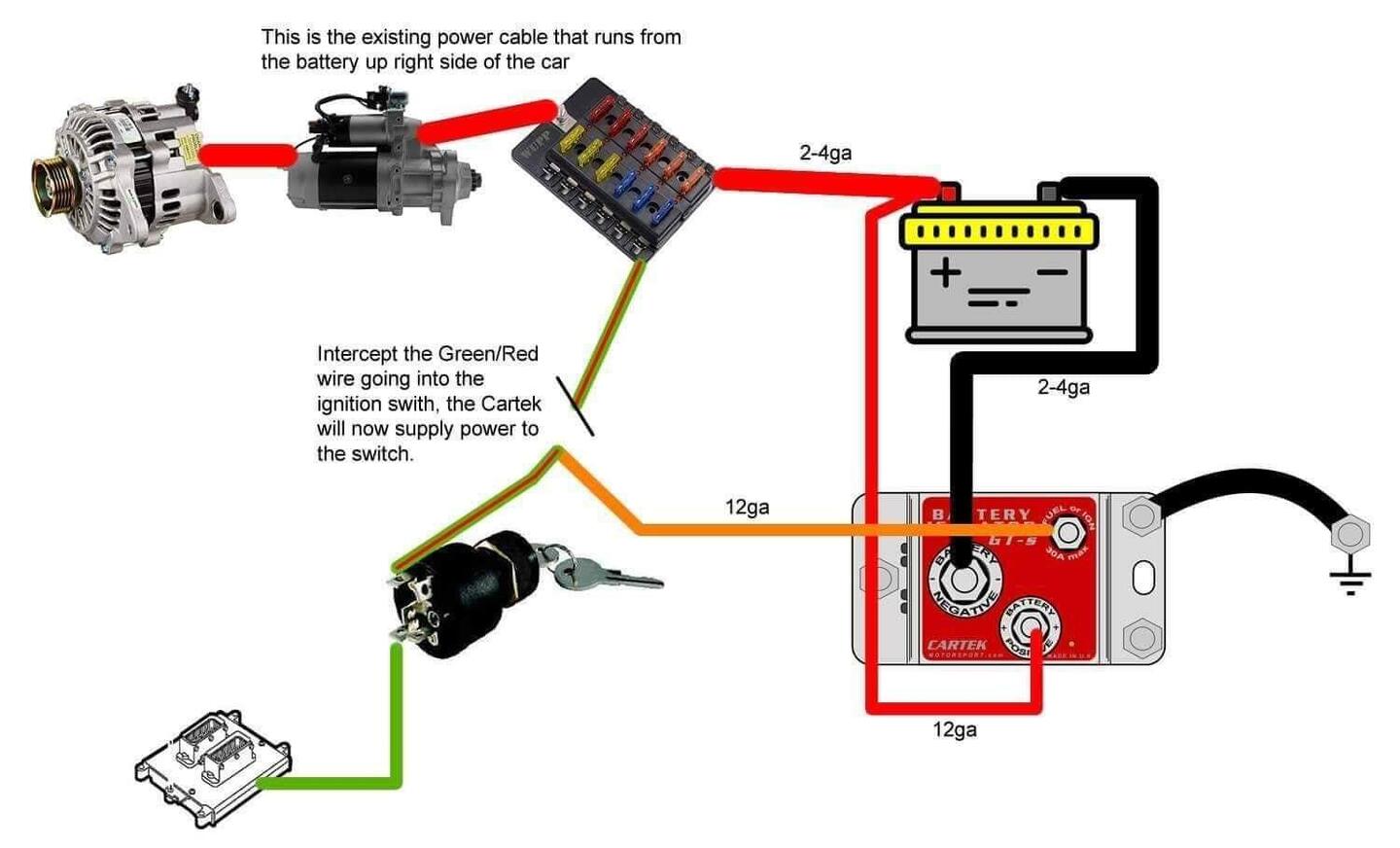

    Click image for larger version  Name:	cartekdiagram.gif Views:	0 Size:	62.7 KB ID:	111279
    Attached a pic from PD's facebook page. Click image for larger version  Name:	cartekGT.jpeg Views:	0 Size:	141.7 KB ID:	111278
    I'm working on this right now as well. I'm trying to find a diagram for the ignition switch on these cars but haven't found one yet. I'm not sure if it's the Red with Green stripe wire or if it is the Green with Silver stripe wire that needs to be cut and given the power from the Cartek.

        I have confirmation that the Red wire w/ green stripe is the wire that receives the power from the Cartek unit, just as the drawing shows. I'll be doing it this week on my car. GL OP.

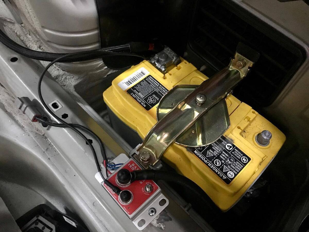

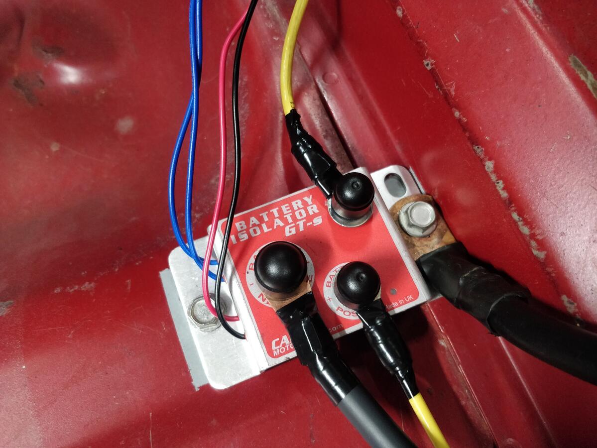

            Installed.
            '02 e46m3 - fully caged track car
            many others
              Looking good! Where did you end up splicing into the green/red cable?
                I grabbed the red/green cable under the dash near the fuse box so I could splice it easily with plenty of room. It's damn hard to work on a car with a full cage in it already.
                For mounting the Cartek itself, I ground the paint off from under the unit then sprayed galvanized paint under it before mounting for a good ground. You can see a little in the photo. Additional stock grounding strap was used as well, just to be extra.

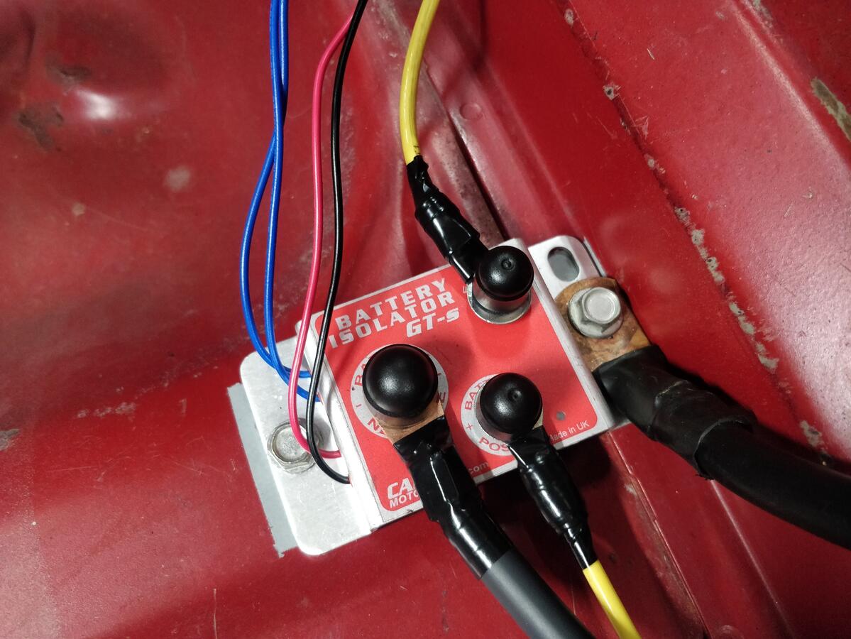

                  For anyone else who stumbles upon this thread later, here is the Red/Green wire out of the ignition switch that needs to BE FED the 12v from the Cartek GT unit.

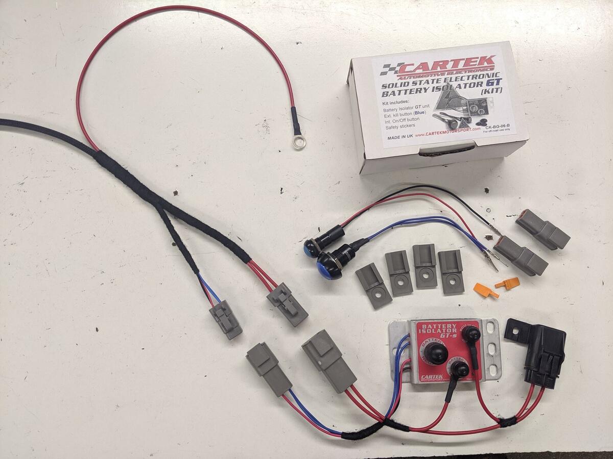

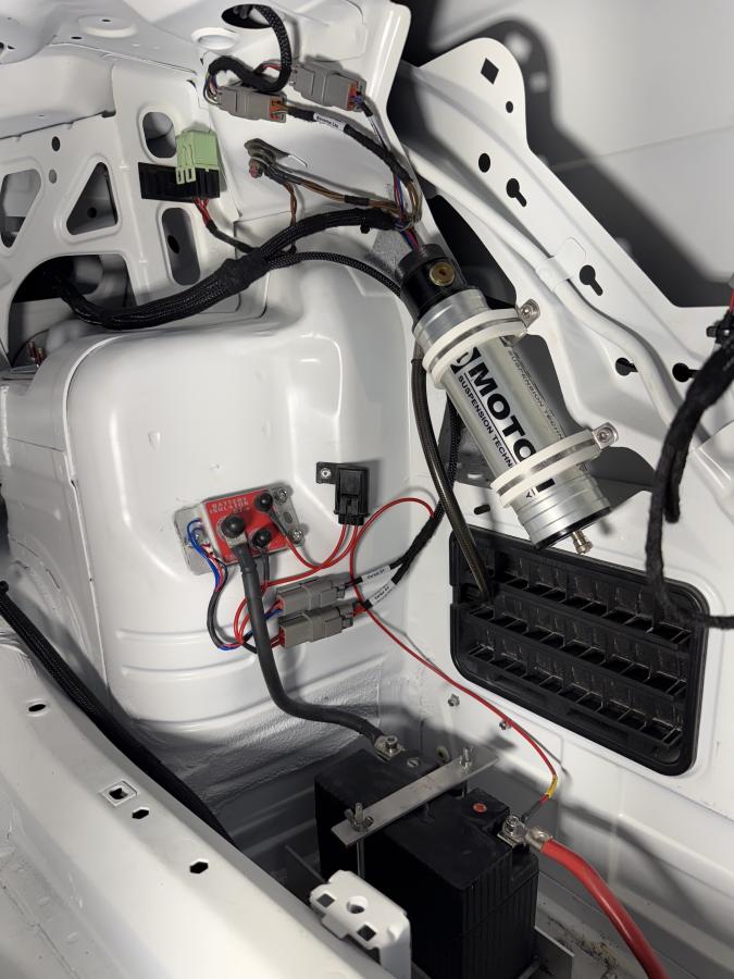

                    Ended up finally installing it in the new car. Kevin Tulay did the entire harness wiring, so putting in the unit was all I had to do. I stripped to bare metal behind where I mounted it, used dielectric grease between the chassis and the cartek, and then I sealed around the unit using some silicone.
