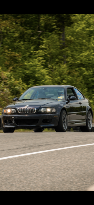

    Been to about 10 or 12 track events so far. Loving it more and more. What I don’t love... is being black flagged at every other event for my hood looking like it’s going to fly open. And it’s only on the side that the oem hood latch is not on. Question is do most guys end up going with hood pins? I haven’t seen to many of them but on dedicated track cars. Has anyone else experienced this issue and fixed it. My guess is the hood needs to be bent, or the rubber gaskets around the headlight are not doing what they are supposed to anymore. Click image for larger version

      Something is wrong with your hood/latches-- a healthy stock hood does not do that.
        Agreed. I would also lower the bump stops a touch. Even if only on track days.
          Thank you all. Upon closer look the left side latch was not engaging. Got it to click on after extending it. Will need to fool around with it more but at least I know they are both clicking in now
