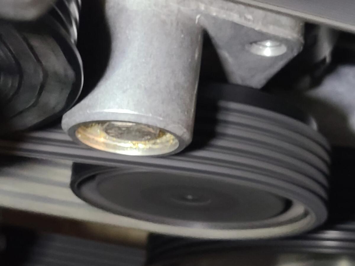

                    I have the vac pully that shipped with the ati damper and swapped back to the stock pulley due to this concern but that didnt work as mentioned above.
                    Pic of stock pulley on ati damper causing shift of belt on tensioner(the belt does not rub the damper this way but.......):

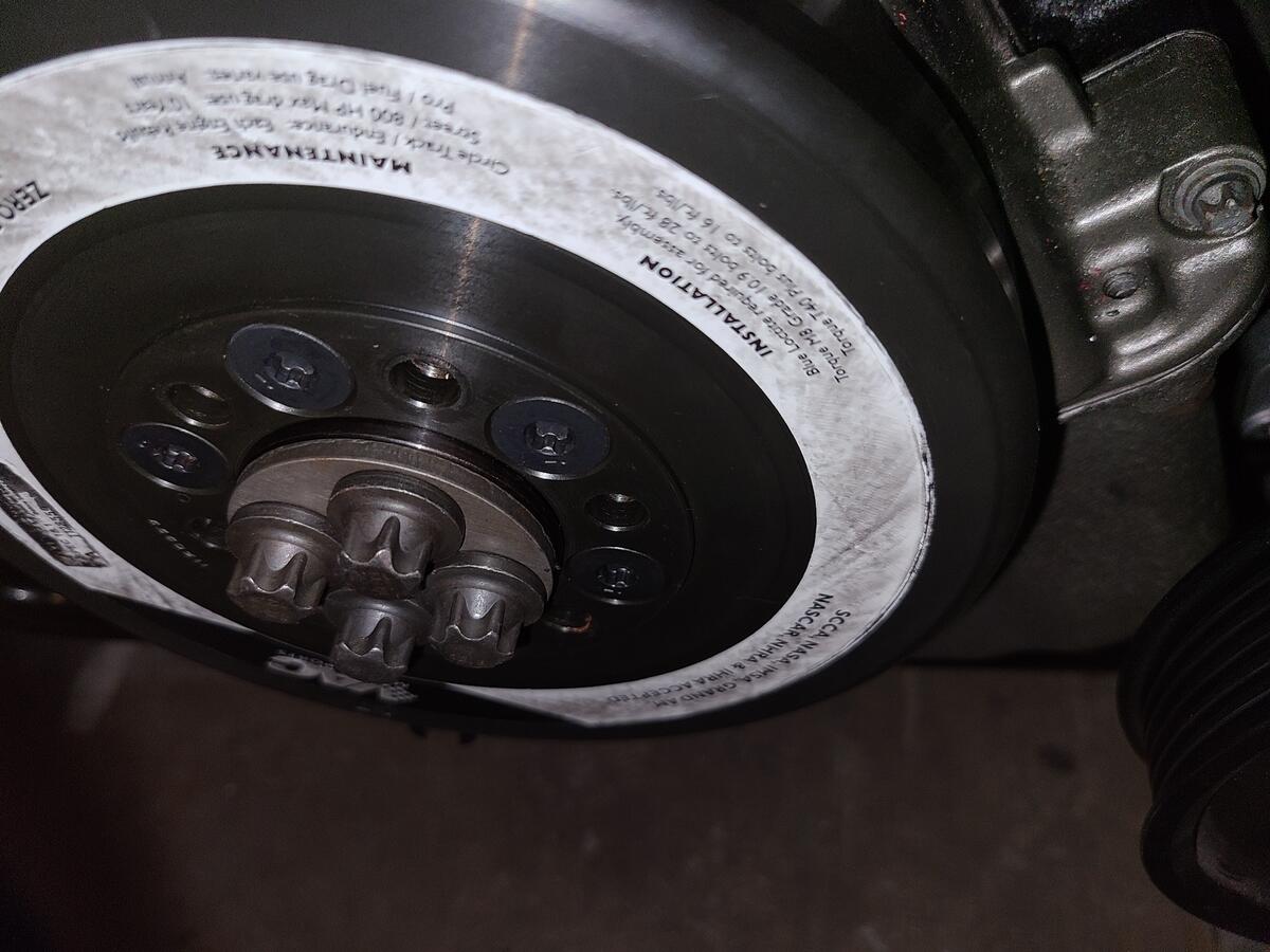

                    Compared to stock there is no "damper side/inbaord" flange to protect the belt like most other pulleys, and while i dont think its a tight rub, the white sticker on the ati damper has marks suggesting a rub. No signs on the belt of wear from relatively short but spirited use.
                    Wear marks on damper(custom vac pulley), i need to get a pic of belt on pulley but when u look at it it looks to be touching.

                      Anyone have experience with the Ross damper?
                        I would not use the VAC ATI setup. Just blew a brand new belt. I'm guessing it's not aligned correctly. Reached out to Morehead and they had the same issue. I'm switching back to stock. This is the last VAC part out of my car, and will never be using anything they make again.
                          so your belt was rubbing the damper like mine?
                          it just needs like 1mm or less to clear i would guess but easier said than done
                            Yes. My guess is that to make this damper fit, VAC did not machine an inner lip on the pulley, and it rubs directly on the damper. Typical VAC bullshit. Maybe this was common knowledge, but news to me. Tore up the old belt in one weekend, and a new belt with brand new tensioner and idler pulley in two weekends.
                              This is a guess. ATi was working on the guidance from VAC. Then VAC wanted to stay cost competitive so they tried to make it work. This is an attempt to make an exclusive product.
                              This wouldn't be an issue if ATi developed the damper themselves.
