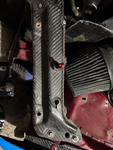

        Have any photos of the install? I saw one on youtube but wanted to see how others do it.
          here ya go
