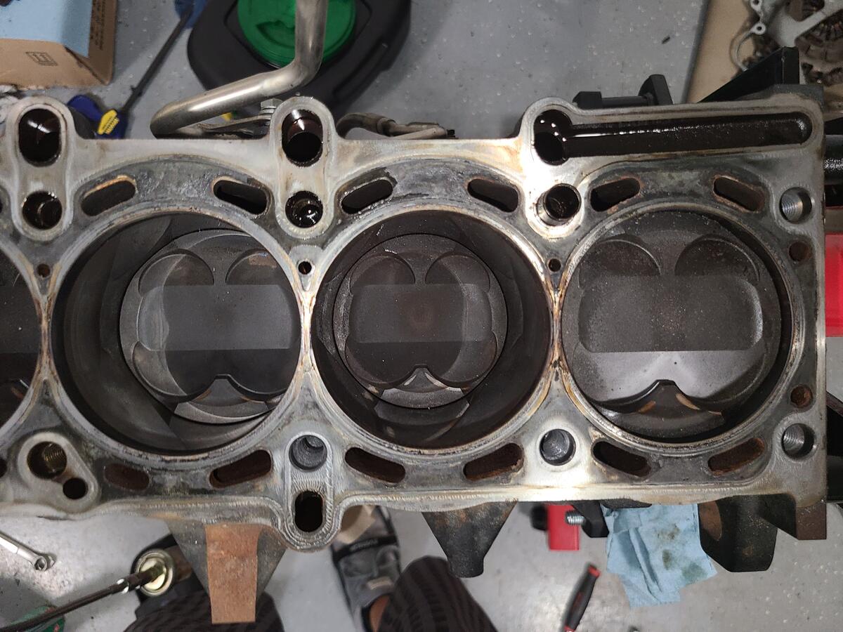

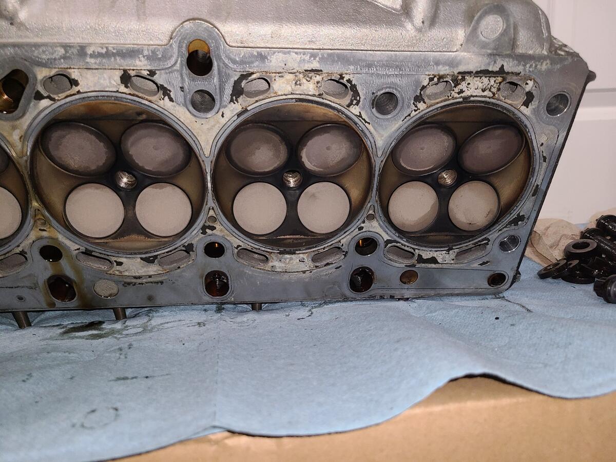

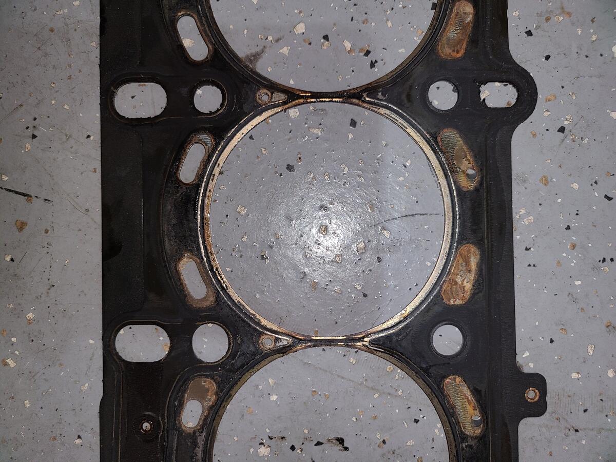

I think i got my head gasket at the last track day. Had a red flag and stopped in the pits but they let us go again and just on pit exit i saw the temp at the hot line. Fresh 80+mph airflow solved the temp issue and it ran just fine and after discovered a disconnected wire to my aux fan. Fixed that and Ran the rest of the day without issue, no power loss, or other symptoms. Over the break my project has been extensive. CMP reinforcement, full solid bushings etc, etc, among many other things. I decided to flush the coolant and it was pretty dusky, greyish. Its only been in 2 years 5% coolant to water and strictly track days 8/10 per year. Refilled thinking it just must have gotten dirty and on refiring the car yesterday letting the new coolant circulate i saw a few puffs of white come out the exhaust. I couldn't believe that short time in the red got the gasket. But its a 150k mile engine so i did compression test. Not knowing what im doing my numbers were 1-6: 145, 130, 145, 145, 95 and 145. Terrible numbers. Added the oil to cylinder 1 and i got 280?? I guess i dont know what im doing. But cylinder 5 spark plug hole had rusty material in it and the plug had what looked like water deposits and also a good bit of corrosion.
Does this sound like a head/valve job and new gaskets or full on pull the engine and rebuild with new rings and other rebuild items? Ive recently (in miles) done the rod bearings, so its not like those are needed.
