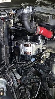

    I have the CSF oil cooler. I run the car... hard. It's a full on track car (see my build if you want all the info). Anyway, the CSF cooler isn't cutting it for me. I want to upgrade to a Setrab or other cooler but I'm having trouble figuring out what size I really should run. Has anyone else run a different cooler besides the stock one, Mishimoto or CSF cooler? I'm leaning towards a Setrab Series 1 Oil Cooler, 50 Row that I can mount in the grill, right into the nice airflow. But I don't know if that will be overkill.
    Any advice from experience of hard track use/endurance car running is appreciated!
    Other pertinent specs: stock s54, only headers, nothing else for power and don't plan on upgrading the hp level.

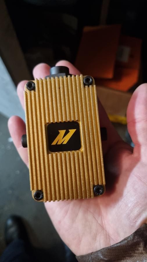

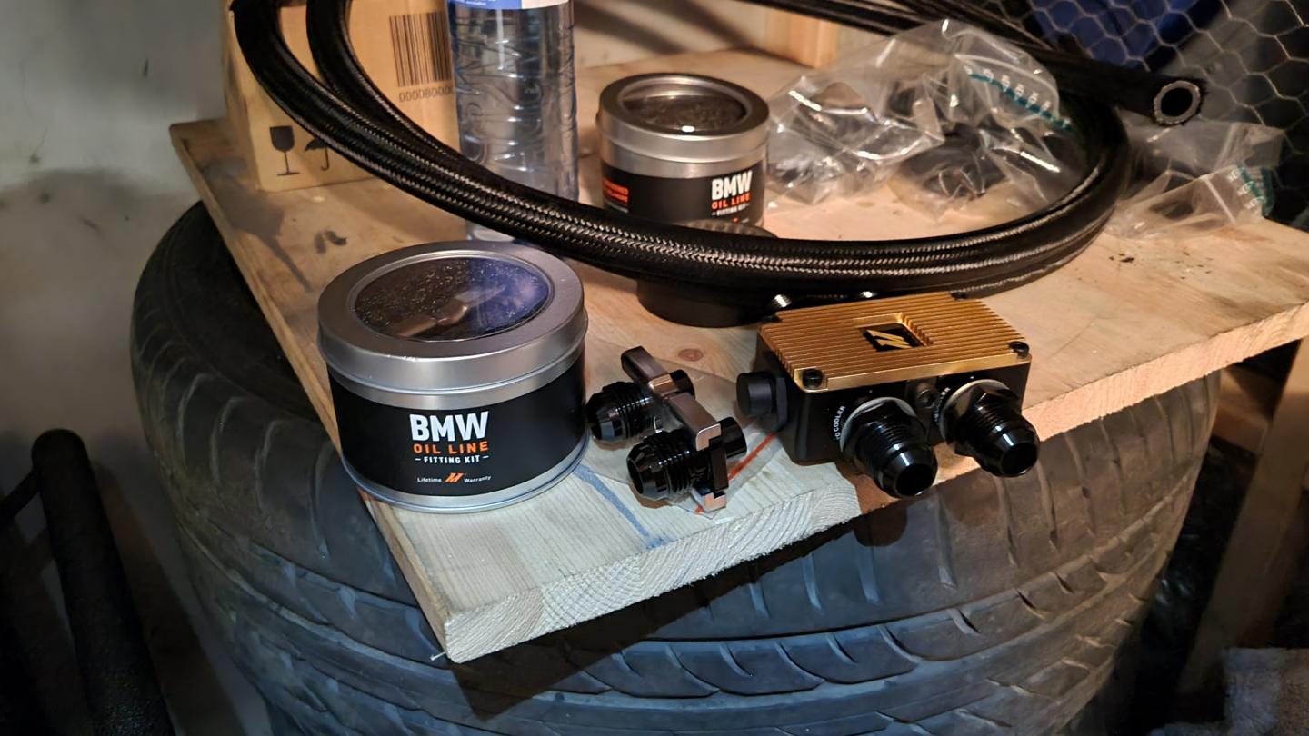

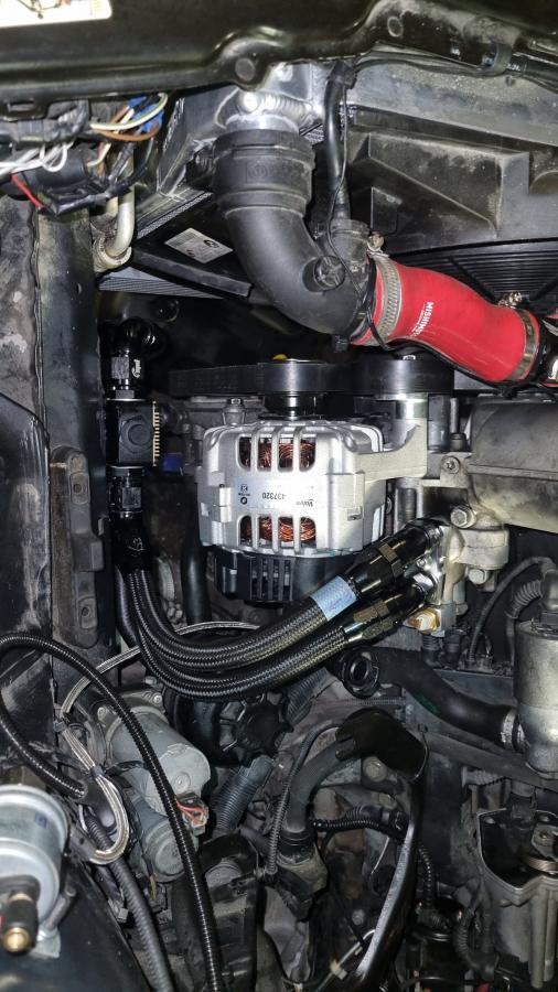

    No track experience, but: I went from a worn OEM to a CSF cooler. Noticed when driving normally the temps were slightly cooler. Recently did a major overhaul to this oil cooling system, had the oil filter housing off and fitted an oil thermostat delete. I've googled and learned that allegedly only about 50% of the oil goes through the cooler on our S54 M3's. Since it's generally a bit chilly where I live, I was now worried sending 100% of the oil through the cooler would overcool my car, so I fitted a Mishimoto inline thermostat and AN10 lines. Thermostat has 3 changeable thermostats of 71, 85 and 93 deg Cs but comes stock with the 85C.
    Click image for larger version  Name:	Mishitermostat1.jpg Views:	0 Size:	49.8 KB ID:	182673 Click image for larger version  Name:	Mishitermostat2.jpg Views:	0 Size:	137.3 KB ID:	182674 Click image for larger version  Name:	Mishitermostat6.jpg Views:	0 Size:	89.6 KB ID:	182675
    My initial observations having run this for a couple of weeks. First off, it works, and I'm also glad I bothered to fit the external thermostat. Driving gently (i.e straight from home onto the highway sitting at 50mph in 6th @ 2200-ish rpm with 12 deg C ambient) my oil would stop heating up at approximately 75 deg C. I learned that the listed thermostat temps are probably when they are fully open rather than when they start to open, so I reckon at 75 my t-stat opens and I have to drive my car actively to push through the 75 deg C stop to reach 85 within any reasonable time ( I tested and after 20 mins the oil temp was still at 75C)
    Oil temps still climb when driving actively though, but takes more effort to rise, wouldn't go as high as before if driven with comparable intensity and ambient conditions, and also cools quicker. I've also noted a slightly higher oil pressure, some for sure due to the cooler temps, but I notice with the temps roughly in the same region as before the mod, the oil pressure is still slightly higher, and I wonder if the shorter run AN10 lines compared to stock might be the reason for this?
    My car also now uses more fuel so I'm gonna swap to the 93 deg C thermostat. I've also learned that at slow speeds the oil temps still rise, so with that said I would advice fitting an oil t-stat delete and look into airflow over your cooler to help you out.
    Regards
    Last edited by Mr.wReckless; 08-31-2022, 01:44 PM. Reason: Edit to say I've also got VAC's high flow oil pump fitted, whether the alleged increased flow has an effect on oil temps or not IDK
