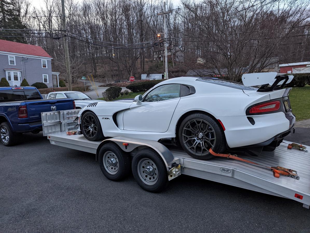

              I went with the lightest weight trailer I could find to make the actual event of towing a much more enjoyable experience. I've pulled enclosed trailers and don't enjoy it. So I have an R&R 18' trailer with (I think) 32" dovetail, 7' ramps and use 4' race ramps on those to get the racecars on/off. It's a 1200# trailer. And Dexter axles, so no annoying leaf springs either. I pulls so nicely. I added a winch for yanking dead vehicles on. The only complaint I have is that there are only 4 D rings on it for tie down, affording no flexibility in the attachment points. I don't always load only cars, so I've had to be creative more than once.
              And oh, don't get aluminum wheels for your trailer. Steel only. Don't fall for that "Upsell".
