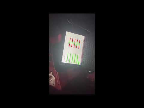

I got the BG Racing string alignment kit. Overall - great! I made a video. Let me be clear, I am in no way trying to be a youtube star. I was smoking a cigar and drinking a beer at the same time - that's my level of commitment!
Key points
- make sure the strings are in the middle of the hub and the same distance between the hub and string left to right on each axle.
- forgot to mention to set the tire pressures to hot PSI before starting.
- would be better to put the driver's weight in the driver's seat...I didn't.
- a more narrow ruler or one with MM's on both sides would work better.
My specs:
Front camber -4.0
Front toe - 0.0mm
Rear camber -3.0
Rear toe - .5mm toe in (7' or .07 degrees)
You can use trig to translate from degrees to mm/in - I just googled "degrees to mm alignment". I have 17" wheels so you'll have a slightly higher measurement for the same degrees on an 18" wheel.
I hope this helps someone!
