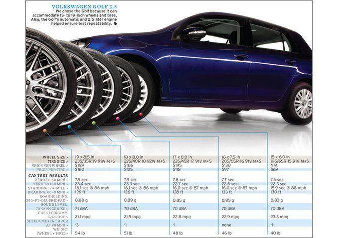

          Plus-Size Models: Testing the performance effects of upsizing wheels and tires.
Name:	effects-of-upsized-wheels-and-tires-tested-chart-678-photo-568637-s-original.jpg?resize=980:*.jpg
            Slightly stretched supposedly optimizes the contact patch.

              My previous track car was a turbo Miata. I ran 205 width tires on a 9" wheel. This is standard miata stuff as there has been testing and lap time confirmation that its faster with some stretch. When I got the M and began a wheel hunt my gut was to run 275's on a 10.5" wheel. I had a thread on the m3forum asking about any experience with wider wheels. It was generally believed that a 9.5" wheel was optimal for a 275 tire on our cars. I never went any further with it. Basically to the miata crowd this has been known for years.

                  I found this to be an interesting test. I understand the merits of testing a setup to the fastest lap time but wonder which would produce the faster average lap time over an extended session (like a 30 min race). I also wonder if the same applies for super grippy tires, like a slick or a hoosier, rather than a 200tw street tire.
                  I have been running 315 hoosier a7 on an 18x11 with the goal of having the grippiest tire afforded by my class and enough surface area as to not overheat them. A skinnier a7 might yield a faster single lap time but in my experience they won't last more than a few hot laps before melting.
                  I am glad tire rack does tests like this, pretty cool stuff. Maybe one day I will buy a set of skinnier a7, like a 285 or 295 and run them on the 18x11 to see for myself.

                        isn't it as simple as the tires on wheels with a little 'stretch' just make it a stiffer side wall, vs the same tire on a thinner wheel making a softer side wall?
                          The wheel width also affects the shape of the contact patch.
