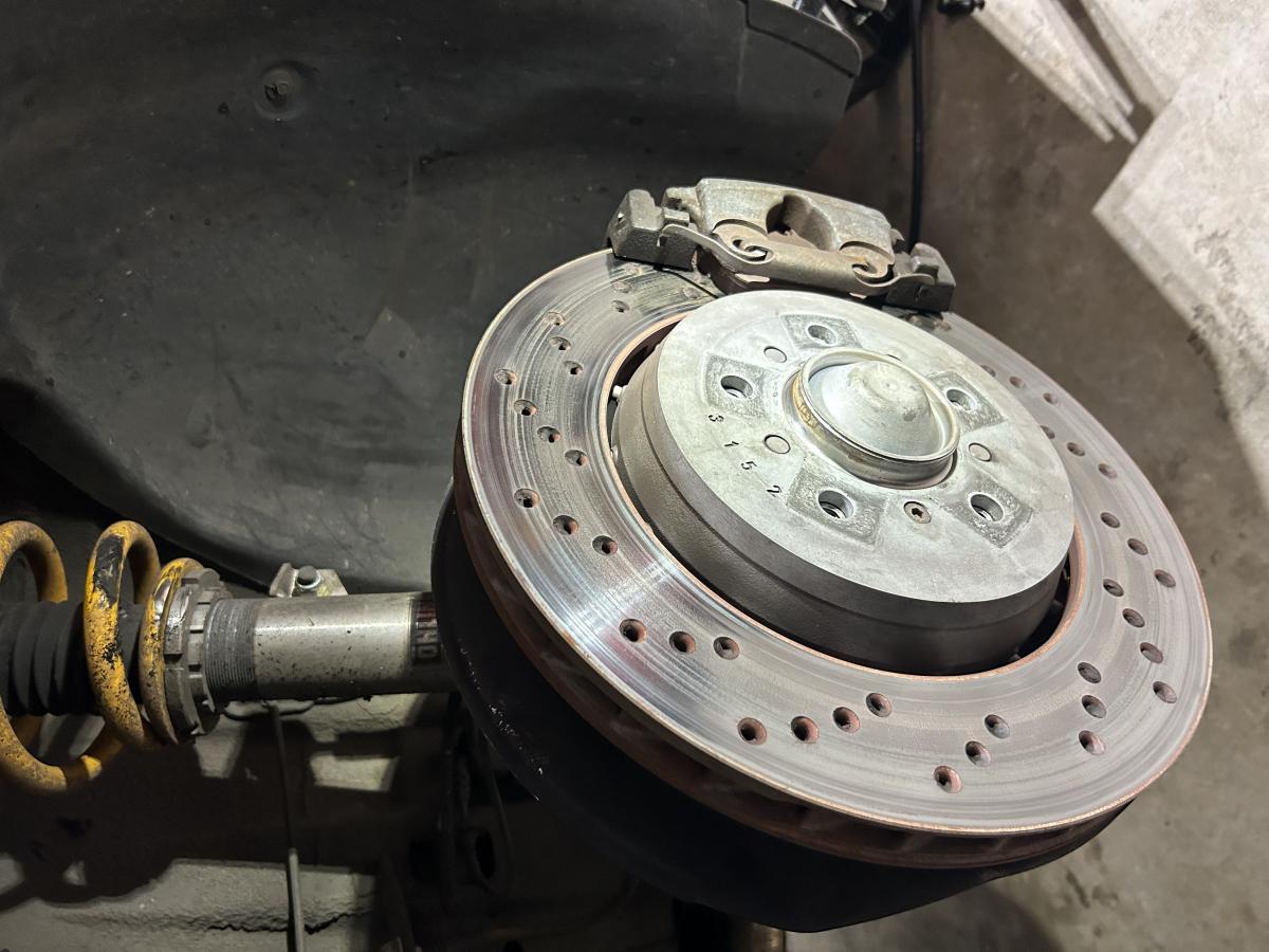

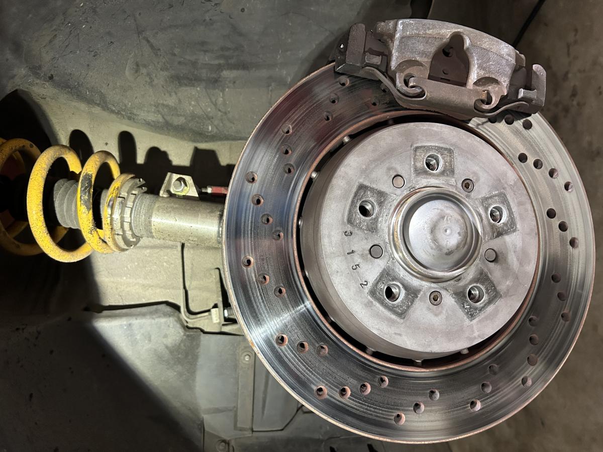

      I also want to add another element to the discussion on brake rotors, spacers and studs/lugs
      One of my rear rotors (the end with 12mm spacer) was rotated on the hub a few degrees. The ID of the rotor bolt hole is larger than the OF of the bolt threads. So I dug in a bit. It appears the anti-corrosion coating wears off in a manner that can accumulate unevenly between the rotor and hub. This is on a wheel that I torque check upon arrival at track, and after every other session. The concern is that when rotating or removing tires for a brake bleed, etc., the shavings can end up in clumps prevent a proper install.
      Recommendation: if you are using Zimmerman OEM rotors or any other with the coating on the rotor ‘hat’ - remove it.
      the first two images are before, the third is after removing the material with a drill/wire wheel
          That's odd because the head of the rotor hold down screw countersinks into the opening so the rotor shouldn't move unless the hold down screws were missing or fell out.
            I agree. I was a bit baffled. Note: the hold down screws are longer with the Future Classic 12mm spacer, and there is enough tolerance to let it happen on track. The threads from the lugs had actually worn marks into the rotor. Just goes to show even with proper torque, if there is anything between that rotor and the hub or rotor and wheel...it can cause trouble. And "anything" seems to include the coating.
