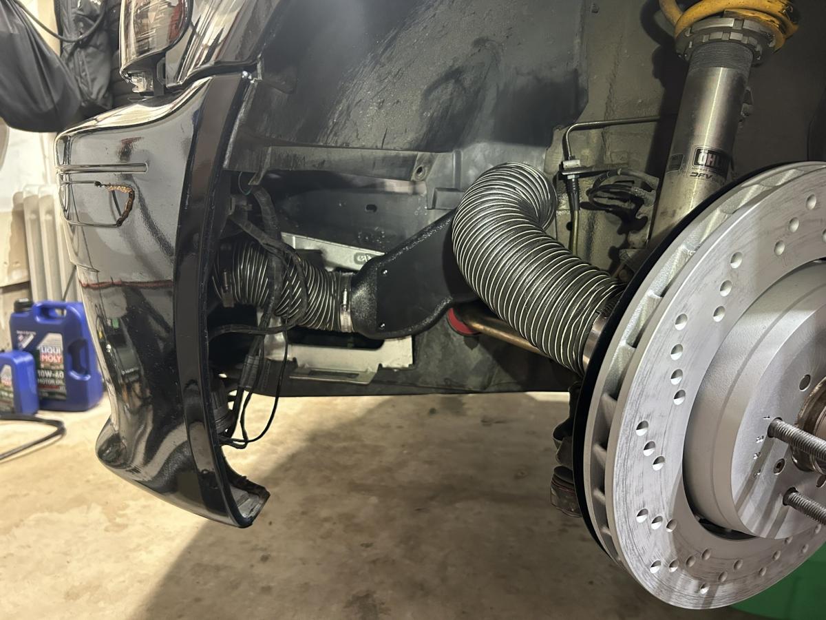

      I have ordered a HARD Motorsports kit with backing plates from AAF that will fit the 345mm rotor. I have yet to install it, but others recommend that I do this as well with the stock calipers. I had avoided that because it complicates cool air supply to the intake and it seemed to be somewhat of a gimmick to me.

        I definitely think additional cooling will increase your pad and rotor life. You mentioned your cooling kit "complicates cool air supply to the intake." Are you running an Eventuri intake? I know that kit has a scoop to direct air from the area behind the fog light which would interfere with the cooling duct.
          On the M3, the brake OE brake cooling duct splits and also supplies air to the bottom of the OE Airbox. In my case with the CSL style intake...it simply dumps air into the 'space' behind the headlight assembly. I don't have it all figured out yet, nor do I even have the Hard Motorsports kit on hand at this point...but using their Brake inlet/foglight delete and their ducting elimnates this source of air. I am considering some alternatives to their inlet, but also in another direction, considering a modified headlight assembly since this car won't have State safety inspections that might fail by removing the high beam.

                            4) Cooling is a must no matter the type of brake system used. You would be surprised how much additional life you can get from a set of pads just by dropping the rotor temps 50 - 75 degrees. I'd strongly recommend finding a way to get a brake cooling setup on your car.
                            I agree, these drilled rotors are not optimal. As you recommended: the brake cooling system I've installed seems to help with this. It's certainly delaying some of the cracking on the rotors I've seen in the past, and appears to be extending pad life. With that installed, I'm now using all of the airflow from the foglight and OEM duct opening for brake cooling.
                            This eliminated a partial supply of air to the air box/engine intake that was provided by the OEM duct next to the driver side fog light. So, I've installed a headlight duct to supplement the refresh air supply to the engine intake. Note: if you do not put screening in front of the brake cooling duct, routinely remove the rotor and clean out any rubber marbles/chunks that might find their way into the rotor hat.
