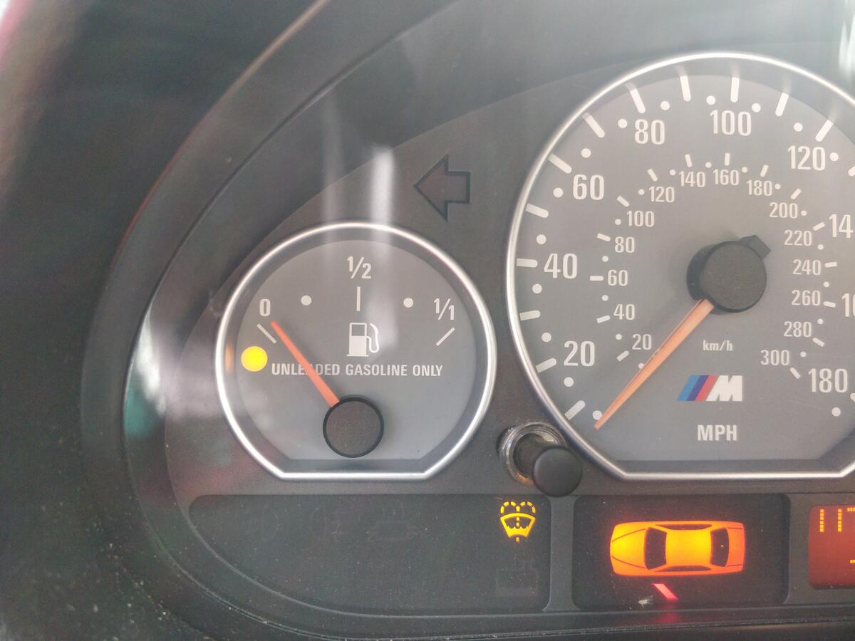

    Ah, in case anyone was wondering if my fueling issues were solved by the bimmerworld dual pump setup, plus new main pump screen/pickup...
    Click image for larger version  Name:	IMG_20210907_113010.jpg Views:	404 Size:	85.7 KB ID:	125564
    I was still pushing and never had a fuel cut. This was the level as I came off track and rolled it right onto the trailer.
