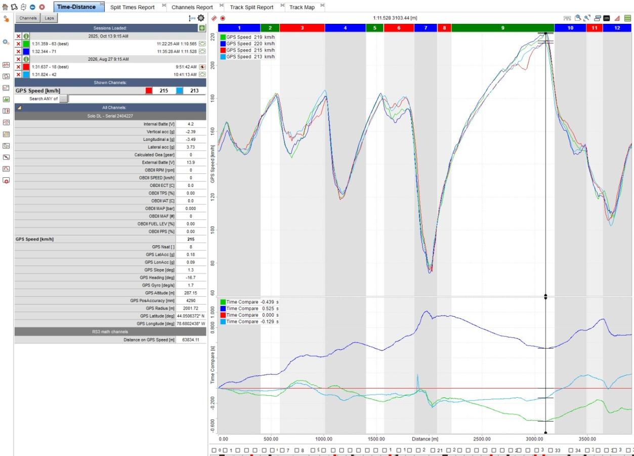

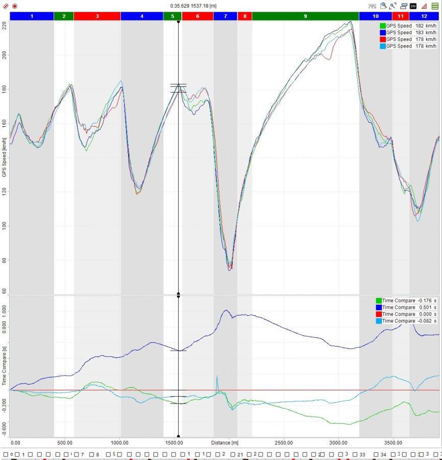

          Here is a graph of my two best times in October last year and this year. See the distinct accel difference in 4th gear.​ The average speed in some corners is up considerably as I've gotten used to the small aero components and learned to trust them (mkrennsport lip and GT4 wing). However, the discrepancy in "in gear" accel is just a bit off to me. This is also the first time I'm really trying to audit my driving.
          Click image for larger version  Name:	IMG-20260828-WA0012.jpg Views:	0 Size:	117.5 KB ID:	365935Click image for larger version  Name:	IMG-20260828-WA0013.jpg Views:	0 Size:	78.2 KB ID:	365933

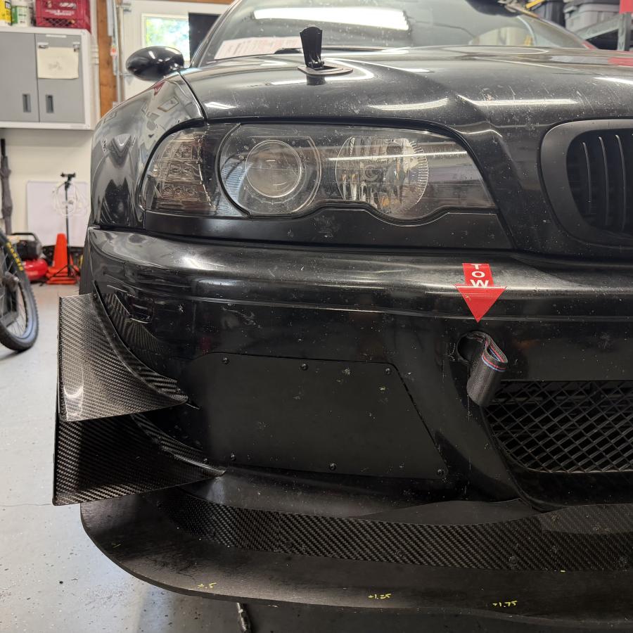

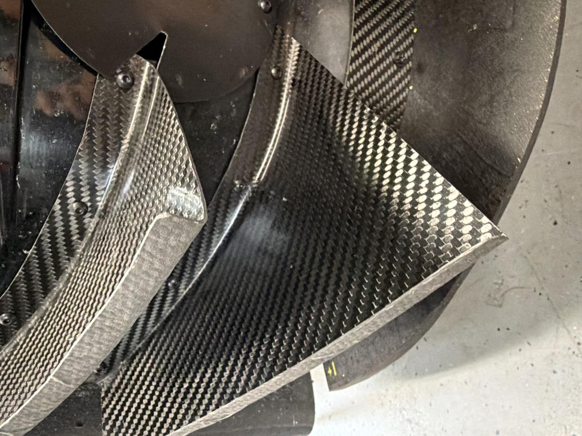

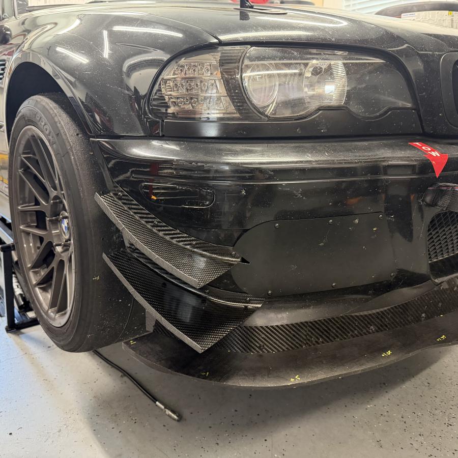

              Changes I have coming are as follows:
              Custom Canards - went old school and put cotton tufts all over the car and put a big fan in front of it and looked where I had movement to properly place and orientate them. Used PSD Designs carbon ones that I bought. However, those are to be mounted at a very steep angle and low on the OEM bumper which showed very little movement in air. Im trying to direct some of that high pressure air from the bumper to merge with low pressure air foil and "throw" it over the car on to the rear wing.
              OEM rear sway bar - Ive been running Hotchkis bars for a long time. A complaint I've had is the car not having enough "drive" out of corners. Id have to be really egregious with the throttle in order to unsettle it at all. As well I can hear the OEM diff not locking up and spinning just the inside wheel at times for a second. The OEM diff was just rebuilt and put in with 3.91 gears last year (for the OCT day as well).
              Optional - new 550cc injectors and fuel rail install plus tune. I've had these parts for about 2 years and not installed them. Currently running on an old tune that we did with Schrick cams, and now I have the CatCams with slightly different lift on exhaust, DLC rockers and the drilled rocker shafts.
                I have just added canards to our track car. My read on these (from AJ Hartmann) is that they’re designed (dimensions and installation angle) to help reduce drag on a square setup. Possibly, also interact with air under the front fender to reduce lift.
                The bumper material is flexible, so these things don’t support a load, they just redirect some air in a useful direction.
                I used rivnuts for the anchor so we can tinker.
                I don’t think these would survive wheel to wheel racing, BTW.

                      Sector 7 first: its in km/h no matter, I'm consistently bad in that section so I consider it a no factor. Meaning, on my fastest laps (which is what im looking at here so as to not skew the data with just really good exits out of that corner complex), I am consistently in the 75/77kph low/min speed in both days.
                      I agree the main variable is definitely track conditions. I think it was very green. However, I'd like to focus on distinctly 4th gear accel on the graphs. You can see the delta there is considerable. Can that be explained by something else other then starting grip out of a corner? Would I not see a delta as pronounced in 3rd gear out of sector 7 for example? (genuinely asking)
                      Where I think you're on the money, and something I haven't considered, is wind. That would make more sense in higher speed situations as the resistance is not constant but a multiplier.
                      Agreed there are a lot of factors, I guess im trying to isolate it or dumb it down for myself a bit and choose to focus on just 1 or 2.
