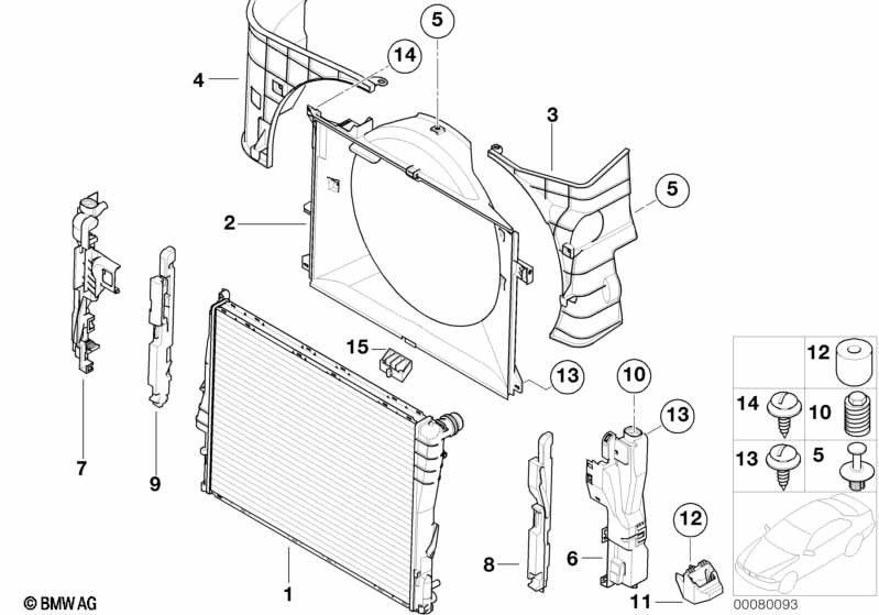

    I am so tired of working through the puzzle (for me) that is removing the fan shroud (Item 2) and the other plastic parts called air ducts (Items 3 and 4). Usually I'm pretty good at sequential tasks, but this one frustrates me beyond no end.
    Part of the issue that complicates removal (with the carbon intake I have) is the driver side air duct (#3) getting in the way. I have it trimmed, but I kept what I could, presuming this duct is part of the overall solution for keeping temps down.
    Does this matter on a track car? How much of this stuff can I ditch? (I"m not trusting ChatGPTs answer)

    I’m not sure how well your car configuration compares to mine so take this with a grain of salt. I had issues with cooling in the summer events here in the Midwest. Referring to your diagram, not only have I removed part numbers two, three, four, five, but I have also removed the mechanical fan and the AC to improve airflow and use hood vents on my car. No more cooling problems.
      foolio - do you have an electric fan (E.g., a SPAL)? Hood vents are in the plan eventually, but at the moment, this car is cooling just fine even in (very) high ambient temps at VIR. I don't want to screw that up...
      Edit: corrected something I misunderstood...Foolio - my A/C, condenser, OEM auxiliary electric fan are all out. I have a 2 year old OEM radiator and OEM oil cooler.
        foolio - do you have an electric fan, or do you still use the OEM clutch fan? Hood vents are in the plan eventually, but at the moment, this car is cooling just fine even in (very) high ambient temps at VIR. I don't want to screw that up...
        No clutch fan. I have not added any electric fan in addition to the stock electric fan. Just to be as complete as possible, I also do not run the traditional engine coolant. Just distilled water and water wetter. However, that was one of the first things I changed when I was having cooling issues and I am not sure how much it helped. I did not get enough data on that alone before I did all the other changes. Also, since I was not specific, when I say I removed the AC, I removed everything, most notably the condenser to improve airflow across the radiator (which is stock).
          Take it off once. There’s radiator hose that goes through the shroud. Get a dremmel and cut off the corner that requires removing the hose. There are still enough mounting points. Next time it’s a non issue.

            I don't have #4 and #5 - #2 shroud has an electrical fan mounted to it, and is screwed in with 3 torx screws, I'm pretty sure I left the one by the headlight out. Takes 2 min to take out.

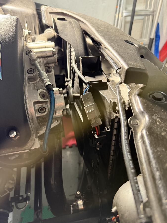

              I’d like to see your setup CrookedCommie.
              If I follow, you mounted an aftermarket electric fan in the OEM shroud. I’ve only seen the SPAL setup (without using OEM #2)
                I'm using a SPAL 30101516, Tulay wired it on a relay off the radiator hose outlet temp sensor and a switch in the cabin. You can also use the aux fan controller to power it. Not the best picture but will give you an idea. I bolted the top two mounting points directly to the shroud, the bottom I used the SPAL mounting brackets and cut them to fit.

                  I have no fans and deleted the shroud. If you plan to keep the puller fan then best to keep the shroud.
