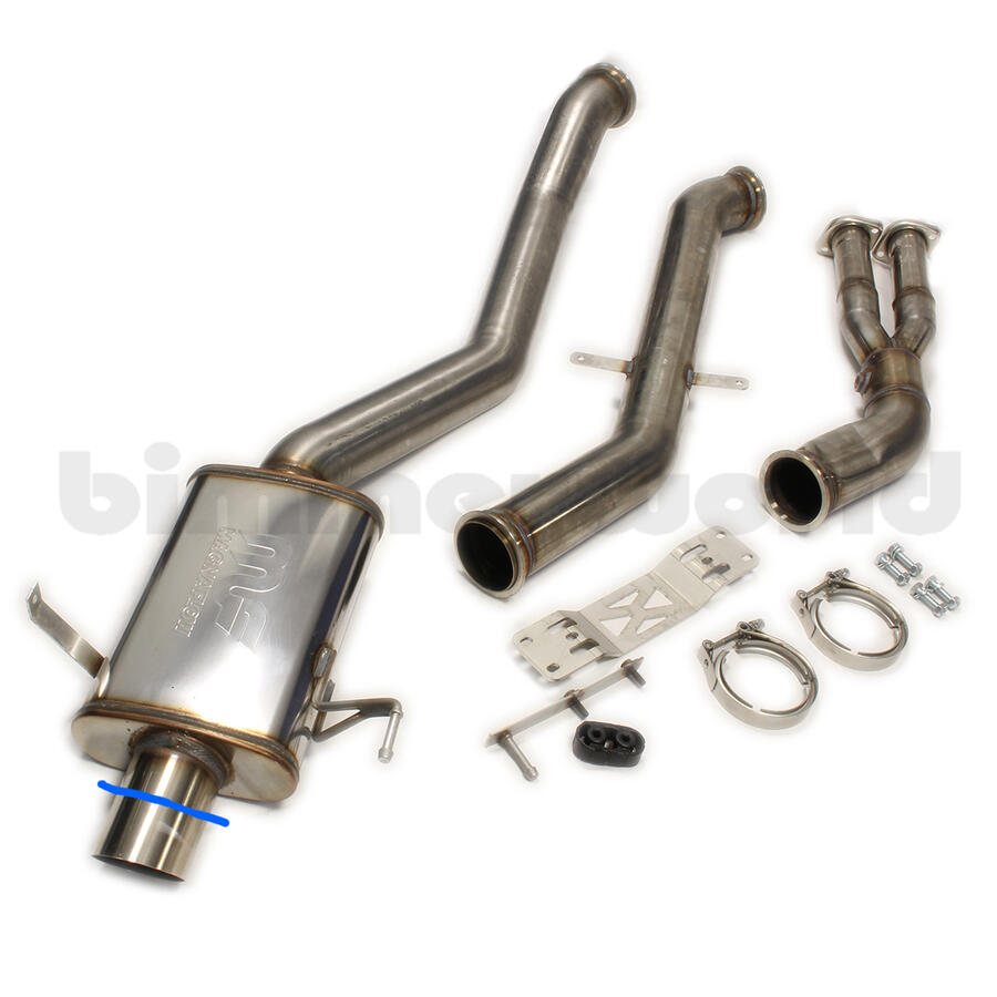

    Hey guys. I’m looking to drive at Harris Hill soon, which has a 99 dB limit trackside and an 85 dB limit at the property line. With the BW exhaust, I know I’m going to get flagged, so I’m trying to find a slip on turn tip that I can attach when I drive at Harris Hill. All of the tips I find are really long, so I was wondering if any of y’all are running one that is shorter. Or, would you happen to know where I can find one that isn’t like 10” long? Thanks.

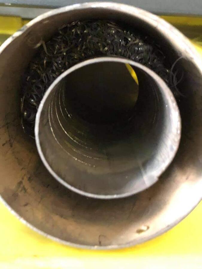

      KenO from M3F gave me a good idea on Facebook. His setup allows him to go from 102dB to 95dB. He attaches a small muffler to the M3’s exhaust tip, and on the other end of the muffler is a turn pipe that has dB killer with packed material in it. I think I’m going to replicate that.
      Muffler: https://www.speedwaymotors.com/Schoe...ler,57016.html
      Exhaust elbow that I’ll likely go with: https://www.speedwaymotors.com/Mild-...Inch,9757.html
      Edit: I think the length of the flange on the muffler will be a problem. Pretty sure the BW exhaust tip is slanted (can’t confirm bc I don’t have the car with me), so the flange will probably be too short.

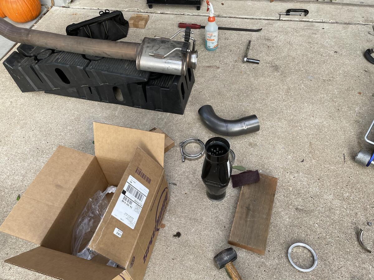

        After talking to some people, I think I’m going to use V-bands. I’m going to cut the exhaust tip off and add a V-band flange to the cut ends, as well as the additional muffler. That way, if I need to use the Laguna pipe I’ll just remove the exhaust tip and install the muffler. Muffler-to-elbow will most likely still be held in place using a couple of bolts.

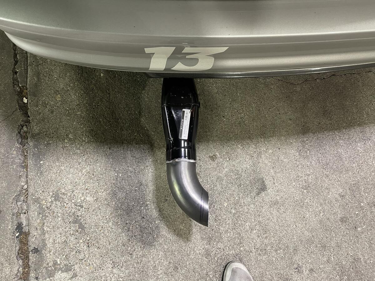

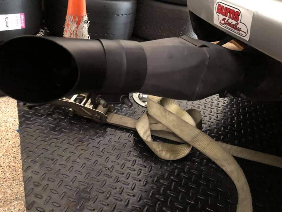

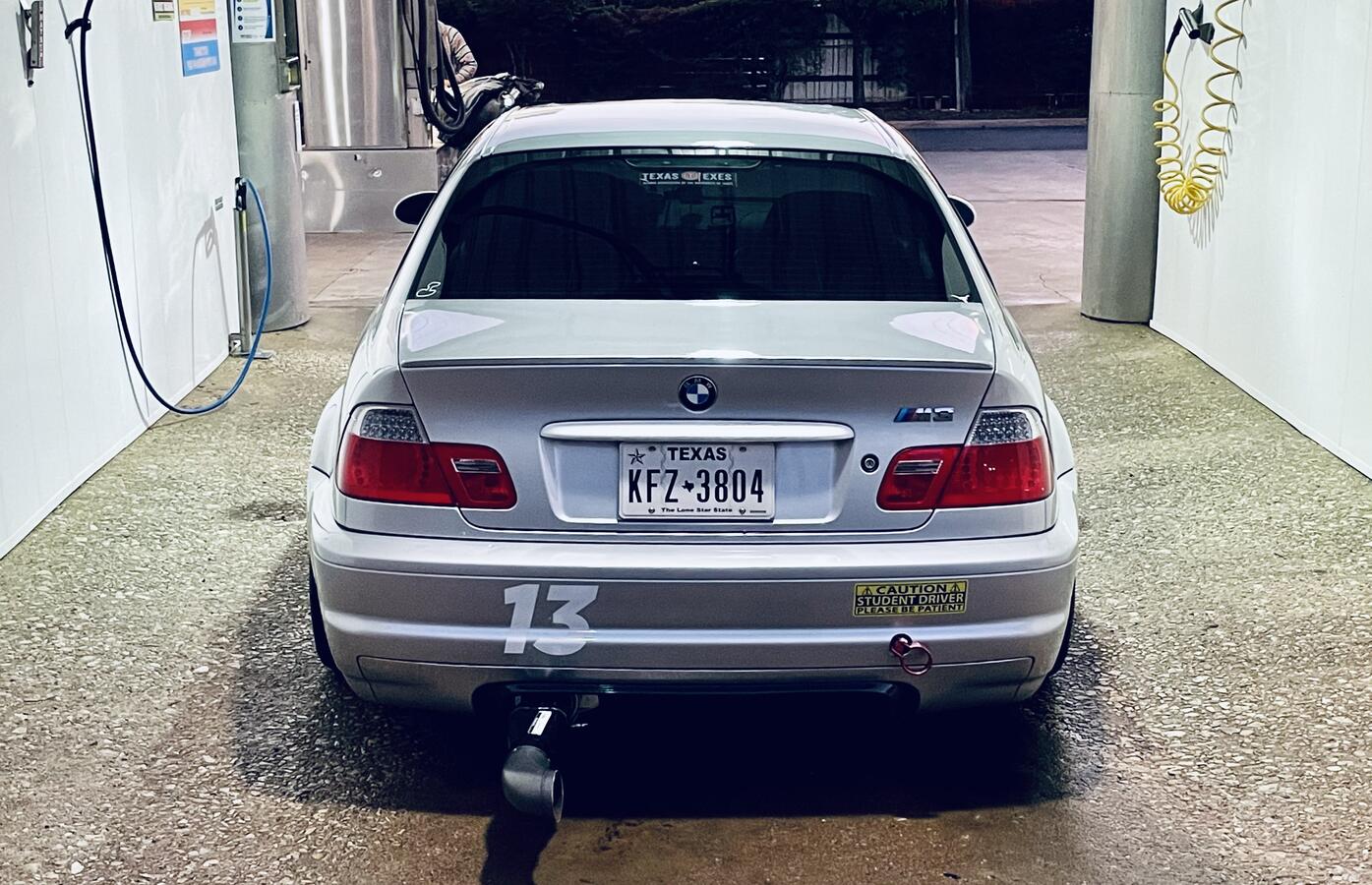

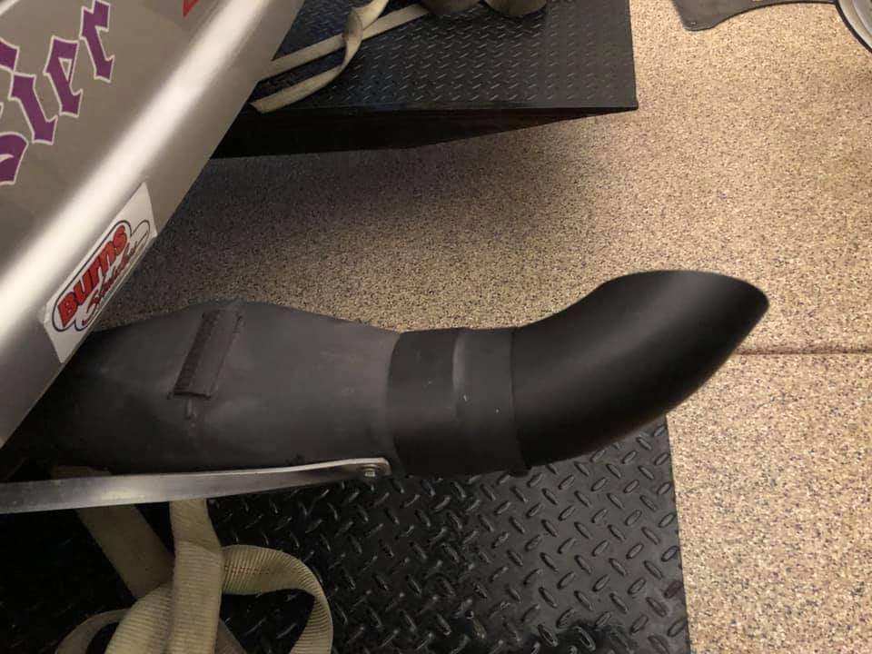

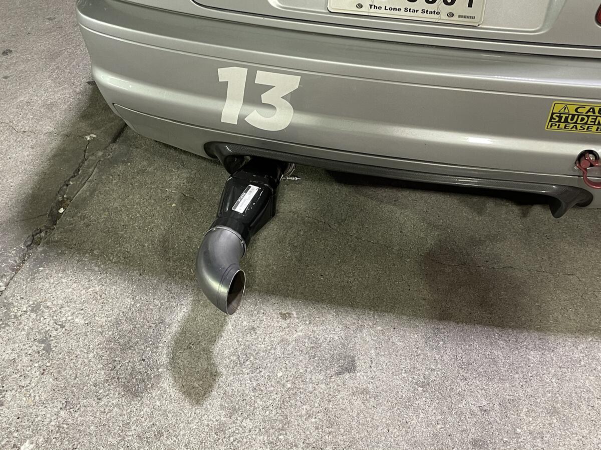

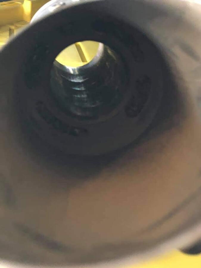

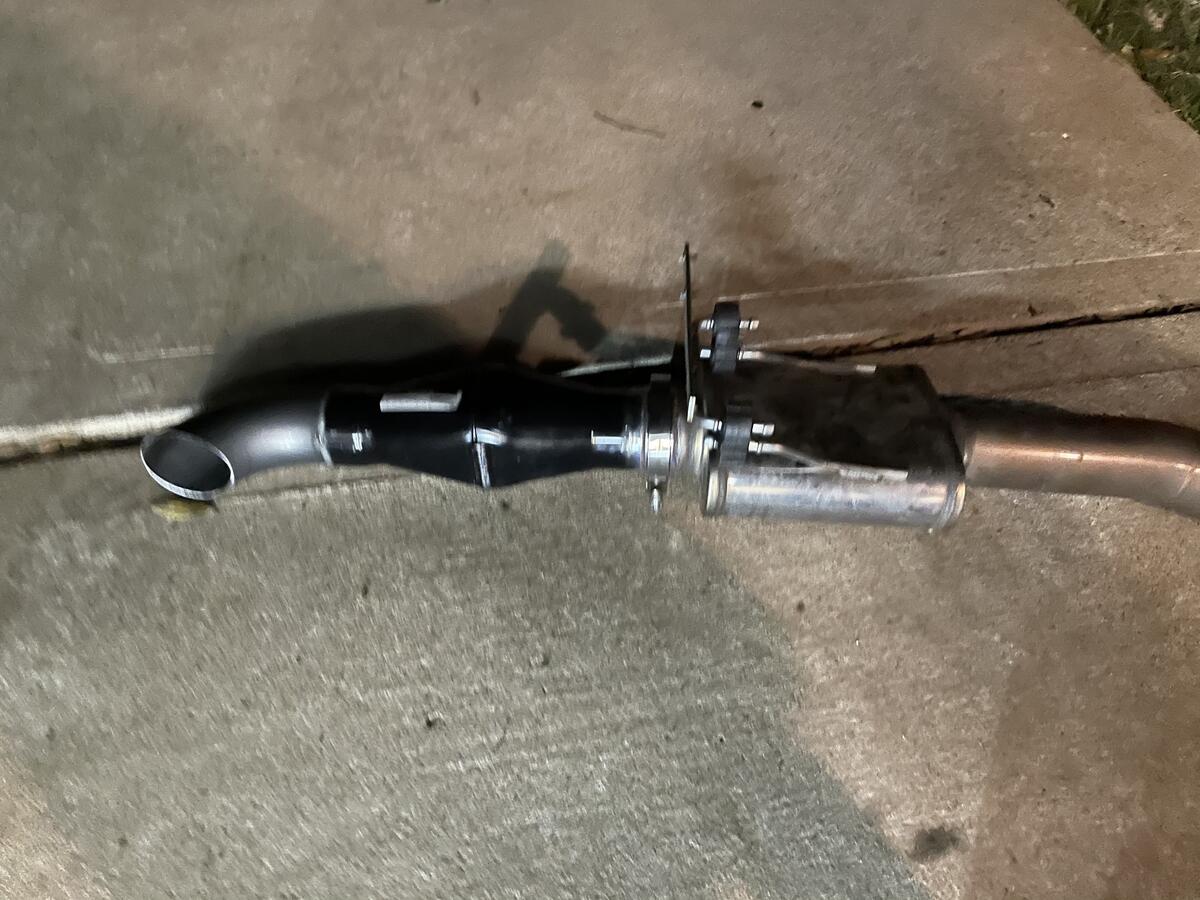

          I ended up going with the setup mentioned above—extended muffler + turn tip. The muffler is attached to the BW exhaust using a V band. The turn tip was cut to remove excess piping, and it is tack welded to the muffler. It’ll be getting a V band setup as well, in case I ever need to use a turn tip but not the muffler. The tip does not have dB killer in it. Still, the exhaust is significantly quieter..similar to my old SS Race muffler with stock mid pipes and CPI headers. I can probably have an instructor in the car and be able to hear him/her clearly. I’d still wear earplugs though.

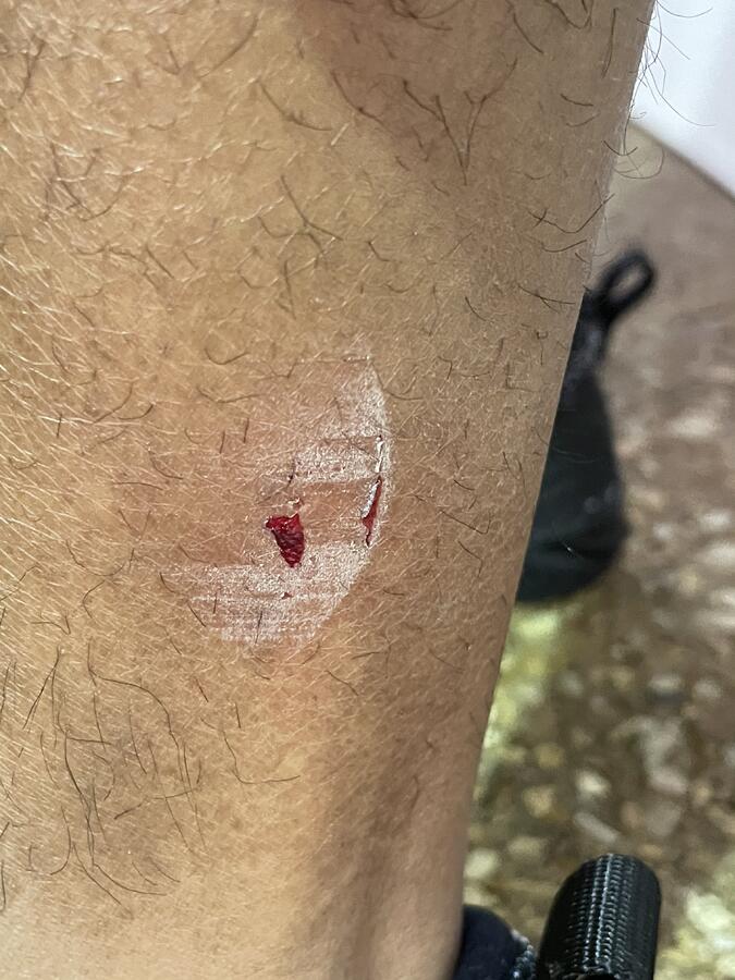

          My concern at this time is the lack of a support bar for the muffler. I’m a little uneasy about having the muffler secured by just the V-band given the muffler’s weight (may be overreacting here). Plan on getting that done hopefully soon. Also, if you cut the turn tip like I did, make sure you smooth out the cut pipe very well. I didn’t have mine smoothed out well enough and cut my leg while washing the car.
