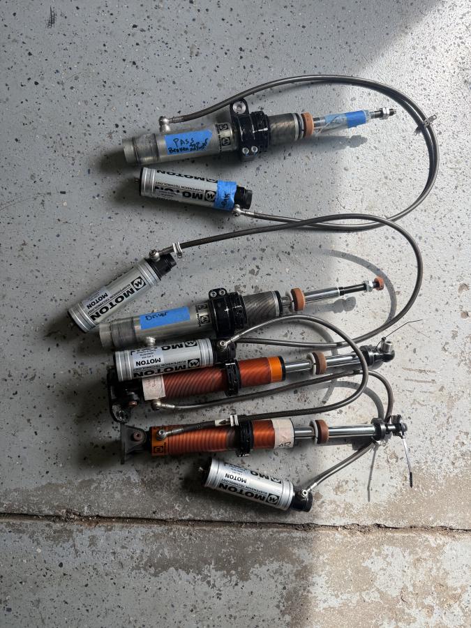

    I have a set of Moton 2 way remotes that I'm trying to make work, unknown history, went off to a local guy for rebuild, but will need to go off to Anze again. Before I spend $1600+, has anyone made the Moton's work well, or did you end up ditching them for a similar MCS's setup.
    This is on a full aero race car, spring rate is 900/450 (coilover rear). The Moton's seemed to be binding up mid corner and bouncing on full soft comp and rebound, and turning either up exacerbated it. They went off for a rebuild to a local guy, but he was unable to fix an adjuster so will have to go off to Anze this time. I can have them get a baseline dyno and revalve if needed to try and make them work well. Another thing to consider is I believe MCS 2W remotes are upgradable to 3-way down the line, with the Moton's I don't think that's an option. Also MCS's can get sent off to their in house service center and are supported by Bimmerworld.
