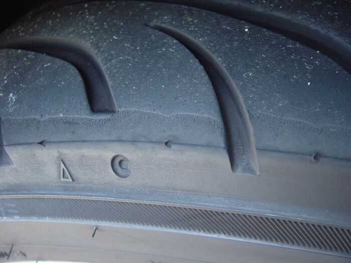

Tire pressures are best set by sidewall rollover. Most track tires have an arrow that indicated how much sidewall roll you should optimally get. This keeps you in the useful part of the tires tread. Using a paint pen, you can see how much roll you're getting on a given session (by how close to the arrow the paint wears away). Many people like to tweak their oversteer/understeer by tweaking tire pressures-- I think that's better accomplished by tweak sway settings, and saving tire pressure adjustment to get optimal use out of your tires.
Roll indicator arrow I'm referring to:
