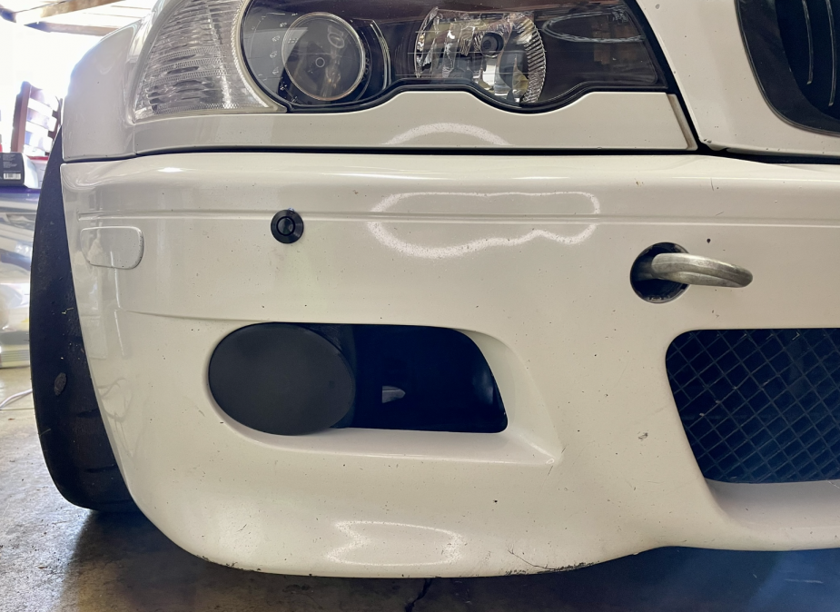

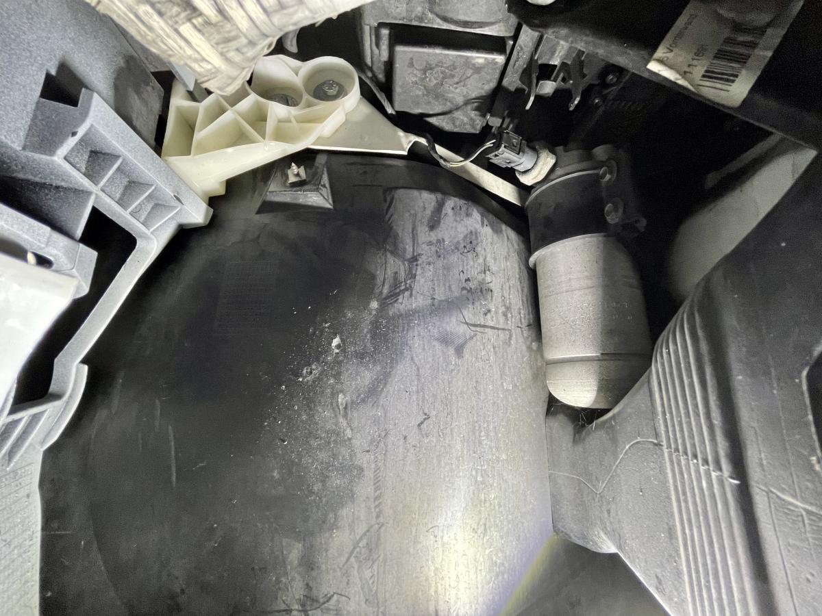

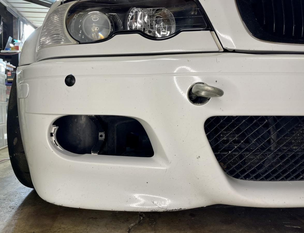

    As you all know, glass lens fog lights and tracking your car do not jive well. This fact led me to removing my fog lights and trim rings a while back which resulted in two large high drag volumes (see photos below).

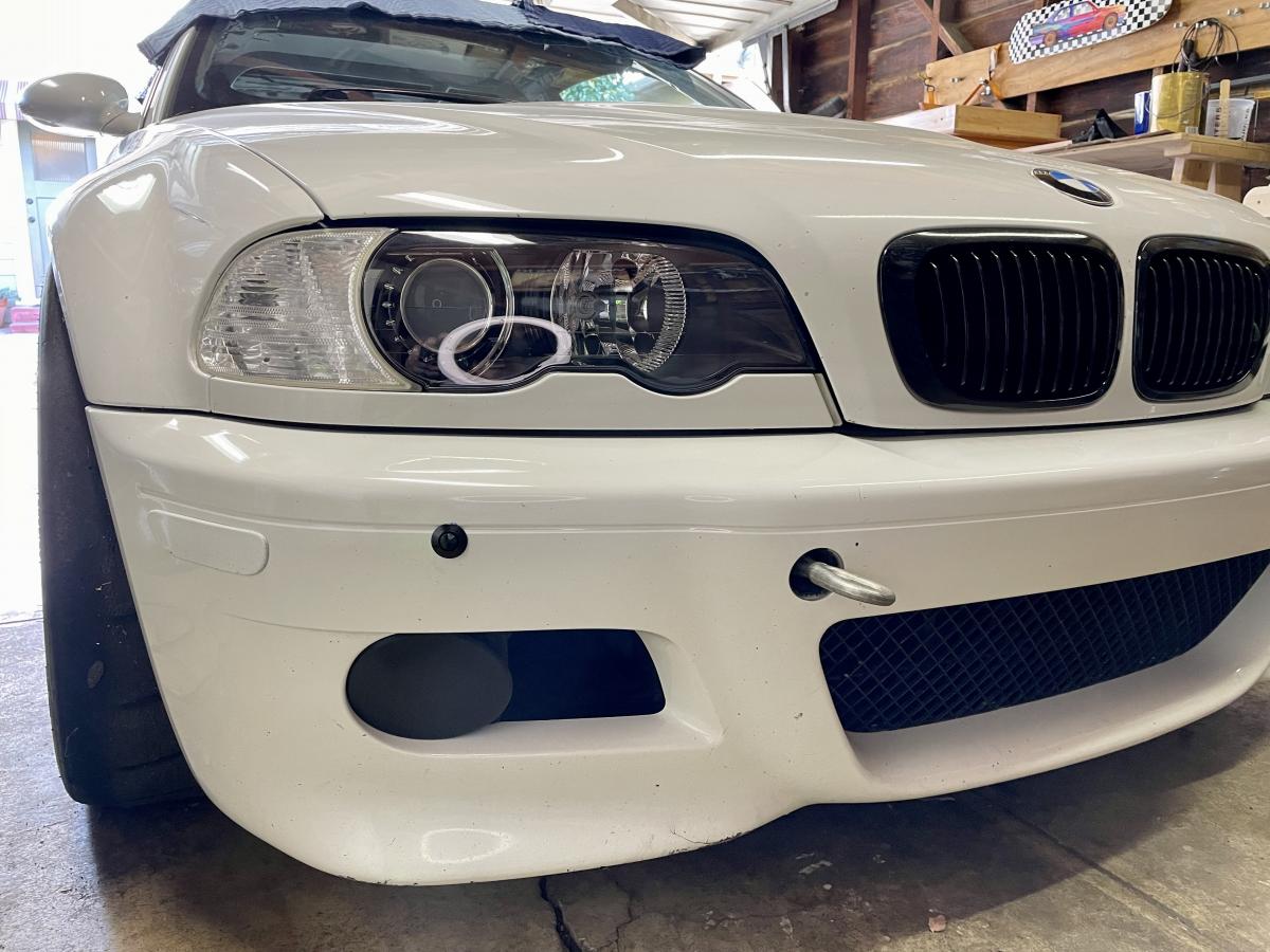

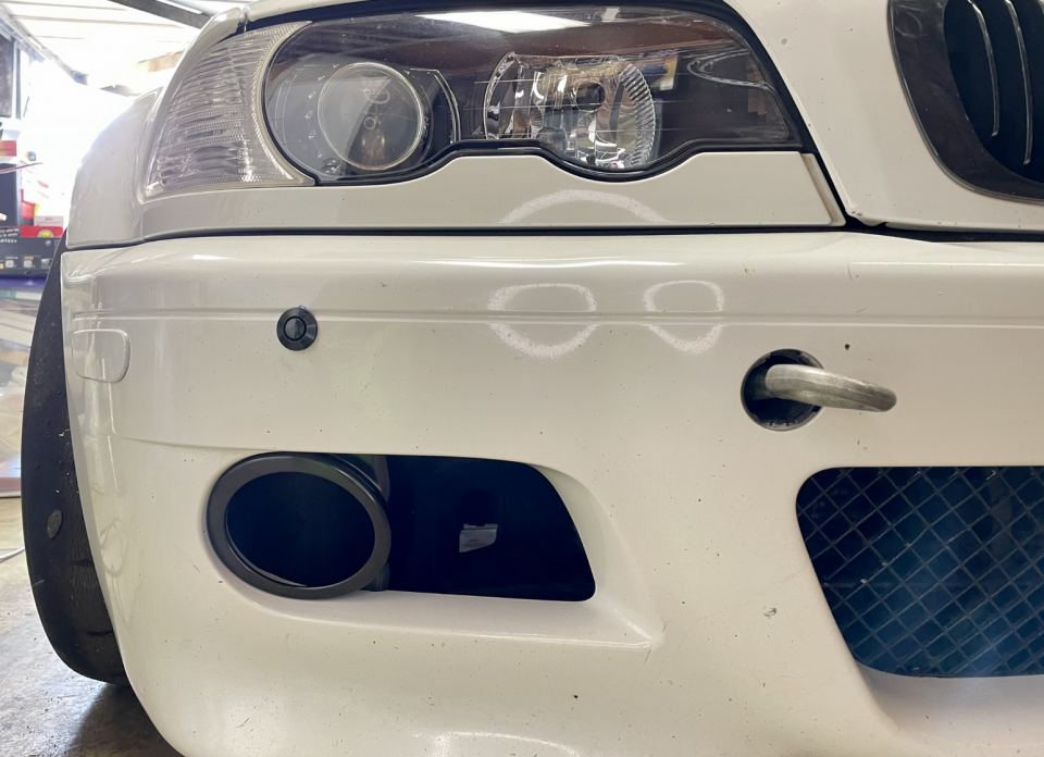

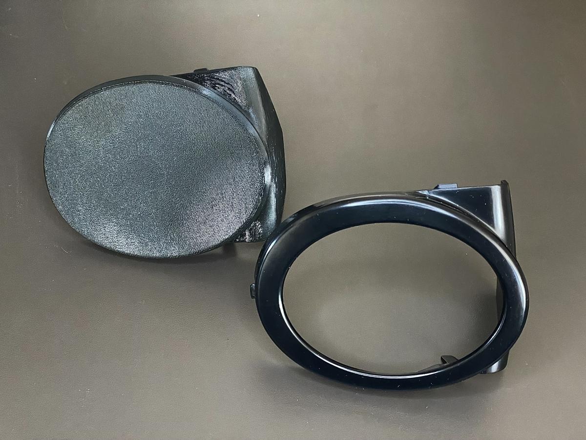

    Recently I have been looking into front lips/splitters and had a look at where the fog lights were and realized how large these two gaping cavities are and how much of an effect they have on drag. This led me to start thinking about solutions, so I laser scanned my OE fog light trim ring and essentially made a block off panel (see side by side photos below).

    What material are you printing these out of?
    It's hot enough down there than PLA will likely warp over time.
      They are made of PETG which is more than enough to handle the heat at hot track days. The glass transition temperature of PETG exceeds 175*F (~80*C).
