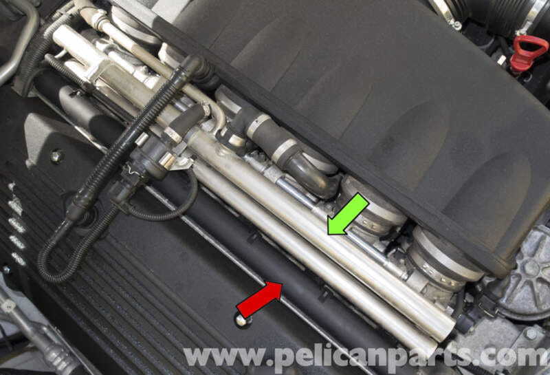

Need the black plastic fuel injector wire harness housing.
    WTB: Need the black plastic fuel injector wire harness housing.
    Long shot. Doesn't seem to be listed in real oem. Can't find one on ebay. It's the black plastic housing with the red arrow inthe pic below:
    Could be 12527506700 and 12527506701, hard to tell. Not sure it does any good as no one seems to stock the part although Schmeidmann lists them.
    https://www.realoem.com/bmw/enUS/sho...07#11787547213
      The diagram for the m3 doesn't list the part #s. The part #s you've found seem to belong to the 318i which would not be the S54 obv.
        I’ve been down this rabbit hole. The engine wiring harness is all one “unit”. The reason I needed this is because I was removing my ITB rail to do a deep cleaning. When I reached the point of pulling the injector harness, I ripped the harness right out of the injector plug. In doing so, I had to replace the entire wiring harness. It wasn’t difficult at all.
          You bought a used one?
