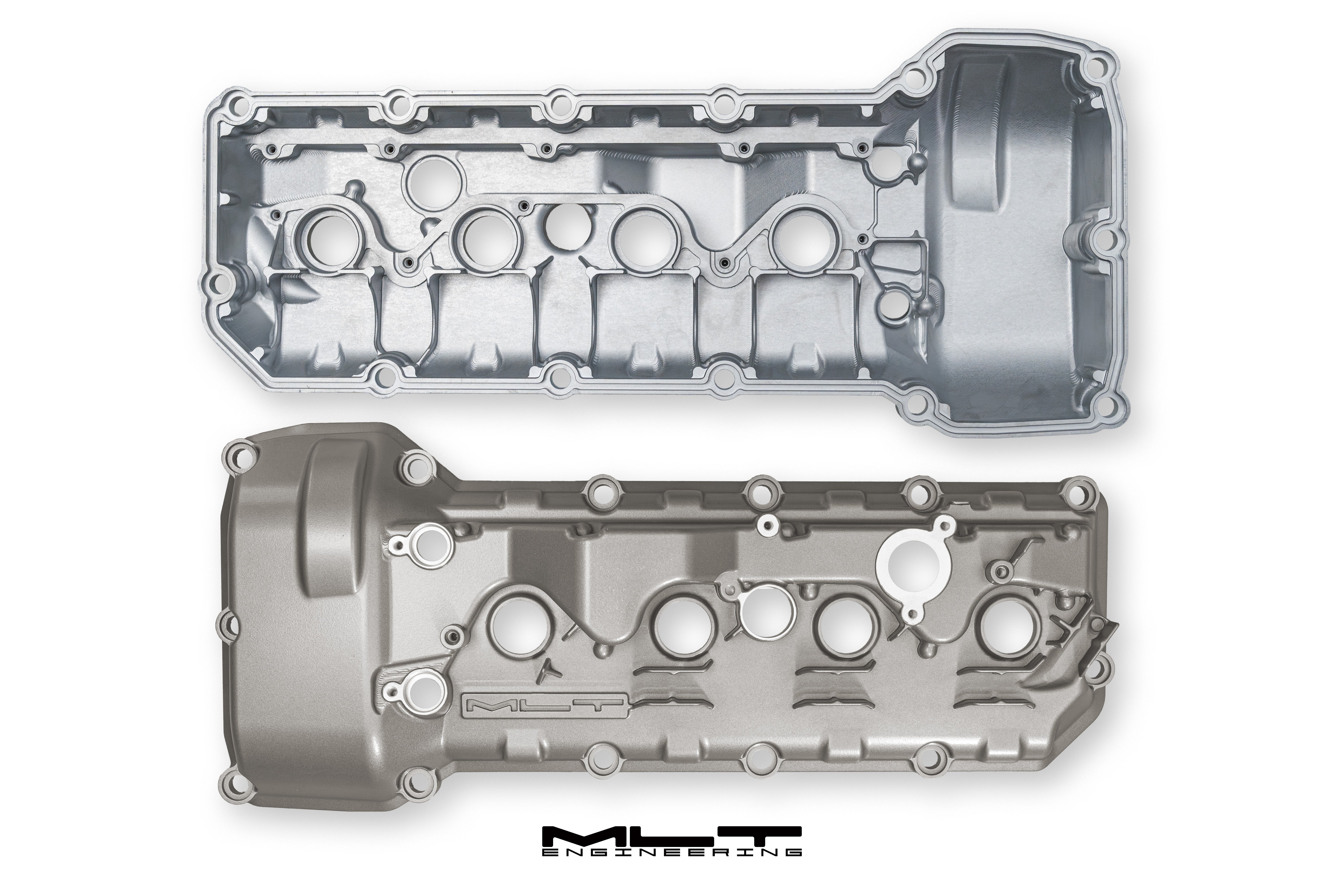

                  MLT is coming out with a billet version, for those of us with more money than brains
                  MLT Engineering Aircraft Grade Full Billet CNC Aluminum Valve Covers BMW S65 Engine 2008-2013 100% BMW OEM Hardware's Compatible This is 100% Full Billet 5-AXIS CNC Aluminum Valve Covers Eliminate the weak point of your high-performance engine with the ultimate top-end upgrade. The factory magnesium covers on the S65 e
