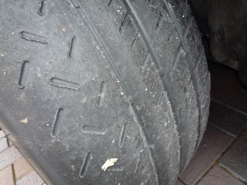

                        Had mine set up for max neg camber on standard suspension (-2 degrees front and back) seemed to work as regards lack of edge wear, have just peeled back the centre section of the front tyres. Carrying too much corner speed I guess, used to the pace of the M3 perhaps?? Hey ho, its only money innit LOL!!!
                          and bear in mind this was after a 2 hour steady drive home that cleaned them up a hell of alot!!!!:whistle:

                            All i can say Hazy is bloody good effort mate! it's good to see you were giving it some :thumbs:
                            But after reading what some of the other experienced guys have said it might be an idea to get your geo setup checked again???

                              I'm thinking the tyre wear might be down to pressures??? Was running 30/32 psi hot..... might be a touch too soft, allowing the tyre to roll a little too much? No doubt someone will advise me....
