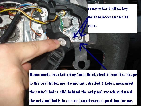

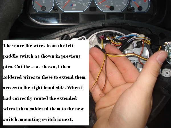

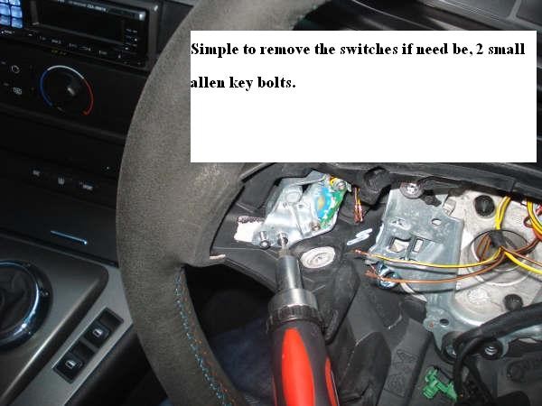

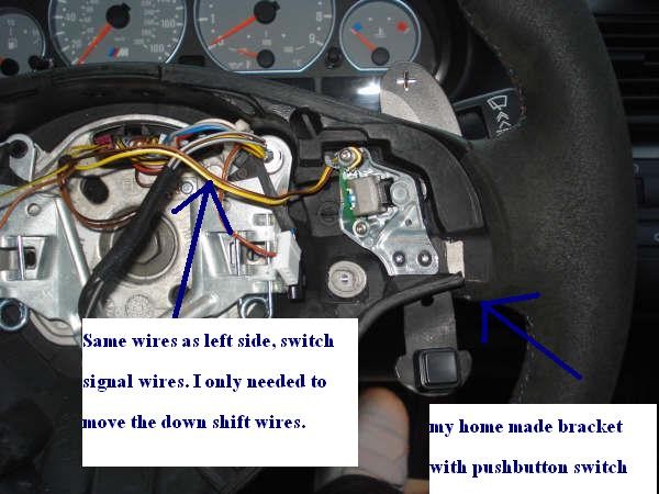

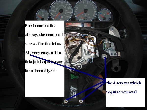

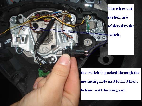

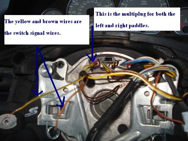

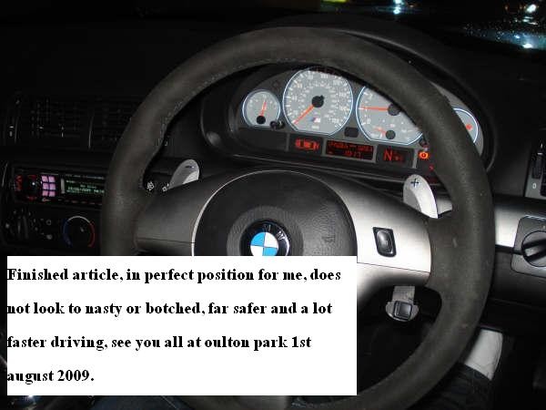

    After bit of faffing with bracket i got my gearchange mod complete tonight:thumbs:
    Those with left arm remaining it will be an easy job, as you can mount your switch in the plastic housing, but as the m track button circuitary was behing the right hand side, i had to create a switch mount, as shown in pics below.
    All that is required is a little time patience, a few tools,
    A pushbutton, push to make momentary switch
    A suitable bracket.

      Quality work and nice write-up :thumbs:
        That my friend is awesome :thumbs::thumbs:
        Although it does give you an unfair advantage at Oulton Park :whistle:
          Thats a great write up Lawsy keep up the good work :thumbs:
            Well done mate, you made that look easy, enjoy your trackday :thumbs:

                I wish the m track button was not on the right hand side, then i could have done this.:banghead:
                After driving it i may do away with the m track circuitary and mount a switch the same as yours.
                I will either drive full traction on or off.
                It will look neater like yours.
                Have you flocked your wheel? looks good:thumbs:
                  Well done guys, both look like quality bits of work. We're just about to finish our version for the race csl as we've upgraded to a sparco smaller removeable wheel so have a whole new paddle arrangement.
