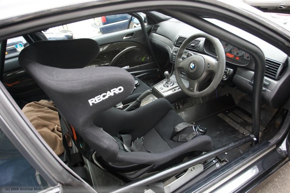

        + 1 for Weichers mine is a 6 point bolt in cage, so I have front section as well .... makes you go a bit faster !! . www.wiechers-sport.de/

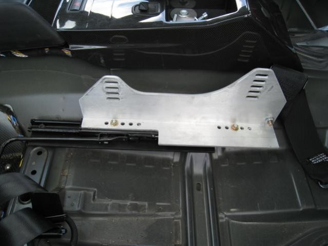

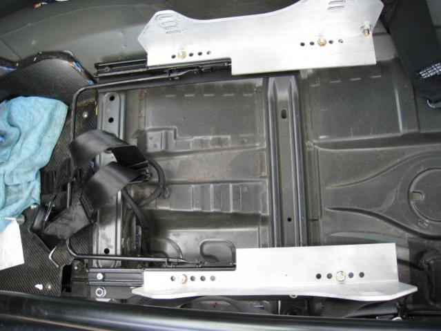

        posted a couple pics showing harness and seat runners for Recaros...cos im like that ! :smokin:
          I've got the Safety Devices full cage, and I fitted the rear only SD cage to Titans car. The rear cage would be reasonably easy to reverse, and all holes would cover up as long as you don't cut your rear carpet about to fit it back in nicely.
            Installing a rear cage alone obviously requires either welding or bolting.
            Both being fairly permanent until either the welded option is cut & ground off or bolted option unbolted & plugged up. Bolting I recommend drilling a minimum of 3 holes/ bolts per 2x floor legs and Weicher I believe supply a 2mm plate when bolting but would prefer a 3mm-6mm plate to be used. Carpet would need to be cut for 2x legs on rear cage only or obviously removed. Alternatively if/ when reverting back to standard buy a new one.
