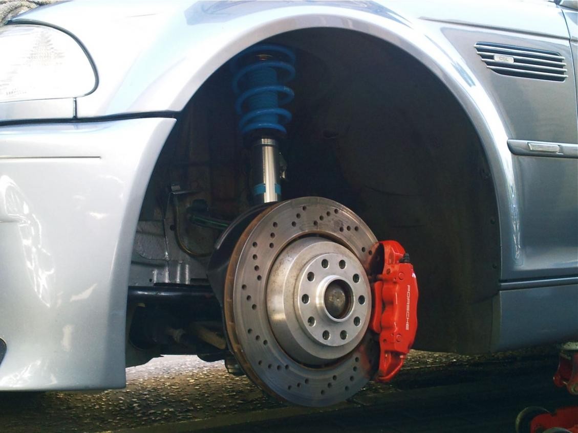

Standard CSL discs are very good :thumbs: but why bother searching in vain for 6 Pot callipers to fit over the OEM CSL discs when BREMBO make perfectly usable 4 pot callipers off Boxter S / Cayman S that are readily available and with a little imagination :whistle: fit snugly over CSL OEM discs :smokin:Originally posted by The Gorilla View PostHi,

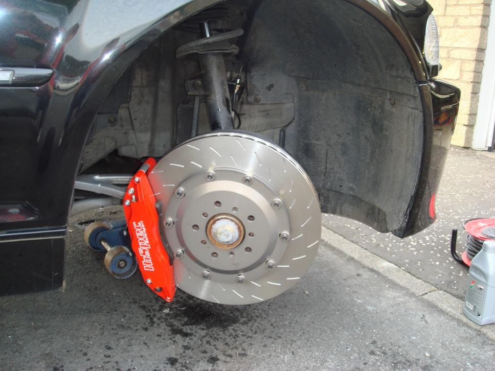

BTW, you just knew that pic was coming
:hahaha:
That's not necessarily true.Originally posted by The Gorilla View PostBy retaining the 28mm std discs rather than
after market you would also have less
unsprung weight on the front, which helps.
The AP front discs are similar weight, if not lighter than the CSL discs.
Also, the AP calipers are much lighter than the stock CSL ones.
